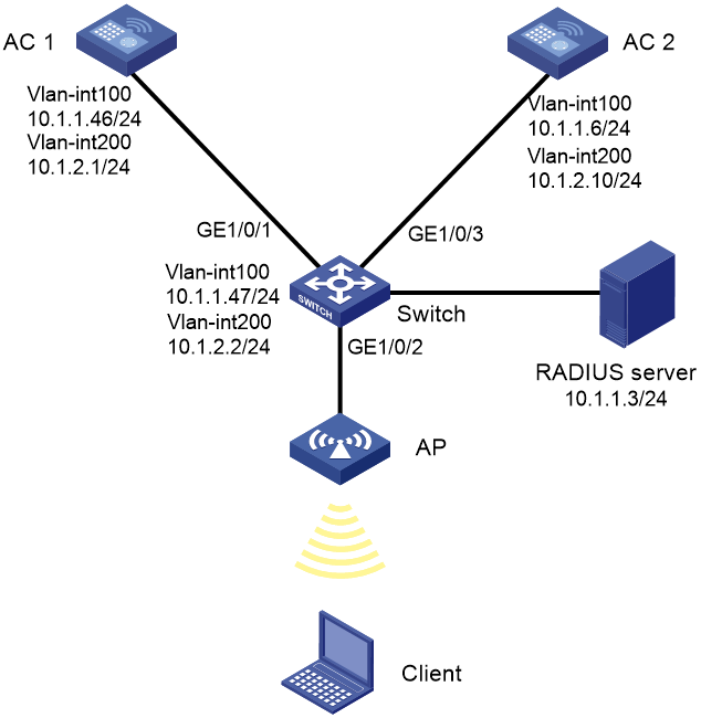

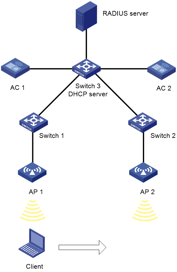

As shown in Figure 1, AP 1 and AP 2 are managed by AC 1 and AC 2, respectively. Clients associated with AC 1 belong to VLAN 200. Clients associated with AC 2 belong to VLAN 400.
Complete the following tasks:
· Configure inter-AC roaming to enable clients to roam between AP 1 and AP 2.
· Enable local forwarding of client traffic.
· Configure VLAN-based user isolation to improve user security and reduce radio resource consumption caused by multicast and broadcast packets.
Device |
Interface |
IP address |
AC 1 |
VLAN-interface 100 |
192.1.0.2/16 |
AC 2 |
192.1.0.3/16 |
Switch 3 |
192.1.0.1/16 |
VLAN-interface 200 |
192.2.0.1/16 |
VLAN-interface 300 |
192.3.0.1/16 |
VLAN-interface 400 |
192.4.0.1/16 |

1. Configure interfaces on AC 1:
# Create VLAN 100 and VLAN-interface 100, and assign IP address 192.1.0.2/16 to the interface. The AC will use this IP address to establish CAPWAP tunnels with APs.
<AC1> system-view
[AC1] vlan 100
[AC1-vlan100] quit
[AC1] interface vlan-interface 100
[AC1-Vlan-interface100] ip address 192.1.0.2 16
[AC1-Vlan-interface100] quit
# Configure interface GigabitEthernet 1/0/1 that connects AC 1 to Switch 3 as an access port, and assign the port to VLAN 100.
[AC1] interface gigabitethernet 1/0/1
[AC1-GigabitEthernet1/0/1] port link-type access
[AC1-GigabitEthernet1/0/1] port access vlan 100
[AC1-GigabitEthernet1/0/1] quit
2. Configure 802.1X authentication:
# Set the 802.1X authentication method to EAP.
[AC1] dot1x authentication-method eap
# Create RADIUS scheme office and enter its view.
[AC1] radius scheme office
# Specify the IP address of the primary RADIUS authentication server as 192.3.0.2.
[AC1-radius-office] primary authentication 192.3.0.2
# Specify the IP address of the primary RADIUS accounting server as 192.3.0.2.
[AC1-radius-office] primary accounting 192.3.0.2

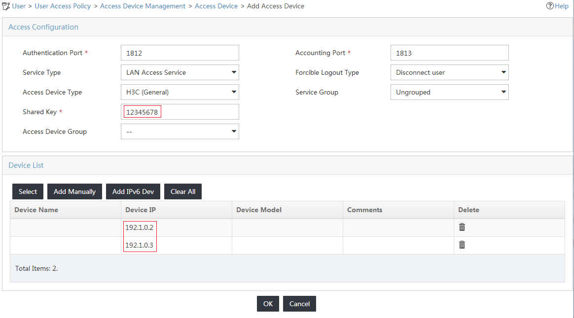

# Set the shared key to 12345678 in plaintext form for communication with the authentication server.
[AC1-radius-office] key authentication simple 12345678
# Set the shared key to 12345678 in plaintext form for communication with the accounting server.
[AC1-radius-office] key accounting simple 12345678
# Specify 192.1.0.2 as the NAS IPv4 address of RADIUS packets.
[AC1-radius-office] nas-ip 192.1.0.2
[AC1-radius-office] quit
# Create ISP domain office and enter its view.
[AC1] domain office
# Perform RADIUS authentication for LAN users based on scheme office.
[AC1-isp-office] authentication lan-access radius-scheme office
# Perform RADIUS authorization for LAN users based on scheme office.
[AC1-isp-office] authorization lan-access radius-scheme office
# Perform RADIUS accounting for LAN users based on scheme office.
[AC1-isp-office] accounting lan-access radius-scheme office
[AC1-isp-office] quit
3. Configure wireless access services:
# Create wireless service template 1 and enter its view.
[AC1] wlan service-template 1
# Set the SSID of the service template to service.
[AC1-wlan-st-1] ssid service
# Assign the service template to VLAN 200.
[AC1-wlan-st-1] vlan 200
# Configure APs to forward client data traffic.
[AC1-wlan-st-1] client forwarding-location ap
# Set the authentication and key management mode to 802.1X.
[AC1-wlan-st-1] akm mode dot1x
# Set the user access authentication mode to 802.1X authentication.
[AC1-wlan-st-1] client-security authentication-mode dot1x
# Specify ISP domain office as the authentication domain for 802.1X clients in service template 1.
[AC1-wlan-st-1] dot1x domain office
# Set the cipher suite to AES-CCMP.
[AC1-wlan-st-1] cipher-suite ccmp
# Enable the RSN IE in beacon and probe responses.
[AC1-wlan-st-1] security-ie rsn
# Enable the service template.
[AC1-wlan-st-1] service-template enable
[AC1-wlan-st-1] quit
4. Configure APs:
IMPORTANT: In a large-scale network, configure AP groups as a best practice. |
# Create AP ap1, and specify its model and serial number.
[AC1] wlan ap ap1 model WA6320
[AC1-wlan-ap-ap1] serial-id 219801A28N819CE0002T
# Create AP group group1, create an AP grouping rule by AP names and an AP grouping rule by AP models, bind wireless service template 1 to radio 1, and enable radio 1.
[AC1] wlan ap-group group1
[AC1-wlan-ap-group-group1] ap ap1
[AC1-wlan-ap-group-group1] ap-model WA6320
[AC1-wlan-ap-group-group1-ap-model-WA6320] radio 1
[AC1-wlan-ap-group-group1-ap-model-WA6320-radio-1] radio enable
[AC1-wlan-ap-group-group1-ap-model-WA6320-radio-1] service-template 1
[AC1-wlan-ap-group-group1-ap-model-WA6320-radio-1] quit
[AC1-wlan-ap-group-group1-ap-model-WA6320] quit
5. Configuring roaming:
# Create mobility group 1 and enter its view.
[AC1] wlan mobility group 1
# Specify 192.1.0.2 as the source IP address for establishing IACTP tunnels.
[AC1-wlan-mg-1] source ip 192.1.0.2
# Configure AC 1 as a member of mobility group 1, and specify 192.1.0.3 as the source IP address for establishing IACTP tunnels.
[AC1-wlan-mg-1] member ip 192.1.0.3
# Enable mobility group 1.
[AC1-wlan-mg-1] group enable
[AC1-wlan-mg-1] quit
6. Configure the default route:
# Configure the next hop of the default route to AC 1 as 192.1.0.1. The default route is used for the communication between AC 1 and the RADIUS server.
[AC1] ip route-static 0.0.0.0 0.0.0.0 192.1.0.1
Configuring AC 2
1. Configure interfaces on AC 2:
# Create VLAN 100 and VLAN-interface 100, and assign IP address 192.1.0.3/16 to the interface. The AC will use this IP address to establish CAPWAP tunnels with APs.
<AC2> system-view
[AC2] vlan 100
[AC2-vlan100] quit
[AC2] interface vlan-interface 100
[AC2-Vlan-interface100] ip address 192.1.0.3 16
[AC2-Vlan-interface100] quit
# Configure interface GigabitEthernet 1/0/1 that connects AC 2 to Switch 3 as an access port, and assign the port to VLAN 100.
[AC2] interface gigabitethernet 1/0/1
[AC2-GigabitEthernet1/0/1] port link-type access
[AC2-GigabitEthernet1/0/1] port access vlan 100
[AC2-GigabitEthernet1/0/1] quit
[AC2] dot1x authentication-method eap
[AC2] radius scheme office
[AC2-radius-office] primary authentication 192.3.0.2
[AC2-radius-office] primary accounting 192.3.0.2
[AC2-radius-office] key authentication simple 12345678
[AC2-radius-office] key accounting simple 12345678
# Specify 192.1.0.3 as the NAS IPv4 address of RADIUS packets.
[AC2-radius-office] nas-ip 192.1.0.3
[AC2-radius-office] quit
[AC2] domain office
[AC2-isp-office] authentication lan-access radius-scheme office
[AC2-isp-office] authorization lan-access radius-scheme office
[AC2-isp-office] accounting lan-access radius-scheme office
[AC2-isp-office] quit
[AC2] wlan service-template 1
[AC2-wlan-st-1] ssid service
# Assign the service template to VLAN 400.
[AC2-wlan-st-1] vlan 400
[AC2-wlan-st-1] client forwarding-location ap
[AC2-wlan-st-1] akm mode dot1x
[AC2-wlan-st-1] client-security authentication-mode dot1x
[AC2-wlan-st-1] dot1x domain office
[AC2-wlan-st-1] cipher-suite ccmp
[AC2-wlan-st-1] security-ie rsn
[AC2-wlan-st-1] service-template enable
[AC2-wlan-st-1] quit
4. Configure APs:
# Create AP ap2, and specify its model and serial number.
[AC2] wlan ap ap2 model WA6320
[AC2-wlan-ap-ap2] serial-id 219801A28N819CE0002U
# Create AP group group2, create an AP grouping rule by AP names and an AP grouping rule by AP models, bind wireless service template 1 to radio 1, and enable radio 1.
[AC2] wlan ap-group group2
[AC2-wlan-ap-group-group2] ap ap2
[AC2-wlan-ap-group-group2] ap-model WA6320
[AC2-wlan-ap-group-group2-ap-model-WA6320] radio 1
[AC2-wlan-ap-group-group2-ap-model-WA6320-radio-1] radio enable
[AC2-wlan-ap-group-group2-ap-model-WA6320-radio-1] service-template 1
[AC2-wlan-ap-group-group2-ap-model-WA6320-radio-1] quit
[AC2-wlan-ap-group-group2-ap-model-WA6320] quit
[AC2] wlan mobility group 1
# Specify 192.1.0.3 as the source IP address for establishing IACTP tunnels.
[AC2-wlan-mg-1] source ip 192.1.0.3
# Configure AC 2 as a member of mobility group 1, and specify 192.1.0.2 as the source IP address for establishing IACTP tunnels.
[AC2-wlan-mg-1] member ip 192.1.0.2
[AC2-wlan-mg-1] group enable
[AC2-wlan-mg-1] quit
# Configure the next hop of the default route to AC 2 as 192.1.0.1. The default route is used for the communication between AC 2 and the RADIUS server.
[AC2] ip route-static 0.0.0.0 0.0.0.0 192.1.0.1

[Switch3-GigabitEthernet1/0/5] quit
2. Configure the DHCP server:
# Enable DHCP.

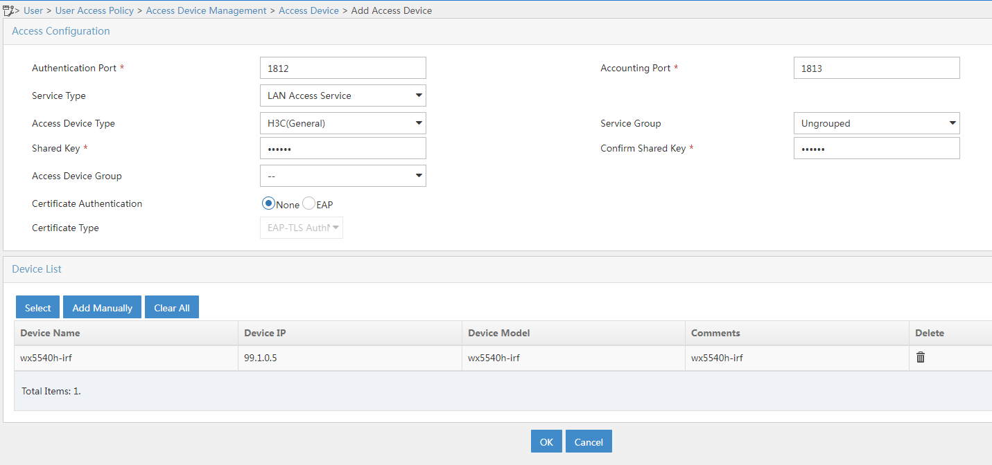

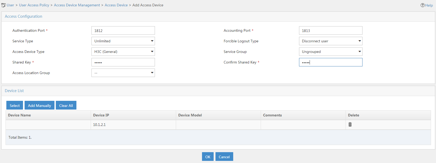

1. Add the ACs to the IMC Platform as access devices:
a. Log in to IMC.
b. Click the User tab.
c. From the navigation tree, select User Access Policy > Access Device Management > Access Device.
d. Click Add to add AC 1 and AC 2 as access devices.
e. Configure the following parameters:
- Enter 192.1.0.2 for AC 1 and 192.1.0.3 for AC 2 in the Device IP field.
- Enter 12345678 in the Shared Key field.
- Use the default settings for other parameters.
f. Click OK.
Figure 2 Adding access devices

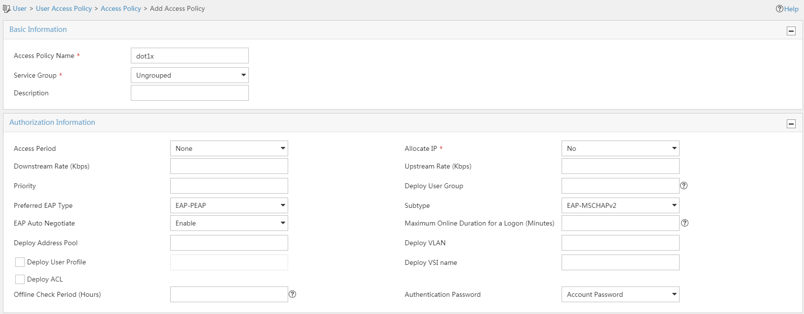

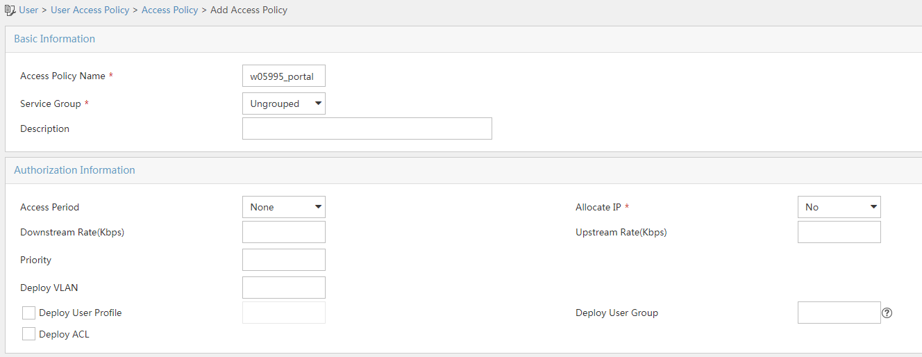

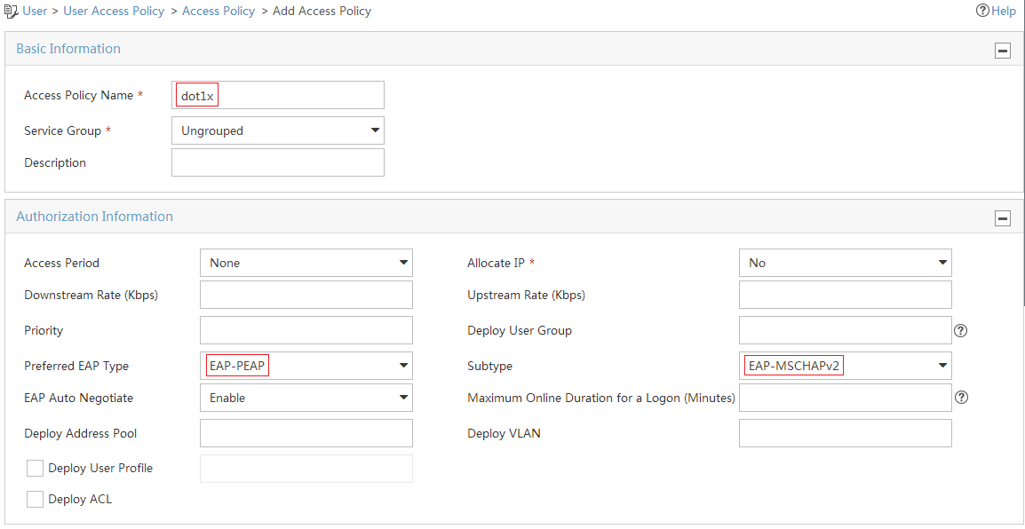

2. Add an access policy:
a. Click the User tab.
b. From the navigation tree, select User Access Policy > Access Policy.
c. Click Add to add an access policy that uses the following settings:
- Access Policy Name—dot1x.
- Preferred EAP Type—EAP-PEAP.
- Subtype—MS-CHAPV2. The subtype must match the client authentication method.
Figure 3 Adding an access policy

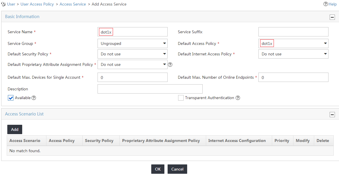

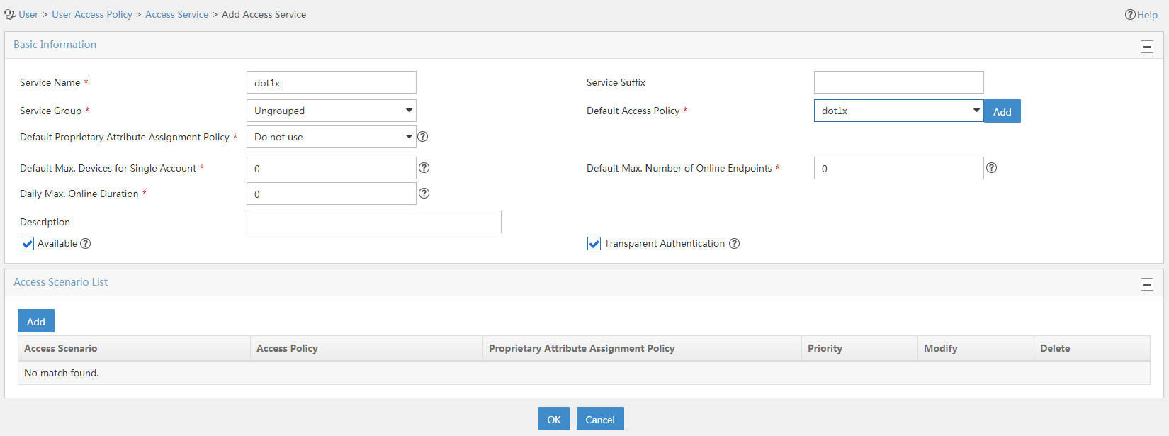

3. Add an access service:
b. From the navigation tree, select User Access Policy > Access Service.
c. Click Add to add an access service that uses the following settings:
- Service Name—dot1x.
- Default Access Policy—dot1x.
Figure 4 Adding an access service

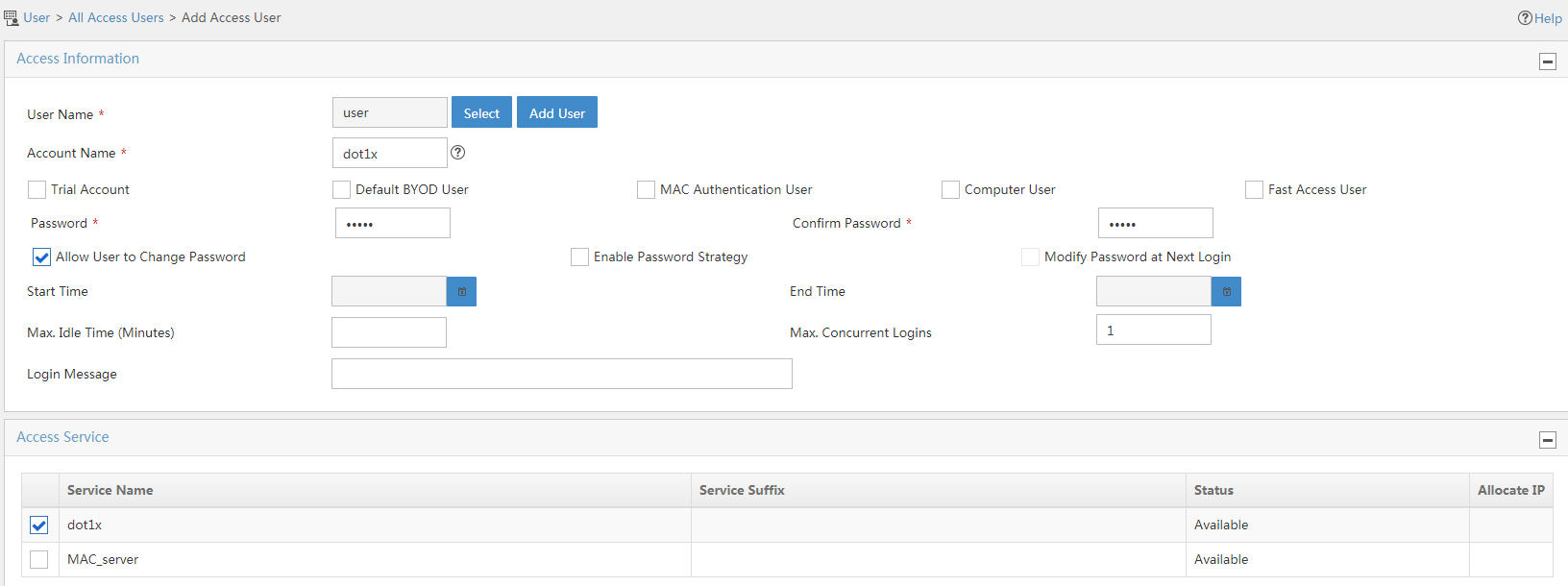

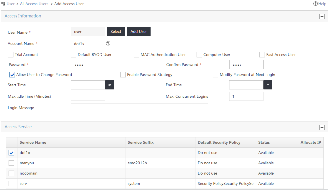

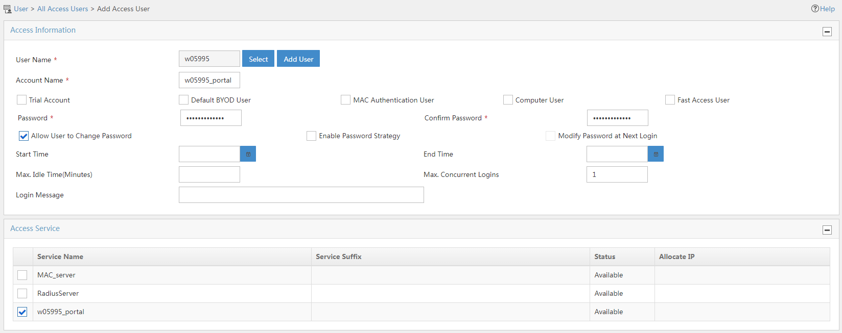

4. Add an access user:
b. From the navigation tree, select All Access Users.
c. Click Add to add an access user that uses the following settings:
- User Name—user.
- Account Name—dot1x.
- Password—dot1x.
d. Select the dot1x service for the user.
Figure 5 Adding an access user
# Make the client come online from AP 1. (Details not shown.)
# On AC 1, verify that the client is associated with AP 1.

# Make the client roam to AP 2.
# On AC 2, verify that the client is associated with AP 2.

# Verify that clients in VLAN 200 and VLAN 400 can access the Internet but cannot access a client in the same VLAN. (Details not shown.)
