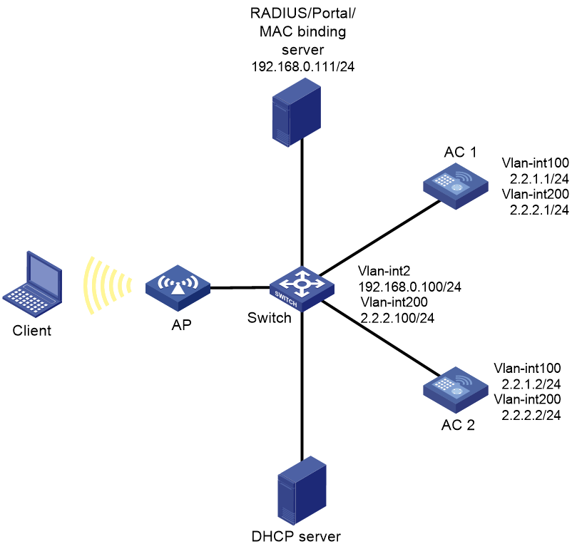

As shown in Figure 1:
· The AP and the client obtain IP addresses from the DHCP server.
· The network deploys an IMC server as the portal authentication server, portal Web server, MAC binding server, and RADIUS server.
Configure the devices to meet the following requirements:
· The ACs operate in active/standby mode. When AC 1 (the master AC) fails, the AP associates with AC 2 (the backup AC). When AC 1 recovers, the AP re-associates with AC 1.
· The ACs use a service template to provide OAuth-based portal MAC-trigger authentication for the client. Before passing the authentication, the client can access only the portal Web server. After passing the authentication, the client can access other network resources. If the client goes offline and then attempts to come online again, the client does not need to enter the username and password.
· The AP forwards the client traffic locally.
· The client can access network resources through any Layer 2 ports in its access VLAN without re-authentication.
· The RADIUS server can dynamically change user authorization information or forcibly disconnect users.

Configuring AC 1
1. Configure interfaces:
# Create VLAN 100, create VLAN-interface 100, and then assign the VLAN interface an IP address. The AC will use this IP address to establish CAPWAP control and data tunnels with the AP.

Configuring AC 2
<AC2> system-view

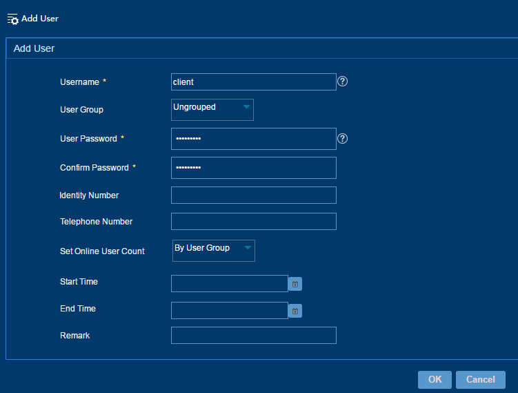

1. Add an access user:
a. Log in to IMC and click the Service tab.
b. From the navigation tree, select Intelligent Portal Management > User Management > Users.
c. Click Add to open the Add User page.
d. Enter username client and password admin@123.
e. Use the default settings for other parameters.
f. Click OK.

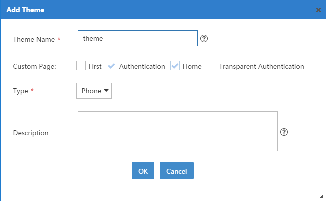

2. Add an authentication page template:
a. From the navigation tree, select Intelligent Portal Management > Page Template List.
b. Click Add to open the Add Theme page.
c. Enter template name theme in the Theme Name field.
d. Use the default settings for other parameters.
e. Click OK to open the page for editing the template.
Figure 3 Adding an authentication page template

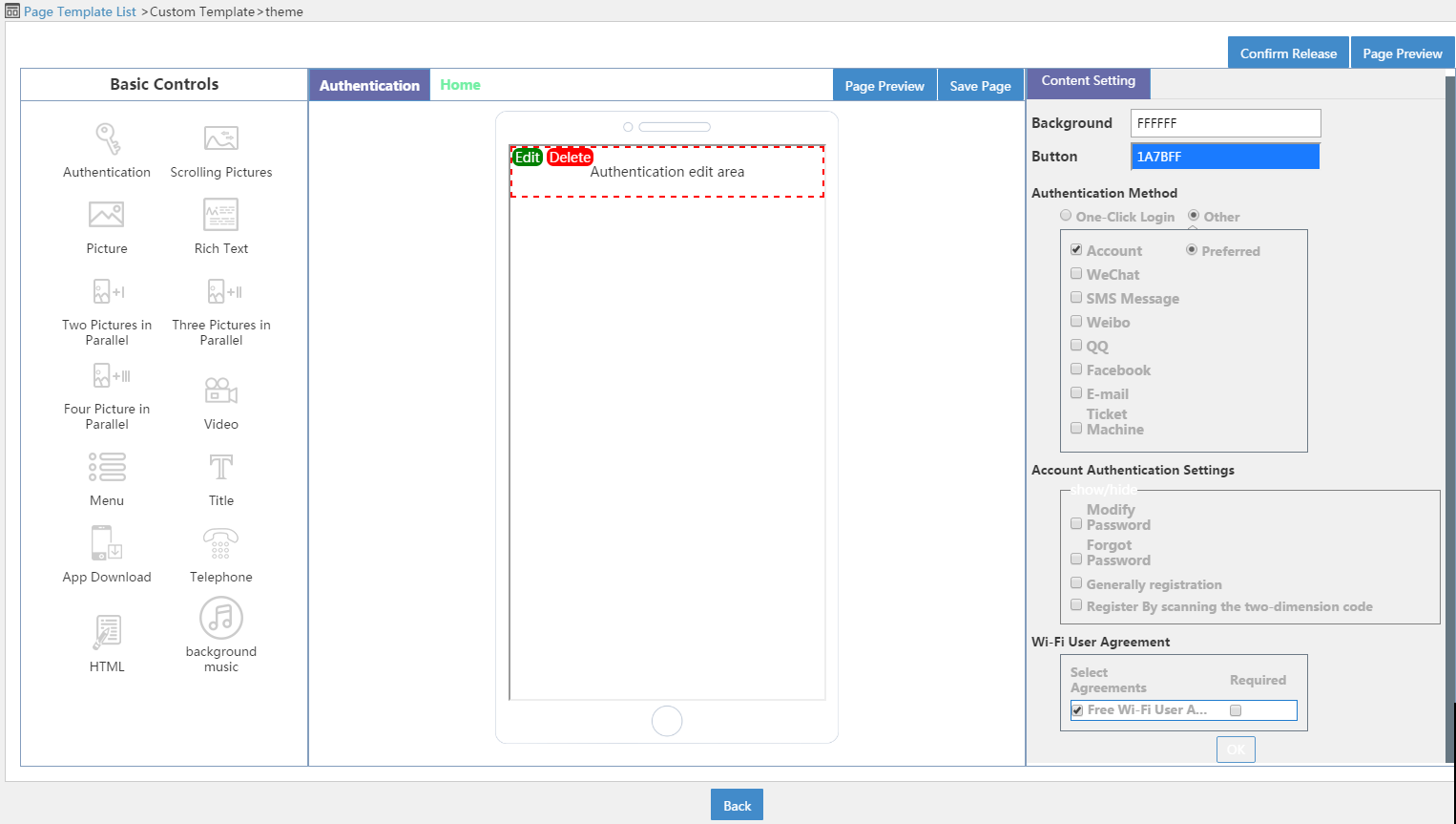

f. On the theme page, click
the Authentication icon in
the Basic Controls area.
g. Click Edit in authentication edit area, select Other and Account in the Authentication Method area, click OK, and then click Save Page.
h. Use the default settings for other configuration.
i. Click Confirm Release.

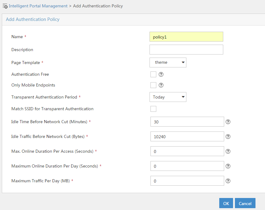

3. Add an authentication policy:
a. From the navigation tree, select Intelligent Portal Management > Authentication Policies.
b. Click Add to open the Add Authentication Policy page.
c. Enter authentication policy name policy1, and select theme from the Page Template list.
d. Select a transparent authentication period to enable portal transparent authentication (MAC-trigger authentication).
f. Click OK.

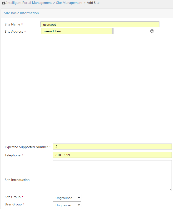

4. Add a site:
a. From the navigation tree, select Intelligent Portal Management > Site Management.
b. Click Add to open the Add Site page.
c. Enter the site name, the site address, the expected number of clients to be supported, and the telephone number.
d. Click OK.
Figure 6 Adding a site

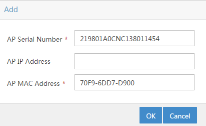

e. In the Associated APs area, click Add to associate an AP.
f. Enter the serial number and MAC address of the AP.
g. Click OK.
Figure 7 Adding an AP

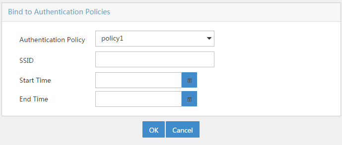

i. In the Bind Authentication Policy area, click Add to bind the AP to an authentication policy.
j. Select authentication policy policy1.
k. Use the default settings for other parameters.
l. Click OK.
Figure 8 Binding the AP to an authentication policy
