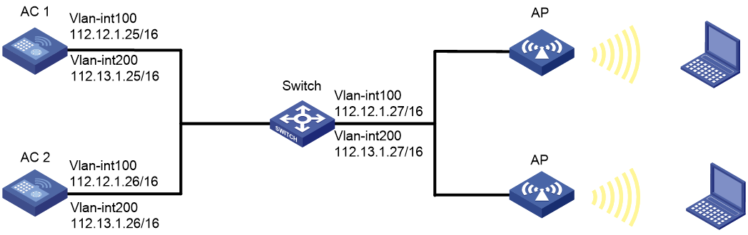

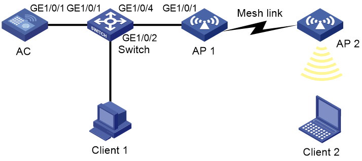

Network requirements
As shown in Figure 1, the APs connect to AC 1 and AC 2 through the switch and the APs provide wireless service for clients. Set the SSID to service and enable AP license synchronization on AC 1 and AC 2. The two ACs back up licenses for each other.
When the master AC fails, the backup AC will take over and becomes the new master AC. The licenses synchronized to the new master AC will be valid for a 30-day grace period.

Configuring the AC 2
1. Configure interfaces on the AC 2:
# Configure VLAN-interface 100 and assign it an IP address. The AC 2 will use this IP address to establish CAPWAP tunnels with APs.
<AC2> system-view
[AC2] vlan 100
[AC2-vlan100] quit
[AC2] interface vlan-interface 100
[AC2-Vlan-interface100] ip address 112.12.1.26 16
[AC2-Vlan-interface100] quit
# Configure VLAN-interface 200 and assign it an IP address. The AC 2 will use VLAN 200 for client access.
[AC2] vlan 200
[AC2-vlan200] quit
[AC2] interface vlan-interface 200
[AC2-Vlan-interface200] ip address 112.13.1.26 16
[AC2-Vlan-interface200] quit
# Configure GigabitEthernet 1/0/1 that connects the AC 2 to the switch as a trunk port.
[AC2] interface gigabitethernet1/0/1
[AC2-GigabitEthernet1/0/1] port link-type trunk
# Remove the trunk port from VLAN 1, and assign the port to VLANs 100 and 200.
[AC2-GigabitEthernet1/0/1] undo port trunk permit vlan 1
[AC2-GigabitEthernet1/0/1] port trunk permit vlan 100 200
[AC2-GigabitEthernet1/0/1] quit
# Enable AP license synchronization on AC 2 and configure AC 2 as the master AC.
[AC2] wlan ap-license-group
[AC2-wlan-ap-license-group] local ip 112.12.1.26
[AC2-wlan-ap-license-group] member ip 112.12.1.25
[AC2-wlan-ap-license-group] ap-license-synchronization enable
[AC2-wlan-ap-license-group] quit
2. Configure the wireless service:
# Create wireless service template service and enter its view.
[AC2] wlan service-template service
# Set the SSID to service.
[AC2-wlan-st-service] ssid service
# Assign clients coming online through service template service to VLAN 200.
[AC2-wlan-st-service] vlan 200
# Set the AKM mode to PSK, and specify the plaintext preshared key as 12345678.
[AC2-wlan-st-service] akm mode psk
[AC2-wlan-st-service] preshared-key pass-phrase simple 12345678
# Set the cipher suite to CCMP and set the security IE to RSN.
[AC2-wlan-st-service] cipher-suite ccmp
[AC2-wlan-st-service] security-ie rsn
# Configure the AC to forward client data traffic. If the AC acts as the client traffic forwarder by default, skip this step.
[AC2-wlan-st-service] client forwarding-location ac
# Enable service template service.
[AC2-wlan-st-service] service-template enable
[AC2-wlan-st-service] quit
3. Configure the AP:
NOTE: In a large-scale network, configure AP settings in AP group view instead of AP view as a best practice. |
# Create AP ap1, and specify the AP model and serial ID.
[AC2] wlan ap ap1 model WA6320
[AC2-wlan-ap-ap1] serial-id 219801A28N819CE0002T
[AC2-wlan-ap-ap1] quit
# Create AP group group1, and configure a grouping rule by AP name to add AP ap1 to the group.
[AC2] wlan ap-group group1
[AC2-wlan-ap-group-group1] ap ap1
# Bind service template service to radio 1, and enable radio 1.
[AC2-wlan-ap-group-group1] ap-model WA6320
[AC2-wlan-ap-group-group1-ap-model-WA6320] radio 1
[AC2-wlan-ap-group-group1-ap-model-WA6320-radio-1] service-template service
[AC2-wlan-ap-group-group1-ap-model-WA6320-radio-1] radio enable
[AC2-wlan-ap-group-group1-ap-model-WA6320-radio-1] quit
[AC2-wlan-ap-group-group1-ap-model-WA6320] quit
[AC2-wlan-ap-group-group1] quit
Configuring the switch
# Create VLAN 100 and VLAN 200. The switch will use VLAN 100 to forward the traffic on CAPWAP tunnels between the AC and APs, and will use VLAN 200 to forward client traffic.
<Switch> system-view
[Switch] vlan 100
[Switch-vlan100] quit
[Switch] vlan 200
[Switch-vlan200] quit
# Configure GigabitEthernet 1/0/1 that connects the switch to the AC 1 as a trunk port.
[Switch] interface gigabitethernet1/0/1
[Switch-GigabitEthernet1/0/1] port link-type trunk
# Remove the trunk port from VLAN 1, and assign the port to VLAN 100 and VLAN 200.
[Switch-GigabitEthernet1/0/1] undo port trunk permit vlan 1
[Switch-GigabitEthernet1/0/1] port trunk permit vlan 100 200
[Switch-GigabitEthernet1/0/1] quit
# Configure GigabitEthernet 1/0/2 that connects the switch to the AC 2 as a trunk port.
[Switch] interface gigabitethernet1/0/2
[Switch-GigabitEthernet1/0/2] port link-type trunk
[Switch-GigabitEthernet1/0/2] undo port trunk permit vlan 1
[Switch-GigabitEthernet1/0/2] port trunk permit vlan 100 200
[Switch-GigabitEthernet1/0/2] quit
# Configure the interface GigabitEthernet 1/0/3 that is connected to APs as an access port, and assign the port to VLAN 100.
[Switch] interface gigabitethernet1/0/3
[Switch-GigabitEthernet1/0/3] port link-type access
[Switch-GigabitEthernet1/0/3] port access vlan 100
# Enable PoE on GigabitEthernet 1/0/3.
[Switch-GigabitEthernet1/0/3] poe enable
[Switch-GigabitEthernet1/0/3] quit
# Specify 112.12.1.27/16 as the IP address of the VLAN 100.
[Switch-Vlan-interface100] ip address 112.12.1.27 16
# Specify 112.13.1.27/16 as the IP address of the VLAN 200.
[Switch] interface vlan-interface 200
[Switch-Vlan-interface200] ip address 112.13.1.27 16
[Switch-Vlan-interface200] quit
# Enable DHCP.
[Switch] dhcp enable
# Create DHCP IP pool 100 to assign IP addresses to APs, and specify the IP address range for the IP pool.
[Switch] dhcp server ip-pool 100
[Switch-dhcp-pool-100] network 112.12.0.0 mask 255.255.0.0
# Specify gateway IP address 112.12.1.27 in the DHCP IP pool.
[Switch-dhcp-pool-100] gateway-list 112.12.1.27
[Switch-dhcp-pool-100] quit
# Create DHCP IP pool 200 to assign IP addresses to clients, and specify the IP address range for the DHCP IP pool.
[Switch] dhcp server ip-pool 200
[Switch-dhcp-pool-200] network 112.13.0.0 mask 255.255.255.0
# Specify gateway IP address 112.13.1.27 in the DHCP IP pool.
[Switch-dhcp-pool-200] gateway-list 112.13.1.27
# Specify the DNS server according to the actual network plan. In this example, the gateway is specified as the DNS server.
[Switch-dhcp-pool-200] dns-list 112.13.1.27
[Switch-dhcp-pool-200] quit
1. Display AP license synchronization group information on AC 1.
<AC1> display wlan ap-license-group
Group total licenses: 32
Group used licenses: 2
AP license synchronization: Enabled
Local IP: 112.12.1.25
Local role: Master
Member information:
IP address Total Used Member role State Online duration
112.12.1.26 16 0 Master UP 10hr 22min 04sec
2. Display AP license synchronization group information on AC 2.
<AC2> display wlan ap-license-group
Local IP: 112.12.1.26
Local role: Master
Member information:
112.12.1.25 16 2 Master UP 10hr 22min 04sec
3. When AC 2 fails, AC 1 takes over and the sum of licenses remains 32.
Local role: Master
Member information:
112.12.1.26 16 0 Master DOWM 00hr 00min 00sec
