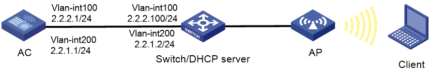

Example: Configuring auto-DFS and auto-TPC

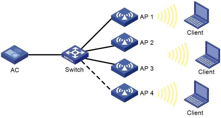

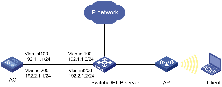

As shown in Figure 1, in centralized forwarding mode, the AC is connected to the switch, and the switch assigns an IP address to the AP and clients as a DHCP server. Configure auto-DFS and auto-TPC for the AP to change the working channel and transmit power automatically based on the wireless environment.

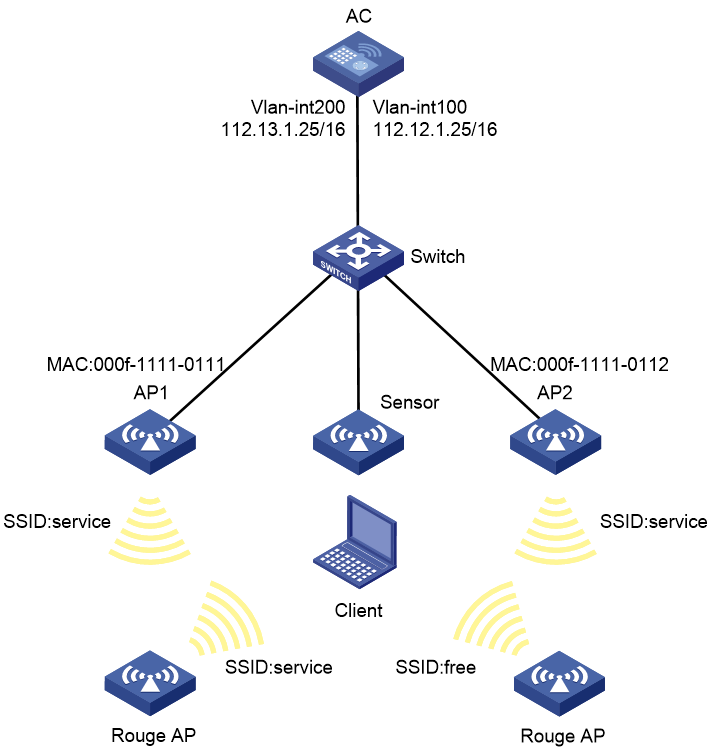

[AC-wlan-st-service] security-ie rsn
# Configure the AC to forward client data traffic. You can skip this step if the AC is the client traffic forwarder by default.
[AC-wlan-st-service] client forwarding-location ap
# Enable the service template.
[AC-wlan-st-service] service-template enable
[AC-wlan-st-service] quit
3. Configure an AP:
# Create a manual AP named ap1, and specify the AP model and serial ID.
[AC] wlan ap ap1 model WA6330
[AC-wlan-ap-ap1] serial-id 219801A23V8192E00021
# Create AP group group1, add the AP to the AP group, and specify the AP model.
[AC] wlan ap-group group1
[AC-wlan-ap-group-group1] ap ap1
[AC-wlan-ap-group-group1] ap-model WA6330
# Enter the view of radio 1.
[AC-wlan-ap-group-group1-ap-model-WA6330] radio 1
# Set the bandwidth mode to 40 MHz.
[AC-wlan-ap-group-group1-ap-model-WA6330-radio-1]channel band-width 40
# Bind WLAN service template service to radio 1 and enable the radio.
[AC-wlan-ap-group-group1-ap-model-WA6330-radio-1] service-template service
[AC-wlan-ap-group-group1-ap-model-WA6330-radio-1] radio enable
[AC-wlan-ap-group-group1-ap-model-WA6330-radio-1] quit
[AC-wlan-ap-group-group1-ap-model-WA6330] quit
[AC-wlan-ap-group-group1] quit
# Configure AP 2, AP 3, and AP 4 in the same way AP 1 is configured.
4. Configure auto-DFS and auto-TPC:
# Enter global configuration view.
[AC] wlan global-configuration
# Enable auto-TPC.
[AC-wlan-global-configuration] calibrate-power self-decisive enable all
# Enable auto-DFS.
[AC-wlan-global-configuration] calibrate-channel self-decisive enable all
[AC-wlan-global-configuration] quit
[AC] quit
Configure the switch
# Create VLAN 100. The switch will use this VLAN to forward the traffic on the CAPWAP tunnels between the AC and AP.
<Switch> system-view
[Switch] vlan 100
[Switch-vlan100] quit
# Create VLAN 200. The switch will use this VLAN to forward packets for wireless clients.
[Switch] vlan 200
[Switch-vlan200] quit
# Configure GigabitEthernet 1/0/1 that connects the switch to the AC as a trunk port, and assign the trunk port to VLAN1, VLAN 100, and VLAN 200.
[Switch] interface gigabitethernet 1/0/1
[Switch-GigabitEthernet1/0/1] port link-type trunk
[Switch-GigabitEthernet1/0/1] port trunk permit vlan 1 100 200
[Switch-GigabitEthernet1/0/1] quit
# Configure GigabitEthernet 1/0/2 that connects the switch to the APs as an access port, and assign the access port to VLAN 100.
[Switch] interface range gigabitethernet 1/0/2 to gigabitethernet 1/0/5
[Switch-if-range] port link-type access
[Switch-if-range] port access vlan 100
# Enable the PoE feature.
[Switch-if-range] poe enable
[Switch-if-range] quit
# Specify an IP address for VLAN-interface 100.
[Switch-Vlan-interface100] ip address 192.1.0.2 16
# Specify an IP address for VLAN-interface 200.
[Switch] interface vlan-interface 200
[Switch-Vlan-interface200] ip address 192.2.0.2 24
[Switch-Vlan-interface200] quit
# Enable DHCP.
[Switch] dhcp enable
# Create DHCP address pool 100. Specify the 192.1.0.0/16 subnet and the 192.1.0.1 gateway for the pool.
[Switch] dhcp server ip-pool 100
[Switch-dhcp-pool-100] network 192.1.0.0 mask 255.255.0.0
[Switch-dhcp-pool-100] gateway-list 192.1.0.1
[Switch-dhcp-pool-100] quit
# Create DHCP address pool 200. Specify the 192.2.0.0/16 subnet and the 192.2.0.1 gateway for the pool.
[Switch] dhcp server ip-pool 200
[Switch-dhcp-pool-200] network 192.2.0.0 mask 255.255.255.0
[Switch-dhcp-pool-200] gateway-list 192.2.0.1
[Switch-dhcp-pool-200] quit
1. View AP registration information on the AC:
# Verify that the APs have been associated with the AC. If the APs are in R/M state, the APs have been associated with the AC.
<AC> display wlan ap all
AP information
State : I = Idle, J = Join, JA = JoinAck, IL = ImageLoad
C = Config, DC = DataCheck, R = Run, M = Master, B = Backup
AP name APID State Model Serial ID
ap1 1 R/M WA6330 219801A23V8192E00021
ap2 2 R/M WA6330 219801A23V8192E00022
ap3 3 R/M WA6330 219801A23V8192E00023
ap4 4 R/M WA6330 219801A23V8192E00024

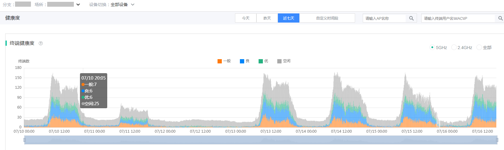

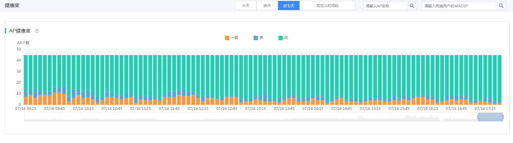

3. (Optional.) Connect the AC to the Cloudnet platform to view AP and client statistics.
# View the health status of clients to identify whether the number of clients with a health score of excellent and good has increased.
Figure 2 Client health status
# View the health status of APs to identify whether the number of APs with a health score of excellent and good has increased.
Figure 3 AP health status
