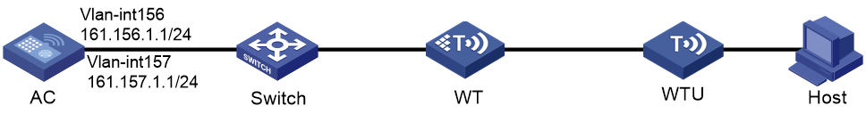

Network requirements
As shown in Figure 1, the AC connects to the WT through the switch and the WT connects to the host through the wireless terminator unit (WTU). The AC acts as a DHCP server to assign IP addresses to the WT and host. The WTU runs in version 2 and supports wireless and wired connection.

[Switch-vlan156] quit
[Switch] interface vlan-interface 156
[Switch-Vlan-interface156] ip address 161.156.1.2 24
[Switch-Vlan-interface156] quit
# Create VLAN 157 and assign an IP address to VLAN-interface 157. The VLAN will be used to forward client traffic.
[Switch] vlan 157
[Switch-vlan157] quit
[Switch] interface vlan-interface 157
[Switch-Vlan-interface157] ip address 161.157.1.2 24
[Switch-Vlan-interface157] quit
# Configure GigabitEthernet 1/0/1 that connects the switch to the AC as a trunk port, and assign the port to VLANs 156 and 157.
[Switch] interface gigabitethernet 1/0/1
[Switch-GigabitEthernet1/0/1] port link-type trunk
[Switch-GigabitEthernet1/0/1] port trunk permit vlan 156 157
[Switch-GigabitEthernet1/0/1] quit
# Configure GigabitEthernet 1/0/2 that connects the switch to the WT as a trunk port, assign the port to VLANs 156 and 157, and set the PVID to 156.
[Switch] interface gigabitethernet 1/0/2
[Switch-GigabitEthernet1/0/2] port link-type trunk
[Switch-GigabitEthernet1/0/2] port trunk permit vlan 156 157
[Switch-GigabitEthernet1/0/2] port trunk pvid vlan 156
[Switch-GigabitEthernet1/0/2] quit
5. Edit the WT configuration file:
# Edit the WT configuration file map.txt and upload it to the AC storage medium via FTP or TFTP. The content and format of the configuration file are as follows:
vlan 157
interface Ten-GigabitEthernet 1/0/1
port trunk permit vlan 157
# Enable WT preprovisioning to issue the settings to the WTU.
slot 1
provision model WTU420H
interface range Ethernet 1/1/1 to Ethernet 1/1/4
port access vlan 157
# Verify that you can see the following information:
· The WT and WTU obtain the IP address of the AC through DHCP.
· The WT, WTU, and the AC have established a CAPWAP tunnel.
· The WT and WTU are in Run state.
[AC] display wlan ap all
Total number of APs: 2
Total number of connected APs: 2
Total number of connected manual APs: 2
Total number of connected auto APs: 0
Total number of connected common APs: 0
Total number of connected WTUs: 1
Total number of inside APs: 0
Maximum supported APs: 3072
Remaining APs: 3071
Total AP licenses: 640
Local AP licenses: 640
Server AP licenses: 0
Remaining Local AP licenses: 639.75
Sync AP licenses: 0
AP information
State : I = Idle, J = Join, JA = JoinAck, IL = ImageLoad
C = Config, DC = DataCheck, R = Run, M = Master, B = Backup
AP name APID State Model Serial ID
ap1 7 R/M WT1024-X-EI 219801A1ARC178000322
ap2 145 R/M WTU420H 219801A0WA916BQ20133
# On the AC, display the IP addresses assigned to the clients.
[AC] display dhcp server ip-in-use pool 157
IP address Client identifier/ Lease expiration Type
Hardware address
161.157.1.3 01f0-921c-ef67-49 Apr 10 15:16:57 2018 Auto(C)
# Verify that the AC and the WTU can reach each other.
[AC] ping 161.157.1.3
Ping 161.157.1.3 (161.157.1.3): 56 data bytes, press CTRL_C to break
56 bytes from 161.157.1.3: icmp_seq=0 ttl=128 time=1.883 ms
56 bytes from 161.157.1.3: icmp_seq=1 ttl=128 time=0.826 ms
56 bytes from 161.157.1.3: icmp_seq=2 ttl=128 time=0.846 ms
56 bytes from 161.157.1.3: icmp_seq=3 ttl=128 time=1.039 ms
56 bytes from 161.157.1.3: icmp_seq=4 ttl=128 time=1.046 ms
--- Ping statistics for 161.157.1.3 ---
round-trip min/avg/max/std-dev = 0.826/1.128/1.883/0.389 ms
