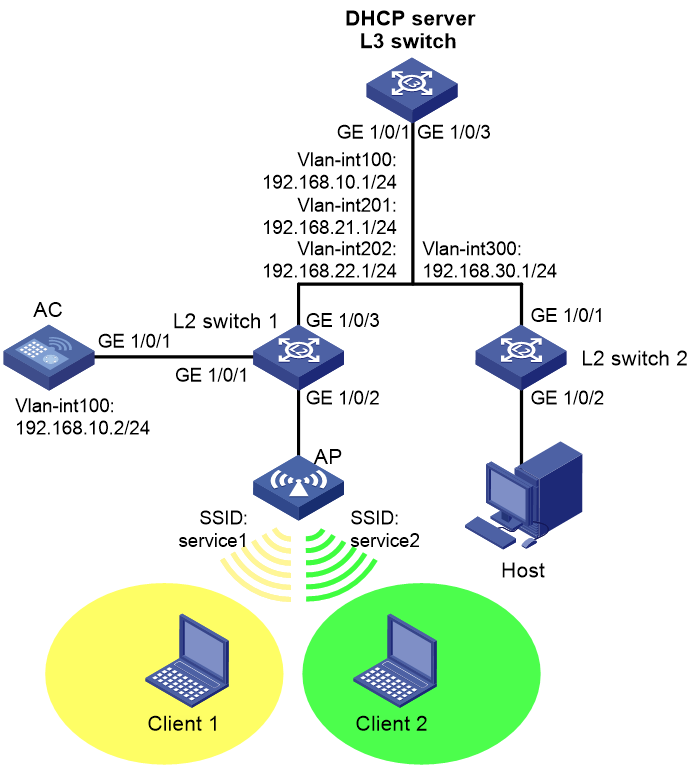

As shown in Figure 1, the AC connects to Layer 2 switch 1 and the Layer 3 switch acts as a DHCP server to assign IP addresses to the AP, the host, and the clients. Radio 1 and radio 2 of the AP operates at 5GHz band and 2.4 GHz band, respectively.
Configure network settings to meet the following requirements:
· Client 1 accesses WLAN service1 over VLAN 201.
· Client 2 accesses WLAN service2 over VLAN 202.
· The host accesses the network over VLAN 300.
· The AC and the AP communicate with each other over VLAN 100.
· Layer 2 switch 1 supplies power to the AP through PoE.

· For the Layer 3 switch to act as a DHCP server, enable the DHCP server feature on the switch.
· For Layer 2 switch 1 to supply power to the AP, enable the PoE feature on the switch.
· For the clients to ping the host through different WLANs, configure service templates with different SSIDs on the AC.
When you configure a serial ID for the AP, use the serial ID labeled on the AP's rear panel.

[L3 switch] interface gigabitEthernet 1/0/1
[L3 switch-GigabitEthernet1/0/1] port link-type trunk
[L3 switch-GigabitEthernet1/0/1] undo port trunk permit vlan 1
[L3 switch-GigabitEthernet1/0/1] port trunk permit vlan 100 201 202
[L3 switch-GigabitEthernet1/0/1] quit
# Set the link type of GigabitEthernet 1/0/3 that connects the switch to Layer 2 switch 2 to trunk. Remove the port from VLAN 1 and assign the port to VLAN 300.
[L3 switch] interfac gigabitEthernet 1/0/3
[L3 switch-GigabitEthernet1/0/3] port link-type trunk
[L3 switch-GigabitEthernet1/0/3] undo port trunk permit vlan 1
[L3 switch-GigabitEthernet1/0/3] port trunk permit vlan 300
[L3 switch-GigabitEthernet1/0/3] quit
2. Configure the DHCP server feature:
# Enable DHCP server.
[L3 switch] dhcp enable
# Create DHCP address pool 1 for dynamic IP allocation to the AP. Specify 192.168.10.0/24 as the subnet and 192.168.10.1 as the gateway address in the address pool.
[L3 switch] dhcp server ip-pool 1
[L3 switch-dhcp-pool-1] network 192.168.10.0 mask 255.255.255.0
[L3 switch-dhcp-pool-1] gateway-list 192.168.10.1
# Exclude the IP address of VLAN-interface 100 on the AC from dynamic IP allocation in DHCP address pool 1.
[L3 switch-dhcp-pool-1] forbidden-ip 192.168.10.2
[L3 switch-dhcp-pool-1] quit
# Create DHCP address pool 2 for dynamic IP allocation to Client 1. Specify 192.168.21.0/24 as the subnet and 192.168.21.1 as the gateway address in the address pool, and then specify the address of the DNS server. In this example, the gateway also acts as the DNS server.
[L3 switch] dhcp server ip-pool 2
[L3 switch-dhcp-pool-2] network 192.168.21.0 mask 255.255.255.0
[L3 switch-dhcp-pool-2] gateway-list 192.168.21.1
[L3 switch-dhcp-pool-2] dns-list 192.168.21.1
[L3 switch-dhcp-pool-2] quit
# Create DHCP address pool 3 for dynamic IP allocation to Client 2. Specify 192.168.22.0/24 as the subnet and 192.168.22.1 as the gateway address in the address pool, and then specify the address of the DNS server. In this example, the gateway also acts as the DNS server.
[L3 switch] dhcp server ip-pool 3
[L3 switch-dhcp-pool-3] network 192.168.22.0 mask 255.255.255.0
[L3 switch-dhcp-pool-3] gateway-list 192.168.22.1
[L3 switch-dhcp-pool-3] dns-list 192.168.22.1
[L3 switch-dhcp-pool-3] quit
# Create DHCP address pool 4 for dynamic IP allocation to the host. Specify 192.168.30.0/24 as the subnet and 192.168.30.1 as the gateway address in the address pool, and then specify the address of the DNS server. In this example, the gateway also acts as the DNS server.
[L3 switch] dhcp server ip-pool 4
[L3 switch-dhcp-pool-4] network 192.168.30.0 mask 255.255.255.0
[L3 switch-dhcp-pool-4] gateway-list 192.168.30.1
[L3 switch-dhcp-pool-4] dns-list 192.168.30.1
[L3 switch-dhcp-pool-4] quit
Configuring the AC
1. Configure AC interfaces:
# Create VLAN 100 and VLAN-interface 100, and assign IP address 192.168.10.2 to the interface. The AC will establish a CAPWAP tunnel with the AP in this VLAN.
<AC> system-view
[AC] vlan 100
[AC-vlan100] quit
[AC] interface vlan-interface 100
[AC-Vlan-interface100] ip address 192.168.10.2 255.255.255.0
[AC-Vlan-interface100] quit
# Create VLAN 201. Client 1 will use this VLAN to access the WLAN.
[AC] vlan 201
[AC-vlan201] quit
# Create VLAN 202. Client 2 will use this VLAN to access the WLAN.
[AC] vlan 202
[AC-vlan202] quit
# Set the link type of GigabitEthernet 1/0/1 that connects the AC to Layer 2 switch 1 to trunk. Remove the port from VLAN 1 and assign the port to VLANs 100, 201, and 202.
[AC] interface gigabitethernet 1/0/1
[AC-GigabitEthernet1/0/1] port link-type trunk
[AC-GigabitEthernet1/0/1] undo port trunk permit vlan 1
[AC-GigabitEthernet1/0/1] port trunk permit vlan 100 201 202
[AC-GigabitEthernet1/0/1] quit
2. Configure wireless services:
# Create service template 1 and enter its view.
[AC] wlan service-template 1
# Set the SSID to service1.
[AC-wlan-st-1] ssid service1
# Specify the AKM mode as PSK, and specify plaintext string 12345678 as the preshared key.
[AC-wlan-st-1] akm mode psk
[AC-wlan-st-1] preshared-key pass-phrase simple 12345678
# Specify the cipher suite as CCMP and the security IE as RSN.
[AC-wlan-st-1] cipher-suite ccmp
[AC-wlan-st-1] security-ie rsn
# Configure the AC to forward client data traffic. You can skip this step if the AC is the client traffic forwarder by default.
[AC-wlan-st-1] client forwarding-location ac
# Enable service template 1.
[AC-wlan-st-1] service-template enable
[AC-wlan-st-1] quit
# Create service template 2 and enter its view.
[AC] wlan service-template 2
# Set the SSID to service2.
[AC-wlan-st-2] ssid service2
# Specify the AKM mode as PSK for service template 2, and specify plaintext string abcdefg as the preshared key.
[AC-wlan-st-2] akm mode psk
[AC-wlan-st-2] preshared-key pass-phrase simple abcdefgh
[AC-wlan-st-2] cipher-suite ccmp
[AC-wlan-st-2] security-ie rsn
[AC-wlan-st-2] client forwarding-location ac
# Enable service template 2.
[AC-wlan-st-2] service-template enable
[AC-wlan-st-2] quit
3. Configure AP settings:
NOTE: In large-scale networks, configure AP groups instead of single APs as a best practice. |
# Create AP officeap, and specify the AP model and serial ID.
[AC] wlan ap officeap model WA6320
[AC-wlan-ap-officeap] serial-id 219801A28N819CE0002T
[AC-wlan-ap-officeap] quit
# Create AP group group1 and add the AP to the AP group.
[AC] wlan ap-group group1
[AC-wlan-ap-group-group1] ap officeap
# Bind service template 1 and VLAN 201 to radio 1.
[AC-wlan-ap-group-group1] ap-model WA6320
[AC-wlan-ap-group-group1-ap-model-WA6320] radio 1
[AC-wlan-ap-group-group1-ap-model-WA6320-radio-1] service-template 1 vlan 201
# Enable radio 1.
[AC-wlan-ap-group-group1-ap-model-WA6320-radio-1] radio enable
[AC-wlan-ap-group-group1-ap-model-WA6320-radio-1] quit
# Bind service template 2 and VLAN 202 to radio 2.
[AC-wlan-ap-group-group1-ap-model-WA6320] radio 2
[AC-wlan-ap-group-group1-ap-model-WA6320-radio-2] service-template 2 vlan 202
# Enable radio 2.
[AC-wlan-ap-group-group1-ap-model-WA6320-radio-2] radio enable
[AC-wlan-ap-group-group1-ap-model-WA6320-radio-2] quit
[AC-wlan-ap-group-group1-ap-model-WA6320] quit
[AC-wlan-ap-group-group1] quit
Configuring Layer 2 switch 1
# Create VLAN 100, VLAN 201, and VLAN 202. The switch will use VLAN 100 to forward traffic between the AC and other devices. Client 1 will use VLAN 201 to access the WLAN and Client 2 will use VLAN 202 to access the WLAN.
<L2 switch 1> system-view
[L2 switch 1] vlan 100
[L2 switch 1-vlan100] quit
[L2 switch 1] vlan 201
[L2 switch 1-vlan201] quit
[L2 switch 1] vlan 202
[L2 switch 1-vlan202] quit
# Set the link type of GigabitEthernet 1/0/1 that connects the switch to the AC to trunk. Remove the port from VLAN 1 and assign the port to VLANs 100, 201, and 202.
[L2 switch 1] interface gigabitEthernet 1/0/1
[L2 switch 1-GigabitEthernet1/0/1] port link-type trunk
[L2 switch 1-GigabitEthernet1/0/1] undo port trunk permit vlan 1
[L2 switch 1-GigabitEthernet1/0/1] port trunk permit vlan 100 201 202
[L2 switch 1-GigabitEthernet1/0/1] quit
# Set the link type of GigabitEthernet 1/0/2 that connects the switch to the AP to access. Assign the port to VLAN 100 and enable PoE.
[L2 switch 1] interfac gigabitEthernet 1/0/2
[L2 switch 1-GigabitEthernet1/0/2] port link-type access
[L2 switch 1-GigabitEthernet1/0/2] port access vlan 100
[L2 switch 1-GigabitEthernet1/0/2] poe enable
[L2 switch 1-GigabitEthernet1/0/2] quit
# Set the link type of GigabitEthernet 1/0/3 that connects the switch to the Layer 3 switch to trunk. Remove the port from VLAN 1 and assign the port to VLANs 100, 201, and 202.
[L2 switch 1] interface gigabitEthernet 1/0/3
[L2 switch 1-GigabitEthernet1/0/3] port link-type trunk
[L2 switch 1-GigabitEthernet1/0/3] undo port trunk permit vlan 1
[L2 switch 1-GigabitEthernet1/0/3] port trunk permit vlan 100 201 202
[L2 switch 1-GigabitEthernet1/0/3] quit
Configuring Layer 2 switch 2
# Create VLAN 300. The host will use VLAN 300 to access the network.
<L2 switch 2> system-view
[L2 switch 2] vlan 300
[L2 switch 2-vlan300] quit
# Set the link type of GigabitEthernet 1/0/1 that connects the switch to the Layer 3 switch to trunk. Remove the port from VLAN 1 and assign the port to VLAN 300.
[L2 switch 2] interface gigabitEthernet 1/0/1
[L2 switch 2-GigabitEthernet1/0/1] port link-type trunk
[L2 switch 2-GigabitEthernet1/0/1] undo port trunk permit vlan 1
[L2 switch 2-GigabitEthernet1/0/1] port trunk permit vlan 300
[L2 switch 2-GigabitEthernet1/0/1] quit
# Set the link type of GigabitEthernet 1/0/2 that connects the switch to the host to access. Assign the port to VLAN 300.
[L2 switch 2] interface gigabitEthernet 1/0/2
[L2 switch 2-GigabitEthernet1/0/2] port link-type access
[L2 switch 2-GigabitEthernet1/0/2] port access vlan 300
[L2 switch 2-GigabitEthernet1/0/2] quit
# Use the display wlan ap all command to view AP information on the AC. If the AP has connected to the AC, the state of the AP is R/M.
<AC> display wlan ap all
Total number of APs: 1
Total number of connected APs: 1
Total number of connected manual APs: 1
Total number of connected auto APs: 0
Total number of connected common APs: 1
Total number of connected WTUs: 0
Total number of inside APs: 0
Maximum supported APs: 3072
Remaining APs: 3071
Total AP licenses: 512
Local AP licenses: 512
Server AP licenses: 0
Remaining local AP licenses: 511
Sync AP licenses: 0
AP information
State : I = Idle, J = Join, JA = JoinAck, IL = ImageLoad
C = Config, DC = DataCheck, R = Run, M = Master, B = Backup
AP name APID State Model Serial ID
officeap 1 R/M WA6320 219801A28N819CE0002T
# Use the display wlan client command to view client information on the AC. Client 1 has connected to radio 1 of the AP and Client 2 has connected to radio 2 of the AP.
<AC> display wlan client
Total number of clients: 2
MAC address User name AP name R IP address VLAN
109a-dd9d-fc68 N/A officeap 1 192.168.21.2 201
109a-dd9d-fc69 N/A officeap 2 192.168.22.2 202
# After Client 1 obtains IP address 192.168.21.2 from the DHCP server, the host and Client 1 can ping each other successfully.
C:\Users\system32>ping 192.168.21.2 -t
Pinging 192.168.21.2 with 32 bytes of data:
Reply from 192.168.21.2: bytes=32 time=8ms TTL=255
Reply from 192.168.21.2: bytes=32 time<1ms TTL=255
Ping statistics for 192.168.21.2:
Packets: Sent = 11, Received = 11, Lost = 0 (0% loss),
Minimum = 0ms, Maximum = 8ms, Average = 0ms
Control-C
^C
C:\Users\system32>
