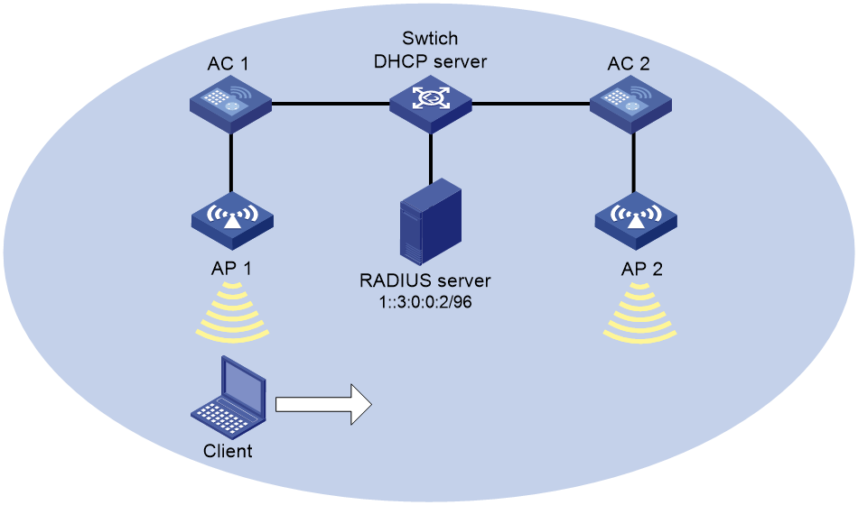

As shown in Figure 1, AP 1 and AP 2 are managed by AC 1 and AC 2, respectively. Clients associated with AC 1 belong to VLAN 200. Clients associated with AC 2 belong to VLAN 400.
Complete the following tasks:
· Configure all devices to use IPv6 addresses.
· Configure inter-AC roaming to enable clients to roam between AP 1 and AP 2.
· Configure VLAN-based user isolation to improve user security and reduce radio resources consumption caused by multicast and broadcast packets.
Table 1 Interface and IPv6 address assignment
Interface |
IPv6 address |
AC 1 |
VLAN-interface 100 |
1::1:0:0:2/96 |
VLAN-interface 200 |
1::2:0:0:2/96 |
AC 2 |
1::1:0:0:3/96 |
VLAN-interface 400 |
1::4:0:0:2/96 |
Switch |
1::1:0:0:1/96 |
1::2:0:0:1/96 |
VLAN-interface 300 |
1::3:0:0:1/96 |
1::4:0:0:1/96 |

2. Configure 802.1X authentication:
# Set the EAP message handling method to EAP.
[AC1] dot1x authentication-method eap
# Create a RADIUS scheme named office and enter its view.
[AC1] radius scheme office
# Specify the server at 1::3:0:0:2 as the primary authentication server.
[AC1-radius-office] primary authentication ipv6 1::3:0:0:2
# Specify the server at 1::3:0:0:2 as the primary accounting server.
[AC1-radius-office] primary accounting ipv6 1::3:0:0:2
# Set the shared key to 12345678 for secure communication with the primary authentication server and accounting server.
[AC1-radius-office] key authentication simple 12345678
[AC1-radius-office] key accounting simple 12345678
# Set the source IPv6 address to 1::1:0:0:2 for outgoing RADIUS packets.
[AC1-radius-office] nas-ip ipv6 1::1:0:0:2
[AC1-radius-office] quit
# Create an ISP domain named office and enter its view.
[AC1] domain office
# Configure the ISP domain to use RADIUS scheme office for authentication, authorization, and accounting of LAN users.
[AC1-isp-office] authentication lan-access radius-scheme office
[AC1-isp-office] authorization lan-access radius-scheme office
[AC1-isp-office] accounting lan-access radius-scheme office
[AC1-isp-office] quit
3. Configure the wireless service:
# Create service template 1 and enter its view.
[AC1] wlan service-template 1
# Set the SSID to service.
[AC1-wlan-st-1] ssid service
# Assign clients coming online through the service template to VLAN 200.
[AC1-wlan-st-1] vlan 200
# Use the AC to forward client traffic.
[AC1-wlan-st-1] client forwarding-location ac
# Set the AKE mode to 802.1X.
[AC1-wlan-st-1] akm mode dot1x
# Set the authentication mode to 802.1X for wireless clients.
[AC1-wlan-st-1] client-security authentication-mode dot1x
# Specify ISP domain office as the authentication domain for 802.1X clients.
[AC1-wlan-st-1] dot1x domain office
# Specify AES-CCMP as the cipher suite used for frame encryption.
[AC1-wlan-st-1] cipher-suite ccmp
# Enable the RSN IE in beacon and probe responses.
[AC1-wlan-st-1] security-ie rsn
# Enable the service template.
[AC1-wlan-st-1] service-template enable
# Enable snooping DHCPv6 and ND packets.
[AC1-wlan-st-1] client ipv6-snooping dhcpv6-learning enable
[AC1-wlan-st-1] client ipv6-snooping nd-learning enable
[AC1-wlan-st-1] quit
4. Configure an AP:
NOTE: In a large-scale network, configure AP settings in AP group view instead of AP view as a best practice. |
# Create an AP named ap1, and specify its model and the serial ID.
[AC1] wlan ap ap1 model WA6320
[AC1-wlan-ap-ap1] serial-id 219801A28N819CE0002T
# Create AP group group1, and configure a grouping rule by AP name to add AP ap1 to the group.
[AC1] wlan ap-group group1
[AC1-wlan-ap-group-group1] ap ap1
# Bind service template 1 to radio 1, and enable radio 1.
[AC1-wlan-ap-group-group1] ap-model WA6320
[AC1-wlan-ap-group-group1-ap-model-WA6320] radio 1
[AC1-wlan-ap-group-group1-ap-model-WA6320-radio-1] service-template 1
[AC1-wlan-ap-group-group1-ap-model-WA6320-radio-1] radio enable
[AC1-wlan-ap-group-group1-ap-model-WA6320-radio-1] quit
[AC1-wlan-ap-group-group1-ap-model-WA6320] quit
5. Configure WLAN roaming:
# Create mobility group 1.
[AC1] wlan mobility group 1
# Set the source IPv6 address for establishing IACTP tunnels to 1::1:0:0:2.
[AC1-wlan-mg-1] source ipv6 1::1:0:0:2
# Add AC 2 to the mobility group.
[AC1-wlan-mg-1] member ipv6 1::1:0:0:3
# Specify the IP address type as IPv6 for IACTP tunnels.
[AC1-wlan-mg-1] tunnel-type ipv6
# Enable the mobility group.
[AC1-wlan-mg-1] group enable
[AC1-wlan-mg-1] quit
6. Configure user isolation:
# Enable user isolation for VLAN 200.
[AC1] user-isolation vlan 200 enable
# Specify the MAC address of the gateway for VLAN 200 as a permitted MAC address for VLAN 200.
[AC1] user-isolation vlan 200 permit-mac 000f-e212-7788
7. Configure a default route:
# Configure a default route for AC 1. Set the next hop to 1::1:0:0:1.
[AC1] ipv6 route-static 0::0 96 1::1:0:0:1
Configuring AC 2
1. Configure interfaces on AC 2:
# Create VLAN 100 and VLAN-interface 100, and assign an IPv6 address to the VLAN interface. The AC will use this IPv6 address to establish CAPWAP tunnels with APs.
<AC2> system-view
[AC2] vlan 100
[AC2-vlan100] quit
[AC2] interface vlan-interface 100
[AC2-Vlan-interface100] ipv6 address 1::1:0:0:3/96
[AC2-Vlan-interface100] quit
# Create VLAN 200. The AC will use VLAN 200 to forward data of the client after the client roams from AP 1 to AP 2.
<AC2> system-view
[AC2] vlan 200
[AC2-vlan200] quit
# Create VLAN 400 and VLAN-interface 400, and assign an IPv6 address to the VLAN interface. The AC will use VLAN 400 for client access.
[AC2] vlan 400
[AC2-vlan400] quit
[AC2] interface vlan-interface 400
[AC2-Vlan-interface400] ipv6 address 1::4:0:0:2/96
[AC2-Vlan-interface400] quit
# Configure the interface that is connected to the switch as a trunk port, and assign the port to VLAN 100, VLAN 200, and VLAN 400.
[AC2] interface gigabitethernet 1/0/1
[AC2-GigabitEthernet1/0/1] port link-type trunk
[AC2-GigabitEthernet1/0/1] port trunk permit vlan 100 200 400
[AC2-GigabitEthernet1/0/1] quit
# Configure the interface that is connected to AP 2 as an access port, and assign the port to VLAN 100.
[AC2] interface gigabitethernet 1/0/2
[AC2-GigabitEthernet1/0/2] port link-type access
[AC2-GigabitEthernet1/0/2] port access vlan 100
[AC2-GigabitEthernet1/0/2] quit
[AC2] dot1x authentication-method eap
[AC2] radius scheme office
[AC2-radius-office] primary authentication ipv6 1::3:0:0:2
[AC2-radius-office] primary accounting ipv6 1::3:0:0:2
# Set the shared key to 12345678 in plaintext form for secure authentication communication.
[AC2-radius-office] key authentication simple 12345678
# Set the shared key to 12345678 in plaintext form for secure accounting communication.
[AC2-radius-office] key accounting simple 12345678
# Set the source IPv6 address to 1::1:0:0:3 for outgoing RADIUS packets.
[AC2-radius-office] nas-ip ipv6 1::1:0:0:3
[AC2-radius-office] quit
[AC2] domain office
[AC2-isp-office] authentication lan-access radius-scheme office
[AC2-isp-office] authorization lan-access radius-scheme office
[AC2-isp-office] accounting lan-access radius-scheme office
[AC2-isp-office] quit
[AC2] wlan service-template 1
[AC2-wlan-st-1] ssid service
# Assign clients coming online through the service template to VLAN 400.
[AC2-wlan-st-1] vlan 400
[AC2-wlan-st-1] akm mode dot1x
[AC2-wlan-st-1] client-security authentication-mode dot1x
[AC2-wlan-st-1] dot1x domain office
[AC2-wlan-st-1] cipher-suite ccmp
[AC2-wlan-st-1] security-ie rsn
[AC2-wlan-st-1] service-template enable
[AC2-wlan-st-1] client ipv6-snooping dhcpv6-learning enable
[AC2-wlan-st-1] client ipv6-snooping nd-learning enable
[AC2-wlan-st-1] quit
4. Configure an AP:
# Create an AP named ap2, and specify its model and the serial ID.
[AC2] wlan ap ap2 model WA6320
[AC2-wlan-ap-ap2] serial-id 219801A28N819CE0002T
# Create AP group group2, and configure a grouping rule by AP name to add AP ap2 to the group.
[AC2] wlan ap-group group2
[AC2-wlan-ap-group-group2] ap ap2
[AC2-wlan-ap-group-group2] ap-model WA6320
[AC2-wlan-ap-group-group2-ap-model-WA6320] radio 1
[AC2-wlan-ap-group-group2-ap-model-WA6320-radio-1] service-template 1
[AC2-wlan-ap-group-group2-ap-model-WA6320-radio-1] radio enable
[AC2-wlan-ap-group-group2-ap-model-WA6320-radio-1] quit
[AC2-wlan-ap-group-group2-ap-model-WA6320] quit
[AC2] wlan mobility group 1
# Set the source IPv6 address for establishing IACTP tunnels to 1::1:0:0:3.
[AC2-wlan-mg-1] source ipv6 1::1:0:0:3
# Add AC 1 to the mobility group.
[AC2-wlan-mg-1] member ipv6 1::1:0:0:2
[AC2-wlan-mg-1] group enable
[AC2-wlan-mg-1] quit
# Enable user isolation for VLAN 400.
[AC2] user-isolation vlan 400 enable
# Specify the MAC address of the gateway for VLAN 400 as a permitted MAC address for VLAN 400.
[AC2] user-isolation vlan 400 permit-mac 000f-eeee-1212
# Configure a default route for AC 2. Set the next hop to 1::1:0:0:1.
[AC2] ipv6 route-static 0::0 96 1::1:0:0:1
Configuring the switch
1. Configure interfaces on the switch:
# Create VLAN 100 and VLAN-interface 100, and assign an IPv6 address to the VLAN interface. The switch will use VLAN 100 to forward the traffic on CAPWAP tunnels between the AC and APs.
<Switch> system-view
[Switch] vlan 100
[Switch-vlan100] quit
[Switch-Vlan-interface100] ipv6 address 1::1:0:0:1/96
# Create VLAN 200 and VLAN-interface 200, and assign an IPv6 address to the VLAN interface. The switch will use VLAN 200 to forward client traffic of AC 1.
[Switch] vlan 200
[Switch-vlan200] quit
[Switch] interface vlan-interface 200
[Switch-Vlan-interface200] ipv6 address 1::2:0:0:1/96
[Switch-Vlan-interface200] quit
# Create VLAN 400 and VLAN-interface 400, and assign an IPv6 address to the VLAN interface. The switch will use VLAN 400 to forward client traffic of AC 2.
[Switch] vlan 400
[Switch-vlan400] quit
[Switch] interface vlan-interface 400
[Switch-Vlan-interface400] ipv6 address 1::4:0:0:1/96
[Switch-Vlan-interface400] quit
# Create VLAN 300 and VLAN-interface 300, and assign an IPv6 address to the VLAN interface. The switch will use VLAN 300 to forward traffic to the RADIUS server.
[Switch] vlan 300
[Switch-vlan300] quit
[Switch] interface vlan-interface 300
[Switch-Vlan-interface300] ipv6 address 1::3:0:0:1/96
[Switch-Vlan-interface300] quit
# Configure the interface that is connected to AC 1 as a trunk port, and assign the port to VLAN 100, VLAN 200, and VLAN 400.
[Switch] interface gigabitethernet 1/0/1
[Switch-GigabitEthernet1/0/1] port link-type trunk
[Switch-GigabitEthernet1/0/1] port trunk permit vlan 100 200 400
[Switch-GigabitEthernet1/0/1] quit
# Configure the interface that is connected to AC 2 as a trunk port, and assign the port to VLAN 100, VLAN 200, and VLAN 400.
[Switch] interface gigabitethernet 1/0/2
[Switch-GigabitEthernet1/0/2] port link-type trunk
[Switch-GigabitEthernet1/0/2] port trunk permit vlan 100 200 400
[Switch-GigabitEthernet1/0/2] quit
# Configure the interface that is connected to the RADIUS server as an access port, and assign the port to VLAN 300.
[Switch] interface gigabitethernet 1/0/3
[Switch-GigabitEthernet1/0/3] port link-type access
[Switch-GigabitEthernet1/0/3] port access vlan 300
[Switch-GigabitEthernet1/0/3] quit
2. Configure the DHCPv6 server:
# Enable the DHCPv6 server on VLAN-interface 100, VLAN-interface 200, and VLAN-interface 300, and apply DHCPv6 address pools to the interfaces.
[Switch-Vlan-interface100] ipv6 dhcp select server
[Switch-Vlan-interface100] ipv6 dhcp server apply pool 1
[Switch-Vlan-interface200] ipv6 dhcp select server
[Switch-Vlan-interface200] ipv6 dhcp server apply pool 2
[Switch-Vlan-interface400] ipv6 dhcp select server
[Switch-Vlan-interface400] ipv6 dhcp server apply pool 3
# Disable RA message suppression. Set both the M flag and O flag to 1 in RA advertisements to be sent.
[Switch-Vlan-interface100] undo ipv6 nd ra halt
[Switch-Vlan-interface100] ipv6 nd autoconfig managed-address-flag
[Switch-Vlan-interface100] ipv6 nd autoconfig other-flag
[Switch-Vlan-interface200] undo ipv6 nd ra halt
[Switch-Vlan-interface200] ipv6 nd autoconfig managed-address-flag
[Switch-Vlan-interface200] ipv6 nd autoconfig other-flag
[Switch-Vlan-interface400] undo ipv6 nd ra halt
[Switch-Vlan-interface400] ipv6 nd autoconfig managed-address-flag
[Switch-Vlan-interface400] ipv6 nd autoconfig other-flag
# Configure DHCPv6 address pool 1. Specify the subnet 1::1:0:0:0/96 and configure Option 52.
[Switch] ipv6 dhcp pool 1
[Switch-dhcp6-pool-1] network 1::1:0:0:0/96
[Switch-dhcp6-pool-1] option 52 hex 00010000000000000001000000000010
[Switch-dhcp6-pool-1] quit
# Configure DHCPv6 address pool 2. Specify the subnet 1::2:0:0:0/96 and configure Option 52.
[Switch] ipv6 dhcp pool 2
[Switch-dhcp6-pool-2] network 1::2:0:0:0/96
[Switch-dhcp6-pool-1] option 52 hex 00010000000000000001000000000011
[Switch-dhcp6-pool-2] quit

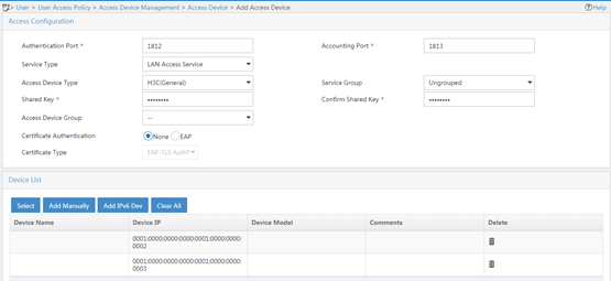

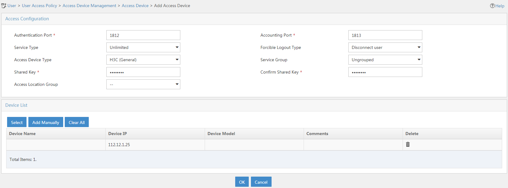

1. Add the ACs to the IMC Platform as access devices:
a. Log in to IMC.
b. Click the User tab.
c. From the navigation tree, select User Access Policy > Access Device Management > Access Device.
d. Click Add and perform the following tasks:
- Enter 12345678 in the Shared Key field.
- Add IPv6 addresses 1::1:0:0:2 and 1::1:0:0:3 to the Device List.
- Use the default settings for other parameters.
e. Click OK.
Figure 2 Adding access devices

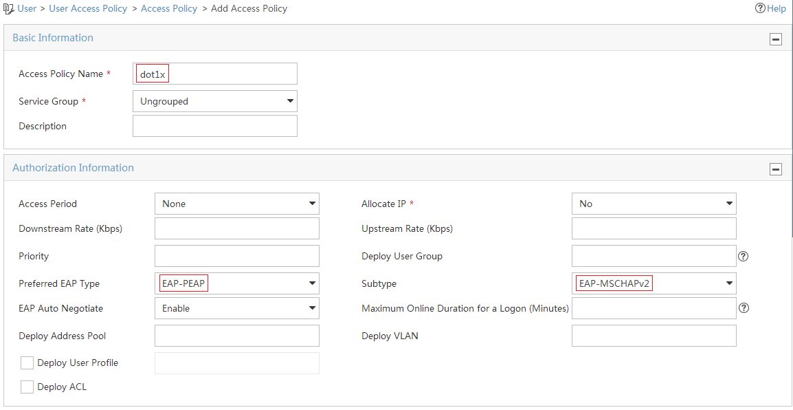

2. Add an access policy:
a. From the navigation tree, select User Access Policy > Access Policy.
b. Click Add to add an access policy that uses the following settings:
- Access Policy Name—dot1x.
- Preferred EAP Type—EAP-PEAP.
- Subtype—EAP-MSCHAPv2. The subtype must match the client authentication method.
Figure 3 Adding an access policy

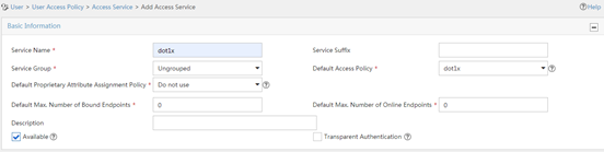

3. Add an access service:
a. From the navigation tree, select User Access Policy > Access Service.
b. Click Add to add an access service that uses the following settings:
- Service Name—dot1x.
- Default Access Policy—dot1x.
Figure 4 Adding an access service

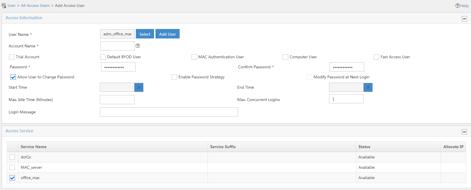

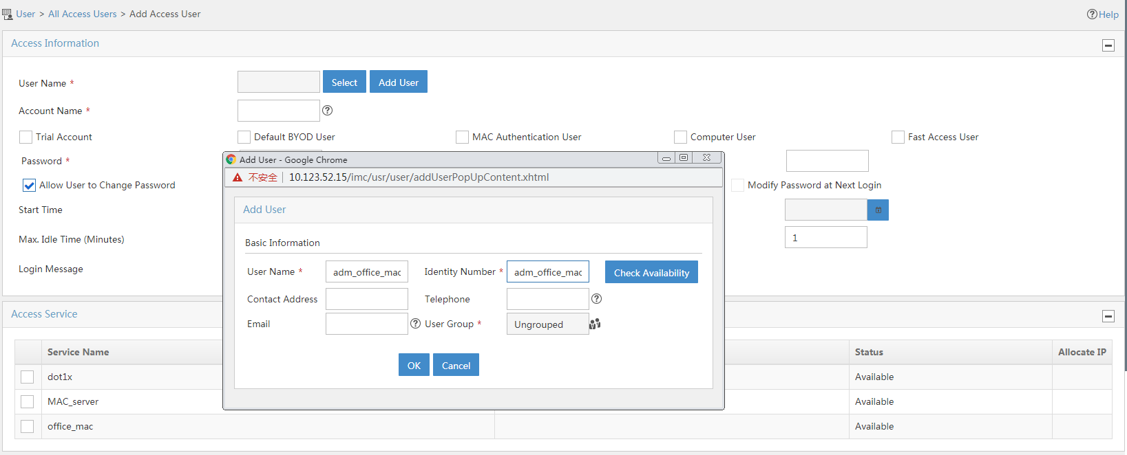

4. Add an access user:
a. From the navigation tree, select All Access Users.
b. Click Add and perform the following tasks:
- Click Add User to add a user with username user.
- Set the Account Name to dot1x.
- Set the Password to dot1x.
- Select the dot1x service.
Figure 5 Adding an access user

# Move the client toward AP 2 for the client to roam to AP 2.
# On AC 2, verify that the client is associated with AP 2.
