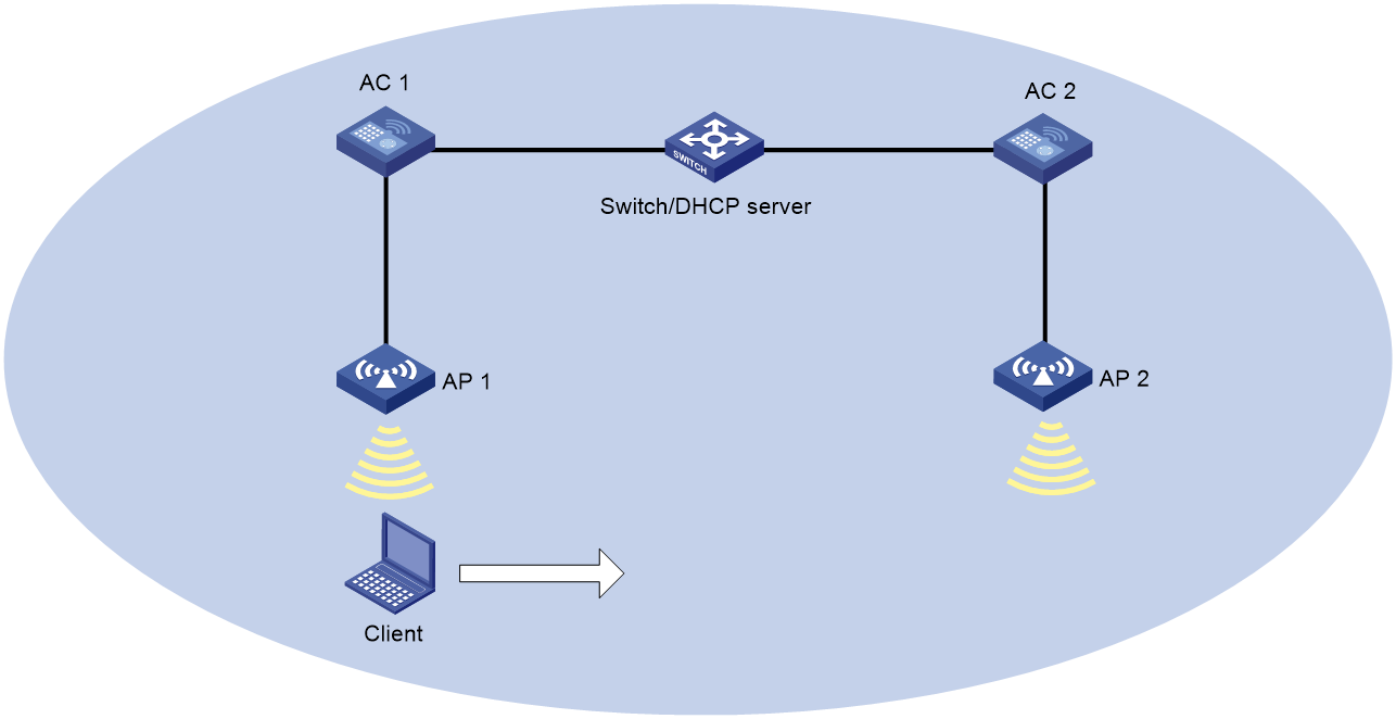

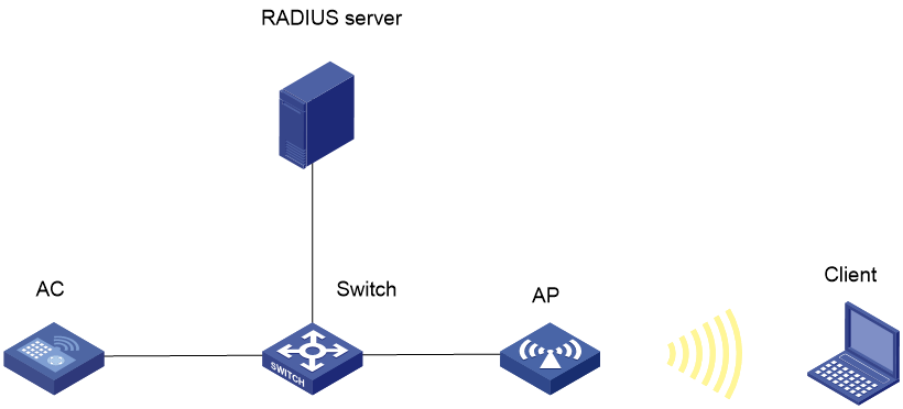

Example: Configuring inter-AC roaming with static client VLAN allocation
As shown in Figure 1, deploy two ACs connected through a switch to provide wireless services. The switch acts as a DHCP server to assign IP addresses to APs and clients. Specify the same VLAN group for each AP to enable clients to roam between the two ACs without changing client VLANs.
Device |
Interface |
IP address |
AC 1 |
Vlan-int100 |
192.1.0.2/16 |
Vlan-int200 |
192.2.0.2/16 |
AC 2 |
Vlan-int100 |
192.1.0.3/16 |
Vlan-int400 |
192.4.0.2/16 |
Switch |
Vlan-int100 |
192.1.0.1/16 |
Vlan-int200 |
192.2.0.1/16 |
Vlan-int400 |
192.4.0.1/16 |

# Set the VLAN allocation method for clients to static.
[AC1-wlan-st-1] client vlan-alloc static
# Specify PSK as the AKM mode and specify 12345678 as the plaintext key.
[AC1-wlan-st-1] akm mode psk
[AC1-wlan-st-1] preshared-key pass-phrase simple 12345678
# Specify CCMP as the cipher suite and specify RSN as the security IE.
[AC1-wlan-st-1] cipher-suite ccmp
[AC1-wlan-st-1] security-ie rsn
# Configure the AC to forward client data traffic. If the default client data traffic forwarder is AC, skip this step.
[AC1-wlan-st-1] client forwarding-location ac
# Enable service template 1.
[AC1-wlan-st-1] service-template enable
[AC1-wlan-st-1] quit
4. Configure AP settings:
NOTE: To simply AP configuration on a large-scale network, configure AP settings on a per AP group basis as a best practice. |
# Create AP ap1, and specify the AP model and serial ID.
[AC1] wlan ap ap1 model WA6320
[AC1-wlan-ap-ap1] serial-id 219801A28N819CE0002T
[AC1-wlan-ap-ap1] quit
# Create AP group group1 and configure ap1 as the AP grouping rule.
[AC1] wlan ap-group group1
[AC1-wlan-ap-group-group1] ap ap1
# Bind service template 1 and VLAN group roam to radio 1 for AP group group1.
[AC1-wlan-ap-group-group1] ap-model WA6320
[AC1-wlan-ap-group-group1-ap-model-WA6320] radio 1
[AC1-wlan-ap-group-group1-ap-model-WA6320-radio-1] service-template 1 vlan-group roam
# Enable radio 1.
[AC1-wlan-ap-group-group1-ap-model-WA6320-radio-1] radio enable
[AC1-wlan-ap-group-group1-ap-model-WA6320-radio-1] quit
[AC1-wlan-ap-group-group1-ap-model-WA6320] quit
[AC1-wlan-ap-group-group1] quit
5. Configure wireless roaming:
# Create mobility group 1 and enter its view.
[AC1] wlan mobility group 1
# Specify the source IPv4 address for establishing IADTP tunnels as 192.1.0.2.
[AC1-wlan-mg-1] source ip 192.1.0.2
# Add AC 2 as a mobility group member.
[AC1-wlan-mg-1] member ip 192.1.0.3
# Enable mobility group 1.
[AC1-wlan-mg-1] group enable
[AC1-wlan-mg-1] quit
6. Configure a static route, whose next hop address is 192.1.0.1.
[AC1] ip route-static 0.0.0.0 0.0.0.0 192.1.0.1
Configuring AC 2
1. Configure AC interfaces:
# Create VLAN 100 and VLAN-interface 100, and assign IP address 192.1.0.3/16 to the interface. The AC will use this IP address to establish CAPWAP tunnels with APs.
<AC2> system-view
[AC2] vlan 100
[AC2-vlan100] quit
[AC2] interface vlan-interface 100
[AC2-Vlan-interface100] ip address 192.1.0.3 16
[AC2-Vlan-interface100] quit
# Create VLAN 200. The AC will use this VLAN to forward traffic of clients roamed from AC 1.
<AC2> system-view
[AC2] vlan 200
[AC2-vlan200] quit
# Create VLAN 400 and VLAN-interface 400, and assign IP address 192.4.0.2/16. The AC will use this interface to communicate with clients.
[AC2] vlan 400
[AC2-vlan400] quit
[AC2] interface vlan-interface 400
[AC2-Vlan-interface400] ip address 192.4.0.2 16
[AC2-Vlan-interface400] quit
# Set the link type of GigabitEthernet 1/0/1 to trunk and assign the port to VLANs 100, 200, and 400.
[AC2] interface gigabitethernet 1/0/1
[AC2-GigabitEthernet1/0/1] port link-type trunk
[AC2-GigabitEthernet1/0/1] port trunk permit vlan 100 200 400
[AC2-GigabitEthernet1/0/1] quit
# Set the link type of GigabitEthernet 1/0/2 to access and assign the port to VLAN 100.
[AC2] interface gigabitethernet 1/0/2
[AC2-GigabitEthernet1/0/2] port link-type access
[AC2-GigabitEthernet1/0/2] port access vlan 100
[AC2-GigabitEthernet1/0/2] quit
2. Create VLAN group roam, and add VLANs 200 and 400 to the group.
[AC2] vlan-group roam
[AC2-vlan-group-roam] vlan-list 200 400
3. Configure wireless services:
# Create service template 1.
[AC2] wlan service-template 1
# Set the SSID to service.
[AC2-wlan-st-1] ssid service
[AC2-wlan-st-1] client vlan-alloc static
[AC2-wlan-st-1] akm mode psk
[AC2-wlan-st-1] preshared-key pass-phrase simple 12345678
[AC2-wlan-st-1] cipher-suite ccmp
[AC2-wlan-st-1] security-ie rsn
[AC2-wlan-st-1] client forwarding-location ac
[AC2-wlan-st-1] service-template enable
[AC2-wlan-st-1] quit
# Create AP ap2, and specify the AP model and serial ID.
[AC2] wlan ap ap2 model WA6320
[AC2-wlan-ap-ap2] serial-id 219801A28N819CE0003T
# Create AP group group1 and configure ap2 as the AP grouping rule.
[AC2] wlan ap-group group1
[AC2-wlan-ap-group-group1] ap ap2
[AC2-wlan-ap-group-group1] ap-model WA6320
[AC2-wlan-ap-group-group1-ap-model-WA6320] radio 1
[AC2-wlan-ap-group-group1-ap-model-WA6320-radio-1] service-template 1 vlan-group roam
# Enable radio 1.
[AC2-wlan-ap-group-group1-ap-model-WA6320-radio-1] radio enable
[AC2-wlan-ap-group-group1-ap-model-WA6320-radio-1] quit
[AC2-wlan-ap-group-group1-ap-model-WA6320] quit
[AC2-wlan-ap-group-group1] quit
[AC2] wlan mobility group 1
# Specify the source IPv4 address for establishing IADTP tunnels as 192.1.0.3.
[AC2-wlan-mg-1] source ip 192.1.0.3
# Add AC 1 as a mobility group member.
[AC2-wlan-mg-1] member ip 192.1.0.2
[AC2-wlan-mg-1] group enable
[AC2-wlan-mg-1] quit
[AC2] ip route-static 0.0.0.0 0.0.0.0 192.1.0.1
Configuring the switch
# Create VLAN 100 and VLAN-interface 100, and assign IP address 192.1.0.1/16 to the interface. The switch will use this interface to communicate with AC 1 and AC 2.
<Switch> system-view
[Switch] vlan 100
[Switch-vlan100] quit
[Switch-Vlan-interface100] ip address 192.1.0.1 16
# Create VLAN 200 and VLAN-interface 200, and assign IP address 192.2.0.1/16 to the interface. The switch will use this interface to communicate with clients associated with AC 1.
[Switch] vlan 200
[Switch-vlan200] quit
[Switch] interface vlan-interface 200
[Switch-Vlan-interface200] ip address 192.2.0.1 16
[Switch-Vlan-interface200] quit
# Create VLAN 400 and VLAN-interface 400, and assign IP address 192.4.0.1/16. The AC will use this interface to communicate with clients associated with AC 2.
[Switch] vlan 400
[Switch-vlan400] quit
[Switch] interface vlan-interface 400
[Switch-Vlan-interface400] ip address 192.4.0.1 16
[Switch-Vlan-interface400] quit
[Switch] interface gigabitethernet 1/0/1
[Switch-GigabitEthernet1/0/1] port link-type trunk
[Switch-GigabitEthernet1/0/1] port trunk permit vlan 100 200 400
[Switch-GigabitEthernet1/0/1] quit
# Set the link type of GigabitEthernet 1/0/2 to access and assign the port to VLANs 100, 200, 400.
[Switch] interface gigabitethernet 1/0/2
[Switch-GigabitEthernet1/0/2] port link-type trunk
[Switch-GigabitEthernet1/0/2] port trunk permit vlan 100 200 400
[Switch-GigabitEthernet1/0/2] quit
2. Configure the DHCP server:
# Enable DHCP.
[Switch] dhcp enable
# Create DHCP address pool vlan100, specify subnet 192.1.0.0/16 in the address pool, exclude IP addresses 192.1.0.2 and 192.1.0.3 from dynamic allocation, and specify the gateway IP address as 192.1.0.1.
[Switch] dhcp server ip-pool vlan100
[Switch-dhcp-pool-vlan100] network 192.1.0.0 mask 255.255.0.0
[Switch-dhcp-pool-vlan100] forbidden-ip 192.1.0.2 192.1.0.3
[Switch-dhcp-pool-vlan100] gateway-list 192.1.0.1
[Switch-dhcp-pool-vlan100] quit
# Create DHCP address pool vlan200, specify subnet 192.2.0.0/16 in the address pool, and exclude 192.2.0.2 from dynamic allocation. Specify the gateway address as 192.2.0.1 and specify the address of the DNS server. In this example, the gateway also acts as the DNS server.
[Switch] dhcp server ip-pool vlan200
[Switch-dhcp-pool-vlan200] network 192.2.0.0 mask 255.255.0.0
[Switch-dhcp-pool-vlan200] forbidden-ip 192.2.0.2
[Switch-dhcp-pool-vlan200] gateway-list 192.2.0.1
[Switch-dhcp-pool-vlan200] dns-list 192.2.0.1
[Switch-dhcp-pool-vlan200] quit
# Create DHCP address pool vlan400, specify subnet 192.4.0.0/16 in the address pool, and exclude 192.4.0.2 from dynamic allocation. Specify the gateway address as 192.4.0.1, and specify the address of the DNS server. In this example, the gateway also acts as the DNS server.
[Switch] dhcp server ip-pool vlan400
[Switch-dhcp-pool-vlan400] network 192.4.0.0 mask 255.255.0.0
[Switch-dhcp-pool-vlan400] forbidden-ip 192.4.0.2
[Switch-dhcp-pool-vlan400] gateway-list 192.4.0.1
[Switch-dhcp-pool-vlan400] dns-list 192.4.0.1
[Switch-dhcp-pool-vlan400] quit
# Make a client come online from AC 1.
# Use the display wlan client command to view the client's VLAN and IP address from AC 1.
[AC] display wlan client
Total number of clients: 1
MAC address User name AP name R IP address VLAN
68db-ca64-23fd N/A ap1 1 192.2.0.3 200
# Make the client roam to AC 2.
# Use the display wlan client command to view the client's VLAN and IP address from AC 2. Verify that the client's VLAN and IP address are not changed after roaming.
68db-ca64-23fd N/A ap2 1 192.2.0.3 200
