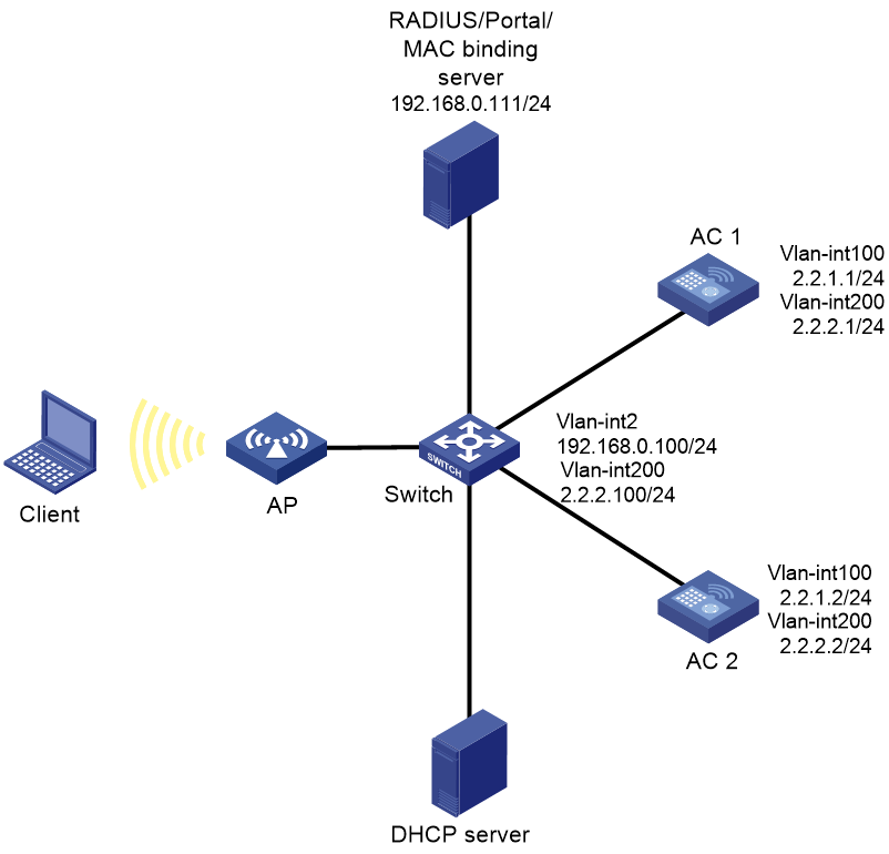

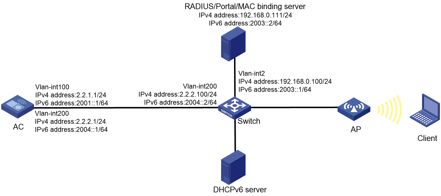

As shown in Figure 1, the AP and the client obtain IP addresses and IPv6 addresses from the DHCP server and the DHCPv6 server, respectively. The IMC server acts a portal authentication server, a portal Web server, a MAC binding server, and a RADIUS server.
Configure direct portal authentication and MAC-trigger authentication to meet the following requirements:
· The client can access only the portal Web servers before passing portal authentication and can access other network resources after passing portal authentication.
· The client can access the network resources through any Layer 2 ports in its access VLAN without re-authentication.
· The RADIUS server can dynamically change the user authorization information or forcibly disconnect users.

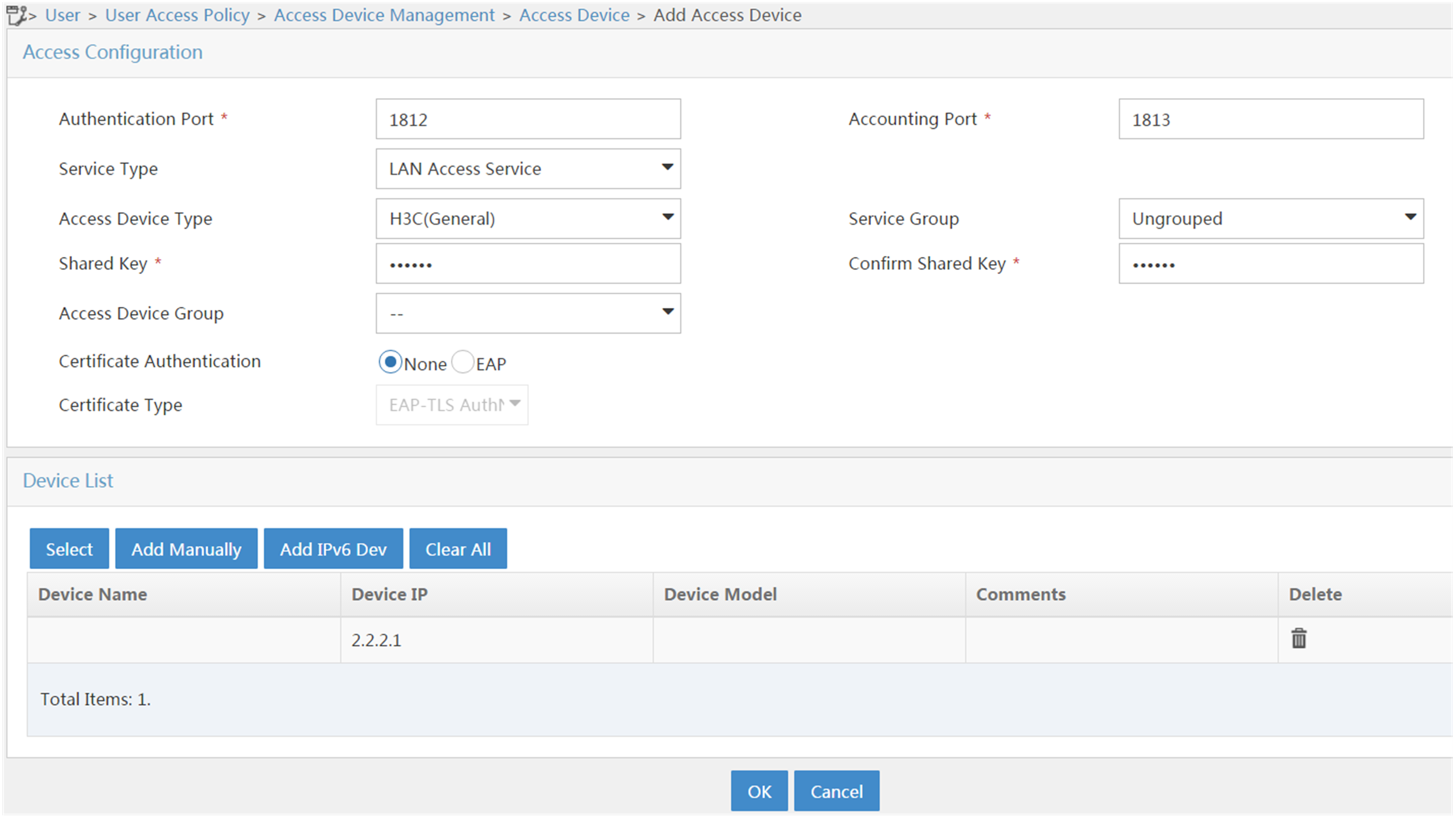

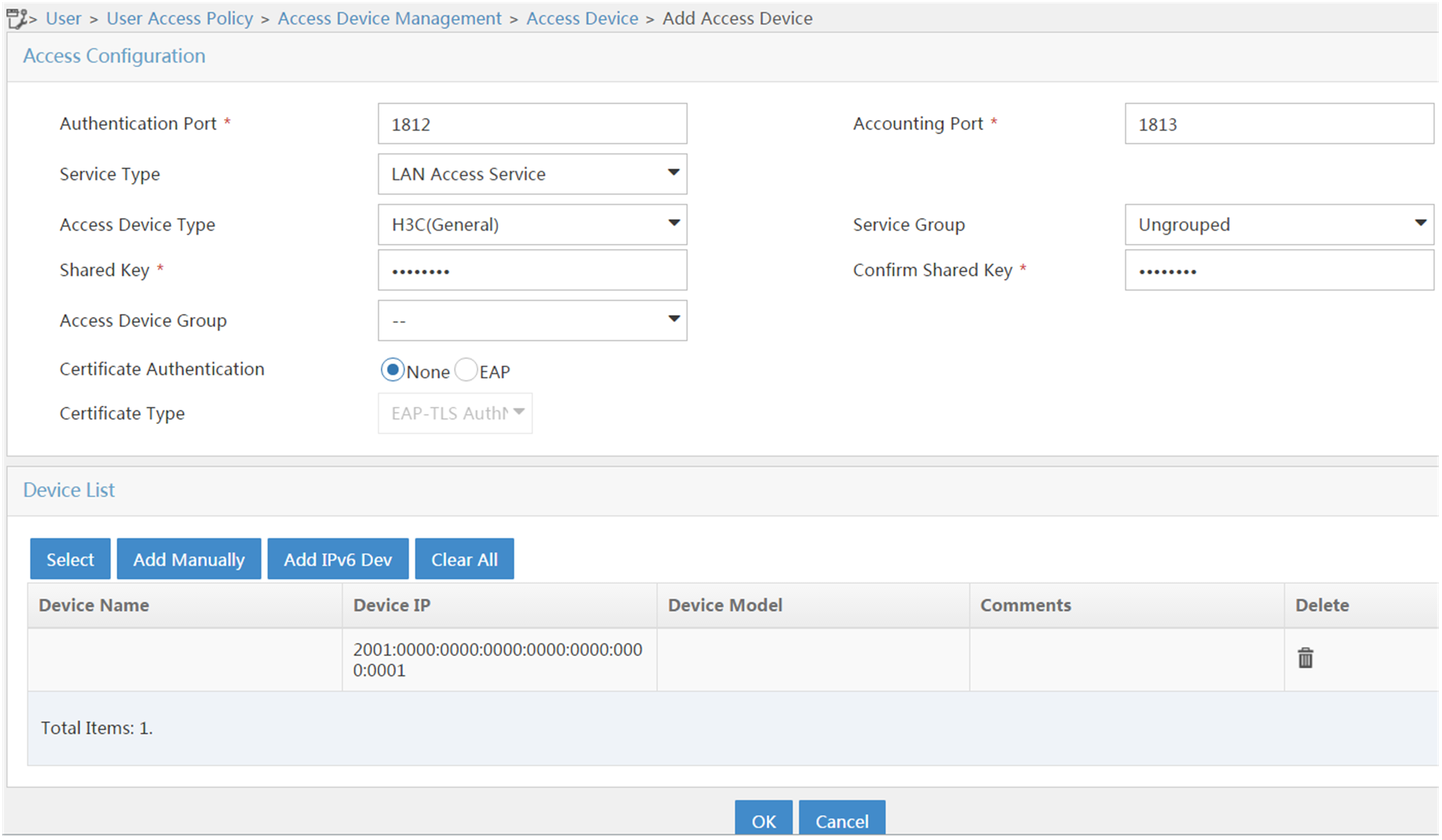

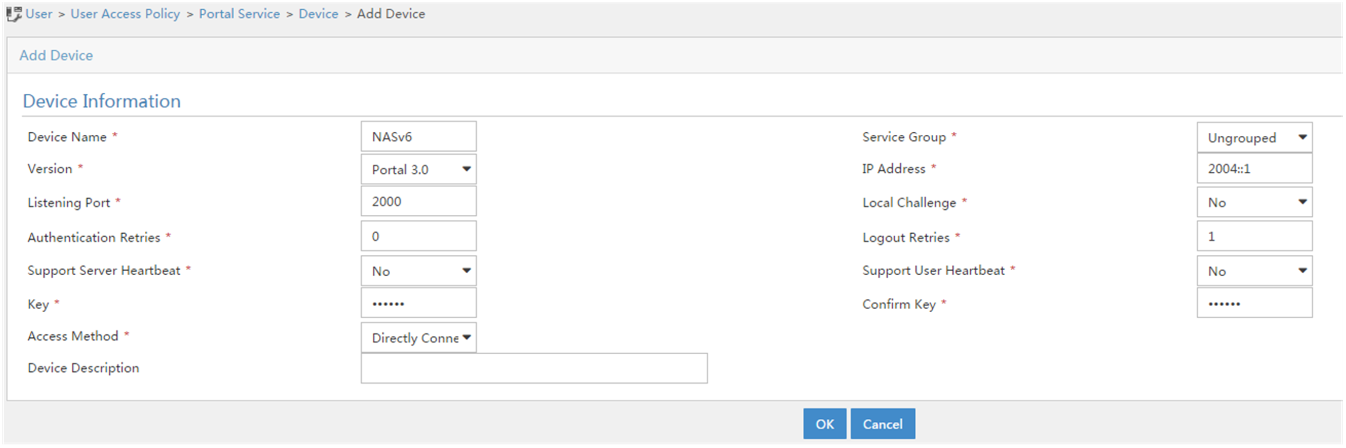

Add the AC to IMC as an IPv4 access device and an IPv6 access device:
1. Log in to IMC and click the User tab.
2. From the navigation tree, select User Access Policy > Access Device Management > Access Device.
3. Click Add to open the page as shown in Figure 2.
4. In the Access Configuration area, set the shared key to radius, which must be the same as that on the AC.
5. In the Device List area, perform the following operations:
a. Click Add Manually to open the Add Access Device Manually page. Enter the start IPv4 address 2.2.2.1 and then click OK.
b. Click Add IPv6 Dev to open the Add Access Device Manually page. Enter the start IPv6 address 2001::1 and then click OK.
6. Use the default values for other parameters.
7. Click OK.
Figure 2 Adding the AC as an IPv4 access device
Figure 3 Adding the AC as an IPv6 access device

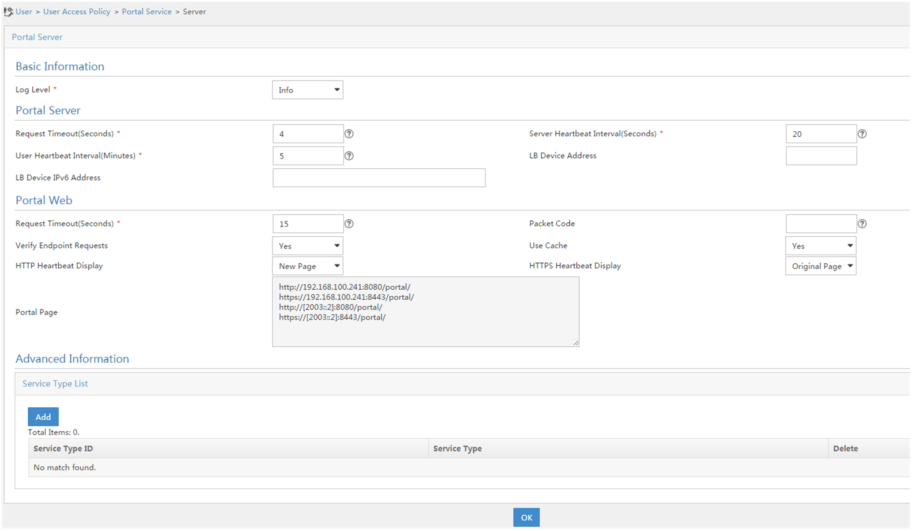

Configuring the portal server
1. Configure the portal authentication service:
a. Click the User tab.
b. From the navigation tree, select User Access Policy > Portal Service > Server to open the portal server configuration page, as shown in Figure 4.
c. Configure the portal server parameters as needed.
This example uses the default values.
d. Click OK.
Figure 4 Portal authentication server configuration

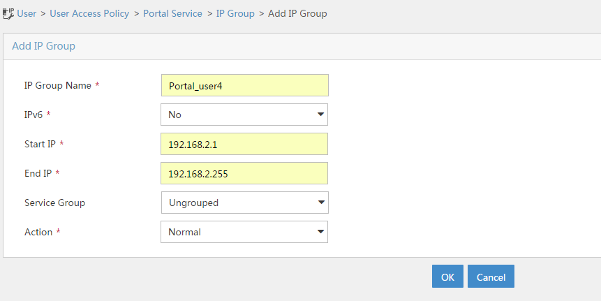

2. Configure an IPv4 group and an IPv6 group:
a. From the navigation tree, select User Access Policy > Portal Service > IP Group.
b. Click Add.
The Add IP Group page opens.
c. Enter an IP group name.
d. To add an IPv4 group, select No from the IPv6 field.
e. To add an IPv6 group, select Yes from the IPv6 field.
f. Enter the start IP address and end IP address of the IP group.
Make sure the client IP address is in the IP group.
g. Select a service group.
This example uses the default value Ungrouped.
h. Select Normal from the Action field.
This step is required only when you add an IPv4 address group.
i. Click OK.

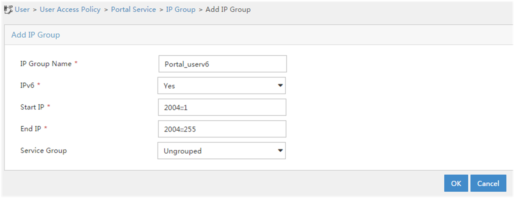

Figure 6 Adding an IPv6 group

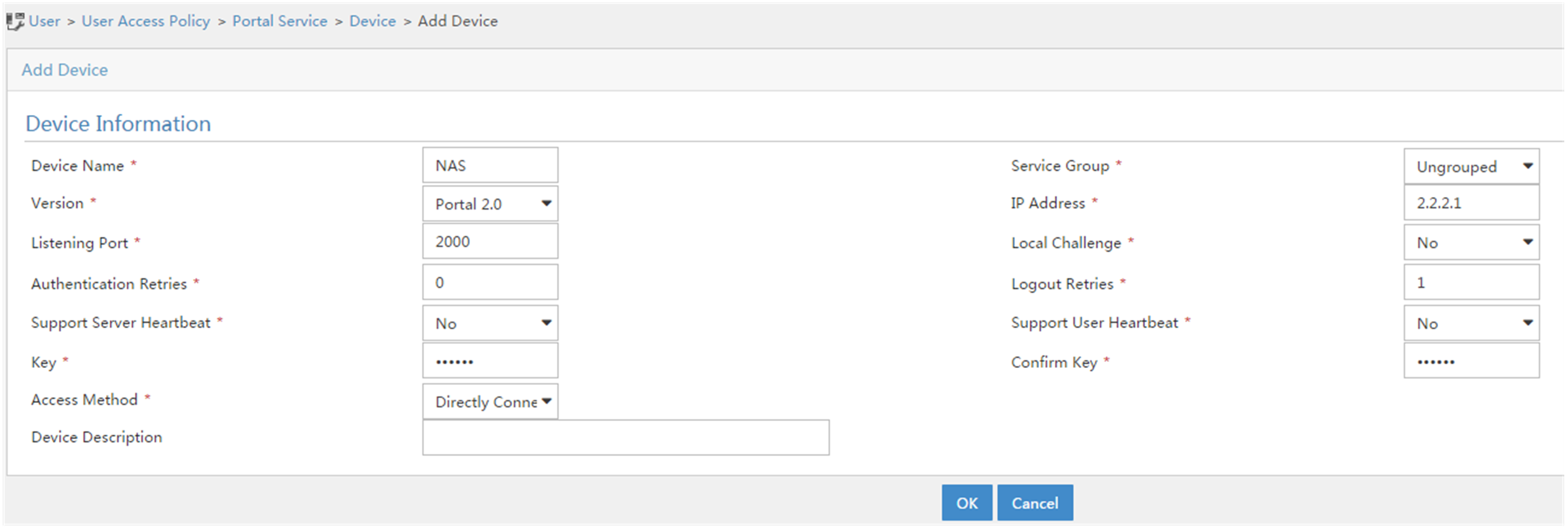

3. Add the portal device:
a. From the navigation tree, select User Access Policy > Portal Service > Device.
b. Click Add.
The Add Device page opens.
c. Enter the device name.
d. Select a portal version.
For an IPv4 portal device, select Portal 2.0. For an IPv6 portal device, select Portal 3.0.
e. Enter the IP address of the AC's interface connected to the client.
f. Set whether to support the portal server heartbeat and user heartbeat functions.
In this example, select No for both Support Server Heartbeat and Support User Heartbeat.
g. Enter the key, which must be the same as that configured on the AC.
h. Select Directly Connected for Access Method.
i. Use the default settings for other parameters.
j. Click OK.
Figure 7 Adding an IPv4 portal device
Figure 8 Adding an IPv6 portal device

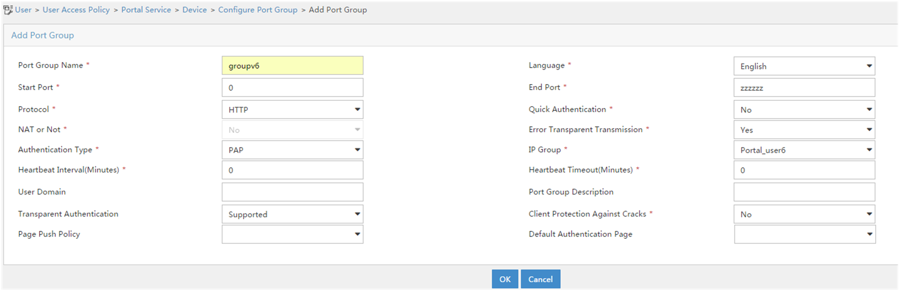

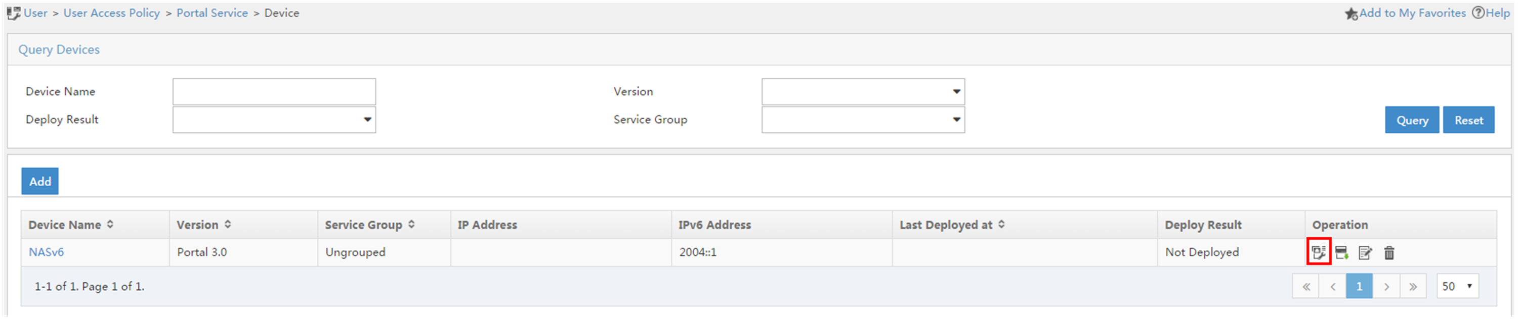

4. Associate a portal device with an IP group:
a. In the device list page, click the Port Group icon in the Operation field for a portal device
to open the port group configuration page.
Figure 10 IPv6 device list
b. Click Add to open the Add Port Group page.
- Enter the port group name.
- Select the configured IP group.
- The IP address used by the user to access the network must be within this IP group.
- Select Supported for Transparent Authentication.
- Use the default settings for other parameters.
c. Click OK.
Figure 11 Adding an IPv4 port group
Figure 12 Adding an IPv6 port group

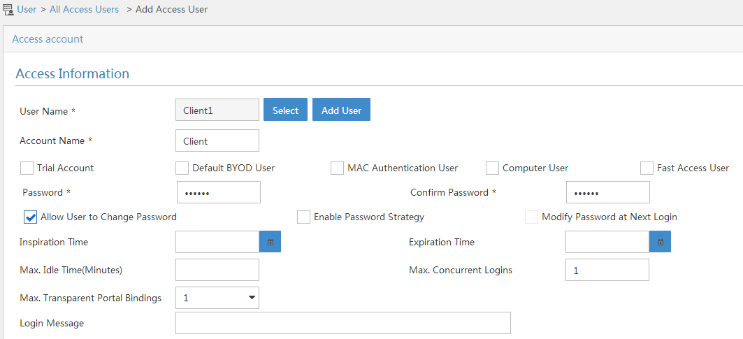

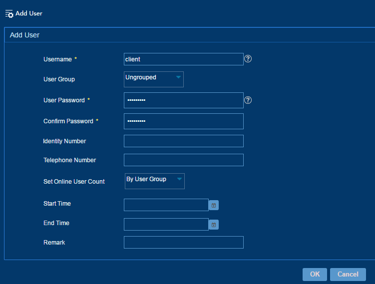

3. Add an access user:
a. From the navigation tree, select Access User > All Access Users.
b. Click Add to open the page as shown in Figure 15.
c. Click Select to select an existing access user or click Add User to add a new access user.
d. Enter the account name.
e. Set the password.
f. Select a value from the Max. Transparent Portal Bindings list.
g. Use the default settings for other parameters.
h. Click OK.
Figure 15 Adding an access user
