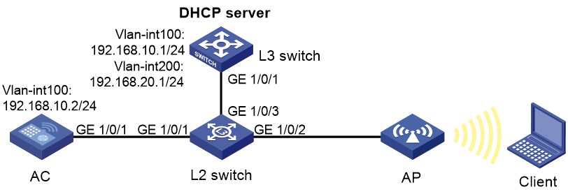

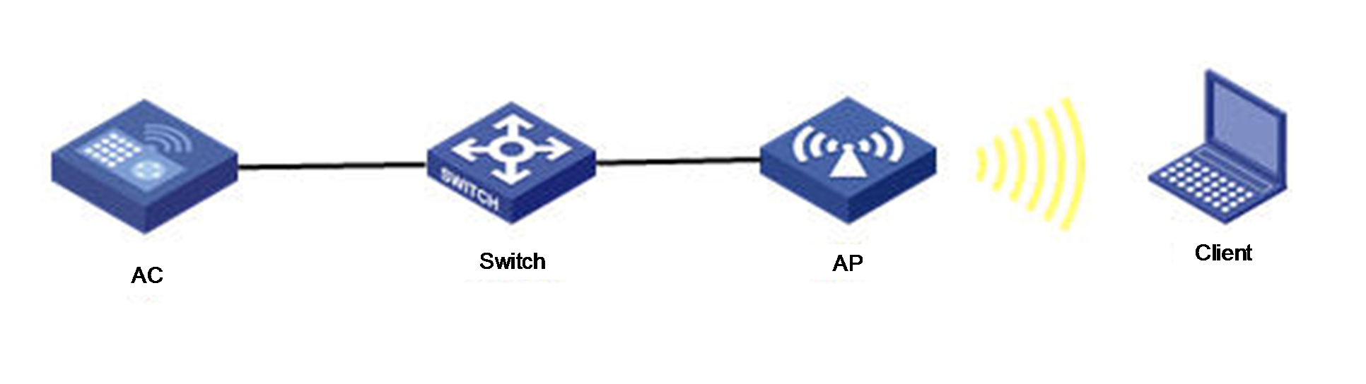

Example: Configuring an AP to associate with the AC at Layer 2

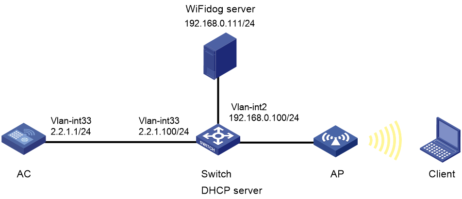

As shown in Figure 1, the AC is attached to a Layer 2 switch, and the Layer 3 switch acts as a DHCP server to assign IP addresses to the AP, client, and host. Assume centralized forwarding is used in this example.
Configure the following settings for the client to communicate with the host:
· Configure the client to access the WLAN through VLAN 200, and the host to access the network through VLAN 300.
· Assign the AC to VLAN 100, and configure the AC to establish tunnels with the AP through a Layer 2 network.
· Configure Layer 2 switch 1 to supply power to the AP through PoE.

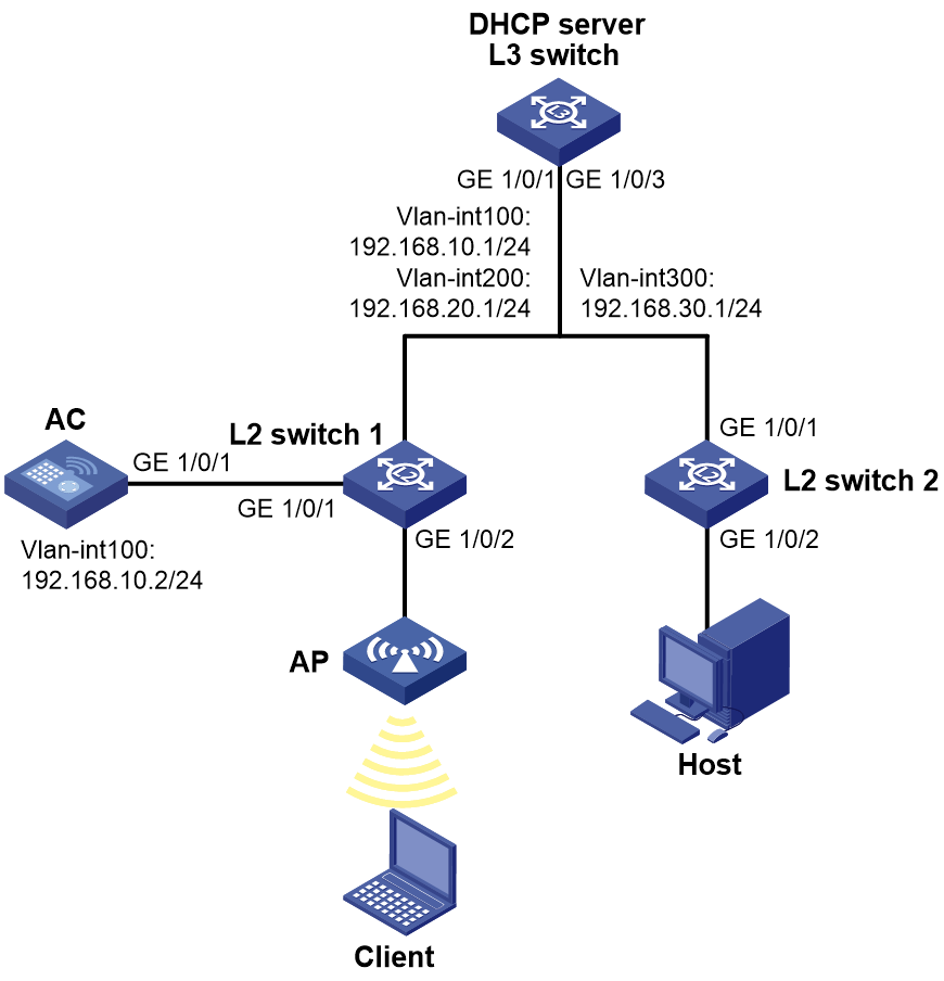

[L3 switch-GigabitEthernet1/0/1] port trunk permit vlan 100 200
[L3 switch-GigabitEthernet1/0/1] quit
# Set the link type of GigabitEthernet 1/0/2 that connects the switch to Layer 2 switch 2 to trunk, remove the port from VLAN 1, and assign the port to VLAN 300.
[L3 switch] interfac gigabitEthernet 1/0/3
[L3 switch-GigabitEthernet1/0/3] port link-type trunk
[L3 switch-GigabitEthernet1/0/3] undo port trunk permit vlan 1
[L3 switch-GigabitEthernet1/0/3] port trunk permit vlan 300
[L3 switch-GigabitEthernet1/0/3] quit
2. Configure the DHCP server:
# Enable DHCP server.
<L3 switch> system-view
[L3 switch] dhcp enable
# Create DHCP address pool 1, specify subnet 192.168.10.0/24 in the address pool, and specify the gateway address as 192.168.10.1. The switch will use this address pool to assign an IP address to the AP.
[L3 switch] dhcp server ip-pool 1
[L3 switch-dhcp-pool-1] network 192.168.10.0 mask 255.255.255.0
[L3 switch-dhcp-pool-1] gateway-list 192.168.10.1
# Exclude IP address 192.168.10.2 from dynamic allocation. The excluded IP address is the address of VLAN-interface 100 on the AC.
[L3 switch-dhcp-pool-1] forbidden-ip 192.168.10.2
[L3 switch-dhcp-pool-1] quit
# Create DHCP address pool 2, specify subnet 192.168.20.0/24 in the address pool, specify the gateway address as 192.168.20.1, and specify the address of the DNS server. In this example, the gateway also acts as the DNS server. The switch will use this address pool to assign an IP address to the client.
[L3 switch] dhcp server ip-pool 2
[L3 switch-dhcp-pool-2] network 192.168.20.0 mask 255.255.255.0
[L3 switch-dhcp-pool-2] gateway-list 192.168.20.1
[L3 switch-dhcp-pool-2] dns-list 192.168.20.1
[L3 switch-dhcp-pool-2] quit
# Create DHCP address pool 3, specify subnet 192.168.30.0/24 in the address pool, specify the gateway address as 192.168.30.1, and specify the address of the DNS server. In this example, the gateway also acts as the DNS server. The switch will use this address pool to assign an IP address to the host.
[L3 switch] dhcp server ip-pool 3
[L3 switch-dhcp-pool-3] network 192.168.30.0 mask 255.255.255.0
[L3 switch-dhcp-pool-3] gateway-list 192.168.30.1
[L3 switch-dhcp-pool-3] dns-list 192.168.30.1
[L3 switch-dhcp-pool-3] quit
Configuring the AC
1. Configure AC interfaces:
# Create VLAN 100 and VLAN-interface 100, and assign an IP address to the VLAN interface. The AC will use this IP address to establish a CAPWAP tunnel with the AP.
[AC-vlan100] quit
[AC] interface vlan-interface 100
[AC-Vlan-interface100] ip address 192.168.10.2 255.255.255.0
[AC-Vlan-interface100] quit
# Create VLAN 200. VLAN 200 will be used for client access.
[AC] vlan 200
[AC-vlan200] quit
# Configure GigabitEthernet 1/0/1 that connects the AC to Layer 2 switch 1 as a trunk port, remove the port from VLAN 1, and assign the port to VLANs 100 and 200.
[AC] interface gigabitethernet 1/0/1
[AC-GigabitEthernet1/0/1] port link-type trunk
[AC-GigabitEthernet1/0/1] undo port trunk permit vlan 1
[AC-GigabitEthernet1/0/1] port trunk permit vlan 100 200
[AC-GigabitEthernet1/0/1] quit
2. Configure wireless services:
# Create service template 1 and enter its view.
[AC] wlan service-template 1
# Configure the SSID as service.
[AC-wlan-st-1] ssid service
# Set the PSK AKM mode and specify plaintext string 12345678 as the preshared key.
[AC-wlan-st-1] akm mode psk
[AC-wlan-st-1] preshared-key pass-phrase simple 12345678
# Set the CCMP cipher suite and enable the RSE security IE.
[AC-wlan-st-1] cipher-suite ccmp
[AC-wlan-st-1] security-ie rsn
# Enable the AC to forward client data traffic. You can skip this step if the AC is the client traffic forwarder by default.
[AC-wlan-st-1] client forwarding-location ac
# Enable the service template.
[AC-wlan-st-1] service-template enable
[AC-wlan-st-1] quit
3. Configure the AP:
NOTE: In a large-scale network, configure AP groups instead of single APs as a best practice. |
# Create manual AP officeap, and specify the AP model and serial ID.
[AC] wlan ap officeap model WA6320
[AC-wlan-ap-officeap] serial-id 219801A28N819CE0002T
[AC-wlan-ap-officeap] quit
# Create AP group group1, and add the AP to the AP group.
[AC] wlan ap-group group1
[AC-wlan-ap-group-group1] ap officeap
# Bind service template 1 and VLAN 200 to radio 1.
[AC-wlan-ap-group-group1] ap-model WA6320
[AC-wlan-ap-group-group1-ap-model-WA6320] radio 1
[AC-wlan-ap-group-group1-ap-model-WA6320-radio-1] service-template 1 vlan 200
[AC-wlan-ap-group-group1-ap-model-WA6320-radio-1] radio enable
[AC-wlan-ap-group-group1-ap-model-WA6320-radio-1] quit
[AC-wlan-ap-group-group1-ap-model-WA6320] quit
[AC-wlan-ap-group-group1] quit
Configuring Layer 2 switch 1
# Create VLANs 100 and 200. The switch will use VLAN 100 to forward packets between the AC and the AP. VLAN 200 will be used for client access.
<L2 switch 1> system-view
[L2 switch 1] vlan 100
[L2 switch 1-vlan100] quit
[L2 switch 1] vlan 200
[L2 switch 1-vlan200] quit
# Configure GigabitEthernet 1/0/1 that connects the switch to the AC as a trunk port, remove the port from VLAN 1, and assign the port to VLANs 100 and 200.
[L2 switch 1] interface gigabitEthernet 1/0/1
[L2 switch 1-GigabitEthernet1/0/1] port link-type trunk
[L2 switch 1-GigabitEthernet1/0/1] undo port trunk permit vlan 1
[L2 switch 1-GigabitEthernet1/0/1] port trunk permit vlan 100 200
[L2 switch 1-GigabitEthernet1/0/1] quit
[L2 switch 1] interface gigabitEthernet 1/0/2
[L2 switch 1-GigabitEthernet1/0/2] port link-type access
[L2 switch 1-GigabitEthernet1/0/2] port access vlan 100
[L2 switch 1-GigabitEthernet1/0/2] poe enable
[L2 switch 1-GigabitEthernet1/0/2] quit
# Configure GigabitEthernet 1/0/2 that connects the switch to the Layer 3 switch as a trunk port, remove the port from VLAN 1, assign the port to VLANs 100 and 200.
[L2 switch 1] interface gigabitEthernet 1/0/3
[L2 switch 1-GigabitEthernet1/0/3] port link-type trunk
[L2 switch 1-GigabitEthernet1/0/3] undo port trunk permit vlan 1
[L2 switch 1-GigabitEthernet1/0/3] port trunk permit vlan 100 200
[L2 switch 1-GigabitEthernet1/0/3] quit
Configuring Layer 2 switch 2
# Create VLAN 300. The switch will use this VLAN for host access.
<L2 switch 2> system-view
[L2 switch 2] vlan 300
[L2 switch 2-vlan300] quit
# Set the link type of GigabitEthernet 1/0/1 that connects the switch to the Layer 3 switch to trunk, remove the port from VLAN 1, and assign the port to VLAN 300.
[L2 switch 2] interface gigabitEthernet 1/0/1
[L2 switch 2-GigabitEthernet1/0/1] port link-type trunk
[L2 switch 2-GigabitEthernet1/0/1] undo port trunk permit vlan 1
[L2 switch 2-GigabitEthernet1/0/1] port trunk permit vlan 300
[L2 switch 2-GigabitEthernet1/0/1] quit
# Set the link type of GigabitEthernet 1/0/2 that connects the switch to the host to access, and assign the port to VLAN 300.
[L2 switch 2] interface gigabitEthernet 1/0/2
[L2 switch 2-GigabitEthernet1/0/2] port link-type access
[L2 switch 2-GigabitEthernet1/0/2] port access vlan 300
[L2 switch 2-GigabitEthernet1/0/2] quit
# Verify that the AP is in R/M state.
<AC> display wlan ap all
Total number of APs: 1
Total number of connected APs: 1
Total number of connected manual APs: 1
Total number of connected auto APs: 0
Total number of connected common APs: 1
Total number of connected WTUs: 0
Total number of inside APs: 0
Maximum supported APs: 3072
Remaining APs: 3071
Total AP licenses: 512
Local AP licenses: 512
Server AP licenses: 0
Remaining local AP licenses: 511
Sync AP licenses: 0
AP information
State : I = Idle, J = Join, JA = JoinAck, IL = ImageLoad
C = Config, DC = DataCheck, R = Run, M = Master, B = Backup
AP name AP ID State Model Serial ID
officeap 1 R/M WA6320 219801A28N819CE0002T
# Verify that the client is connected to radio 1 on AP officeap.
<AC> display wlan client
Total number of clients: 1
MAC address Username AP name RID IP address IPv6 address VLAN
109a-dd9d-fc68 N/A officeap 1 192.168.20.4 N/A 200
# Verify that the client and the host can ping each other successfully.
C:\Users\system32>ping 192.168.20.4 -t
Pinging 192.168.20.4 with 32 bytes of data:
Reply from 192.168.20.4: bytes=32 time=8ms TTL=255
Reply from 192.168.20.4: bytes=32 time<1ms TTL=255
Ping statistics for 192.168.20.4:
Packets: Sent = 11, Received = 11, Lost = 0 (0% loss),
Minimum = 0ms, Maximum = 8ms, Average = 0ms
Control-C
^C
C:\Users\system32>
