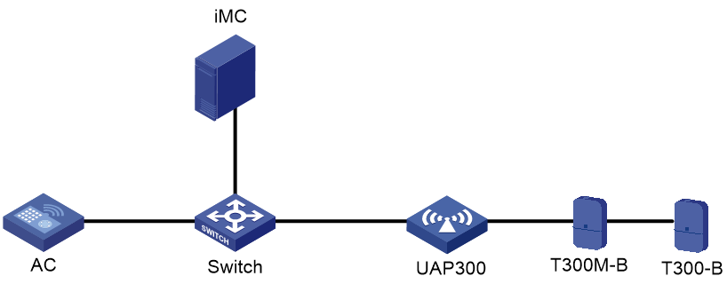

As shown in Figure 1, the IMC server acts as an IoT server, and UAP300 acts as an IoT AP to provide IoT services for the connected IoT modules T300M-B and T300-B.
When you configure iBeacon transmission for a BLE module, follow these restrictions and guidelines:
· Use the actual serial ID of an AP to uniquely identify that AP.
· Enable LLDP on the PoE switch.
· The number of cascaded T300-B connected to T300M-B depends on the power supply capacity of the uplink device (UAP300).

# Set the IPv4 address and port number for the BLE location server to 3.3.3.204 and 1145, respectively, for AP ap1.
[AC-wlan-ap-group-group1] rfid-tracking ble engine-address 3.3.3.204 engine-port 1145
# Enable BLE location for AP ap1.
[AC-wlan-ap-group-group1] rfid-tracking ble enable
# Enable neighbor list reporting for AP ap1.
[AC-wlan-ap-group-group1] rfid-tracking ble report enable
[AC-wlan-ap-group-group1] quit
