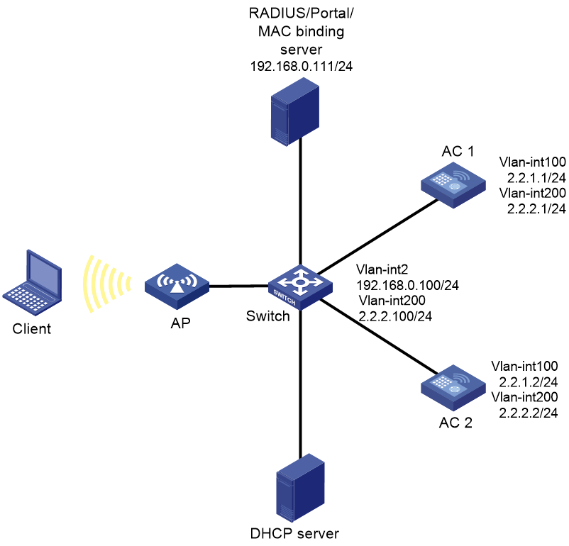

As shown in Figure 1, the AP and the client obtain IP addresses from the DHCP server. The IMC server acts as the portal authentication server, portal Web server, RADIUS server, and MAC binding server.
Configure the devices to meet the following requirements:
· The AP associates with both ACs and the two ACs to back up each other. When the master AC (AC 1) fails, the backup AC (AC 2) takes over, and the AP can provide services correctly through the backup AC.
· Direct portal authentication is used for wireless clients.
· Before passing portal authentication, the client can access only the portal Web server. After passing the authentication, the client can access other network resources.
· The client can access network resources through any Layer 2 ports in its access VLAN without re-authentication.
· The IMC server can dynamically modify user authorization information and log off clients.

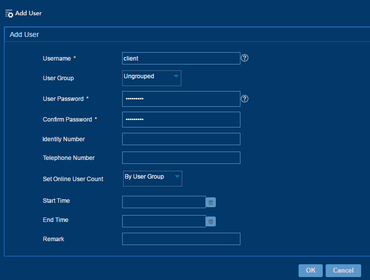

5. Add an access user.
a. From the navigation pane, select Access User > All Access Users.
b. Click Add.
c. Select an existing access user or click Add User to add a new access user.
d. Specify the account name. In this example, the name is client.
e. Set the password. In this example, the password is 1234567.
f. Select service RadiusServer.
g. Use the default settings for other parameters.
h. Click OK.

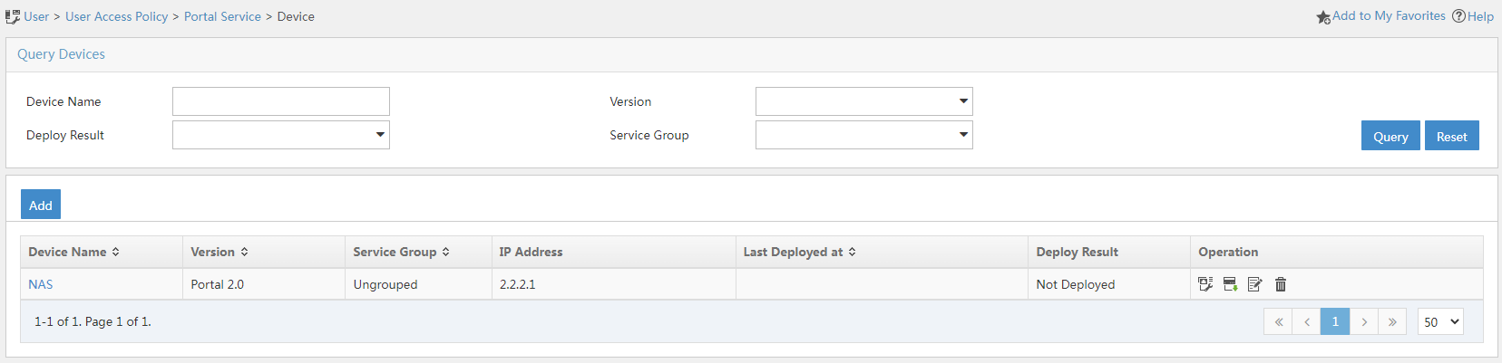

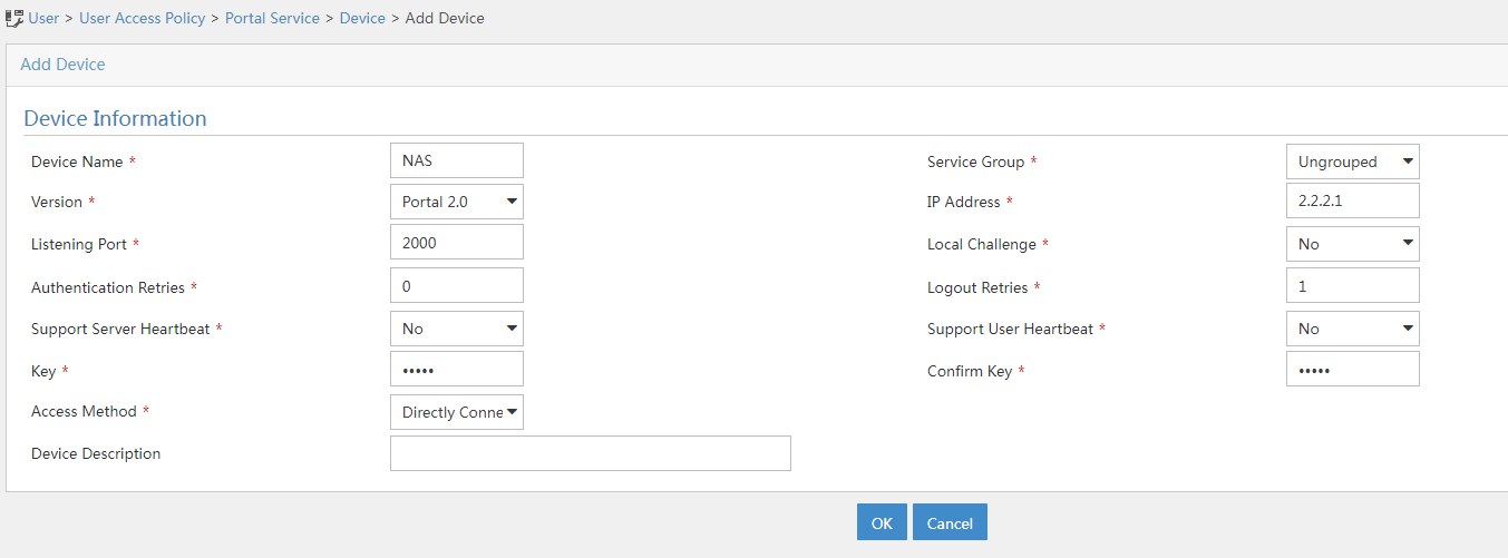

3. Add AC 1 as a portal device:
a. Select User Access Policy > Portal Service > Device from the navigation tree to open the portal device configuration page.
b. Click Add to open the page as shown in Figure 8.
c. Enter the device name.
d. Specify the version as Portal 2.0.
e. Enter the portal BAS-IP configured on AC 1 as the IP address.
f. Set whether to support the portal server heartbeat and user heartbeat functions.
In this example, select No for both Support Server Heartbeat and Support User Heartbeat.
g. Enter the key, which must be the same as that configured on the AC.
h. Select Directly Connected from the Access Method list.
i. Use the default settings for other parameters.
j. Click OK.
Figure 8 Adding a portal device
4. Repeat the previous step to add AC 2 as a portal device.

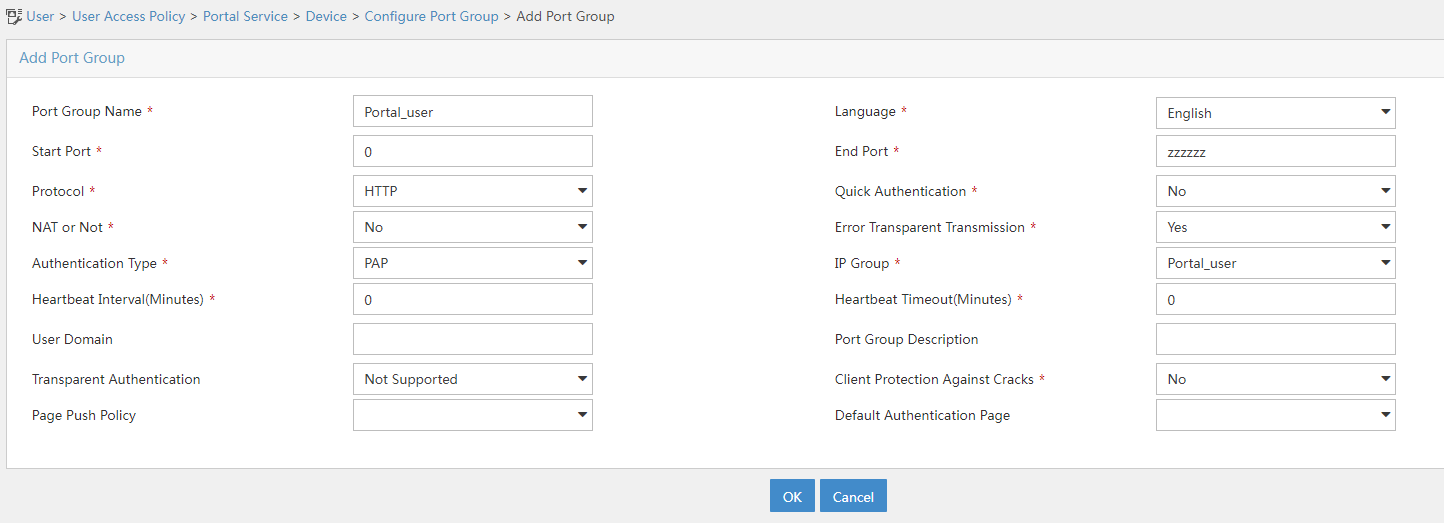

5. Associate AC 1 with the IP address group:
a. As shown in Figure 9, click
the Port Group Information Management icon for the device to
open the port group configuration page.
b. Click Add to open the page as shown in Figure 10.
c. Enter the port group name. In this example, the name is Portal_user.
d. Select the configured IP address group.
The IP address used by the user to access the network must be within this IP address group.
e. Use the default settings for other parameters.
f. Click OK.
