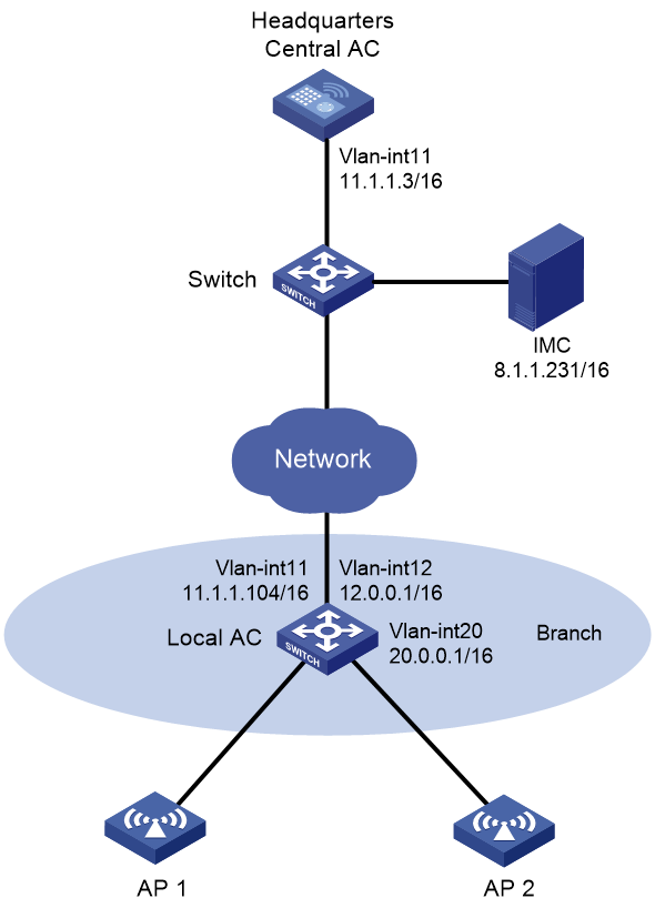

As shown in Figure 1, the AP and the client obtain IP addresses from the DHCP server.
To implement remote portal authentication, perform the following tasks:
· Configure direct portal authentication.
· Configure a portal authentication server and a portal Web server on IMC.
· Configure a RADIUS server as the authentication server and accounting server.
· Enable the AC to detect the reachability of the portal Web server and send a log message and a trap massage after server reachability status changes.
¡ When the AC detects that the portal Web server is unreachable, it stops portal authentication for wireless users. The AC allows users to have network access without portal authentication.
¡ After the portal Web server becomes reachable, the AC restarts portal authentication for wireless users that access the network. A user must pass portal authentication to access the network.

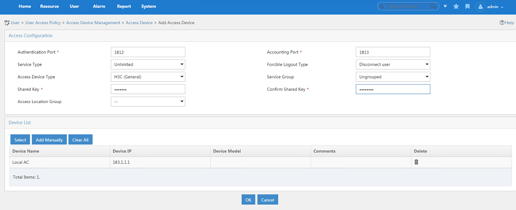

1. Add an access device:
a. Log in to IMC and click the User tab.
b. From the navigation tree, select User Access Policy > Access Device Management > Access Device.
c. Click Add to open the page as shown in Figure 2.
d. In the Device List area, click Add Manually to open the Add Access Device Manually page. Enter 2.2.2.1 in the Start IP field and then click OK.
e. In the Access Configuration area, set the shared key to radius, which must be the same as that configured on the AC.
f. Use the default settings for other parameters.
g. Click OK.
Figure 2 Adding an access device

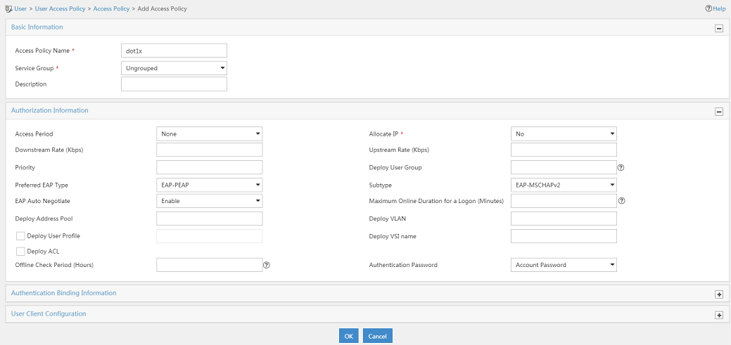

2. Add an access policy:
a. From the navigation tree, select User Access Policy > Access Policy.
b. Click Add to open the page as shown in Figure 3.
c. Enter the access policy name.
d. Select a service group. This example uses the default setting (Ungrouped).
e. Use the default settings for other parameters.
f. Click OK.
Figure 3 Adding an access policy

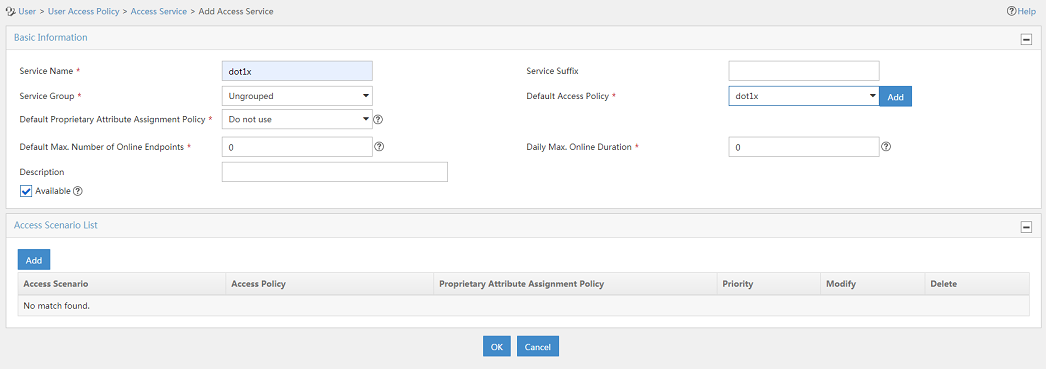

3. Add an access service:
a. From the navigation tree, select User Access Policy > Access Service.

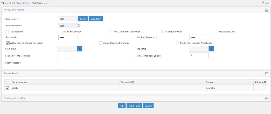

4. Add an access user:
a. From the navigation tree, select Access User > Access User.
b. Click Add to open the page as shown in Figure 5.
c. Select an existing access user or click Add User to add a new access user.
d. Set the password.
e. In the Access Service area, select the configured access service.
g. Click OK.
Figure 5 Adding an access user
