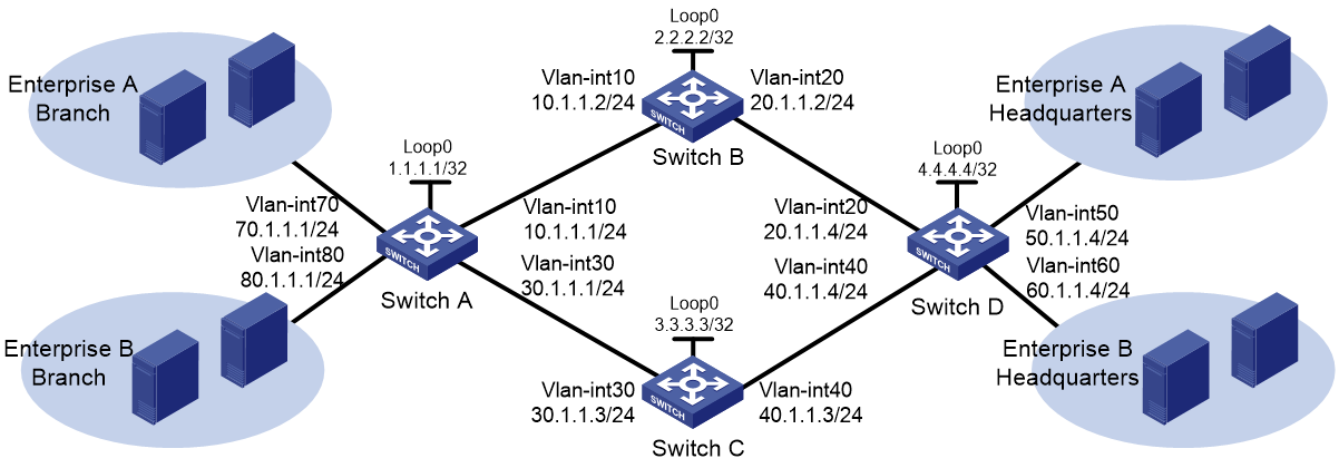

Example: Establishing MPLS TE tunnels with RSVP-TE
As shown in Figure 1, use RSVP-TE to establish two MPLS TE tunnels between Switch A and Switch D. The MPLS TE tunnel for Enterprise A requires a bandwidth of 20000 kbps. The MPLS TE tunnel for Enterprise B requires a bandwidth of 30000 kbps.
The maximum bandwidth of the link that each tunnel traverses is 50000 kbps and the maximum reservable bandwidth is 40000 kbps.
Figure 1 Network diagram
Analysis
To establish MPLS TE tunnels through RSVP-TE, you must perform the following tasks:
·     Enable MPLS, MPLS TE, and RSVP-TE on nodes that the MPLS TE tunnels traverse.
·     On each interface that the MPLS TE tunnels traverse, configure link TE attributes, including the maximum link bandwidth and the maximum reservable bandwidth.
·     On each node that the MPLS TE tunnels traverse, configure the IGP TE extension to advertise the link TE attributes, which generates a TEDB on each node.
Based on the TEDB, CSPF calculates the shortest, TE constraints-compliant path to the tunnel destination. If you do not configure the IGP TE extension, the path is created based on IGP routing. The supported IGP TE extensions are OSPF TE and ISIS TE. This example uses OSPF TE.
·     Create a tunnel interface on the ingress node of each MPLS TE tunnel, and perform the following tasks on the tunnel interface:
¡     Specify the tunnel destination address.
¡     Specify the tunnel bandwidth as required (20000 kbps for Enterprise A and 30000 kbps for Enterprise B).
¡     Specify the MPLS TE signaling protocol as RSVP-TE.
RSVP-TE advertises labels to establish CRLSPs and reserves bandwidth resources on each node along the calculated path.
·     On the ingress node of each MPLS TE tunnel, configure static routing to direct traffic to the MPLS TE tunnel.

To generate a TEDB on each node that the MPLS TE tunnels traverse, you must configure the IGP TE extension to advertise the link TE attributes. If you do not configure the IGP TE extension, the path is created based on IGP routing rather than CSPF..
Before configuration, disable the spanning tree feature globally or map each VLAN to an MSTI.

4.     Configure MPLS TE attributes of links:
# Configure the maximum link bandwidth and maximum reservable bandwidth on Switch A.
[SwitchA-Vlan-interface10] mpls te max-link-bandwidth 50000
[SwitchA-Vlan-interface10] mpls te max-reservable-bandwidth 40000
[SwitchA-Vlan-interface10] quit
[SwitchA] interface vlan-interface 30
[SwitchA-Vlan-interface30] mpls te max-link-bandwidth 50000
[SwitchA-Vlan-interface30] mpls te max-reservable-bandwidth 40000
[SwitchA-Vlan-interface30] quit
# Configure the maximum link bandwidth and maximum reservable bandwidth on Switch B.
[SwitchB] interface vlan-interface 10
[SwitchB-Vlan-interface10] mpls te max-link-bandwidth 50000
[SwitchB-Vlan-interface10] mpls te max-reservable-bandwidth 40000
[SwitchB-Vlan-interface10] quit
[SwitchB] interface vlan-interface 20
[SwitchB-Vlan-interface20] mpls te max-link-bandwidth 50000
[SwitchB-Vlan-interface20] mpls te max-reservable-bandwidth 40000
[SwitchB-Vlan-interface20] quit
# Configure the maximum link bandwidth and maximum reservable bandwidth on Switch C.
[SwitchC] interface vlan-interface 30
[SwitchC-Vlan-interface30] mpls te max-link-bandwidth 50000
[SwitchC-Vlan-interface30] mpls te max-reservable-bandwidth 40000
[SwitchC-Vlan-interface30] quit
[SwitchC] interface vlan-interface 40
[SwitchC-Vlan-interface40] mpls te max-link-bandwidth 50000
[SwitchC-Vlan-interface40] mpls te max-reservable-bandwidth 40000
[SwitchC-Vlan-interface40] quit
# Configure the maximum link bandwidth and maximum reservable bandwidth on Switch D.
[SwitchD] interface vlan-interface 20
[SwitchD-Vlan-interface20] mpls te max-link-bandwidth 50000
[SwitchD-Vlan-interface20] mpls te max-reservable-bandwidth 40000
[SwitchD-Vlan-interface20] quit
[SwitchD] interface vlan-interface 40
[SwitchD-Vlan-interface40] mpls te max-link-bandwidth 50000
[SwitchD-Vlan-interface40] mpls te max-reservable-bandwidth 40000
[SwitchD-Vlan-interface40] quit
5.     Configure OSPF TE to advertise link TE attributes:
# Enable opaque LSA advertisement and reception on Switch A. By default, the opaque LSA advertisement and reception capability is enabled.
[SwitchA] ospf
[SwitchA-ospf-1] opaque-capability enable
# Enable MPLS TE for OSPF area 0 on Switch A.
[SwitchA-ospf-1] area 0
[SwitchA-ospf-1-area-0.0.0.0] mpls te enable
[SwitchA-ospf-1-area-0.0.0.0] quit
[SwitchA-ospf-1] quit
# Enable opaque LSA advertisement and reception on Switch B. By default, the opaque LSA advertisement and reception capability is enabled.
[SwitchB] ospf
[SwitchB-ospf-1] opaque-capability enable
# Enable MPLS TE for OSPF area 0 on Switch B.
[SwitchB-ospf-1] area 0
[SwitchB-ospf-1-area-0.0.0.0] mpls te enable
[SwitchB-ospf-1-area-0.0.0.0] quit
[SwitchB-ospf-1] quit
# Enable opaque LSA advertisement and reception on Switch C. By default, the opaque LSA advertisement and reception capability is enabled.
[SwitchC] ospf
[SwitchC-ospf-1] opaque-capability enable
# Enable MPLS TE for OSPF area 0 on Switch C.
[SwitchC-ospf-1] area 0
[SwitchC-ospf-1-area-0.0.0.0] mpls te enable
[SwitchC-ospf-1-area-0.0.0.0] quit
[SwitchC-ospf-1] quit
# Enable opaque LSA advertisement and reception on Switch D. By default, the opaque LSA advertisement and reception capability is enabled.
[SwitchD] ospf
[SwitchD-ospf-1] opaque-capability enable
# Enable MPLS TE for OSPF area 0 on Switch D.
[SwitchD-ospf-1] area 0
[SwitchD-ospf-1-area-0.0.0.0] mpls te enable
[SwitchD-ospf-1-area-0.0.0.0] quit
[SwitchD-ospf-1] quit
6.     Configure MPLS TE tunnels on Switch A:
# Configure MPLS TE tunnel interface Tunnel 1 to forward traffic of Enterprise A.
[SwitchA] interface tunnel 1 mode mpls-te
[SwitchA-Tunnel1] ip address 7.1.1.1 255.255.255.0
# Specify the tunnel destination address as the LSR ID of Switch D, use RSVP-TE to establish the tunnel, and assign 20000 kbps bandwidth to the tunnel.
[SwitchA-Tunnel1] destination 4.4.4.4
[SwitchA-Tunnel1] mpls te signaling rsvp-te
[SwitchA-Tunnel1] mpls te bandwidth 20000
# Enable route recording for MPLS TE tunnel 1.
[SwitchA-Tunnel1] mpls te record-route
[SwitchA-Tunnel1] quit
# Configure MPLS TE tunnel interface Tunnel 2 to forward traffic of Enterprise B.
[SwitchA] interface tunnel 2 mode mpls-te
[SwitchA-Tunnel2] ip address 8.1.1.1 255.255.255.0
# Specify the tunnel destination address as the LSR ID of Switch D, use RSVP-TE to establish the tunnel, and assign 30000 kbps bandwidth to the tunnel.
[SwitchA-Tunnel2] destination 4.4.4.4
[SwitchA-Tunnel2] mpls te signaling rsvp-te
[SwitchA-Tunnel2] mpls te bandwidth 30000
# Enable route recording for MPLS TE tunnel 2.
[SwitchA-Tunnel2] mpls te record-route
[SwitchA-Tunnel2] quit
7.     Configure static routing on Switch A to direct traffic to the MPLS TE tunnels:
# Configure a static route to direct traffic destined for 50.1.1.0/24 to MPLS TE tunnel interface Tunnel 1.
[SwitchA] ip route-static 50.1.1.0 24 tunnel 1 preference 1
# Configure a static route to direct traffic destined for 60.1.1.0/24 to MPLS TE tunnel interface Tunnel 2.
[SwitchA] ip route-static 60.1.1.0 24 tunnel 2 preference 1
# Execute the display interface tunnel brief command on Switch A. The output shows that the two tunnel interfaces are up.
[SwitchA] display interface tunnel brief
Brief information on interfaces in route mode:
Link: ADM - administratively down; Stby - standby
Protocol: (s) - spoofing
Interface            Link Protocol Primary IP      Description
Tun1                 UP   UP       7.1.1.1
Tun2                 UP   UP       8.1.1.1
# Execute the display mpls te tunnel-interface command on Switch A to display detailed information about the MPLS TE tunnels.
[SwitchA] display mpls te tunnel-interface
Tunnel Name            : Tunnel 1
Tunnel State           : Up (Main CRLSP up, Shared-resource CRLSP down)
Tunnel Attributes      :
  LSP ID               : 27415           Tunnel ID            : 1
  Admin State          : Normal
  Ingress LSR ID       : 1.1.1.1         Egress LSR ID        : 4.4.4.4
  Signaling            : RSVP-TE         Static CRLSP Name    : -
  Resv Style           : SE
  Tunnel mode          : -
  Reverse-LSP name     : -
  Reverse-LSP LSR ID   : -               Reverse-LSP Tunnel ID: -
  Class Type           : CT0             Tunnel Bandwidth     : 20000 kbps
  Reserved Bandwidth   : 20000 kbps
  Setup Priority       : 7               Holding Priority     : 7
  Affinity Attr/Mask   : 0/0
  Explicit Path        : -
  Backup Explicit Path : -
  Metric Type          : TE
  Record Route         : Enabled         Record Label         : Disabled
  FRR Flag             : Disabled        Bandwidth Protection : Disabled
  Backup Bandwidth Flag: Disabled        Backup Bandwidth Type: -
  Backup Bandwidth     : -
  Bypass Tunnel        : No              Auto Created         : No
  Route Pinning        : Disabled
  Retry Limit          : 3               Retry Interval       : 2 sec
  Reoptimization       : Disabled        Reoptimization Freq  : -
  Backup Type          : None            Backup LSP ID        : -
  Auto Bandwidth       : Disabled        Auto Bandwidth Freq  : -
  Min Bandwidth        : -               Max Bandwidth        : -
  Collected Bandwidth  : -
Tunnel Name            : Tunnel 2
Tunnel Attributes      :
  LSP ID               : 27302           Tunnel ID            : 2
  Resv Style           : SE
  Tunnel mode          : -
  Class Type           : CT0             Tunnel Bandwidth     : 30000 kbps
  Reserved Bandwidth   : 30000 kbps
  Explicit Path        : -
  Metric Type          : TE
# Execute the display ip routing-table command on Switch A. The output shows two static route entries with output interfaces of Tunnel 1 and Tunnel 2.
[SwitchA] display ip routing-table
Destinations : 28        Routes : 29
Destination/Mask    Proto   Pre  Cost         NextHop         Interface
0.0.0.0/32          Direct  0    0            127.0.0.1       InLoop0
1.1.1.1/32          Direct  0    0            127.0.0.1       InLoop0
2.2.2.2/32          O_INTRA 10   1            10.1.1.2        Vlan10
3.3.3.3/32          O_INTRA 10   1            30.1.1.3        Vlan30
4.4.4.4/32          O_INTRA 10   2            10.1.1.2        Vlan10
                                             30.1.1.3        Vlan30
7.1.1.0/24          Direct  0    0            7.1.1.1         Tun1
7.1.1.0/32          Direct  0    0            7.1.1.1         Tun1
7.1.1.1/32          Direct  0    0            127.0.0.1       InLoop0
7.1.1.255/32        Direct  0    0            7.1.1.1         Tun1
8.1.1.0/24          Direct  0    0            8.1.1.1         Tun2
8.1.1.0/32          Direct  0    0            8.1.1.1         Tun2
8.1.1.1/32          Direct  0    0            127.0.0.1       InLoop0
8.1.1.255/32        Direct  0    0            8.1.1.1         Tun2
10.1.1.0/24         Direct  0    0            10.1.1.1        Vlan10
10.1.1.0/32         Direct  0    0            10.1.1.1        Vlan10
10.1.1.1/32         Direct  0    0            127.0.0.1       InLoop0
10.1.1.255/32       Direct  0    0            10.1.1.1        Vlan10
50.1.1.0/24         Static  1    0            0.0.0.0         Tun1
30.1.1.0/24         Direct  0    0            30.1.1.1        Vlan30
30.1.1.0/32         Direct  0    0            30.1.1.1        Vlan30
30.1.1.1/32         Direct  0    0            127.0.0.1       InLoop0
30.1.1.255/32       Direct  0    0            30.1.1.1        Vlan30
60.1.1.0/24         Static  1    0            0.0.0.0         Tun2
127.0.0.0/8         Direct  0    0            127.0.0.1       InLoop0
127.0.0.0/32        Direct  0    0            127.0.0.1       InLoop0
127.0.0.1/32        Direct  0    0            127.0.0.1       InLoop0
127.255.255.255/32  Direct  0    0            127.0.0.1       InLoop0
255.255.255.255/32  Direct  0    0            127.0.0.1       InLoop0
# Execute the display rsvp lsp verbose command on Switch A to verify the following information:
·     Tunnel 1 uses path Switch A—Switch B—Switch D, and has a bandwidth of 20000 kbps.
·     Tunnel 2 uses path Switch A—Switch C—Switch D, and has a bandwidth of 30000 kbps.
[SwitchA] display rsvp lsp verbose
Tunnel name: SwitchA_t1
Destination: 4.4.4.4                      Source: 1.1.1.1
Tunnel ID: 1                              LSP ID: 27415
LSR type: Ingress                         Direction: Unidirectional
Setup priority: 7                         Holding priority: 7
In-Label: -                               Out-Label: 1146
In-Interface: -                           Out-Interface: Vlan10
Nexthop: 10.1.1.2                         Exclude-any: 0
Include-Any: 0                            Include-all: 0
Mean rate (CIR): 20000 kbps               Mean burst size (CBS): 1000.00 bytes
Path MTU: 1500                            Class type: CT0
RRO number: 6
  10.1.1.1/32        Flag: 0x00 (No FRR)
  10.1.1.2/32        Flag: 0x00 (No FRR)
  2.2.2.2/32         Flag: 0x20 (No FRR/Node-ID)
  20.1.1.2/32        Flag: 0x00 (No FRR)
  20.1.1.4/32        Flag: 0x00 (No FRR)
  4.4.4.4/32         Flag: 0x20 (No FRR/Node-ID)
Fast Reroute protection: None
Tunnel name: SwitchA_t2
Tunnel ID: 2                              LSP ID: 27302
In-Label: -                               Out-Label: 1150
In-Interface: -                           Out-Interface: Vlan30
Nexthop: 30.1.1.3                         Exclude-any: 0
Mean rate (CIR): 30000 kbps               Mean burst size (CBS): 1000.00 bytes
RRO number: 6
  30.1.1.1/32        Flag: 0x00 (No FRR)
  30.1.1.3/32        Flag: 0x00 (No FRR)
  3.3.3.3/32         Flag: 0x20 (No FRR/Node-ID)
  40.1.1.3/32        Flag: 0x00 (No FRR)
  40.1.1.4/32        Flag: 0x00 (No FRR)

vlan 10
vlan 30
vlan 70
vlan 80
mpls te
rsvp
interface LoopBack0
 ip address 1.1.1.1 255.255.255.255
interface Vlan-interface10
 mpls enable
 mpls te enable
 rsvp enable
interface Vlan-interface30
 ip address 30.1.1.1 255.255.255.0
 mpls enable
 mpls te enable
 rsvp enable
interface Vlan-interface70
 ip address 70.1.1.1 255.255.255.0
interface Vlan-interface80
 ip address 80.1.1.1 255.255.255.0
interface Twenty-FiveGigE1/0/1
 port link-mode bridge
 port access vlan 10
interface Twenty-FiveGigE1/0/2
 port access vlan 30
interface Twenty-FiveGigE1/0/3
 port access vlan 70
interface Twenty-FiveGigE1/0/4
 port access vlan 80
interface Tunnel1 mode mpls-te
 mpls te bandwidth ct0 20000
 destination 4.4.4.4
interface Tunnel2 mode mpls-te
 mpls te bandwidth ct0 30000
 destination 4.4.4.4
 ip route-static 50.1.1.0 24 Tunnel1 preference 1
 ip route-static 60.1.1.0 24 Tunnel2 preference 1
·     Switch B:
ospf 1
 area 0.0.0.0
  network 2.2.2.2 0.0.0.0
  network 10.1.1.0 0.0.0.255
  network 20.1.1.0 0.0.0.255
  mpls te enable
 mpls lsr-id 2.2.2.2
vlan 10
vlan 20
mpls te
rsvp
interface LoopBack0
 ip address 2.2.2.2 255.255.255.255
 ip address 10.1.1.2 255.255.255.0
 mpls enable
 mpls te enable
 rsvp enable
interface Vlan-interface20
 ip address 20.1.1.2 255.255.255.0
 mpls enable
 mpls te enable
 rsvp enable
 port access vlan 10
 port access vlan 20
·     Switch C:
ospf 1
 area 0.0.0.0
  network 3.3.3.3 0.0.0.0
  network 30.1.1.0 0.0.0.255
  network 40.1.1.0 0.0.0.255
  mpls te enable
 mpls lsr-id 3.3.3.3
vlan 30
vlan 40
mpls te
rsvp
interface LoopBack0
 ip address 3.3.3.3 255.255.255.0
 ip address 30.1.1.3 255.255.255.0
 mpls enable
 mpls te enable
 rsvp enable
interface Vlan-interface40
 ip address 40.1.1.3 255.255.255.0
 mpls enable
 mpls te enable
 rsvp enable
 port access vlan 40
 port access vlan 30
·     Switch D:
ospf 1
 area 0.0.0.0
  network 4.4.4.4 0.0.0.0
  mpls te enable
 mpls lsr-id 4.4.4.4
vlan 20
vlan 40
vlan 50
vlan 60
mpls te
rsvp
interface LoopBack0
 ip address 4.4.4.4 255.255.255.255
 ip address 20.1.1.4 255.255.255.0
 mpls enable
 mpls te enable
 rsvp enable
 ip address 40.1.1.4 255.255.255.0
 mpls enable
 mpls te enable
 rsvp enable
interface Vlan-interface50
 ip address 50.1.1.4 255.255.255.0
interface Vlan-interface60
 ip address 60.1.1.4 255.255.255.0
 port access vlan 40
 port access vlan 20
 port access vlan 50
 port access vlan 60

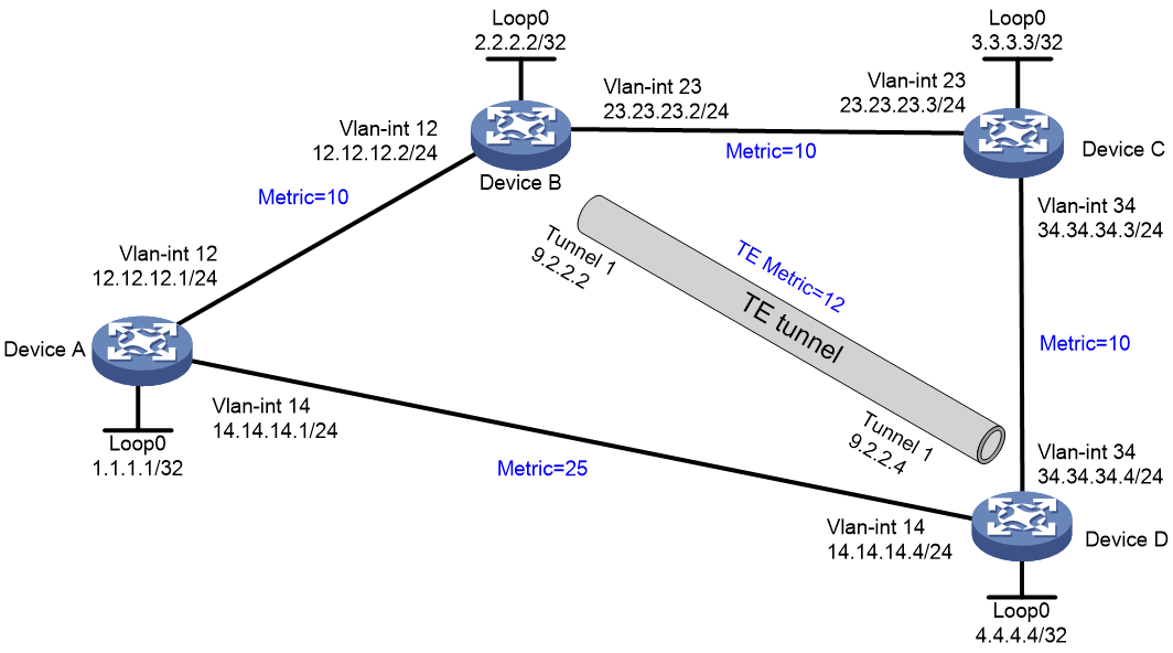

Example: Configuring MPLS TE forwarding adjacency
As shown in Figure 2, Device A, Device B, Device C, and Device D run OSPF.
Establish an MPLS TE tunnel from Device B to Device D that uses the path Device B—Device C—Device D, and configure MPLS TE forwarding adjacency for the tunnel.
Before the tunnel is established, traffic from Device A to Device D is forwarded through the direct link Device A—Device D. After the tunnel is established, the traffic is forwarded through the MPLS TE tunnel.
Figure 2 Network diagram
Analysis
·     Enable MPLS TE on nodes and interfaces that the MPLS TE tunnels traverse.
·     To make forwarding adjacency take effect, you must establish two MPLS TE tunnels in opposite directions between Device B and Device D, and enable forwarding adjacency on both devices.
·     For the MPLS TE tunnel to use the path Device B—Device C—Device D, configure the path as the explicit path for the tunnel.
·     For traffic from Device A to Device D to be forwarded through the MPLS TE tunnel, make sure the tunnel's metric is less than 15 (metric 25 minus 10). This example uses 12.
Hardware
Software version
S6812 switch series
S6813 switch series
Not supported
S6550XE-HI switch series
Release 6008 and later, Release 8106Pxx
S6525XE-HI switch series
S5850 switch series
Not supported
S5570S-EI switch series
Not supported
S5560X-EI switch series
Not supported
S5560X-HI switch series
Not supported
S5500V2-EI switch series
Not supported
MS4520V2-30F switch
Not supported
MS4520V2-30C switch
MS4520V2-54C switch
Not supported
MS4520V2-28S switch
MS4520V2-24TP switch
Not supported
S6520X-HI switch series
S6520X-EI switch series
Not supported
S6520X-SI switch series
S6520-SI switch series
Not supported
S5000-EI switch series
Not supported
MS4600 switch series
Not supported
ES5500 switch series
Not supported
S5560S-EI switch series
S5560S-SI switch series
Not supported
S5500V3-24P-SI switch
S5500V3-48P-SI switch
Not supported
S5500V3-SI switch series (except S5500V3-24P-SI and S5500V3-48P-SI switches)
Not supported
S5170-EI switch series
Not supported
S5130S-HI switch series
S5130S-EI switch series
S5130S-SI switch series
S5130S-LI switch series
Not supported
S5120V2-SI switch series
S5120V2-LI switch series
Not supported
S5120V3-EI switch series
Not supported
S5120V3-36F-SI
S5120V3-28P-HPWR-SI
S5120V3-54P-PWR-SI
Not supported
S5120V3-SI switch series (except S5120V3-36F-SI, S5120V3-28P-HPWR-SI, and S5120V3-54P-PWR-SI switches)
Not supported
S5120V3-LI switch series
Not supported
S3600V3-EI switch series
Not supported
S3600V3-SI switch series
Not supported
S3100V3-EI switch series
S3100V3-SI switch series
Not supported
S5110V2 switch series
Not supported
S5110V2-SI switch series
Not supported
S5000V3-EI switch series
S5000V5-EI switch series
Not supported
S5000E-X switch series
S5000X-EI switch series
Not supported
E128C switch
E152C switch
E500C switch series
E500D switch series
Not supported
MS4320V2 switch series
MS4300V2 switch series
MS4320 switch series
MS4200 switch series
Not supported
WS5850-WiNet switch series
Not supported
WS5820-WiNet switch series
WS5810-WiNet switch series
Not supported
WAS6000 switch series
Not supported
IE4300-12P-AC switch
IE4300-12P-PWR switch
IE4300-M switch series
IE4320 switch series
Not supported
IE4520 switch series
Not supported
S5135S-EI switch series
Not supported
By default, interfaces on the device are disabled (in ADM or Administratively Down state). To have an interface operate, you must use the undo shutdown command to enable that interface.
Procedures
1.     Configure IP addresses for interfaces, configure basic OSPF, and set OSPF costs. (Details not shown.) For the configuration, see "Configuration files."
2.     Enable MPLS TE on each node and interface that the MPLS TE tunnel traverses:
# On Device B, configure an LSR ID, and enable MPLS, MPLS TE, and RSVP-TE.
<DeviceB> system-view
[DeviceB] mpls lsr-id 2.2.2.2
[DeviceB] mpls te
[DeviceB-te] quit
[DeviceB] rsvp
[DeviceB-rsvp] quit
[DeviceB] interface vlan-interface 23
[DeviceB-Vlan-interface23] mpls enable
[DeviceB-Vlan-interface23] mpls te enable
[DeviceB-Vlan-interface23] rsvp enable
[DeviceB-Vlan-interface23] quit
# On Device C, configure an LSR ID, and enable MPLS, MPLS TE, and RSVP-TE.
<DeviceC> system-view
[DeviceC] mpls lsr-id 3.3.3.3
[DeviceC] mpls te
[DeviceC-te] quit
[DeviceC] rsvp
[DeviceC-rsvp] quit
[DeviceC] interface vlan-interface 23
[DeviceC-Vlan-interface23] mpls enable
[DeviceC-Vlan-interface23] mpls te enable
[DeviceC-Vlan-interface23] rsvp enable
[DeviceC-Vlan-interface23] quit
[DeviceC] interface vlan-interface 34
[DeviceC-Vlan-interface34] mpls enable
[DeviceC-Vlan-interface34] mpls te enable
[DeviceC-Vlan-interface34] rsvp enable
[DeviceC-Vlan-interface34] quit
# On Device D, configure an LSR ID, and enable MPLS, MPLS TE, and RSVP-TE.
<DeviceD> system-view
[DeviceD] mpls lsr-id 4.4.4.4
[DeviceD] mpls te
[DeviceD-te] quit
[DeviceD] rsvp
[DeviceD-rsvp] quit
[DeviceD] interface vlan-interface 34
[DeviceD-Vlan-interface34] mpls enable
[DeviceD-Vlan-interface34] mpls te enable
[DeviceD-Vlan-interface34] rsvp enable
[DeviceD-Vlan-interface34] quit
3.     Configure OSPF TE to advertise link TE attributes:
# On Device B, enable opaque LSA advertisement and reception, and enable MPLS TE for OSPF area 0. By default, opaque LSA advertisement and reception are enabled.
[DeviceB] ospf
[DeviceB-ospf-1] opaque-capability enable
[DeviceB-ospf-1] area 0
[DeviceB-ospf-1-area-0.0.0.0] mpls te enable
[DeviceB-ospf-1-area-0.0.0.0] quit
[DeviceB-ospf-1] quit
# On Device C, enable opaque LSA advertisement and reception, and enable MPLS TE for OSPF area 0. By default, opaque LSA advertisement and reception are enabled.
[DeviceC] ospf
[DeviceC-ospf-1] opaque-capability enable
[DeviceC-ospf-1] area 0
[DeviceC-ospf-1-area-0.0.0.0] mpls te enable
[DeviceC-ospf-1-area-0.0.0.0] quit
[DeviceC-ospf-1] quit
# On Device D, enable opaque LSA advertisement and reception, and enable MPLS TE for OSPF area 0. By default, opaque LSA advertisement and reception are enabled.
[DeviceD] ospf
[DeviceD-ospf-1] opaque-capability enable
[DeviceD-ospf-1] area 0
[DeviceD-ospf-1-area-0.0.0.0] mpls te enable
[DeviceD-ospf-1-area-0.0.0.0] quit
[DeviceD-ospf-1] quit
4.     Configure MPLS TE tunnels:
# On Device B, configure MPLS TE tunnel interface Tunnel 1, and specify the tunnel destination address as the LSR ID of Device D.
[DeviceB] interface tunnel 1 mode mpls-te
[DeviceB-Tunnel1] ip address 9.2.2.2 255.255.255.0
[DeviceB-Tunnel1] destination 4.4.4.4
# Configure MPLS TE to use RSVP-TE to establish the tunnel.
[DeviceB-Tunnel1] mpls te signaling rsvp-te
[DeviceB-Tunnel1] quit
# Configure an explicit path named tun1.
[DeviceB] explicit-path tun1
[DeviceB-explicit-path-tun1] nexthop 23.23.23.3
[DeviceB-explicit-path-tun1] nexthop 34.34.34.4
[DeviceB-explicit-path-tun1]quit
# Specify explicit path tun1 for the tunnel.
[DeviceB–Tunnel1] mpls te path preference 1 explicit-path tun1
# Enable forwarding adjacency for the tunnel.
[DeviceB-Tunnel1] mpls te igp advertise
# Enable OSPF on tunnel interface Tunnel 1 and set the OSPF cost to 12 for the tunnel interface.
[DeviceB-Tunnel1] ospf 1 area 0
[DeviceB-Tunnel1] ospf cost 12
# On Device D, configure MPLS TE tunnel interface Tunnel 1, and specify the tunnel destination address as the LSR ID of Device B.
[DeviceD] interface tunnel 1 mode mpls-te
[DeviceD-Tunnel1] ip address 9.2.2.4  255.255.255.0
[DeviceD-Tunnel1] destination 2.2.2.2
[DeviceD-Tunnel1] mpls te signaling rsvp-te
[DeviceD-Tunnel1] quit
[DeviceD] explicit-path tun1
[DeviceD-explicit-path-tun1] nexthop 34.34.34.3
[DeviceD-explicit-path-tun1] nexthop 23.23.23.2
[DeviceD-explicit-path-tun1]quit
[DeviceD–Tunnel1] mpls te path preference 1 explicit-path tun1
[DeviceD-Tunnel1] mpls te igp advertise
[DeviceD-Tunnel1] ospf 1 area 0
[DeviceD-Tunnel1] ospf cost 12
# Execute the display interface tunnel brief command on Device B and Device D. This example uses Device B. The output shows that Tunnel 1 is up.
[DeviceB] display interface tunnel brief
Tun1                 UP   UP       9.2.2.2
# Display routing table information on Device A. The output shows that the next hop of the route to Device D is Device B, and the cost is 22 (10 plus 12). The MPLS TE tunnel has been used during IGP route calculation.
[Device A] display ip routing-table
Destinations : 22        Routes : 22
2.2.2.2/32         O_INTRA 10  10          12.12.12.2      Vlan12
3.3.3.3/32         O_INTRA 10  20          12.12.12.2      Vlan12
4.4.4.4/32         O_INTRA 10  22          12.12.12.2      Vlan12
9.2.2.0/24         O_INTRA 10  22          12.12.12.2      Vlan12
10.1.0.3/32        Direct  0   0           127.0.0.1       InLoop0
12.12.12.0/24      Direct  0   0           12.12.12.1      Vlan12
12.12.12.0/32      Direct  0   0           12.12.12.1      Vlan12
12.12.12.1/32      Direct  0   0           127.0.0.1       InLoop0
12.12.12.255/32    Direct  0   0           12.12.12.1      Vlan12

Configuration files
·     Device A:
ospf 1
 area 0.0.0.0
  network 1.1.1.1 0.0.0.0
  network 12.12.12.0 0.0.0.255
  network 14.14.14.0 0.0.0.255
vlan 12
vlan 14
interface LoopBack0
interface Vlan-interface12
 ip address 12.12.12.1 255.255.255.0
 ospf cost 10
interface Vlan-interface14
 ip address 14.14.14.1 255.255.255.0
 ospf cost 25
 port access vlan 12
 port access vlan 14
·     Device B:
ospf 1
 area 0.0.0.0
  network 23.23.23.0 0.0.0.255
  mpls te enable
 mpls lsr-id 2.2.2.2
vlan 12
vlan 23
mpls te
explicit-path tun1
 nexthop index 1 23.23.23.3 include strict
 nexthop index 101 34.34.34.4 include strict
rsvp
interface LoopBack0
 ip address 12.12.12.2 255.255.255.0
 ospf cost 10
interface Vlan-interface23
 ip address 23.23.23.2 255.255.255.0
 ospf cost 10
 mpls enable
 mpls te enable
 rsvp enable
 port access vlan 12
 port access vlan 23
 ospf cost 12
 ospf 1 area 0.0.0.0
 destination 4.4.4.4
·     Device C:
ospf 1
 area 0.0.0.0
  network 34.34.34.0 0.0.0.255
  mpls te enable
 mpls lsr-id 3.3.3.3
vlan 23
vlan 34
mpls te
rsvp
interface LoopBack0
 ip address 3.3.3.3 255.255.255.255
 ip address 23.23.23.3 255.255.255.0
 ospf cost 10
 mpls enable
 mpls te enable
 rsvp enable
interface Vlan-interface34
 ip address 34.34.34.3 255.255.255.0
 ospf cost 10
 mpls enable
 mpls te enable
 rsvp enable
 port access vlan 34
 port access vlan 23
·     Device D:
ospf 1
 area 0.0.0.0
  mpls te enable
 mpls lsr-id 4.4.4.4
vlan 14
vlan 34
mpls te
explicit-path tun1
 nexthop index 1 34.34.34.3 include strict
 nexthop index 101 23.23.23.2 include strict
rsvp
interface LoopBack0
 ip address 14.14.14.4 255.255.255.0
 ospf cost 25
 ip address 34.34.34.4 255.255.255.0
 ospf cost 10
 mpls enable
 mpls te enable
 rsvp enable
 port access vlan 34
 port access vlan 14
 ospf cost 12
 ospf 1 area 0.0.0.0
 destination 2.2.2.2

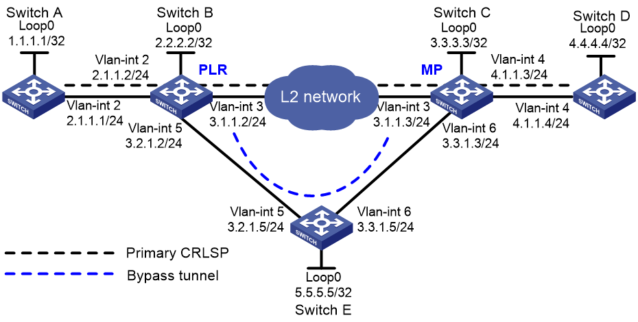

Example: Configuring MPLS TE FRR
As shown in Figure 3, on the primary CRLSP Switch ASwitch B—Switch C—Switch D, configure MPLS TE FRR to protect the link Switch B—Switch C. When the link between Switch B and Switch C fails, MPLS TE can immediately switch traffic to the bypass tunnel Switch B—Switch E—Switch C.
The primary CRLSP and the bypass tunnel each require a bandwidth of 30000 kbps. The maximum bandwidth of the link that each tunnel traverses is 50000 kbps and the maximum reservable bandwidth is 40000 kbps.
Figure 3 Network diagram
Analysis
To implement MPLS TE FRR, you must perform the following tasks:
·     Enable MPLS, MPLS TE, and RSVP-TE on each switch for primary and bypass tunnel establishment.
·     Configure explicit paths for the primary CRLSP and the bypass tunnel as required.
·     Configure BFD for RSVP-TE on Switch B and Switch C for quick detection of the link failure.
BFD can immediately detect the failure of the protected link and notify RSVP-TE of the failure.
·     Configure MPLS TE FRR on the ingress node of the primary CRLSP to ensure that traffic can be immediately switched to the bypass tunnel when BFD detects the failure of the protected link.
·     If multiple bypass tunnels are specified for a primary CRLSP, MPLS TE selects an optimal bypass tunnel to protect the primary CRLSP. To make sure an optimal bypass tunnel is always selected, set the optimal bypass tunnel selection interval to 5 seconds on the PLR. The default interval for selecting an optimal bypass tunnel is 300 seconds.

When you configure MPLS TE FRR, follow these restrictions and guidelines:
·     Before configuration, disable the spanning tree feature globally or map each VLAN to an MSTI.
·     Only MPLS TE tunnels established through RSVP-TE support FRR.
·      Do not configure both FRR and RSVP authentication on the same interface.
·     Use bypass tunnels to protect only critical interfaces or links when bandwidth is insufficient. Bypass tunnels are pre-established and require extra bandwidth.
·      Make sure the bandwidth assigned to the bypass tunnel is no less than the total bandwidth needed by all primary CRLSPs to be protected by the bypass tunnel. Otherwise, some primary CRLSPs might not be protected by the bypass tunnel.
·      A bypass tunnel typically does not forward data when the primary CRLSP operates correctly. For a bypass tunnel to also forward data during tunnel protection, you must assign adequate bandwidth to the bypass tunnel.
·      A bypass tunnel cannot be used for services such as VPN.
·     You cannot configure FRR for a bypass tunnel. A bypass tunnel cannot act as a primary CRLSP.
·     Make sure the protected node or interface is not on the bypass tunnel.
·     After you associate a primary CRLSP that does not require bandwidth protection with a bypass tunnel that provides bandwidth protection, the primary CRLSP occupies the bandwidth that the bypass tunnel protects. The bandwidth is protected on a first-come-first-served basis. The primary CRLSP that needs bandwidth protection cannot preempt the one that does not need bandwidth protection.
·     After an FRR, the primary CRLSP will be down if you modify the bandwidth that the bypass tunnel can protect and your modification results in one of the following:
¡     The CT type changes.
¡     The bypass tunnel cannot protect adequate bandwidth as configured.
¡     FRR protection type (whether or not to provide bandwidth protection for the primary CRLSP) changes.

7.     Configure a bypass tunnel on Switch B (the PLR):
# Configure an explicit path named by-path for the bypass tunnel.
[SwitchB] explicit-path by-path
[SwitchB-explicit-path-by-path] nexthop 3.2.1.5
[SwitchB-explicit-path-by-path] nexthop 3.3.1.3
[SwitchB-explicit-path-by-path] nexthop 3.3.3.3
[SwitchB-explicit-path-by-path] quit
# Configure MPLS TE tunnel interface Tunnel 5 for the bypass tunnel.
[SwitchB] interface tunnel 5 mode mpls-te
[SwitchB-Tunnel5] ip address 11.1.1.1 255.255.255.0
# Specify the tunnel destination address as the LSR ID of Switch C and configure MPLS TE to use RSVP-TE to establish the tunnel.
[SwitchB-Tunnel5] destination 3.3.3.3
[SwitchB-Tunnel5] mpls te signaling rsvp-te
# Set the bandwidth that the bypass tunnel can protect to 30000 kbps.
[SwitchB-Tunnel5] mpls te backup bandwidth 30000
# Specify the explicit path to be used as by-path.
[SwitchB-Tunnel5] mpls te path preference 1 explicit-path by-path
[SwitchB-Tunnel5] quit
# Bind the bypass tunnel to the protected interface.
[SwitchB] interface vlan-interface 3
[SwitchB-Vlan-interface3] mpls te fast-reroute bypass-tunnel tunnel 5
[SwitchB-Vlan-interface3] quit
# Execute the display interface tunnel brief command on Switch B. The output shows that tunnel interface Tunnel 5 is up.
[SwitchB] display interface tunnel brief
Tun5                 UP   DOWN     11.1.1.1

# Execute the display mpls lsp command on Switch B. The output shows that the bypass tunnel is in use.
[SwitchB] display mpls lsp
FEC                         Proto    In/Out Label    Interface/Out NHLFE
1.1.1.1/4/37325             RSVP     1150/1147       Tun5
2.2.2.2/5/18928             RSVP     -/1149          Vlan5
3.2.1.5                     Local    -/-             Vlan5
Tunnel5                     Local    -/-             NHLFE1027
# On the PLR, configure the interval for selecting an optimal bypass tunnel as 5 seconds.
[SwitchB] mpls te
[SwitchB-te] fast-reroute timer 5
[SwitchB-te] quit
# On the PLR, bring up the protected interface VLAN-interface 3.
[SwitchB-Vlan-interface3] undo shutdown
# Execute the display interface tunnel 4 brief command on Switch A. The output shows that the tunnel interface is in up state.
[SwitchA] display interface tunnel 4 brief
Tun4                 UP   UP       10.1.1.1
# Wait for about 5 seconds, execute the display mpls lsp verbose command on Switch B. The output shows that Tunnel 5 is bound to interface VLAN-interface 3 but is not in use.
[SwitchB] display mpls lsp verbose
Destination  : 4.4.4.4
FEC          : 1.1.1.1/4/53319
Protocol     : RSVP
LSR Type     : Transit
Service      : -
In-Label     : 1150
Path ID      : 0x540000003.1
State        : Active
Out-Label    : 1150
Nexthop      : 3.1.1.3
BkLabel      : 1150
BkInterface  : Tun5
Destination  : 3.3.3.3
FEC          : 2.2.2.2/5/16429
Protocol     : RSVP
LSR Type     : Ingress
Service      : -
NHLFE ID     : 1025
State        : Active
Out-Label    : 1151
Nexthop      : 3.2.1.5
Out-Interface: Vlan5
Destination  : 3.1.1.3
FEC          : 3.1.1.3
Protocol     : Local
LSR Type     : Ingress
Service      : -
NHLFE ID     : 1027
State        : Active
Nexthop      : 3.1.1.3
Destination  : 3.2.1.5
FEC          : 3.2.1.5
Protocol     : Local
LSR Type     : Ingress
Service      : -
NHLFE ID     : 1024
State        : Active
Nexthop      : 3.2.1.5
FEC          : Tunnel5
Protocol     : Local
LSR Type     : Ingress
Service      : -
NHLFE ID     : 268435461
State        : Active
Out-Interface: NHLFE1025

Configuration files
·     Switch A:
ospf 1
 area 0.0.0.0
  network 2.1.1.0 0.0.0.255
  mpls te enable
 mpls lsr-id 1.1.1.1
vlan 2
mpls te
explicit-path pri-path
 nexthop index 1 2.1.1.2 include strict
 nexthop index 101 3.1.1.3 include strict
 nexthop index 201 4.1.1.4 include strict
 nexthop index 301 4.4.4.4 include strict
rsvp
interface LoopBack0
 ip address 2.1.1.1 255.255.255.0
 mpls enable
 mpls te enable
 rsvp enable
 port access vlan 2
interface Tunnel4 mode mpls-te
 mpls te path preference 1 explicit-path pri-path
 destination 4.4.4.4
ip route-static 4.1.1.0 24 Tunnel4 preference 1
·     Switch B:
ospf 1
 area 0.0.0.0
  network 3.1.1.0 0.0.0.255
  network 3.2.1.0 0.0.0.255
  mpls te enable
 mpls lsr-id 2.2.2.2
vlan 2 to 3
vlan 5
mpls te
 nexthop index 1 3.2.1.5 include strict
 nexthop index 101 3.3.1.3 include strict
 nexthop index 201 3.3.3.3 include strict
rsvp
interface LoopBack0
 ip address 2.1.1.2 255.255.255.0
 mpls enable
 mpls te enable
 rsvp enable
 ip address 3.1.1.2 255.255.255.0
 mpls enable
 mpls te enable
 mpls te fast-reroute bypass-tunnel Tunnel5
 rsvp enable
 rsvp bfd enable
 ip address 3.2.1.2 255.255.255.0
 mpls enable
 mpls te enable
 rsvp enable
 port access vlan 2
 port access vlan 3
 port access vlan 5
interface Tunnel5 mode mpls-te
 mpls te backup bandwidth ct0 30000
 destination 3.3.3.3
·     Switch C:
ospf 1
 area 0.0.0.0
  network 3.3.1.0 0.0.0.255
  network 4.1.1.0 0.0.0.255
  mpls te enable
 mpls lsr-id 3.3.3.3
vlan 3 to 4
vlan 6
mpls te
rsvp
interface LoopBack0
 ip address 3.1.1.3 255.255.255.0
 mpls enable
 mpls te enable
 rsvp enable
 rsvp bfd enable
 ip address 4.1.1.3 255.255.255.0
 mpls enable
 mpls te enable
 rsvp enable
 ip address 3.3.1.3 255.255.255.0
 mpls enable
 mpls te enable
 rsvp enable
 port access vlan 4
 port access vlan 3
 port access vlan 6
·     Switch D:
ospf 1
 area 0.0.0.0
  mpls te enable
 mpls lsr-id 4.4.4.4
vlan 4
mpls te
rsvp
interface LoopBack0
 ip address 4.1.1.4 255.255.255.0
 mpls enable
 mpls te enable
 rsvp enable
 port access vlan 4
·     Switch E:
ospf 1
 area 0.0.0.0
  network 5.5.5.5 0.0.0.0
  mpls te enable
 mpls lsr-id 5.5.5.5
vlan 5 to 6
mpls te
rsvp
interface LoopBack0
 ip address 5.5.5.5 255.255.255.255
 ip address 3.2.1.5 255.255.255.0
 mpls enable
 mpls te enable
 rsvp enable
 ip address 3.3.1.5 255.255.255.0
 mpls enable
 mpls te enable
 rsvp enable
 port access vlan 5
 port access vlan 6
