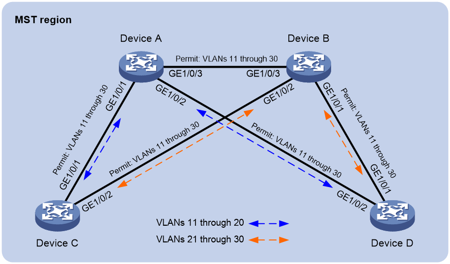

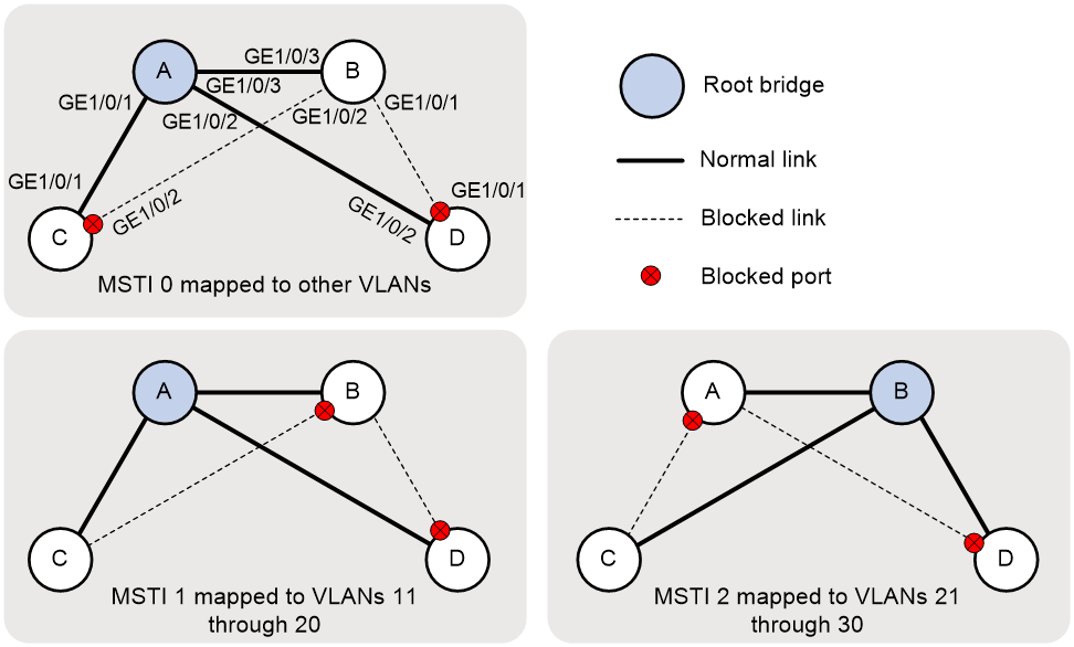

As shown in Figure 1, Device A and Device B operate at the core layer, and Device C and Device D operate at the distribution layer. The ports on the devices have the same path cost, and they all permit VLANs 11 through 30.
Configure MSTP to meet the following requirements:
·     Device A, Device B, Device C, and Device D belong to the same MST region.
·     MSTIs are used to share the traffic of VLANs 11 through 20 and of VLANs 21 through 30.
Figure 1 Network diagram
Analysis
To assign the devices to the same MST region, make sure the following MST region parameters are the same on the devices:
·     Spanning tree mode (the default mode MSTP is used).
·     Region name (test in this example).
·     Revision level (the default value 0 is used).
·     VLAN-to-instance mappings (VLANs 11 through 20 to MIST 1, and VLANs 21 through 30 to MIST 2).

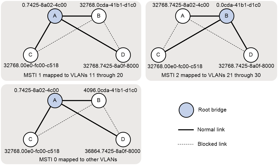

To use redundant links to share the traffic of different VLANs (as shown in Figure 2), perform the following tasks:
·     Configure Device A as the root bridge of MSTI 1.
·     Configure Device B as the root bridge of MIST 2.
·     Assign priorities to Device A, Device B, Device C, and Device D in MSTI 0 in descending order for Device A to be the regional root bridge.
Figure 2 MSTIs mapped to different VLANs

# Configure Device A as the root bridge of MSTI 0 and MSTI 1.
[DeviceA] stp instance 0 to 1 root primary

# Configure Device B as the root bridge of MSTI 2 and a secondary root bridge of MSTI 0.
[DeviceB] stp instance 2 root primary
[DeviceB] stp instance 0 root secondary

# Set the device priority to 36864 in MSTI 0, which is lower than the default priority 32768 of Device C.
[DeviceD] stp instance 0 priority 36864

 0        GigabitEthernet1/0/2                   ALTE  DISCARDING  NONE
 1        GigabitEthernet1/0/1                   ROOT  FORWARDING  NONE
 1        GigabitEthernet1/0/2                   ALTE  DISCARDING  NONE
 2        GigabitEthernet1/0/1                   ALTE  DISCARDING  NONE
 2        GigabitEthernet1/0/2                   ROOT  FORWARDING  NONE
# Display brief spanning tree information on Device D.
[DeviceD] display stp brief
 MST ID   Port                                    Role  STP State   Protection
 0        GigabitEthernet1/0/1                    ALTE  DISCARDING  NONE
 0        GigabitEthernet1/0/2                    ROOT  FORWARDING  NONE
 1        GigabitEthernet1/0/1                    ALTE  DISCARDING  NONE
 1        GigabitEthernet1/0/2                    ROOT  FORWARDING  NONE
 2        GigabitEthernet1/0/1                    ROOT  FORWARDING  NONE
 2        GigabitEthernet1/0/2                    ALTE  DISCARDING  NONE
Based on the output, the topology for each MSTI is shown in Figure 3.
Figure 3 MSTI topologies

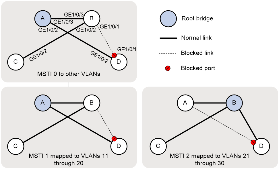

2.     Verify that the network can accommodate topology changes:
# Shut down GigabitEthernet 1/0/1 on Device C. (Details not shown.)
# Display brief spanning tree information on all devices.
[DeviceA] display stp brief
 0        GigabitEthernet1/0/2                    DESI  FORWARDING  NONE
 0        GigabitEthernet1/0/3                    DESI  FORWARDING  NONE
 1        GigabitEthernet1/0/2                    DESI  FORWARDING  NONE
 1        GigabitEthernet1/0/3                    DESI  FORWARDING  NONE
 2        GigabitEthernet1/0/2                    DESI  FORWARDING  NONE
 2        GigabitEthernet1/0/3                    ROOT  FORWARDING  NONE
[DeviceB] display stp brief
 0        GigabitEthernet1/0/1                    DESI  FORWARDING  NONE
 0        GigabitEthernet1/0/3                    ROOT  FORWARDING  NONE
 1        GigabitEthernet1/0/1                    DESI  FORWARDING  NONE
 1        GigabitEthernet1/0/3                    ROOT  FORWARDING  NONE
 2        GigabitEthernet1/0/1                    DESI  FORWARDING  NONE
 2        GigabitEthernet1/0/3                    DESI  FORWARDING  NONE
[DeviceC] display stp brief
Based on the output, the topology for each MSTI is shown in Figure 4.
Figure 4 MSTI topologies

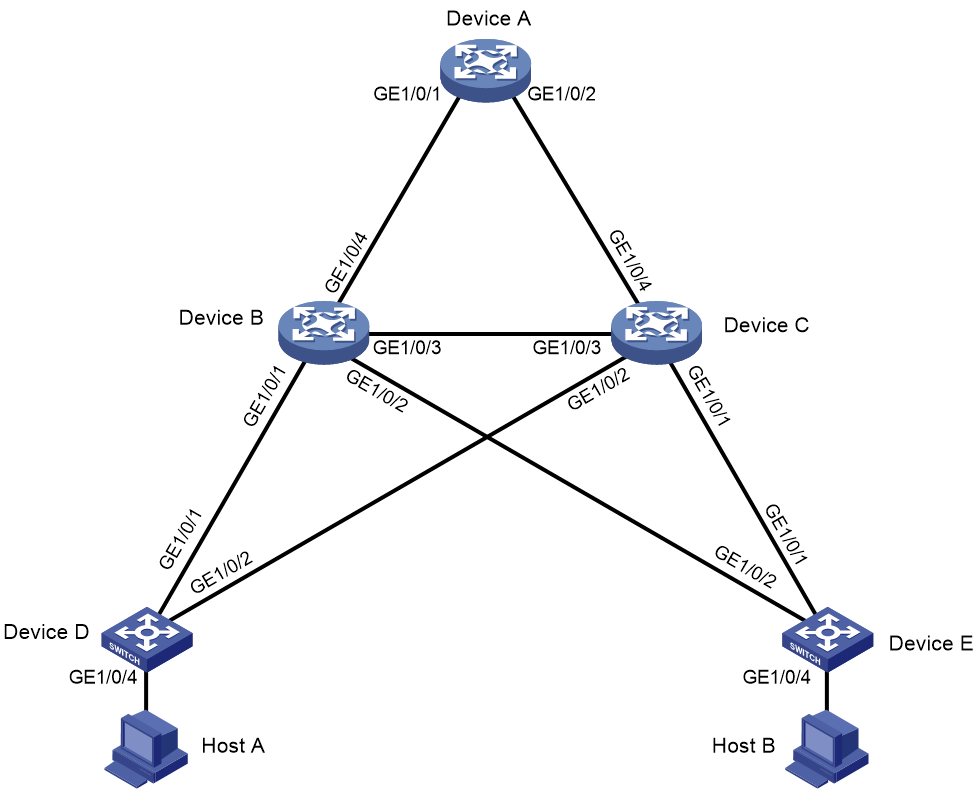

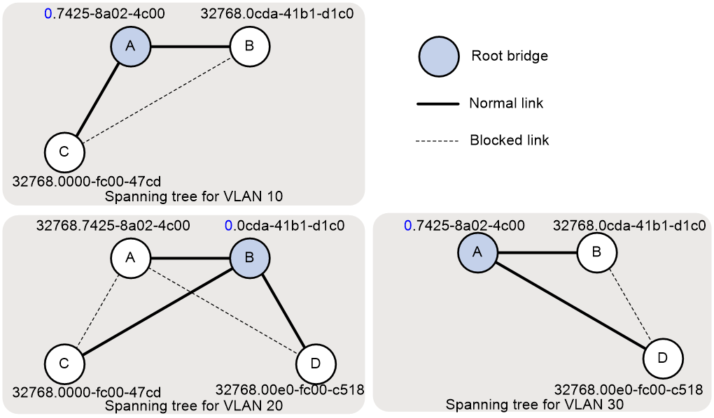

Example: Configuring PVST
As shown in Figure 5, Device A and Device B operate at the distribution layer, and Device C and Device D operate at the access layer. The ports on the devices have the same path cost.
Configure PVST to meet the following requirements:
·     Redundant links are used for load sharing.
·     Packets of each VLAN are forwarded along its spanning tree.
Figure 5 Network diagram

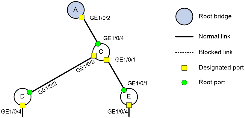

Analysis
For traffic of different VLANs to be shared along the spanning trees in Figure 6, perform the following tasks:
·     Configure Device A as the root bridge of the spanning trees for VLAN 10 and VLAN 30.
·     Configure Device B as the root bridge of the spanning tree for VLAN 20.
Figure 6 VLAN spanning tree topologies

Configuring Device A
# Create VLAN 10, VLAN 20, and VLAN 30.
<DeviceA> system-view
[DeviceA] vlan 10
[DeviceA-vlan10] vlan 20
[DeviceA-vlan20] vlan 30
[DeviceA-vlan30] quit
# Configure GigabitEthernet 1/0/1 to trunk VLAN 10 and VLAN 20.
[DeviceA-GigabitEthernet1/0/1] port link-type trunk
[DeviceA-GigabitEthernet1/0/1] port trunk permit vlan 10 20
[DeviceA-GigabitEthernet1/0/1] quit
# Configure GigabitEthernet 1/0/2 to trunk VLAN 20 and VLAN 30.
[DeviceA] interface gigabitethernet 1/0/2
[DeviceA-GigabitEthernet1/0/2] port link-type trunk
[DeviceA-GigabitEthernet1/0/2] port trunk permit vlan 20 30
[DeviceA-GigabitEthernet1/0/2] quit
# Configure GigabitEthernet 1/0/3 to trunk VLAN 10, VLAN 20, and VLAN 30.
[DeviceA] interface gigabitethernet 1/0/3
[DeviceA-GigabitEthernet1/0/3] port link-type trunk
[DeviceA-GigabitEthernet1/0/3] port trunk permit vlan 10 20 30
[DeviceA-GigabitEthernet1/0/3] quit
# Set the spanning tree mode to PVST.
[DeviceA] stp mode pvst
# Configure Device A as the root bridge of VLAN 10 and VLAN 30.
[DeviceA] stp vlan 10 30 root primary
# Enable the spanning tree feature globally.
[DeviceA] stp global enable
Configuring Device B
<DeviceB> system-view
[DeviceB] vlan 10
[DeviceB-vlan10] vlan 20
[DeviceB-vlan20] vlan 30
[DeviceB-vlan30] quit
# Configure GigabitEthernet 1/0/1 to trunk VLAN 20 and VLAN 30.
[DeviceB-GigabitEthernet1/0/1] port link-type trunk
[DeviceB-GigabitEthernet1/0/1] port trunk permit vlan 20 30
[DeviceB-GigabitEthernet1/0/1] quit
# Configure GigabitEthernet 1/0/2 to trunk VLAN 10 and VLAN 20.
[DeviceB] interface gigabitethernet 1/0/2
[DeviceB-GigabitEthernet1/0/2] port link-type trunk
[DeviceB-GigabitEthernet1/0/2] port trunk permit vlan 10 20
[DeviceB-GigabitEthernet1/0/2] quit
[DeviceB] interface gigabitethernet 1/0/3
[DeviceB-GigabitEthernet1/0/3] port link-type trunk
[DeviceB-GigabitEthernet1/0/3] port trunk permit vlan 10 20 30
[DeviceB-GigabitEthernet1/0/3] quit
[DeviceB] stp mode pvst
# Configure Device B as the root bridge of VLAN 20.
[DeviceB] stp vlan 20 root primary
[DeviceB] stp global enable
Configuring Device C
# Create VLAN 10 and VLAN 20.
<DeviceC> system-view
[DeviceC] vlan 10
[DeviceC-vlan10] vlan 20
[DeviceC-vlan20] quit
# Configure GigabitEthernet 1/0/1 and GigabitEthernet 1/0/2 to trunk VLAN 10 and VLAN 20.
[DeviceC] interface range gigabitethernet 1/0/1 to gigabitethernet 1/0/2
[DeviceC-if-range] port link-type trunk
[DeviceC-if-range] port trunk permit vlan 10 20
[DeviceC-if-range] quit
[DeviceC] stp mode pvst
[DeviceC] stp global enable
Configuring Device D
# Create VLAN 20 and VLAN 30.
<DeviceD> system-view
[DeviceD] vlan 20
[DeviceD-vlan20] vlan 30
[DeviceD-vlan30] quit
# Configure GigabitEthernet 1/0/1 and GigabitEthernet 1/0/2 to trunk VLAN 20 and VLAN 30.
[DeviceD] interface range gigabitethernet 1/0/1 to gigabitethernet 1/0/2
[DeviceD-if-range] port link-type trunk
[DeviceD-if-range] port trunk permit vlan 20 30
[DeviceD-if-range] quit
[DeviceD] stp mode pvst
[DeviceD] stp global enable
Use the display stp brief command to display brief spanning tree information on each device.
# Display brief spanning tree information on Device A.
 VLAN ID  Port                                    Role  STP State   Protection
 1        GigabitEthernet1/0/3                    ALTE  DISCARDING  NONE
 10       GigabitEthernet1/0/1                    DESI  FORWARDING  NONE
 10       GigabitEthernet1/0/3                    DESI  FORWARDING  NONE
 20       GigabitEthernet1/0/1                    ALTE  DISCARDING  NONE

# Display brief spanning tree information on Device B.
 10       GigabitEthernet1/0/2                    ALTE  DISCARDING  NONE
 10       GigabitEthernet1/0/3                    ROOT  FORWARDING  NONE
 20       GigabitEthernet1/0/1                    DESI  FORWARDING  NONE
 20       GigabitEthernet1/0/2                    DESI  FORWARDING  NONE
 20       GigabitEthernet1/0/3                    DESI  FORWARDING  NONE
 30       GigabitEthernet1/0/1                    ALTE  DISCARDING  NONE
 30       GigabitEthernet1/0/3                    ROOT  FORWARDING  NONE
# Display brief spanning tree information on Device C.
 10       GigabitEthernet1/0/1                    ROOT  FORWARDING  NONE
 10       GigabitEthernet1/0/2                    DESI  FORWARDING  NONE
 20       GigabitEthernet1/0/2                    ROOT  FORWARDING  NONE
 20       GigabitEthernet1/0/1                    ROOT  FORWARDING  NONE
 30       GigabitEthernet1/0/1                    DESI  FORWARDING  NONE
 30       GigabitEthernet1/0/2                    ROOT  FORWARDING  NONE
Based on the output, the topology for each VLAN is shown in Figure 7.
Figure 7 VLAN spanning tree topologies

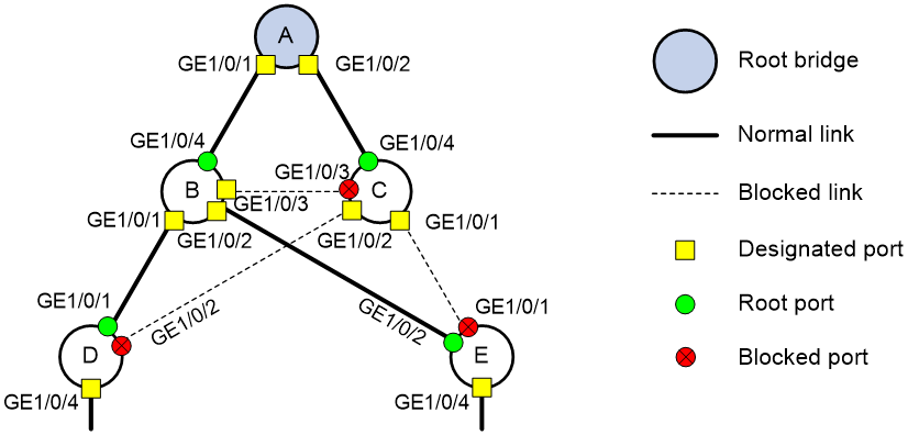

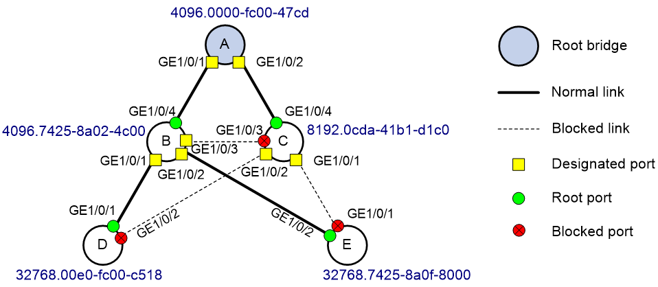

1.     Verify that Layer 2 loops have been eliminated in the network:
# Display the brief spanning tree information on Device A.
# Display the brief spanning tree information on Device B.
 0        GigabitEthernet1/0/4                    ROOT  FORWARDING  NONE
# Display the brief spanning tree information on Device C.
 0        GigabitEthernet1/0/3                    ALTE  DISCARDING  NONE
# Display the brief spanning tree information on Device D.
 0        GigabitEthernet1/0/4                    DESI  FORWARDING  BPDU
# Display the brief spanning tree information on Device E.
[DeviceE] display stp brief
Based on the output, the topology for the network is shown in Figure 10.
Figure 10 Network topology

3.     Verify that traffic is forwarded through Device C when Device B fails:
# Reboot Device B. (Details not shown.)
# Display the brief spanning tree information on Device A, Device C, Device D, and Device E before Device B completes the reboot.
[DeviceA] dis stp brief
 0        GigabitEthernet1/0/2                    DESI  FORWARDING  ROOT
[DeviceC] dis stp brief
 0        GigabitEthernet1/0/1                    DESI  FORWARDING  ROOT
[DeviceD] dis stp brief
[DeviceE] dis stp brief
Based on the network topology, the topology for the network is shown in Figure 11.
