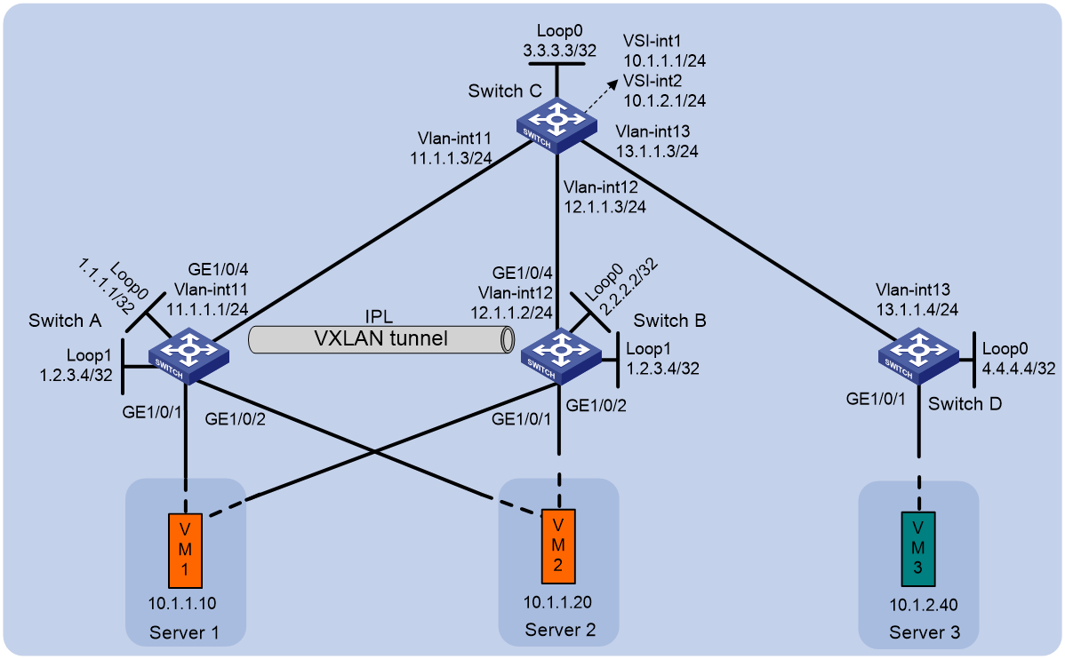

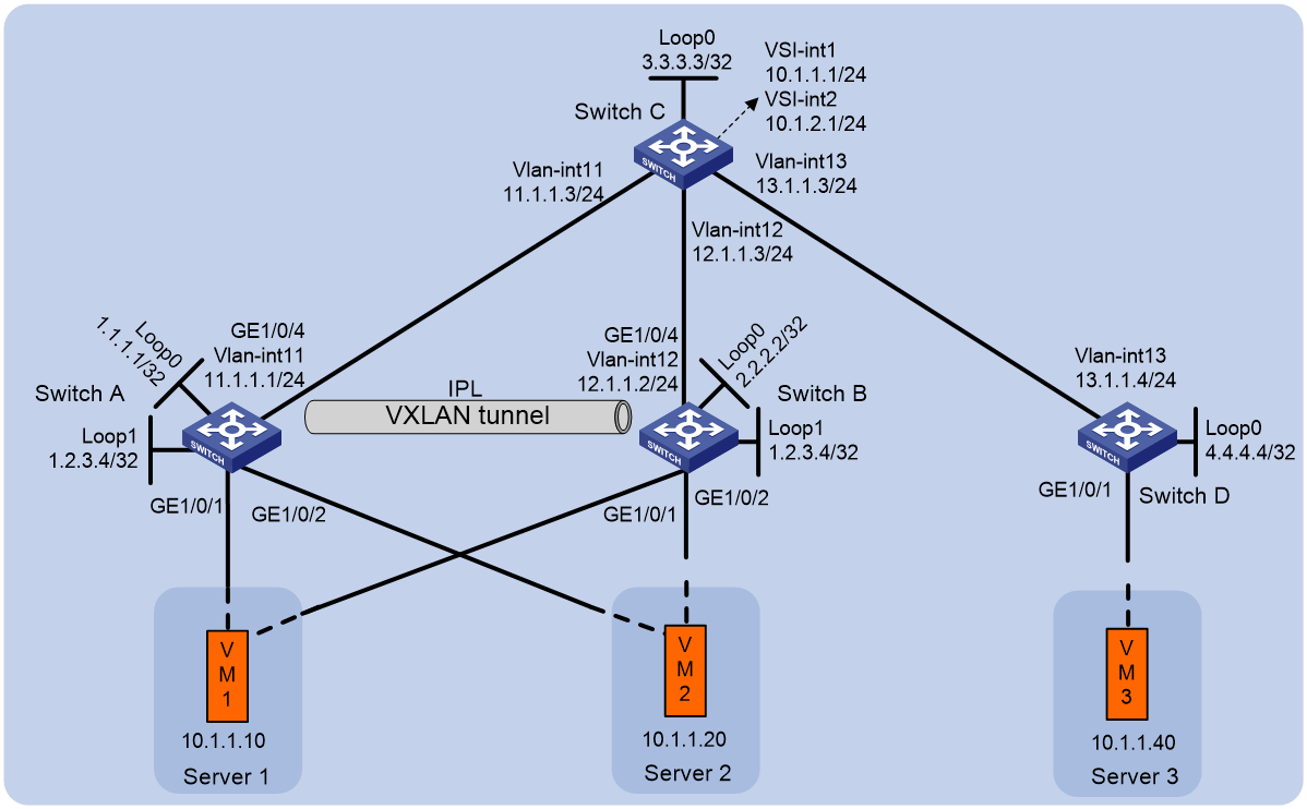

Example: Configuring DRNI using a VXLAN tunnel as the IPL on EVPN VTEPs  22
Network configuration· 22
Analysis· 23

Example: Configuring DRNI using a VXLAN tunnel as the IPL on EVPN gateways  68
Network configuration· 68
Analysis· 69

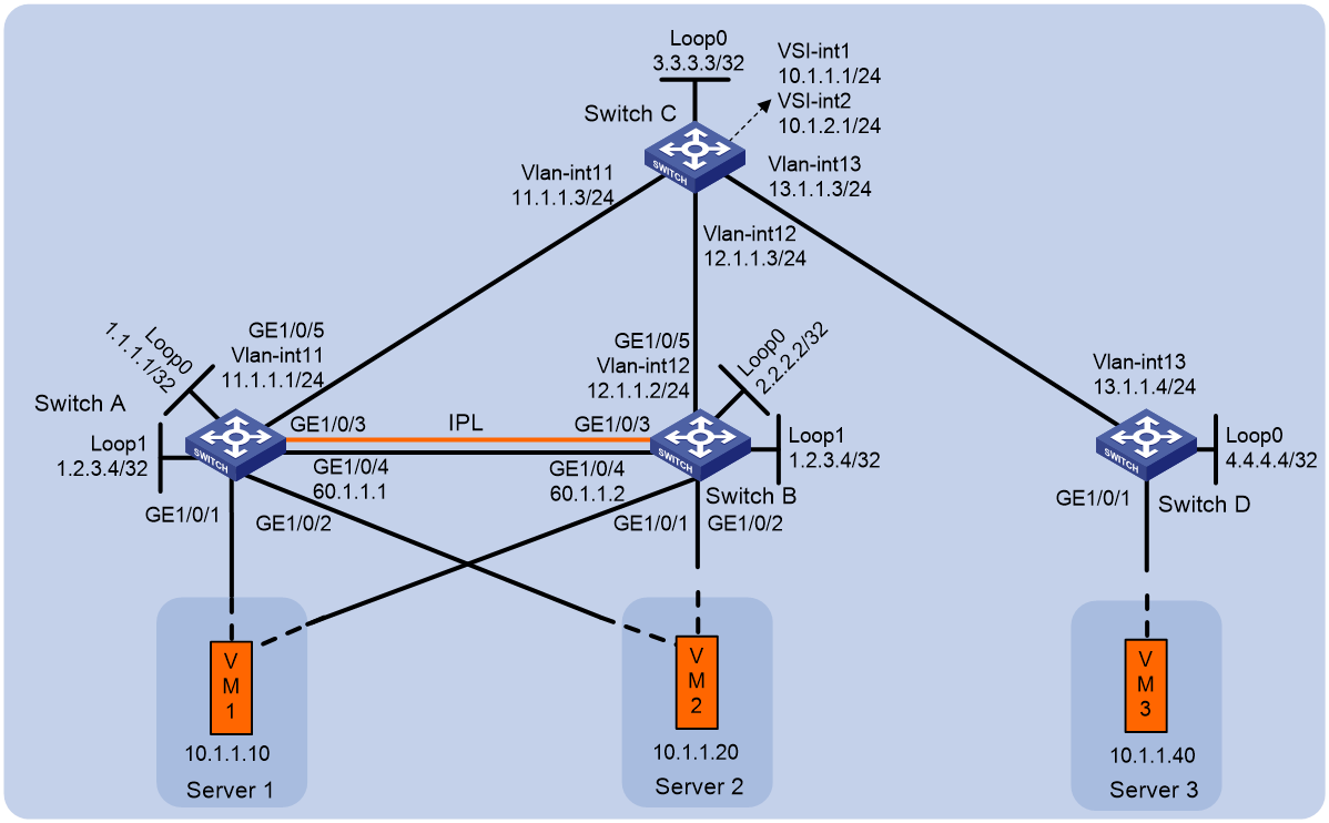

Example: Configuring DRNI using an Ethernet aggregate link as the IPL on EVPN VTEPs
As shown in Figure 1, perform the following tasks to make sure the VMs can communicate with one another:
·     Configure VXLAN 10 on Switch A, Switch B, and Switch D.
·     Configure DRNI on Switch A and Switch B to virtualize them into one VTEP. Configure an Ethernet aggregate link as the IPL between the switches.
·     Configure Switch C as a route reflector (RR).
Figure 1 Network diagram
Analysis
To make sure the overlay network has connectivity, configure a routing protocol on the switches to advertise routes for reaching their interfaces, including the loopback interfaces. In this example, OSPF is used.
To conserve resources, configure Switch C to reflect routes for Switch A, Switch B, and Switch D.

Configuring Switch B
# Configure OSPF to advertise the networks attached to the Layer 3 interfaces.
<SwitchB> system-view
[SwitchB] ospf 1 router-id 2.2.2.2
[SwitchB-ospf-1] area 0
[SwitchB-ospf-1-area-0.0.0.0] network 2.2.2.2 0.0.0.0
[SwitchB-ospf-1-area-0.0.0.0] network 1.2.3.4 0.0.0.0
[SwitchB-ospf-1-area-0.0.0.0] network 12.1.1.0 0.0.0.255
[SwitchB-ospf-1-area-0.0.0.0] quit
[SwitchB-ospf-1] quit
# Configure OSPF on VLAN-interface 100 for traffic to be redirected to an available DR member device when an uplink fails.
[SwitchB] vlan 100
[SwitchB-vlan100] quit
[SwitchB] interface Vlan-interface 100
[SwitchB-Vlan-interface100] ip address 100.1.1.2 255.255.255.0
[SwitchB-Vlan-interface100] ospf 1 area 0.0.0.0
Configuring Switch C
<SwitchC> system-view
[SwitchC] ospf 1 router-id 3.3.3.3
[SwitchC-ospf-1] area 0
[SwitchC-ospf-1-area-0.0.0.0] network 3.3.3.3 0.0.0.0
[SwitchC-ospf-1-area-0.0.0.0] network 11.1.1.0 0.0.0.255
[SwitchC-ospf-1-area-0.0.0.0] network 12.1.1.0 0.0.0.255
[SwitchC-ospf-1-area-0.0.0.0] network 13.1.1.0 0.0.0.255
[SwitchC-ospf-1-area-0.0.0.0] quit
[SwitchC-ospf-1] quit
Configuring Switch D
<SwitchD> system-view
[SwitchD] ospf 1 router-id 4.4.4.4
[SwitchD-ospf-1] area 0
[SwitchD-ospf-1-area-0.0.0.0] network 4.4.4.4 0.0.0.0
[SwitchD-ospf-1-area-0.0.0.0] network 13.1.1.0 0.0.0.255
[SwitchD-ospf-1-area-0.0.0.0] quit
[SwitchD-ospf-1] quit
Disabling spanning tree
Configuring Switch A
# Disable spanning tree on transport-facing physical interface GigabitEthernet 1/0/5.
[SwitchA] interface gigabitethernet 1/0/5
[SwitchA-GigabitEthernet1/0/5] undo stp enable
[SwitchA-GigabitEthernet1/0/5] quit
[SwitchB] interface gigabitethernet 1/0/5
[SwitchB-GigabitEthernet1/0/5] undo stp enable
[SwitchB-GigabitEthernet1/0/5] quit
Configuring EVPN
# Enable L2VPN.
[SwitchA] l2vpn enable
# Enable Layer 2 forwarding for VXLANs.
[SwitchA] undo vxlan ip-forwarding
# Disable remote MAC address learning and remote ARP learning.
[SwitchA] vxlan tunnel mac-learning disable
[SwitchA] vxlan tunnel arp-learning disable
# Create an EVPN instance on VSI vpna.
[SwitchA] vsi vpna
[SwitchA-vsi-vpna] arp suppression enable
[SwitchA-vsi-vpna] evpn encapsulation vxlan
# Configure the switch to automatically generate an RD and a route target for the EVPN instance.
[SwitchA-vsi-vpna-evpn-vxlan] route-distinguisher auto
[SwitchA-vsi-vpna-evpn-vxlan] vpn-target auto
[SwitchA-vsi-vpna-evpn-vxlan] quit
# Create VXLAN 10.
[SwitchA-vsi-vpna] vxlan 10
[SwitchA-vsi-vpna-vxlan-10] quit
[SwitchA-vsi-vpna] quit
# Enable L2VPN.
[SwitchB] l2vpn enable
[SwitchB] undo vxlan ip-forwarding
[SwitchB] vxlan tunnel mac-learning disable
[SwitchB] vxlan tunnel arp-learning disable
[SwitchB] vsi vpna
[SwitchB-vsi-vpna] arp suppression enable
[SwitchB-vsi-vpna] evpn encapsulation vxlan
[SwitchB-vsi-vpna-evpn-vxlan] route-distinguisher auto
[SwitchB-vsi-vpna-evpn-vxlan] vpn-target auto
[SwitchB-vsi-vpna-evpn-vxlan] quit
# Create VXLAN 10.
[SwitchB-vsi-vpna] vxlan 10
[SwitchB-vsi-vpna-vxlan-10] quit
[SwitchB-vsi-vpna] quit
# Enable L2VPN.
[SwitchD] l2vpn enable
[SwitchD] undo vxlan ip-forwarding
[SwitchD] vxlan tunnel mac-learning disable
[SwitchD] vxlan tunnel arp-learning disable
[SwitchD] vsi vpna
[SwitchD-vsi-vpna] arp suppression enable
[SwitchD-vsi-vpna] evpn encapsulation vxlan
[SwitchD-vsi-vpna-evpn-vxlan] route-distinguisher auto
[SwitchD-vsi-vpna-evpn-vxlan] vpn-target auto
[SwitchD-vsi-vpna-evpn-vxlan] quit
# Create VXLAN 10.
[SwitchD-vsi-vpna] vxlan 10
[SwitchD-vsi-vpna-vxlan-10] quit
[SwitchD-vsi-vpna] quit
Configuring DRNI
# Specify the virtual VTEP address as 1.2.3.4.
[SwitchA] evpn drni group 1.2.3.4
# Configure DR system parameters.
[SwitchA] drni system-mac 0001-0001-0001
[SwitchA] drni system-number 1
[SwitchA] drni system-priority 10
[SwitchA] drni restore-delay 180
[SwitchA] drni keepalive ip destination 60.1.1.2 source 60.1.1.1
# Create Layer 2 dynamic aggregate interface Bridge-Aggregation 3.
[SwitchA] interface bridge-aggregation 3
[SwitchA-Bridge-Aggregation3] link-aggregation mode dynamic
[SwitchA-Bridge-Aggregation3] quit
# Assign GigabitEthernet 1/0/3 to aggregation group 3.
[SwitchA] interface gigabitethernet 1/0/3
[SwitchA-GigabitEthernet1/0/3] port link-aggregation group 3
[SwitchA-GigabitEthernet1/0/3] quit
# Specify Bridge-Aggregation 3 as the IPP.
[SwitchA-Bridge-Aggregation3] port drni intra-portal-port 1
[SwitchA-Bridge-Aggregation3] undo mac-address static source-check enable
# Disable the static source check feature on GigabitEthernet 1/0/5.
[SwitchA-GigabitEthernet1/0/5] undo mac-address static source-check enable
# Create Layer 2 dynamic aggregate interface Bridge-Aggregation 4.
[SwitchA] interface bridge-aggregation 4
[SwitchA-Bridge-Aggregation4] link-aggregation mode dynamic
[SwitchA-Bridge-Aggregation4] quit
# Assign GigabitEthernet 1/0/1 to aggregation group 4.
[SwitchA] interface gigabitethernet 1/0/1
[SwitchA-GigabitEthernet1/0/1] port link-aggregation group 4
[SwitchA-GigabitEthernet1/0/1] quit
# Assign Bridge-Aggregation 4 to DR group 4.
[SwitchA-Bridge-Aggregation4] port drni group 4
# Create Layer 2 dynamic aggregate interface Bridge-Aggregation 5.
[SwitchA] interface bridge-aggregation 5
[SwitchA-Bridge-Aggregation5] link-aggregation mode dynamic
[SwitchA-Bridge-Aggregation5] quit
# Assign GigabitEthernet 1/0/2 to aggregation group 5.
[SwitchA] interface gigabitethernet 1/0/2
[SwitchA-GigabitEthernet1/0/2] port link-aggregation group 5
[SwitchA-GigabitEthernet1/0/2] quit
# Assign Bridge-Aggregation 5 to DR group 5.
[SwitchA-Bridge-Aggregation5] port drni group 5
# Exclude all interfaces used by EVPN from the shutdown action by DRNI MAD.
[SwitchA] drni mad exclude interface loopback 0
[SwitchA] drni mad exclude interface gigabitethernet 1/0/4
[SwitchA] drni mad exclude interface gigabitethernet 1/0/5
[SwitchA] drni mad exclude interface vlan-interface 11
[SwitchB] evpn drni group 1.2.3.4
[SwitchB] drni system-mac 0001-0001-0001
[SwitchB] drni system-number 2
[SwitchB] drni system-priority 10
[SwitchB] drni restore-delay 180
[SwitchB] drni keepalive ip destination 60.1.1.1 source 60.1.1.2
[SwitchB] interface bridge-aggregation 3
[SwitchB-Bridge-Aggregation3] link-aggregation mode dynamic
[SwitchB-Bridge-Aggregation3] quit
[SwitchB] interface gigabitethernet 1/0/3
[SwitchB-GigabitEthernet1/0/3] port link-aggregation group 3
[SwitchB-GigabitEthernet1/0/3] quit
[SwitchB-Bridge-Aggregation3] port drni intra-portal-port 1
[SwitchB-Bridge-Aggregation3] undo mac-address static source-check enable
[SwitchB-GigabitEthernet1/0/5] undo mac-address static source-check enable
[SwitchB] interface bridge-aggregation 4
[SwitchB-Bridge-Aggregation4] link-aggregation mode dynamic
[SwitchB-Bridge-Aggregation4] quit
[SwitchB] interface gigabitethernet 1/0/1
[SwitchB-GigabitEthernet1/0/1] port link-aggregation group 4
[SwitchB-GigabitEthernet1/0/1] quit
[SwitchB-Bridge-Aggregation4] port drni group 4
[SwitchB] interface bridge-aggregation 5
[SwitchB-Bridge-Aggregation5] link-aggregation mode dynamic
[SwitchB-Bridge-Aggregation5] quit
[SwitchB] interface gigabitethernet 1/0/2
[SwitchB-GigabitEthernet1/0/2] port link-aggregation group 5
[SwitchB-GigabitEthernet1/0/2] quit
[SwitchB-Bridge-Aggregation5] port drni group 5
[SwitchB] drni mad exclude interface loopback 0
[SwitchB] drni mad exclude interface gigabitethernet 1/0/4
[SwitchB] drni mad exclude interface gigabitethernet 1/0/5
[SwitchA] drni mad exclude interface vlan-interface 12
Configuring BGP to advertise BGP EVPN routes
# Configure BGP to advertise BGP EVPN routes.
[SwitchA] bgp 200
[SwitchA-bgp-default] peer 3.3.3.3 as-number 200
[SwitchA-bgp-default] peer 3.3.3.3 connect-interface loopback 0
[SwitchA-bgp-default] address-family l2vpn evpn
[SwitchA-bgp-default-evpn] peer 3.3.3.3 enable
[SwitchA-bgp-default-evpn] quit
[SwitchA-bgp-default] quit
[SwitchB] bgp 200
[SwitchB-bgp-default] peer 3.3.3.3 as-number 200
[SwitchB-bgp-default] peer 3.3.3.3 connect-interface loopback 0
[SwitchB-bgp-default] address-family l2vpn evpn
[SwitchB-bgp-default-evpn] peer 3.3.3.3 enable
[SwitchB-bgp-default-evpn] quit
[SwitchB-bgp-default] quit
# Configure BGP to advertise BGP EVPN routes and configure the switch as an RR.
[SwitchC] bgp 200
[SwitchC-bgp-default] group evpn
[SwitchC-bgp-default] peer 1.1.1.1 group evpn
[SwitchC-bgp-default] peer 2.2.2.2 group evpn
[SwitchC-bgp-default] peer 4.4.4.4 group evpn
[SwitchC-bgp-default] peer evpn as-number 200
[SwitchC-bgp-default] peer evpn connect-interface loopback 0
[SwitchC-bgp-default] address-family l2vpn evpn
[SwitchC-bgp-default-evpn] peer evpn enable
[SwitchC-bgp-default-evpn] undo policy vpn-target
[SwitchC-bgp-default-evpn] peer evpn reflect-client
[SwitchC-bgp-default-evpn] quit
[SwitchC-bgp-default] quit
[SwitchD] bgp 200
[SwitchD-bgp-default] peer 3.3.3.3 as-number 200
[SwitchD-bgp-default] peer 3.3.3.3 connect-interface loopback 0
[SwitchD-bgp-default] address-family l2vpn evpn
[SwitchD-bgp-default-evpn] peer 3.3.3.3 enable
[SwitchD-bgp-default-evpn] quit
[SwitchD-bgp-default] quit
Mapping Ethernet service instances to VSIs
# On Bridge-Aggregation 4, create Ethernet service instance 1000 to match VLAN 2.
[SwitchA-Bridge-Aggregation4] port link-type trunk
[SwitchA-Bridge-Aggregation4] port trunk permit vlan 2
[SwitchA-Bridge-Aggregation4] service-instance 1000
[SwitchA-Bridge-Aggregation4-srv1000] encapsulation s-vid 2
# Map Ethernet service instance 1000 to VSI vpna.
[SwitchA-Bridge-Aggregation4-srv1000] xconnect vsi vpna
[SwitchA-Bridge-Aggregation4-srv1000] quit
# On Bridge-Aggregation 5, create Ethernet service instance 1000 to match VLAN 3.
[SwitchA-Bridge-Aggregation5] port link-type trunk
[SwitchA-Bridge-Aggregation5] port trunk permit vlan 3
[SwitchA-Bridge-Aggregation5] service-instance 1000
[SwitchA-Bridge-Aggregation5-srv1000] encapsulation s-vid 3
[SwitchA-Bridge-Aggregation5-srv1000] xconnect vsi vpna
[SwitchA-Bridge-Aggregation5-srv1000] quit
[SwitchB-Bridge-Aggregation4] port link-type trunk
[SwitchB-Bridge-Aggregation4] port trunk permit vlan 2
[SwitchB-Bridge-Aggregation4] service-instance 1000
[SwitchB-Bridge-Aggregation4-srv1000] encapsulation s-vid 2
[SwitchB-Bridge-Aggregation4-srv1000] xconnect vsi vpna

Verifying the configuration on a DR member device
The verification procedure uses Switch A as an example.
As shown in Figure 2, perform the following tasks to make sure the VMs can communicate with one another:
·     Configure DRNI on Switch A and Switch B to virtualize them into one VTEP. Manually set up a VXLAN tunnel as the IPL between the switches.
·     Configure Switch C as an RR.
Figure 2 Network diagram
Analysis
To make sure the overlay network has connectivity,, configure a routing protocol on these switches to advertise routes for reaching their interfaces, including the loopback interfaces. In this example, OSPF is used.

Make sure the following settings are consistent on the DR member devices:
·     Ethernet service instances and their match criterion on the DR interfaces in the same DR group or single-homed site-facing interfaces.
·     VXLAN IDs of VSIs.
In addition, the Ethernet service instances must be created manually.
As a best practice, do not redistribute external routes on the DR member devices.
Use the drni mad exclude interface command to exclude all interfaces used by EVPN from the shutdown action by DRNI MAD. The interfaces include VSI interfaces, interfaces that provide BGP peer addresses, interfaces used for setting up the keepalive link, and transport-facing outgoing interfaces of VXLAN tunnels.
Use the drni mad exclude interface command to exclude VXLAN tunnel interfaces and their traffic outgoing interfaces from the MAD shutdown action by DRNI before you configure them as IPPs. If you have configured the VXLAN tunnel interfaces as IPPs before excluding them and their traffic outgoing interfaces from the MAD shutdown action, you must first remove the IPP configuration. After the VXLAN tunnel interfaces and their traffic outgoing interfaces come up, exclude the interfaces from the MAD shutdown action by DRNI. Then, configure the VXLAN tunnel interfaces as IPPs.
As a best practice, use the IP address of a loopback interface as the virtual VTEP address.
For EVPN to run correctly on a DR system, you must execute the undo mac-address static source-check enable command to disable static source check on the following interfaces:
·     Layer 2 aggregate interfaces or Layer 2 Ethernet interfaces acting as the IPPs.
·     Transport-facing physical interfaces.
You must disable spanning tree on the Layer 2 Ethernet interface that acts as the physical traffic outgoing interface of a VXLAN tunnel. If you enable spanning tree on that interface, the upstream device will falsely block the interfaces connected to the DR member devices.
Procedures
Configuring the system operating mode
# Set the system operating mode to VXLAN on Switch A, and reboot the switch for the mode change to take effect.
<SwitchA> system-view
[SwitchA] switch-mode 1
Reboot device to make the configuration take effect.
[SwitchA] quit
<SwitchA> reboot
Start to check configuration with next startup configuration file, please wait..
.......DONE!
Current configuration may be lost after the reboot, save current configuration?
[Y/N]:y
This command will reboot the device. Continue? [Y/N]:y
# Set the system operating mode of Switch B and Switch D to VXLAN. The method is the same as Switch A. (Details not shown.)
Configuring Layer 3 interfaces
# Configure the Layer 3 interfaces on Switch A.
[SwitchA] interface loopback 0
[SwitchA-Loopback0] ip address 1.1.1.1 32
[SwitchA-Loopback0] quit
[SwitchA] interface loopback 1
[SwitchA-Loopback1] ip address 1.2.3.4 32
[SwitchA-Loopback1] quit
[SwitchA] vlan 11
[SwitchA-vlan11] port gigabitethernet 1/0/5
[SwitchA-vlan11] quit
[SwitchA] interface vlan-interface 11
[SwitchA-Vlan-interface11] ip address 11.1.1.1 24
[SwitchA-Vlan-interface11] quit
# Configure the Layer 3 interfaces on other switches. (Details not shown.)
Configuring OSPF
[SwitchA] ospf 1 router-id 1.1.1.1
[SwitchA-ospf-1] area 0
[SwitchA-ospf-1-area-0.0.0.0] network 1.1.1.1 0.0.0.0
[SwitchA-ospf-1-area-0.0.0.0] network 1.2.3.4 0.0.0.0
[SwitchA-ospf-1-area-0.0.0.0] network 11.1.1.0 0.0.0.255
[SwitchA-ospf-1-area-0.0.0.0] quit
[SwitchA-ospf-1] quit
Configuring EVPN
# Enable L2VPN.
# Specify the reserved VXLAN as VXLAN 1234.
[SwitchA] reserved vxlan 1234
[SwitchA] vsi vpna
# Create VXLAN 10.
# Enable L2VPN.
[SwitchB] reserved vxlan 1234
[SwitchB] vsi vpna
# Create VXLAN 10.
# Enable L2VPN.
[SwitchD] vsi vpna
# Create VXLAN 10.
Configuring DRNI
# Create a tunnel to Switch B, and set the ToS of tunneled packets to 100.
[SwitchA] interface tunnel 1 mode vxlan
[SwitchA-Tunnel1] source 1.1.1.1
[SwitchA-Tunnel1] destination 2.2.2.2
[SwitchA-Tunnel1] tunnel tos 100
[SwitchA-Tunnel1] quit
# Exclude Tunnel 1 from the shutdown action by DRNI MAD.
[SwitchA] drni mad exclude interface tunnel 1
# Specify Tunnel 1 as the IPP
[SwitchA-Tunnel1] port drni intra-portal-port 1
# Disable the static source check feature on GigabitEthernet 1/0/4.
[SwitchA] interface gigabitethernet 1/0/4
[SwitchA-GigabitEthernet1/0/4] undo mac-address static source-check enable
[SwitchA-GigabitEthernet1/0/4] quit
# Create a tunnel to Switch A, and set the ToS of tunneled packets to 100.
[SwitchB] interface tunnel 1 mode vxlan
[SwitchB-Tunnel1] source 2.2.2.2
[SwitchB-Tunnel1] destination 1.1.1.1
[SwitchB-Tunnel1] tunnel tos 100
[SwitchB-Tunnel1] quit
[SwitchB] drni mad exclude interface tunnel 1
[SwitchB-Tunnel1] port drni intra-portal-port 1
[SwitchB] interface gigabitethernet 1/0/4
[SwitchB-GigabitEthernet1/0/4] undo mac-address static source-check enable
[SwitchB-GigabitEthernet1/0/4] quit
[SwitchB] drni mad exclude interface vlan-interface 12
[SwitchA] bgp 200
[SwitchB] bgp 200
[SwitchC] bgp 200
[SwitchD] bgp 200
[SwitchB-Bridge-Aggregation4-srv1000] quit
[SwitchB-Bridge-Aggregation5] port link-type trunk
[SwitchB-Bridge-Aggregation5] port trunk permit vlan 3
[SwitchB-Bridge-Aggregation5] service-instance 1000
[SwitchB-Bridge-Aggregation5-srv1000] encapsulation s-vid 3
[SwitchB-Bridge-Aggregation5-srv1000] xconnect vsi vpna
[SwitchB-Bridge-Aggregation5-srv1000] quit
# On GigabitEthernet 1/0/1, create Ethernet service instance 1000 to match VLAN 2.
[SwitchD] interface gigabitethernet 1/0/1
[SwitchD-GigabitEthernet1/0/1] service-instance 1000
[SwitchD-GigabitEthernet1/0/1] encapsulation s-vid 2
[SwitchD-GigabitEthernet1/0/1] xconnect vsi vpna
[SwitchD-GigabitEthernet1/0/1] quit
Configuring Monitor Link
# Create monitor link group 1 and assign the uplink and downlink interfaces to it.
[SwitchA] monitor-link group 1
[SwitchA-mtlk-group1] port gigabitethernet 1/0/1 downlink
[SwitchA-mtlk-group1] port gigabitethernet 1/0/2 downlink
[SwitchA-mtlk-group1] port gigabitethernet 1/0/4 uplink
[SwitchA-mtlk-group1] quit
[SwitchB] monitor-link group 1
[SwitchB-mtlk-group1] port gigabitethernet 1/0/1 downlink
[SwitchB-mtlk-group1] port gigabitethernet 1/0/2 downlink
[SwitchB-mtlk-group1] port gigabitethernet 1/0/4 uplink
[SwitchB-mtlk-group1] quit

Configuration files
·     Switch A:
 area 0.0.0.0
vlan 2
vlan 3
vlan 11
 l2vpn enable
 reserved vxlan 1234
vsi vpna
 vxlan 10
  vpn-target auto export-extcommunity
  vpn-target auto import-extcommunity
interface Bridge-Aggregation4
 port trunk permit vlan 1 to 2
 port drni group 4
  xconnect vsi vpna
interface Bridge-Aggregation5
 port trunk permit vlan 1 3
 port drni group 5
  xconnect vsi vpna
interface LoopBack0
 ip address 1.1.1.1 255.255.255.255
interface LoopBack1
 ip address 1.2.3.4 255.255.255.255
interface Vlan-interface11
 ip address 11.1.1.1 255.255.255.0
 port link-mode bridge
 port monitor-link group 1 downlink
interface GigabitEthernet1/0/4
 port access vlan 11
 undo stp enable
 port monitor-link group 1 uplink
interface Tunnel1 mode vxlan
 source 1.1.1.1
 destination 2.2.2.2
 tunnel tos 100
bgp 200
 peer 3.3.3.3 connect-interface LoopBack0
  peer 3.3.3.3 enable
 drni mad exclude interface LoopBack0
 drni mad exclude interface GigabitEthernet1/0/5
 drni mad exclude interface Tunnel1
 drni mad exclude interface Vlan-interface 11
return
·     Switch B:
 area 0.0.0.0
vlan 2
vlan 3
vlan 12
 l2vpn enable
 reserved vxlan 1234
vsi vpna
 vxlan 10
 port drni group 4
  xconnect vsi vpna
 port drni group 5
  xconnect vsi vpna
interface LoopBack0
 ip address 2.2.2.2 255.255.255.255
interface LoopBack1
interface Vlan-interface12
 ip address 12.1.1.2 255.255.255.0
 port access vlan 12
 source 2.2.2.2
 destination 1.1.1.1
 tunnel tos 100
bgp 200
  peer 3.3.3.3 enable
 drni mad exclude interface Vlan-interface 12
return
·     Switch C:
 area 0.0.0.0
vlan 11 to 13
interface LoopBack0
 ip address 3.3.3.3 255.255.255.255
 ip address 11.1.1.3 255.255.255.0
 ip address 12.1.1.3 255.255.255.0
interface Vlan-interface13
 ip address 13.1.1.3 255.255.255.0
 port access vlan 11
 port access vlan 12
 port access vlan 13
bgp 200
 group evpn internal
 peer evpn connect-interface LoopBack0
  peer evpn enable
return
·     Switch D:
 area 0.0.0.0
vlan 2
vlan 13
 l2vpn enable
vsi vpna
 vxlan 10
interface LoopBack0
 ip address 4.4.4.4 255.255.255.255
 ip address 13.1.1.4 255.255.255.0
  xconnect vsi vpna
 port access vlan 13
bgp 200
  peer 3.3.3.3 enable
return
Example: Configuring DRNI using an Ethernet aggregate link as the IPL on EVPN gateways
As shown in Figure 3, perform the following tasks to make sure the VMs can communicate with one another:
·     Configure VXLAN 10 on Switch A, Switch B, and Switch D, and configure VXLAN 20 on Switch A and Switch B.
·     Configure Switch A, Switch B, and Switch D as distributed EVPN gateways to provide Layer 3 forwarding service for the VMs.
Figure 3 Network diagram
Analysis
As shown in Figure 4, perform the following tasks to make sure the VMs can communicate with one another:
·     Configure VXLAN 10 on Switch A, Switch B, and Switch D, and configure VXLAN 20 on Switch A, and Switch B.
·     Configure Switch A, Switch B, and Switch D as distributed EVPN gateways to provide Layer 3 forwarding service for VMs.
·     Create a monitor link group on Switch A and Switch B. Configure the transport-facing interfaces of Switch A and Switch B as uplink interfaces for the monitor link group, and member interfaces of DR interfaces as downlink interfaces.
Figure 4 Network diagram
Analysis

Configuring DRNI
[SwitchA] drni system-mac 0001-0002-0003
[SwitchA] drni mad exclude interface loopback0
[SwitchA] drni mad exclude interface gigabitethernet1/0/4
[SwitchA] drni mad exclude interface vsi-interface 1
[SwitchA] drni mad exclude interface vsi-interface 2
# Verify that Switch A has BGP EVPN routes.
[Switch A]display bgp l2vpn evpn
 BGP local router ID is 1.2.3.4
 Status codes: * - valid, > - best, d - dampened, h - history
               s - suppressed, S - stale, i - internal, e - external
               a - additional-path
       Origin: i - IGP, e - EGP, ? - incomplete
 Total number of routes from all PEs: 3
 Route distinguisher: 1:1(vpna)
 Total number of routes: 2
     Network            NextHop         MED        LocPrf     PrefVal Path/Ogn
* >  [5][0][24][10.1.1.0]/80
                        1.1.1.1         0          100        32768   i
* >  [5][0][24][10.1.2.0]/80
 Route distinguisher: 1:10
 Total number of routes: 4
* >  [3][0][32][1.1.1.1]/80
* >  [3][0][32][1.2.3.4]/80
                        1.2.3.4         0          100        32768   i
* >i [3][0][32][2.2.2.2]/80
                        2.2.2.2         0          100        0       i
* >i [3][0][32][4.4.4.4]/80
                        4.4.4.4         0          100        0       i
 Route distinguisher: 1:20
 Total number of routes: 3
                        2.2.2.2         0          100        0       i
# Verify that the IPL Tunnel 1 is up, and Tunnel 0 to Switch D uses the virtual VTEP address as the source address.
[SwitchA] display interface tunnel
Tunnel0
Current state: UP
Line protocol state: UP
Description: Tunnel0 Interface
Bandwidth: 64 kbps
Maximum transmission unit: 1464
Internet protocol processing: Disabled
Last clearing of counters: Never
Tunnel source 1.2.3.4, destination 4.4.4.4
Tunnel protocol/transport UDP_VXLAN/IP
Last 300 seconds input rate: 0 bytes/sec, 0 bits/sec, 0 packets/sec
Last 300 seconds output rate: 0 bytes/sec, 0 bits/sec, 0 packets/sec
Input: 0 packets, 0 bytes, 0 drops
Output: 0 packets, 0 bytes, 0 drops
Tunnel1
Current state: UP
Description: Tunnel1 Interface
Bandwidth: 64 kbps
Tunnel source 1.1.1.1, destination 2.2.2.2
Last 300 seconds input rate: 149 bytes/sec, 1192 bits/sec, 1 packets/sec
Last 300 seconds output rate: 379 bytes/sec, 3032 bits/sec, 3 packets/sec
Input: 398 packets, 46446 bytes, 0 drops
Output: 3597 packets, 363591 bytes, 0 drops
# Verify that the VXLAN tunnels have been assigned to VXLAN 10 and VXLAN 20.
[SwitchA] display l2vpn vsi verbose
VSI Name: Auto_L3VNI1000_3
  VSI Index               : 1
  VSI State               : Down
  MTU                     : 1500
  Bandwidth               : -
  Broadcast Restrain      : -
  Multicast Restrain      : -
  Unknown Unicast Restrain: -
  MAC Learning            : Enabled
  MAC Table Limit         : -
  MAC Learning rate       : -
  Drop Unknown            : -
  Flooding                : Enabled
  Statistics              : Disabled
  Gateway Interface       : VSI-interface 3
  VXLAN ID                : 1000
VSI Name: vpna
  VSI Index               : 0
  VSI State               : Up
  MTU                     : 1500
  Bandwidth               : -
  MAC Table Limit         : -
  Drop Unknown            : -
  Flooding                : Enabled
  Gateway Interface       : VSI-interface 1
  VXLAN ID                : 10
  Tunnels:
    Tunnel Name          Link ID    State    Type        Flood proxy
    Tunnel0              0x5000000  UP       Auto        Disabled
    Tunnel1              0x5000001  UP       Manual      Disabled
  ACs:
    AC                               Link ID  State       Type
    BAGG4 srv1000                    0        Up          Manual
VSI Name: vpnb
  VSI Index               : 2
  VSI State               : Up
  MTU                     : 1500
  Bandwidth               : -
  MAC Table Limit         : -
  Drop Unknown            : -
  Flooding                : Enabled
  Gateway Interface       : VSI-interface 2
  VXLAN ID                : 20
  Tunnels:
  ACs:
    BAGG5 srv1000                    0        Up          Manual
Verifying the network connectivity of the VMs
# Verify that the VMs can communicate when both Switch A and Switch B are operating correctly. (Details not shown.)
# Verify that VM 1 and VM 5 can communicate when Switch A's or Switch B's links to the local site are disconnected. (Details not shown.)
