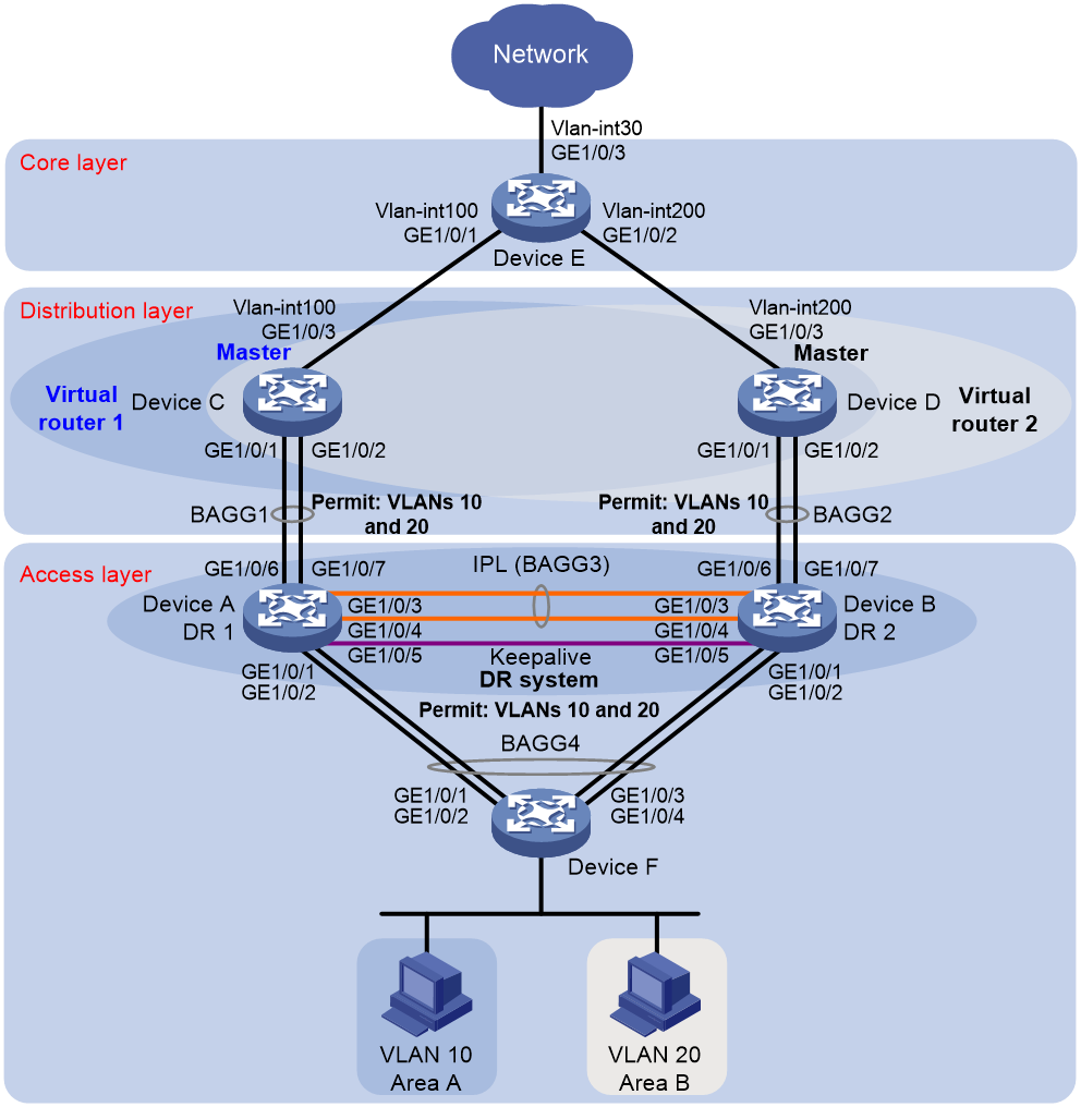

Example: Configuring DRNI at the access Layer
As shown in Figure 1:
·     Configure Device A and Device B as a DR system to establish one multichassis aggregate link with Device F and one with Device C and Device D.
·     Set up a keepalive link between GigabitEthernet 1/0/5 of Device A and GigabitEthernet 1/0/5 of Device B, and exclude the interfaces from the shutdown action by DRNI MAD.
·     Configure two VRRP groups on Device C and Device D to provide gateway services for VLAN 10 and VLAN 20.
¡     Configure VRRP group 1 to provide gateway services for hosts in VLAN 10 (Area A). Add Device C and Device D to the group as the master and backup devices, respectively.
¡     Configure VRRP group 2 to provide gateway services for hosts in VLAN 20 (Area B). Add Device D and Device C to the group as the master and backup devices, respectively.
·     Configure OSPF on Device C, Device D, and Device E for the hosts to communicate with external networks at Layer 3.
Figure 1 Network diagram

Analysis
For the secondary DR device to monitor the state of the primary device, establish a Layer 3 keepalive link between the DR member devices.
To balance traffic between two VRRP gateway devices, you can assign them to two VRRP groups with different priorities. In this example, Device C is assigned a higher priority than Device D in VRRP group 1 so Device C can become the master in this group. Device D is assigned a higher priority than Device C in VRRP group 2 so Device D can become the master in this group.

Configuring Device A
# Configure DR system settings.
<DeviceA> system-view
[DeviceA] drni system-mac 1-1-1
Changing the system MAC might flap the intra-portal link and cause DR system setup failure. Continue? [Y/N]:y
[DeviceA] drni system-number 1
Changing the system number might flap the intra-portal link and cause DR system setup failure. Continue? [Y/N]:y
[DeviceA] drni system-priority 123
Changing the system priority might flap the intra-portal link and cause DR system setup failure. Continue? [Y/N]:y
# Configure DR keepalive packet parameters.
[DeviceA] drni keepalive ip destination 1.1.1.2 source 1.1.1.1
# Configure GigabitEthernet 1/0/5 as a routed (Layer 3) interface and assign the interface an IP address. The IP address will be used as the source IP address of keepalive packets.
[DeviceA] interface gigabitethernet 1/0/5
[DeviceA-GigabitEthernet1/0/5] port link-mode route
[DeviceA-GigabitEthernet1/0/5] ip address 1.1.1.1 24
[DeviceA-GigabitEthernet1/0/5] quit
# Exclude the interface used for DR keepalive detection (GigabitEthernet 1/0/5) from the shutdown action by DRNI MAD.
[DeviceA] drni mad exclude interface gigabitethernet 1/0/5
# Create VLAN 10 and VLAN 20.
[DeviceA] vlan 10
[DeviceA-vlan10] quit
[DeviceA] vlan 20
[DeviceA-vlan20] quit
# Create Layer 2 dynamic aggregate interface Bridge-Aggregation 1.
[DeviceA] interface bridge-aggregation 1
[DeviceA-Bridge-Aggregation1] link-aggregation mode dynamic
[DeviceA-Bridge-Aggregation1] quit
# Assign GigabitEthernet 1/0/6 and GigabitEthernet 1/0/7 to aggregation group 1.
[DeviceA] interface gigabitethernet 1/0/6
[DeviceA-GigabitEthernet1/0/6] port link-aggregation group 1
[DeviceA-GigabitEthernet1/0/6] quit
[DeviceA] interface gigabitethernet 1/0/7
[DeviceA-GigabitEthernet1/0/7] port link-aggregation group 1
[DeviceA-GigabitEthernet1/0/7] quit
# Set the link type of Bridge-Aggregation 1 to trunk and assign it to VLAN 10 and VLAN 20.
[DeviceA-Bridge-Aggregation1] port link-type trunk
Configuring GigabitEthernet1/0/6 done.
Configuring GigabitEthernet1/0/7 done.
[DeviceA-Bridge-Aggregation1] port trunk permit vlan 10 20
# Create Layer 2 dynamic aggregate interface Bridge-Aggregation 3 and specify it as the IPP.
[DeviceA] interface bridge-aggregation 3
[DeviceA-Bridge-Aggregation3] link-aggregation mode dynamic
[DeviceA-Bridge-Aggregation3] port drni intra-portal-port 1
[DeviceA-Bridge-Aggregation3] quit
# Assign GigabitEthernet 1/0/3 and GigabitEthernet 1/0/4 to aggregation group 3.
[DeviceA] interface gigabitethernet 1/0/3
[DeviceA-GigabitEthernet1/0/3] port link-aggregation group 3
[DeviceA-GigabitEthernet1/0/3] quit
[DeviceA] interface gigabitethernet 1/0/4
[DeviceA-GigabitEthernet1/0/4] port link-aggregation group 3
[DeviceA-GigabitEthernet1/0/4] quit
# Set the link type of Bridge-Aggregation 3 to trunk and assign it to VLAN 10 and VLAN 20.
[DeviceA-Bridge-Aggregation3] port link-type trunk
Configuring GigabitEthernet1/0/3 done.
Configuring GigabitEthernet1/0/4 done.
[DeviceA-Bridge-Aggregation3] port trunk permit vlan 10 20
# Create Layer 2 dynamic aggregate interface Bridge-Aggregation 4 and assign it to DR group 4.
[DeviceA] interface bridge-aggregation 4
[DeviceA-Bridge-Aggregation4] link-aggregation mode dynamic
[DeviceA-Bridge-Aggregation4] port drni group 4
[DeviceA-Bridge-Aggregation4] quit
# Assign GigabitEthernet 1/0/1 and GigabitEthernet 1/0/2 to aggregation group 4.
[DeviceA-GigabitEthernet1/0/1] port link-aggregation group 4
[DeviceA-GigabitEthernet1/0/1] quit
[DeviceA] interface gigabitethernet 1/0/2
[DeviceA-GigabitEthernet1/0/2] port link-aggregation group 4
[DeviceA-GigabitEthernet1/0/2] quit
# Set the link type of Bridge-Aggregation 4 to trunk and assign it to VLAN 10 and VLAN 20.
[DeviceA-Bridge-Aggregation4] port link-type trunk
Configuring GigabitEthernet1/0/1 done.
Configuring GigabitEthernet1/0/2 done.
[DeviceA-Bridge-Aggregation4] port trunk permit vlan 10 20
[DeviceB] drni keepalive ip destination 1.1.1.1 source 1.1.1.2
[DeviceB] interface gigabitethernet 1/0/5
[DeviceB-GigabitEthernet1/0/5] port link-mode route
[DeviceB-GigabitEthernet1/0/5] ip address 1.1.1.2 24
[DeviceB-GigabitEthernet1/0/5] quit
[DeviceB] drni mad exclude interface gigabitethernet 1/0/5
[DeviceB] vlan 10
[DeviceB-vlan10] quit
[DeviceB] vlan 20
[DeviceB-vlan20] quit
# Create Layer 2 dynamic aggregate interface Bridge-Aggregation 2.
[DeviceB] interface bridge-aggregation 2
[DeviceB-Bridge-Aggregation2] link-aggregation mode dynamic
[DeviceB-Bridge-Aggregation2] quit
# Assign GigabitEthernet 1/0/6 and GigabitEthernet 1/0/7 to aggregation group 2.
[DeviceB] interface gigabitethernet 1/0/6
[DeviceB-GigabitEthernet1/0/6] port link-aggregation group 2
[DeviceB-GigabitEthernet1/0/6] quit
[DeviceB] interface gigabitethernet 1/0/7
[DeviceB-GigabitEthernet1/0/7] port link-aggregation group 2
[DeviceB-GigabitEthernet1/0/7] quit
# Set the link type of Bridge-Aggregation 2 to trunk and assign it to VLAN 10 and VLAN 20.
[DeviceB-Bridge-Aggregation2] port link-type trunk
[DeviceB-Bridge-Aggregation2] port trunk permit vlan 10 20
[DeviceB] interface bridge-aggregation 3
[DeviceB-Bridge-Aggregation3] link-aggregation mode dynamic
[DeviceB-Bridge-Aggregation3] port drni intra-portal-port 1
[DeviceB-Bridge-Aggregation3] quit
[DeviceB] interface gigabitethernet 1/0/3
[DeviceB-GigabitEthernet1/0/3] port link-aggregation group 3
[DeviceB-GigabitEthernet1/0/3] quit
[DeviceB] interface gigabitethernet 1/0/4
[DeviceB-GigabitEthernet1/0/4] port link-aggregation group 3
[DeviceB-GigabitEthernet1/0/4] quit
[DeviceB-Bridge-Aggregation3] port link-type trunk
[DeviceB-Bridge-Aggregation3] port trunk permit vlan 10 20
[DeviceB] interface bridge-aggregation 4
[DeviceB-Bridge-Aggregation4] link-aggregation mode dynamic
[DeviceB-Bridge-Aggregation4] port drni group 4
[DeviceB-Bridge-Aggregation4] quit
[DeviceB-GigabitEthernet1/0/1] port link-aggregation group 4
[DeviceB-GigabitEthernet1/0/1] quit
[DeviceB] interface gigabitethernet 1/0/2
[DeviceB-GigabitEthernet1/0/2] port link-aggregation group 4
[DeviceB-GigabitEthernet1/0/2] quit
[DeviceB-Bridge-Aggregation4] port link-type trunk
[DeviceB-Bridge-Aggregation4] port trunk permit vlan 10 20
Configuring Device C
# Create VLAN 10, VLAN 20, and VLAN 100.
<DeviceC> system-view
[DeviceC] vlan 10
[DeviceC-vlan10] quit
[DeviceC] vlan 20
[DeviceC-vlan20] quit
[DeviceC] vlan 100
# Assign GigabitEthernet 1/0/3 to VLAN 100.
[DeviceC] vlan 100
[DeviceC-vlan100] port gigabitethernet 1/0/3
[DeviceC-vlan100] quit
[DeviceC] interface bridge-aggregation 1
[DeviceC-Bridge-Aggregation1] link-aggregation mode dynamic
[DeviceC-Bridge-Aggregation1] quit
# Assign GigabitEthernet 1/0/1 and GigabitEthernet1/0/2 to aggregation group 1.
[DeviceC] interface range gigabitethernet 1/0/1 to gigabitethernet 1/0/2
[DeviceC-if-range] port link-aggregation group 1
[DeviceC-if-range] quit
[DeviceC-Bridge-Aggregation1] port link-type trunk
[DeviceC-Bridge-Aggregation1] port trunk permit vlan 10 20
# Create uplink interface VLAN-interface 100 and assign it an IP address.
[DeviceC] interface vlan-interface 100
[DeviceC-Vlan-interface100] ip address 100.1.1.1 24
[DeviceC-Vlan-interface100] quit
# Create VLAN-interface 10 and VLAN-interface 20 and assign an IP address to each of them.
[DeviceC-vlan-interface10] ip address 10.1.1.1 24
[DeviceC-vlan-interface10] quit
[DeviceC] interface vlan-interface 20
[DeviceC-vlan-interface20] ip address 20.1.1.1 24
[DeviceC-vlan-interface20] quit
# Create VRRP group 1 on VLAN-interface 10 and set its virtual IP address to 10.1.1.100.
[DeviceC-Vlan-interface10] vrrp vrid 1 virtual-ip 10.1.1.100
# Set the priority of Device C to 200 for it to become the master in VRRP group 1.
[DeviceC-Vlan-interface10] vrrp vrid 1 priority 200
[DeviceC-Vlan-interface10] quit
# Create VRRP group 2 on VLAN-interface 20 and set its virtual IP address to 20.1.1.100.
[DeviceC-Vlan-interface20] vrrp vrid 2 virtual-ip 20.1.1.100
# Configure Device C to operate in preemptive mode in VRRP group 1. Set the preemption delay to 500 centiseconds to avoid frequent status switchover.
[DeviceC-Vlan-interface10] vrrp vrid 1 preempt-mode delay 500
# Create track entry 1 to monitor the upstream link status of GigabitEthernet 1/0/3.
[DeviceC] track 1 interface gigabitethernet 1/0/3
# Configure Device C in VRRP group 1 to monitor track entry 1, and decrease its priority by 150 when the track entry transits to Negative.
[DeviceC-Vlan-interface10] vrrp vrid 1 track 1 priority reduced 150
# Configure OSPF.
[DeviceC] ospf
[DeviceC-ospf-1] area 0
[DeviceC-ospf-1-area-0.0.0.0] network 10.1.1.0 0.0.0.255
[DeviceC-ospf-1-area-0.0.0.0] network 20.1.1.0 0.0.0.255
[DeviceC-ospf-1-area-0.0.0.0] network 100.1.1.0 0.0.0.255
[DeviceC-ospf-1-area-0.0.0.0] quit
[DeviceC-ospf-1] quit
Configuring Device D
# Create VLAN 10, VLAN 20, and VLAN 200.
<DeviceD> system-view
[DeviceD] vlan 10
[DeviceD-vlan10] quit
[DeviceD] vlan 20
[DeviceD-vlan20] quit
[DeviceD] vlan 200
# Assign GigabitEthernet 1/0/3 to VLAN 200.
[DeviceD] vlan 200
[DeviceD-vlan200] port gigabitethernet 1/0/3
[DeviceD-vlan200] quit
[DeviceD] interface bridge-aggregation 2
[DeviceD-Bridge-Aggregation2] link-aggregation mode dynamic
[DeviceD-Bridge-Aggregation2] quit
# Assign GigabitEthernet 1/0/1 and GigabitEthernet 1/0/2 to aggregation group 2.
[DeviceD] interface range gigabitethernet 1/0/1 to gigabitethernet 1/0/2
[DeviceD-if-range] port link-aggregation group 2
[DeviceD-if-range] quit
[DeviceD-Bridge-Aggregation2] port link-type trunk
[DeviceD-Bridge-Aggregation2] port trunk permit vlan 10 20
# Create uplink interface VLAN-interface 200 and assign it an IP address.
[DeviceD] interface vlan-interface 200
[DeviceD-Vlan-interface200] ip address 200.1.1.1 24
[DeviceD-Vlan-interface200] quit
[DeviceD] interface vlan-interface 10
[DeviceD-vlan-interface10] ip address 10.1.1.2 24
[DeviceD-vlan-interface10] quit
[DeviceD-vlan-interface20] ip address 20.1.1.2 24
[DeviceD-vlan-interface20] quit
[DeviceD-Vlan-interface10] vrrp vrid 1 virtual-ip 10.1.1.100
[DeviceD-Vlan-interface20] vrrp vrid 2 virtual-ip 20.1.1.100
# Set the priority of Device D to 200 for it to become the master in VRRP group 2.
[DeviceD-Vlan-interface20] vrrp vrid 2 priority 200
# Configure Device D to operate in preemptive mode in VRRP group 2. Set the preemption delay to 500 centiseconds to avoid frequent status switchover.
[DeviceD-Vlan-interface20] vrrp vrid 2 preempt-mode delay 500
[DeviceD-Vlan-interface20] quit
# Create track entry 2 to monitor the upstream link status of GigabitEthernet 1/0/3.
[DeviceD] track 2 interface gigabitethernet 1/0/3
# Configure Device D in VRRP group 2 to monitor track entry 2, and decrease its priority by 150 when the track entry transits to Negative.
[DeviceD-Vlan-interface20] vrrp vrid 2 track 2 priority reduced 150
# Configure OSPF.
[DeviceD] ospf
[DeviceD-ospf-1] area 0
[DeviceD-ospf-1-area-0.0.0.0] network 10.1.1.0 0.0.0.255
[DeviceD-ospf-1-area-0.0.0.0] network 20.1.1.0 0.0.0.255
[DeviceD-ospf-1-area-0.0.0.0] network 200.1.1.0 0.0.0.255
[DeviceD-ospf-1-area-0.0.0.0] quit
[DeviceD-ospf-1] quit
Configuring Device E
# Create VLAN 100 and assign GigabitEthernet 1/0/1 to the VLAN.
<DeviceE> system-view
[DeviceE] vlan 100
[DeviceE-vlan100] port gigabitethernet 1/0/1
[DeviceE-vlan100] quit
# Create VLAN-interface 100 and assign it an IP address.
[DeviceE] interface vlan-interface 100
[DeviceE-vlan-interface100] ip address 100.1.1.2 24
[DeviceE-vlan-interface100] quit
# Create VLAN 200 and assign GigabitEthernet 1/0/2 to the VLAN.
[DeviceE] vlan 200
[DeviceE-vlan200] port gigabitethernet 1/0/2
[DeviceE-vlan200] quit
# Create VLAN-interface 200 and assign it an IP address.
[DeviceE] interface vlan-interface 200
[DeviceE-vlan-interface200] ip address 200.1.1.2 24
[DeviceE-vlan-interface200] quit
# Create VLAN 30 and assign GigabitEthernet 1/0/3 to the VLAN.
[DeviceE] vlan 30
[DeviceE-vlan30] port gigabitethernet 1/0/3
[DeviceE-vlan30] quit
# Create VLAN-interface 30 and assign it an IP address.
[DeviceE] interface vlan-interface 30
[DeviceE-vlan-interface30] ip address 30.1.1.1 24
[DeviceE-vlan-interface30] quit
# Configure OSPF.
[DeviceD] ospf
[DeviceD-ospf-1-area-0.0.0.0] network 100.1.1.0 0.0.0.255
[DeviceD-ospf-1-area-0.0.0.0] network 30.1.1.0 0.0.0.255
Configuring Device F
[DeviceF] vlan 10
[DeviceF-vlan10] quit
[DeviceF] vlan 20
[DeviceF-vlan20] quit
# Create Layer 2 dynamic aggregate interface Bridge-Aggregation 4.
[DeviceF] interface bridge-aggregation 4
[DeviceF-Bridge-Aggregation4] link-aggregation mode dynamic
[DeviceF-Bridge-Aggregation4] quit
# Assign GigabitEthernet 1/0/1 through GigabitEthernet 1/0/4 to aggregation group 4.
[DeviceF] interface range gigabitethernet 1/0/1 to gigabitethernet 1/0/4
[DeviceF-if-range] port link-aggregation group 4
[DeviceF-if-range] quit
[DeviceF-Bridge-Aggregation4] port link-type trunk
[DeviceF-Bridge-Aggregation4] port trunk permit vlan 10 20
This configuration example uses the output from Release 6615P03. The command output varies by software version.
# Verify that Device A and Device B have formed a DR system.
[DeviceA] display drni summary
Flags: A -- Aggregate interface down, B -- No peer DR interface configured
       C -- Configuration consistency check failed
IPP: BAGG3
IPP state (cause): UP
Keepalive link state (cause): UP
                     DR interface information
DR interface  DR group  Local state (cause)  Peer state  Remaining down time (s)

[DeviceA] display drni verbose
Flags: A -- Home_Gateway, B -- Neighbor_Gateway, C -- Other_Gateway,
       D -- IPP_Activity, E -- DRCP_Timeout, F -- Gateway_Sync,
       G -- Port_Sync, H -- Expired
IPP/IPP ID: BAGG3/1
State: UP
Cause: -
Local DRCP flags/Peer DRCP flags: ABDFG/ABDFG
Local Selected ports (index): GE1/0/3 (260), GE1/0/4 (261)
Peer Selected ports indexes: 260, 261
DR interface/DR group ID: BAGG4/4
Local DR interface state: UP
Peer DR interface state: UP
DR group state: UP
Local DR interface down cause: -
Remaining DRNI DOWN time: -
Local DR interface LACP MAC: Config=0001-0001-0001, Effective=0001-0001-0001
Peer DR interface LACP MAC: Config=0001-0001-0001, Effective=0001-0001-0001
Local DR interface LACP priority: Config=123, Effective=123
Peer DR interface LACP priority: Config=123, Effective=123
Local Selected ports (index): GE1/0/1 (258), GE1/0/2 (259)
Peer Selected ports indexes: 258, 259
# Verify that all member ports of aggregation group 4 are in Selected state on Device F, which indicates a successful link aggregation between the DR system and Device F.
[DeviceF] display link-aggregation verbose
Loadsharing Type: Shar -- Loadsharing, NonS -- Non-Loadsharing
Port Status: S -- Selected, U -- Unselected, I -- Individual
Port: A -- Auto port, M -- Management port, R -- Reference port
Flags:  A -- LACP_Activity, B -- LACP_Timeout, C -- Aggregation,
        G -- Defaulted, H -- Expired
Aggregate Interface: Bridge-Aggregation4
Creation Mode: Manual
Aggregation Mode: Dynamic
Management VLANs: None
System ID: 0x8000, 1eba-3c46-0300
Local:
  Port                Status   Priority Index    Oper-Key               Flag
  GE1/0/1             S        32768    1        1                      {ACDEF}
  GE1/0/2             S        32768    2        1                      {ACDEF}
  GE1/0/3             S        32768    3        1                      {ACDEF}
  GE1/0/4             S        32768    4        1                      {ACDEF}
Remote:
  Actor               Priority Index    Oper-Key SystemID               Flag
  GE1/0/1(R)          32768    16385    40004    0x7b  , 0001-0001-0001 {ACDEF}
  GE1/0/2             32768    16388    40004    0x7b  , 0001-0001-0001 {ACDEF}
  GE1/0/3             32768    32769    40004    0x7b  , 0001-0001-0001 {ACDEF}
  GE1/0/4             32768    32772    40004    0x7b  , 0001-0001-0001 {ACDEF}
# Verify that Device C is the master in VRRP group 1 and Device D is the master in VRRP group 2.
[DeviceC] display vrrp
IPv4 Virtual Router Information:
 Running mode : Standard
 Total number of virtual routers : 2
 Interface          VRID  State        Running Adver   Auth     Virtual
                                       Pri     Timer   Type        IP
 Vlan10             1     Master       200     100     None     10.1.1.100
 Vlan20             2     Backup       100     100     None     20.1.1.100
[DeviceD] display vrrp
                                       Pri     Timer   Type        IP
 Vlan10             1     Backup       100     100     None     10.1.1.100
 Vlan20             2     Master       200     100     None     20.1.1.100
# Verify that Device E has established OSPF neighbor relationships with Device C and Device D.
[DeviceE] display ospf peer
         OSPF Process 1 with Router ID 200.1.1.2
               Neighbor Brief Information
 Area: 0.0.0.0
 Router ID       Address         Pri Dead-Time  State             Interface
 100.1.1.1       100.1.1.1       1   35         Full/BDR          Vlan100
 200.1.1.1       200.1.1.1       1   33         Full/BDR          Vlan200
# Verify that the host in Area A can ping VLAN-interface 30 (30.1.1.1) on Device E.
C:\Documents and Settings\Administrator>ping 30.1.1.1
Pinging 30.1.1.1 with 32 bytes of data:
Reply from 30.1.1.1: bytes=32 time=1ms TTL=126
Ping statistics for 30.1.1.1:

·     Device A:
vlan 10
vlan 20
interface Bridge-Aggregation1
 port trunk permit vlan 1 10 20
interface Bridge-Aggregation3
interface Bridge-Aggregation4
 port drni group 4
interface GigabitEthernet1/0/5
 ip address 1.1.1.1 255.255.255.0
 port link-mode bridge
interface GigabitEthernet1/0/4
interface GigabitEthernet1/0/6
interface GigabitEthernet1/0/7
 drni system-mac 0001-0001-0001
 drni mad exclude interface GigabitEthernet1/0/5
·     Device B:
vlan 10
vlan 20
interface Bridge-Aggregation2
 port drni group 4
 ip address 1.1.1.2 255.255.255.0
 drni system-number 2
·     Device C:
ospf 1
 area 0.0.0.0
vlan 10
vlan 20
vlan 100
interface Vlan-interface10
interface Vlan-interface20
 ip address 20.1.1.1 255.255.255.0
interface Vlan-interface100
 ip address 100.1.1.1 255.255.255.0
 port access vlan 100
 track 1 interface GigabitEthernet1/0/3
·     Device D:
ospf 1
 area 0.0.0.0
vlan 10
vlan 20
vlan 200
 ip address 10.1.1.2 255.255.255.0
 ip address 20.1.1.2 255.255.255.0
interface Vlan-interface200
 ip address 200.1.1.1 255.255.255.0
 port access vlan 200
 track 2 interface GigabitEthernet1/0/3
·     Device E:
ospf 1
 area 0.0.0.0
vlan 30
vlan 100
vlan 200
interface Vlan-interface30
 ip address 30.1.1.1 255.255.255.0
 ip address 100.1.1.2 255.255.255.0
 ip address 200.1.1.2 255.255.255.0
 port access vlan 30
·     Device F:
vlan 10
vlan 20

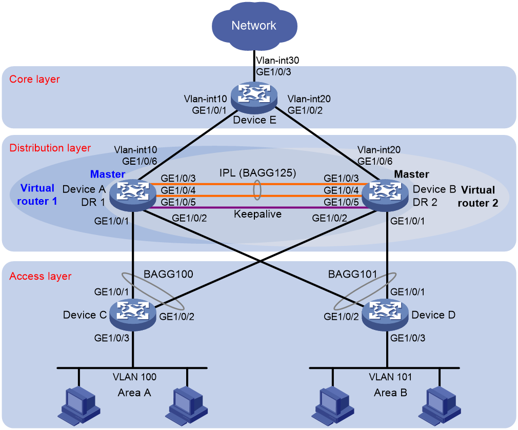

Example: Configuring DRNI at the distribution Layer
As shown in Figure 2:
·     Configure Device A and Device B as a DR system to establish one multichassis aggregate link with Device C and Device D.
·     Configure two VRRP groups on Device A and Device B to provide gateway services for VLAN 100 and VLAN 101.
¡     Configure VRRP group 1 to provide gateway services for hosts in VLAN 100 (Area A). Add Device A and Device B to the group as the master and backup devices, respectively.
¡     Configure VRRP group 2 to provide gateway services for hosts in VLAN 101 (Area B). Add Device B and Device A to the group as the master and backup devices, respectively.
·     Configure OSPF on Device A, Device B, and Device E for the hosts to communicate with external networks at Layer 3.

Analysis
For Device A to be the master in VRRP group 1, assign it a higher priority than Device B. For Device B to be the master in VRRP group 2, assign it a higher priority than Device A.
# Create Layer 2 dynamic aggregate interface Bridge-Aggregation 125 and specify it as the IPP.
[DeviceA] interface bridge-aggregation 125
[DeviceA-Bridge-Aggregation125] link-aggregation mode dynamic
[DeviceA-Bridge-Aggregation125] port drni intra-portal-port 1
[DeviceA-Bridge-Aggregation125] quit
# Assign GigabitEthernet 1/0/3 and GigabitEthernet 1/0/4 to aggregation group 125.
[DeviceA-GigabitEthernet1/0/3] port link-aggregation group 125
[DeviceA-GigabitEthernet1/0/4] port link-aggregation group 125
# Create Layer 2 dynamic aggregate interface Bridge-Aggregation 100 and assign it to DR group 1.
[DeviceA] interface bridge-aggregation 100
[DeviceA-Bridge-Aggregation100] link-aggregation mode dynamic
[DeviceA-Bridge-Aggregation100] port drni group 1
[DeviceA-Bridge-Aggregation100] quit
# Assign GigabitEthernet 1/0/1 to aggregation group 100.
[DeviceA-GigabitEthernet1/0/1] port link-aggregation group 100
# Create Layer 2 dynamic aggregate interface Bridge-Aggregation 101 and assign it to DR group 2.
[DeviceA] interface bridge-aggregation 101
[DeviceA-Bridge-Aggregation101] link-aggregation mode dynamic
[DeviceA-Bridge-Aggregation101] port drni group 2
[DeviceA-Bridge-Aggregation101] quit
# Assign GigabitEthernet 1/0/2 to aggregation group 101.
[DeviceA-GigabitEthernet1/0/2] port link-aggregation group 101
# Create VLAN 10, VLAN 100, and VLAN 101.
[DeviceA] vlan 10
[DeviceA] vlan 100
[DeviceA-vlan100] quit
[DeviceA] vlan 101
[DeviceA-vlan101] quit
# Assign GigabitEthernet 1/0/6 to VLAN 10.
[DeviceA] vlan 10
[DeviceA-vlan10] port gigabitethernet 1/0/6
# Set the link type of Bridge-Aggregation 100 to trunk and assign it to VLAN 100.
[DeviceA-Bridge-Aggregation100] port link-type trunk
[DeviceA-Bridge-Aggregation100] port trunk permit vlan 100
# Set the link type of Bridge-Aggregation 101 to trunk and assign it to VLAN 101.
[DeviceA-Bridge-Aggregation101] port link-type trunk
[DeviceA-Bridge-Aggregation101] port trunk permit vlan 101
# Set the link type of Bridge-Aggregation 125 to trunk and assign it to VLAN 100 and VLAN 101.
[DeviceA-Bridge-Aggregation125] port link-type trunk
[DeviceA-Bridge-Aggregation125] port trunk permit vlan 100 101
# Create VLAN-interface 10, VLAN-interface 100, and VLAN-interface 101 and assign an IP address to each of them.
[DeviceA] interface vlan-interface 10
[DeviceA-vlan-interface10] ip address 10.1.1.1 24
[DeviceA-vlan-interface10] quit
[DeviceA] interface vlan-interface 100
[DeviceA-vlan-interface100] ip address 100.1.1.1 24
[DeviceA-vlan-interface100] quit
[DeviceA] interface vlan-interface 101
[DeviceA-vlan-interface101] ip address 101.1.1.1 24
[DeviceA-vlan-interface101] quit
# Configure OSPF.
[DeviceA] ospf
[DeviceA-ospf-1] area 0
[DeviceA-ospf-1-area-0.0.0.0] network 10.1.1.0 0.0.0.255
[DeviceA-ospf-1-area-0.0.0.0] network 100.1.1.0 0.0.0.255
[DeviceA-ospf-1-area-0.0.0.0] network 101.1.1.0 0.0.0.255
[DeviceA-ospf-1-area-0.0.0.0] quit
[DeviceA-ospf-1] quit
# Create VRRP group 1 on VLAN-interface 100 and set its virtual IP address to 100.1.1.100.
[DeviceA-Vlan-interface100] vrrp vrid 1 virtual-ip 100.1.1.100
# Set the priority of Device A to 200 for it to become the master in VRRP group 1.
[DeviceA-Vlan-interface100] vrrp vrid 1 priority 200
[DeviceA-Vlan-interface100] quit
# Create VRRP group 2 on VLAN-interface 101 and set its virtual IP address to 101.1.1.100.
[DeviceA-Vlan-interface101] vrrp vrid 2 virtual-ip 101.1.1.100
[DeviceA-Vlan-interface101] quit
# Configure Device A to operate in preemptive mode in VRRP group 1. Set the preemption delay to 500 centiseconds to avoid frequent status switchover.
[DeviceA-Vlan-interface100] vrrp vrid 1 preempt-mode delay 500
# Create track entry 1 to monitor the upstream link status of GigabitEthernet 1/0/6.
[DeviceA] track 1 interface gigabitethernet 1/0/6
# Configure Device A in VRRP group 1 to monitor track entry 1, and decrease its priority by 150 when the track entry transits to Negative.
[DeviceA-Vlan-interface100] vrrp vrid 1 track 1 priority reduced 150

[DeviceB-vlan-interface101] quit
# Configure OSPF.
[DeviceB] ospf
[DeviceB-ospf-1] area 0
[DeviceB-ospf-1-area-0.0.0.0] network 20.1.1.0 0.0.0.255
[DeviceB-ospf-1-area-0.0.0.0] network 100.1.1.0 0.0.0.255
[DeviceB-ospf-1-area-0.0.0.0] network 101.1.1.0 0.0.0.255
[DeviceB-ospf-1-area-0.0.0.0] quit
[DeviceB-ospf-1] quit
[DeviceB] interface vlan-interface 100
[DeviceB-Vlan-interface100] vrrp vrid 1 virtual-ip 100.1.1.100
[DeviceB-Vlan-interface100] quit
[DeviceB] interface vlan-interface 101
[DeviceB-Vlan-interface101] vrrp vrid 2 virtual-ip 101.1.1.100
# Set the priority of Device B to 200 for it to become the master in VRRP group 2.
[DeviceB-Vlan-interface101] vrrp vrid 2 priority 200
# Configure Device B to operate in preemptive mode in VRRP group 2. Set the preemption delay to 500 centiseconds to avoid frequent status switchover.
[DeviceB-Vlan-interface101] vrrp vrid 2 preempt-mode delay 500
[DeviceB-Vlan-interface101] quit
# Create track entry 2 to monitor the upstream link status of GigabitEthernet 1/0/6.
[DeviceB] track 2 interface gigabitethernet 1/0/6
# Configure Device B in VRRP group 2 to monitor track entry 2, and decrease its priority by 150 when the track entry transits to Negative.
[DeviceB-Vlan-interface101] vrrp vrid 2 track 2 priority reduced 150
# Create VLAN 100.
[DeviceC] vlan 100
[DeviceC] interface gigabitethernet 1/0/3
[DeviceC-GigabitEthernet1/0/3] port access vlan 100
[DeviceC-GigabitEthernet1/0/3] quit
# Create Layer 2 dynamic aggregate interface Bridge-Aggregation 100.
[DeviceC] interface bridge-aggregation 100
[DeviceC-Bridge-Aggregation100] link-aggregation mode dynamic
[DeviceC-Bridge-Aggregation100] quit
# Assign GigabitEthernet 1/0/1 and GigabitEthernet 1/0/2 to aggregation group 100.
[DeviceC-if-range] port link-aggregation group 100
[DeviceC-Bridge-Aggregation100] port link-type trunk
[DeviceC-Bridge-Aggregation100] port trunk permit vlan 100
# Create VLAN 101.
[DeviceD] vlan 101
[DeviceD-vlan101] quit
# Assign GigabitEthernet 1/0/3 to VLAN 101.
[DeviceD] interface gigabitethernet 1/0/3
[DeviceD-GigabitEthernet1/0/3] port access vlan 101
[DeviceD-GigabitEthernet1/0/3] quit
# Create Layer 2 dynamic aggregate interface Bridge-Aggregation 101.
[DeviceD] interface bridge-aggregation 101
[DeviceD-Bridge-Aggregation101] link-aggregation mode dynamic
[DeviceD-Bridge-Aggregation101] quit
# Assign GigabitEthernet 1/0/1 and GigabitEthernet 1/0/2 to aggregation group 101.
[DeviceD-if-range] port link-aggregation group 101
[DeviceD-Bridge-Aggregation101] port link-type trunk
[DeviceD-Bridge-Aggregation101] port trunk permit vlan 101
# Create VLAN 10 and assign GigabitEthernet 1/0/1 to the VLAN.
[DeviceE] vlan 10
[DeviceE-vlan10] port gigabitethernet 1/0/1
[DeviceE-vlan10] quit
# Create VLAN-interface 10 and assign it an IP address.
[DeviceE-vlan-interface10] ip address 10.1.1.2 24
[DeviceE-vlan-interface10] quit
# Create VLAN 20 and assign GigabitEthernet 1/0/2 to the VLAN.
[DeviceE] vlan 20
[DeviceE-vlan20] port gigabitethernet 1/0/2
[DeviceE-vlan20] quit
# Create VLAN-interface 20 and assign it an IP address.
[DeviceE-vlan-interface20] ip address 20.1.1.2 24
[DeviceE-vlan-interface20] quit
[DeviceE] vlan 30
# Configure OSPF.
[DeviceE] ospf
[DeviceE-ospf-1] area 0
[DeviceE-ospf-1-area-0.0.0.0] network 10.1.1.0 0.0.0.255
[DeviceE-ospf-1-area-0.0.0.0] network 20.1.1.0 0.0.0.255
[DeviceE-ospf-1-area-0.0.0.0] network 30.1.1.0 0.0.0.255
[DeviceE-ospf-1-area-0.0.0.0] quit
[DeviceE-ospf-1] quit
IPP: BAGG125
BAGG100       1         UP                   UP          -
BAGG101       2         UP                   UP          -
IPP/IPP ID: BAGG125/1
State: UP
Cause: -
Local Selected ports (index): GE1/0/3 (261), GE1/0/4 (262)
Peer Selected ports indexes: 261, 262
DR interface/DR group ID: BAGG100/1
DR group state: UP
Local Selected ports (index): GE1/0/1 (259)
Peer Selected ports indexes: 259
DR interface/DR group ID: BAGG101/2
DR group state: UP
Local Selected ports (index): GE1/0/2 (260)
# Verify that all member ports of aggregation group 100 are in Selected state on Device C, which indicates a successful link aggregation between the DR system and Device C.
[DeviceC] display link-aggregation verbose
Aggregate Interface: Bridge-Aggregation100
System ID: 0x8000, 8e33-8e4a-0300
Local:
Remote:
  GE1/0/1(R)          32768    16386    40001    0x7b  , 0001-0001-0001 {ACDEF}
  GE1/0/2             32768    32770    40001    0x7b  , 0001-0001-0001 {ACDEF}
# Verify that all member ports of aggregation group 101 are in Selected state on Device D, which indicates a successful link aggregation between the DR system and Device D.
[DeviceD] display link-aggregation verbose
Aggregate Interface: Bridge-Aggregation101
System ID: 0x8000, 8e33-9400-0400
Local:
Remote:
  GE1/0/1(R)          32768    16387    40002    0x7b  , 0001-0001-0001 {ACDEF}
  GE1/0/2             32768    32771    40002    0x7b  , 0001-0001-0001 {ACDEF}
# Verify that Device A is the master in VRRP group 1 and Device B is the master in VRRP group 2.
[DeviceA] display vrrp
                                       Pri     Timer   Type        IP
 Vlan100            1     Master       200     100     None     100.1.1.100
 Vlan101            2     Backup       100     100     None     101.1.1.100
[DeviceB] display vrrp
                                       Pri     Timer   Type        IP
 Vlan100            1     Backup       100     100     None     100.1.1.100
 Vlan101            2     Master       200     100     None     101.1.1.100
# Verify that Device E has established OSPF neighbor relationships with Device A and Device B.
         OSPF Process 1 with Router ID 30.1.1.1
 Area: 0.0.0.0
 101.1.1.1       10.1.1.1        1   34         Full/DR           Vlan10
 101.1.1.2       20.1.1.1        1   36         Full/DR           Vlan20
# Verify that a host in Area A can ping the host at 101.1.1.4 in Area B.
C:\Documents and Settings\Administrator>ping 101.1.1.4
Pinging 101.1.1.4 with 32 bytes of data:
Reply from 101.1.1.4: bytes=32 time=1ms TTL=126
Ping statistics for 101.1.1.4:
# Verify that a host in Area A can ping VLAN-interface 30 (30.1.1.1) on Device E.
Configuration files
IMPORTANT
IMPORTANT:
Support for the port link-mode bridge command depends on the device model.
·     Device A:
ospf 1
 area 0.0.0.0
vlan 10
vlan 100 to 101
interface Bridge-Aggregation100
 port trunk permit vlan 1 100
 port drni group 1
interface Bridge-Aggregation101
 port trunk permit vlan 1 101
 port drni group 2
interface Bridge-Aggregation125
 port trunk permit vlan 1 100 to 101
interface Vlan-interface101
 ip address 101.1.1.1 255.255.255.0
 port access vlan 10
 track 1 interface GigabitEthernet1/0/6
·     Device B:
ospf 1
 area 0.0.0.0
vlan 20
vlan 100 to 101
 port drni group 1
 port drni group 2
 ip address 101.1.1.2 255.255.255.0
 port access vlan 20
 track 2 interface GigabitEthernet1/0/6
·     Device C:
vlan 100
·     Device D:
vlan 101
·     Device E:
ospf 1
 area 0.0.0.0
vlan 10
vlan 20
vlan 30
 port access vlan 10
 port access vlan 20
 port access vlan 30

[DeviceA] drni mad exclude interface vlan-interface101
# Configure the router ID as 3.3.3.3.
[DeviceA] router id 3.3.3.3
# Configure OSPF on VLAN-interface 100 and VLAN-interface 101. Disable VLAN-interface 100 from receiving and sending OSPF packets. The OSPF configuration enables the DR member devices to have IPv4 connectivity.
[DeviceA] ospf 1
[DeviceA-ospf-1] silent-interface vlan-interface 100
[DeviceA-ospf-1] import-route direct
[DeviceA-Vlan-interface100] ospf 1 area 0.0.0.0
[DeviceA-Vlan-interface101] ospf 1 area 0.0.0.0
# Configure OSPFv3 on VLAN-interface 100 and VLAN-interface 101. Disable VLAN-interface 100 from receiving and sending OSPFv3 packets. The OSPFv3 configuration enables the DR member devices to have IPv6 connectivity.
[DeviceA] ospfv3 1
[DeviceA-ospfv3-1] silent-interface vlan-interface 100
[DeviceA-ospfv3-1] import-route direct
[DeviceA-ospfv3-1] area 0
[DeviceA-ospfv3-1-area-0.0.0.0] quit
[DeviceA-ospfv3-1] quit
[DeviceA-Vlan-interface100] ospfv3 1 area 0.0.0.0
[DeviceA-Vlan-interface101] ospfv3 1 area 0.0.0.0
# Create VLAN 32, and assign GigabitEthernet 1/0/6 to the VLAN. The interface is an uplink member interface of the DR interface.
[DeviceA] vlan 32
[DeviceA-vlan32] quit
[DeviceA-GigabitEthernet1/0/6] port link-type trunk
[DeviceA-GigabitEthernet1/0/6] port trunk permit vlan 32
[DeviceA-GigabitEthernet1/0/6] undo port trunk permit vlan 1
# Create VLAN-interface 32, and assign the interface an IPv4 address and an IPv6 address. Enable OSPF and OSPFv3 on the interface.
[DeviceA] interface vlan-interface 32
[DeviceA-Vlan-interface32] ip address 32.1.1.1 255.255.255.0
[DeviceA-Vlan-interface32] ipv6 address 32::1 64
[DeviceA-Vlan-interface32] ospf 1 area 0
[DeviceA-Vlan-interface32] ospfv3 1 area 0
[DeviceA-Vlan-interface32] quit
Configuring Device B
<DeviceB> system-view
[DeviceB] drni system-mac 0002-0002-0002
[DeviceB] drni system-number 2
[DeviceB] drni system-priority 123
[DeviceB] drni keepalive ip destination 21.1.1.1 source 21.1.1.2
[DeviceB-GigabitEthernet1/0/5] ip address 21.1.1.2 255.255.255.0
[DeviceB-GigabitEthernet1/0/5] ipv6 address 21::2 64
[DeviceB] interface bridge-aggregation 1
[DeviceB-Bridge-Aggregation1] link-aggregation mode dynamic
[DeviceB-Bridge-Aggregation1] quit
# Assign GigabitEthernet 1/0/3 and GigabitEthernet 1/0/4 to aggregation group 1.
[DeviceB-GigabitEthernet1/0/3] port link-aggregation group 1
[DeviceB-GigabitEthernet1/0/4] port link-aggregation group 1
# Configure Bridge-Aggregation 1 as the IPP.
[DeviceB-Bridge-Aggregation1] port drni intra-portal-port 1
[DeviceB-Bridge-Aggregation1] undo port trunk permit vlan 1
# Create Layer 2 dynamic aggregate interface Bridge-Aggregation 3, and assign it to DR group 1.
[DeviceB-Bridge-Aggregation3] port drni group 1
# Assign GigabitEthernet 1/0/1 and GigabitEthernet 1/0/2 to aggregation group 3.
[DeviceB-GigabitEthernet1/0/1] port link-aggregation group 3
[DeviceB-GigabitEthernet1/0/2] port link-aggregation group 3
# Create VLAN 100 and VLAN 101.
[DeviceB] vlan 100
[DeviceB-vlan100] quit
[DeviceB] vlan 101
[DeviceB-vlan101] quit
# Set the link type of Bridge-Aggregation 3 to trunk, and assign it to VLAN 100.
[DeviceB-Bridge-Aggregation3] port trunk permit vlan 100
[DeviceB-Bridge-Aggregation3] undo port trunk permit vlan 1
# Create VLAN-interface 100, and assign it an IPv4 address and a MAC address for it to act as an IPv4 gateway.
[DeviceB-Vlan-interface100] ip address 100.1.1.100 255.255.255.0
[DeviceB-Vlan-interface100] mac-address 0000-0010-0010
# Assign VLAN-interface 100 an IPv6 address and a link-local address for it to act as an IPv6 gateway.
[DeviceB-Vlan-interface100] ipv6 address 100::100 64
[DeviceB-Vlan-interface100] ipv6 address FE80::80 link-local
# Exclude VLAN-interface 100 from the shutdown action by DRNI MAD.
[DeviceB] drni mad exclude interface vlan-interface100
# Create VLAN-interface 101 and assign it an IPv4 address and an IPv6 address for the device to communicate with the DR peer at Layer 3.
[DeviceB-vlan-interface101] ip address 101.1.1.2 24
[DeviceB-vlan-interface101] ipv6 address 101::2 64
# Exclude VLAN-interface 101 from the shutdown action by DRNI MAD.
[DeviceB] drni mad exclude interface vlan-interface101
# Configure the router ID as 4.4.4.4.
[DeviceB] router id 4.4.4.4
[DeviceB] ospf 1
[DeviceB-ospf-1] silent-interface vlan-interface100
[DeviceB-ospf-1] import-route direct
[DeviceB-Vlan-interface100] ospf 1 area 0.0.0.0
[DeviceB-Vlan-interface101] ospf 1 area 0.0.0.0
[DeviceB] ospfv3 1
[DeviceB-ospfv3-1] import-route direct
[DeviceB-ospfv3-1] area 0
[DeviceB-ospfv3-1-area-0.0.0.0] quit
[DeviceB-ospfv3-1] quit
[DeviceB-vlan-interface100] ospfv3 1 area 0
[DeviceB-vlan-interface100] quit
[DeviceB-vlan-interface101] ospfv3 1 area 0
# Create VLAN 33, and assign GigabitEthernet 1/0/6 to the VLAN. The interface is an uplink member interface of the DR interface.
[DeviceB] vlan 33
[DeviceB-vlan33] quit
[DeviceB-GigabitEthernet1/0/6] port link-type trunk
[DeviceB-GigabitEthernet1/0/6] port trunk permit vlan 33
[DeviceB-GigabitEthernet1/0/6] undo port trunk permit vlan 1
# Create VLAN-interface 33, and assign the interface an IPv4 address and an IPv6 address. Enable OSPF and OSPFv3 on the interface.
[DeviceB] interface vlan-interface 33
[DeviceB-Vlan-interface33] ip address 33.1.1.1 255.255.255.0
[DeviceB-Vlan-interface33] ipv6 address 33::1 64
[DeviceB-Vlan-interface33] ospf 1 area 0
[DeviceB-Vlan-interface33] ospfv3 1 area 0
[DeviceB-Vlan-interface33] quit
# Create VLAN 32 and assign GigabitEthernet 1/0/1 (attached to Device A) to the VLAN. Create VLAN-interface 32 and assign it an IPv4 address and an IPv6 address.
[DeviceC] vlan 32
[DeviceC-vlan32] quit
[DeviceC] interface gigabitethernet 1/0/1
[DeviceC-GigabitEthernet1/0/1] port link-type trunk
[DeviceC-GigabitEthernet1/0/1] port trunk permit vlan 32
[DeviceC-GigabitEthernet1/0/1] undo port trunk permit vlan 1
[DeviceC-GigabitEthernet1/0/] quit
[DeviceC] interface vlan-interface 32
[DeviceC-Vlan-interface32] ip address 32.1.1.2 24
[DeviceC-Vlan-interface32] ipv6 address 32::2 64
[DeviceC-Vlan-interface32] quit
# Create VLAN 33 and assign GigabitEthernet 1/0/2 (attached to Device B) to the VLAN. Create VLAN-interface 33 and assign it an IPv4 address and an IPv6 address.
[DeviceC] vlan 33
[DeviceC-vlan33] quit
[DeviceC] interface gigabitethernet 1/0/2
[DeviceC-GigabitEthernet1/0/2] port link-type trunk
[DeviceC-GigabitEthernet1/0/2] port trunk permit vlan 33
[DeviceC-GigabitEthernet1/0/2] undo port trunk permit vlan 1
[DeviceC-GigabitEthernet1/0/2] quit
[DeviceC] interface vlan-interface 33
[DeviceC-Vlan-interface33] ip address 33.1.1.2 24
[DeviceC-Vlan-interface33] ipv6 address 33::2 64
[DeviceC-Vlan-interface33] quit
# Configure the router ID as 5.5.5.5.
[DeviceC] router id 5.5.5.5
# Enable OSPF on VLAN-interface 32 and VLAN-interface 33.
[DeviceC] ospf 1
[DeviceC-ospf-1] import-route direct
[DeviceC-Vlan-interface32] ospf 1 area 0
[DeviceC-Vlan-interface33] ospf 1 area 0
# Enable OSPFv3 on VLAN-interface 32 and VLAN-interface 33.
[DeviceC] ospfv3 1
[DeviceC-ospfv3-1] import-route direct
[DeviceC-ospfv3-1] area 0
[DeviceC-ospfv3-1-area-0.0.0.0] quit
[DeviceC-ospfv3-1] quit
[DeviceC-Vlan-interface32] ospfv3 1 area 0
[DeviceC-Vlan-interface33] ospfv3 1 area 0
# Create VLAN 22, and assign GigabitEthernet 1/0/3 (attached to the upstream network) to the VLAN. Create VLAN-interface 22 and assign it an IPv4 address and an IPv6 address.
[DeviceC] vlan 22
[DeviceC-vlan22] quit
[DeviceC-GigabitEthernet1/0/3] port link-type trunk
[DeviceC-GigabitEthernet1/0/3] port trunk permit vlan 22
[DeviceC-GigabitEthernet1/0/3] undo port trunk permit vlan 1
[DeviceC] interface vlan-interface 22
[DeviceC-Vlan-interface22] ip address 22.1.1.1 24
[DeviceC-Vlan-interface22] ipv6 address 22::1 64
[DeviceC-Vlan-interface22] quit
# Create Layer 2 dynamic aggregate interface Bridge-Aggregation 3.
[DeviceD] interface bridge-aggregation 3
[DeviceD-Bridge-Aggregation3] link-aggregation mode dynamic
[DeviceD-Bridge-Aggregation3] quit
# Assign GigabitEthernet 1/0/1 through GigabitEthernet 1/0/4 to aggregation group 3.
[DeviceD] interface range gigabitethernet 1/0/1 to gigabitethernet 1/0/4
[DeviceD-if-range] port link-aggregation group 3
# Create VLAN 100.
[DeviceD] vlan 100
[DeviceD-vlan100] quit
[DeviceD-Bridge-Aggregation3] port link-type trunk
[DeviceD-Bridge-Aggregation3] port trunk permit vlan 100
[DeviceD-Bridge-Aggregation3] undo port trunk permit vlan 1
Verifying the DRNI configuration
The following tasks use Device A as an example.
# Verify that Device A has formed a DR system with Device B.
IPP: BAGG1
BAGG3         1         UP                   UP          -
# Verify that the keepalive link is operating correctly.
[DeviceA] display drni keepalive
Neighbor keepalive link status: Up
Neighbor is alive for: 64765 s 28 ms
Keepalive packet transmission status:
  Sent: Successful
  Received: Successful
Last received keepalive packet information:
  Source IP address: 21.1.1.2
  Time: 2021/01/17 17:10:52
  Action: Accept
Distributed relay keepalive parameters:
Destination IP address: 21.1.1.2
Source IP address: 21.1.1.1
Keepalive UDP port : 6400
Keepalive VPN name : N/A
Keepalive interval : 1000 ms
Keepalive timeout  : 5 sec
Keepalive hold time: 3 sec
# Verify that the DR system is operating correctly.
<Sysname> display drni system
                     System information
Local system number: 1                      Peer system number: 2
Local system MAC: 0002-0002-0002            Peer system MAC: 0002-0002-0002
Local system priority: 123                  Peer system priority: 123
Local bridge MAC: 3cd4-3ce1-0200            Peer bridge MAC: 3cd4-437d-0300
Local effective role: Primary               Peer effective role: Secondary
Health level: 0
Standalone mode on split: Disabled
In standalone mode: No
                     System timer information
Timer                      State       Value (s)    Remaining time (s)
Auto recovery              Disabled    -            -
