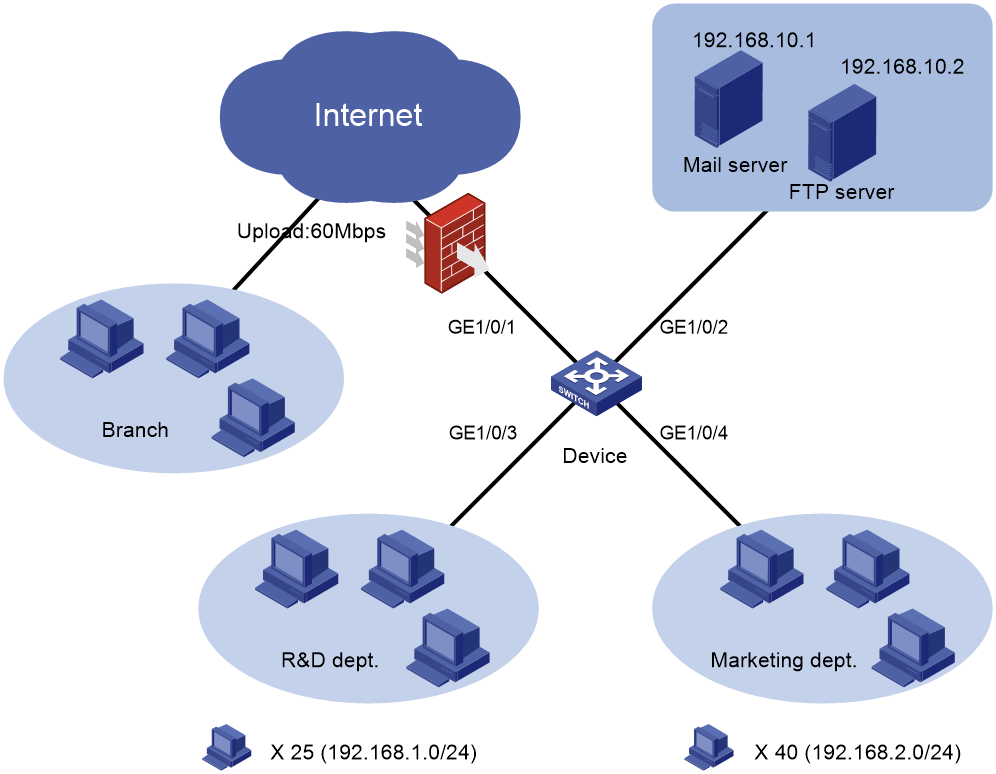

Example: Policing traffic by IP address and protocol type
As shown in Figure 1, a company uses a dedicated line to access the Internet, with an uplink bandwidth of 60 Mbps. All end devices use the firewall as the gateway. The mail server forwards emails for all clients to the external network. The FTP server provides data services for the branch through the Internet.
Configure traffic policing to classify and rate limit the uplink traffic as follows:
·     HTTP trafficRate limit HTTP traffic to a total rate of 40 Mbps (15 Mbps for the 25 hosts in the R&D department and 25 Mbps for the 40 hosts in the Marketing department).
·     Email traffic—Rate limit email traffic to 2 Mbps.
·     FTP traffic—Rate limit FTP traffic to 10 Mbps.
Figure 1 Network diagram
Analysis
To meet the network requirements, you must perform the following tasks:
·     Configure ACLs to classify packets of different types.
·     Associate classes with policing actions to rate limit packets of different types.

Procedures
1.     Police HTTP traffic from the R&D department:
# Create advanced IPv4 ACL 3000 to match HTTP traffic from the R&D department.
<Device> system-view
[Device] acl advanced 3000
[Device-acl-ipv4-adv-3000] rule permit tcp destination-port eq 80 source 192.168.1.0 0.0.0.255
[Device-acl-ipv4-adv-3000] quit
# Create a class named rd_http, and use advanced IPv4 ACL 3000 as the match criterion.
[Device] traffic classifier rd_http
[Device-classifier-rd_http] if-match acl 3000
[Device-classifier-rd_http] quit
# Create a behavior named rd_http, and configure traffic policing with the CIR of 15 Mbps.
[Device] traffic behavior rd_http
[Device-behavior-rd_http] car cir 15360
[Device-behavior-rd_http] quit
# Create a QoS policy named rd_http, and associate the class rd_http with the behavior rd_http in the QoS policy.
[Device] qos policy rd_http
[Device-qospolicy-rd_http] classifier rd_http behavior rd_http
[Device-qospolicy-rd_http] quit
# Apply the QoS policy rd_http to the inbound direction of interface GigabitEthernet 1/0/3.
[Device] interface gigabitethernet 1/0/3
[Device-GigabitEthernet1/0/3] qos apply policy rd_http inbound
[Device-GigabitEthernet1/0/3] quit
2.     Police HTTP traffic from the Marketing department:
# Create advanced IPv4 ACL 3001 to match HTTP traffic from the Marketing department.
[Device] acl advanced 3001
[Device-acl-ipv4-adv-3001] rule permit tcp destination-port eq 80 source 192.168.2.0 0.0.0.255
[Device-acl-ipv4-adv-3001] quit
# Create a class named mkt_http, and use advanced IPv4 ACL 3001 as the match criterion.
[Device] traffic classifier mkt_http
[Device-classifier-mkt_http] if-match acl 3001
[Device-classifier-mkt_http] quit
# Create a behavior named mkt_http, and configure traffic policing with the CIR of 25 Mbps.
[Device] traffic behavior mkt_http
[Device-behavior-mkt_http] car cir 25600
[Device-behavior-mkt_http] quit
# Create a QoS policy named mkt_http, and associate the class mkt_http with the behavior mkt_http in the QoS policy.
[Device] qos policy mkt_http
[Device-qospolicy-mkt_http] classifier mkt_http behavior mkt_http
[Device-qospolicy-mkt_http] quit
# Apply the QoS policy mkt_http to the inbound direction of interface GigabitEthernet 1/0/4.
[Device] interface gigabitethernet 1/0/4
[Device-GigabitEthernet1/0/4] qos apply policy mkt_http inbound
[Device-GigabitEthernet1/0/4] quit
3.     Police email traffic and FTP traffic:
# Create advanced IPv4 ACL 3002 to match email traffic.
[Device] acl advanced 3002
[Device-acl-ipv4-adv-3002] rule permit tcp destination-port eq smtp source 192.168.10.1 0.0.0.0
[Device-acl-ipv4-adv-3002] quit
# Create a class named email, and use advanced IPv4 ACL 3002 as the match criterion.
[Device] traffic classifier email
[Device-classifier-email] if-match acl 3002
[Device-classifier-email] quit
# Create a behavior named email, and configure traffic policing with the CIR of 2 Mbps.
[Device] traffic behavior email
[Device-behavior-email] car cir 2048
[Device-behavior-email] quit
# Create basic IPv4 ACL 2001 to match FTP traffic.
[Device] acl basic 2001
[Device-acl-ipv4-basic-2001] rule permit source 192.168.10.2 0.0.0.0
[Device-acl-ipv4-basic-2001] quit
# Create a class named ftp, and use basic IPv4 ACL 2001 as the match criterion.
[Device] traffic classifier ftp
[Device-classifier-ftp] if-match acl 2001
[Device-classifier-ftp] quit
# Create a behavior named ftp, and configure traffic policing with the CIR of 10 Mbps.
[Device] traffic behavior ftp
[Device-behavior-ftp] car cir 10240
[Device-behavior-ftp] quit
# Create a QoS policy named email&ftp, and associate the classes email and ftp with the behavior email and ftp in the QoS policy, respectively.
[Device] qos policy email&ftp
[Device-qospolicy-email&ftp] classifier email behavior email
[Device-qospolicy-email&ftp] classifier ftp behavior ftp
[Device-qospolicy-email&ftp] quit
# Apply the QoS policy email&ftp to the inbound direction of interface GigabitEthernet 1/0/2.
[Device] interface gigabitethernet 1/0/2
[Device-GigabitEthernet1/0/2] qos apply policy email&ftp inbound
[Device-GigabitEthernet1/0/2] quit
# Verify QoS policies applied to interfaces.
[Device] display qos policy interface
Interface: GigabitEthernet1/0/2
  Direction: Inbound
  Policy: email&ftp
   Classifier: email
     Operator: AND
     Rule(s) :
      If-match acl 3002
     Behavior: email
      Committed Access Rate:
        CIR 2048 (kbps), CBS 128000 (Bytes), EBS 0 (Bytes)
        Green action  : pass
        Yellow action : pass
        Red action    : discard
        Green packets : 0 (Packets)
        Red packets   : 0 (Packets)
   Classifier: ftp
     Operator: AND
     Rule(s) :
      If-match acl 2001
     Behavior: ftp
        CIR 10240 (kbps), CBS 640000 (Bytes), EBS 0 (Bytes)
        Green action  : pass
Interface: GigabitEthernet1/0/3
  Direction: Inbound
  Policy: rd_http
   Classifier: rd_http
     Operator: AND
     Rule(s) :
      If-match acl 3000
     Behavior: rd_http
        CIR 15360 (kbps), CBS 960000 (Bytes), EBS 0 (Bytes)
        Green action  : pass
Interface: GigabitEthernet1/0/4
  Direction: Inbound
  Policy: mkt_http
   Classifier: mkt_http
     Operator: AND
     Rule(s) :
      If-match acl 3001
     Behavior: mkt_http
        CIR 25600 (kbps), CBS 1600000 (Bytes), EBS 0 (Bytes)
        Green action  : pass
Configuration files
traffic classifier email operator and
 if-match acl 3002
traffic classifier ftp operator and
 if-match acl 2001
traffic classifier mkt_http operator and
 if-match acl 3001
traffic classifier rd_http operator and
 if-match acl 3000
 car cir 2048 cbs 128000 ebs 0 green pass red discard yellow pass
 car cir 10240 cbs 640000 ebs 0 green pass red discard yellow pass
 car cir 25600 cbs 1600000 ebs 0 green pass red discard yellow pass
 car cir 15360 cbs 960000 ebs 0 green pass red discard yellow pass
qos policy mkt_http
qos policy rd_http
 port link-mode bridge
interface GigabitEthernet1/0/4
acl basic 2001
 rule 0 permit source 192.168.10.2 0
acl advanced 3000
 rule 0 permit tcp source 192.168.1.0 0.0.0.255 destination-port eq www
acl advanced 3001
 rule 0 permit tcp source 192.168.2.0 0.0.0.255 destination-port eq www
acl advanced 3002
 rule 0 permit tcp source 192.168.10.1 0 destination-port eq smtp

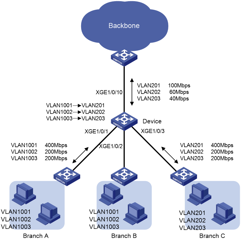

Example: Allocating bandwidth based on VLANs
As shown in Figure 2, the device aggregates traffic from the branches and transmits the traffic to the backbone network through a leased line. Each branch site assigns packets of different applications to different VLANs.
·     Configure one-to-one VLAN mapping on the following interfaces of the device to re-map traffic of different applications to VLANs as per the transmission scheme on the backbone network:
¡     GigabitEthernet 1/0/1.
¡     GigabitEthernet 1/0/2.
·     Configure traffic policing to allocate bandwidth to traffic from different VLANs, as shown in Table 1.
Table 1 Bandwidth allocation
XGE 1/0/1 and XGE 1/0/2 (uplink or downlink)
XGE 1/0/3 (uplink or downlink)
XGE 1/0/10 (uplink or downlink)
VLAN 1001
VLAN 1002
VLAN 1003
VLAN 201
VLAN 202
VLAN 203
VLAN 201
VLAN 202
VLAN 203
400 Mbps
200 Mbps
200 Mbps
400 Mbps
200 Mbps
200 Mbps
100 Mbps
60 Mbps
40 Mbps
Figure 2 Network diagram
Analysis
·     Configure VLAN-based traffic classes.
·     Configure per-VLAN traffic policing behaviors.
·     Associate each class with its specific traffic behavior.

Procedures
Configuring VLAN settings
1.     Configure GigabitEthernet 1/0/1 and GigabitEthernet 1/0/2 as follows:
¡     Configure GigabitEthernet 1/0/1 and GigabitEthernet 1/0/2 as trunk ports.
¡     Assign them to VLANs 1001 through 1003 and VLANs 201 through 203.
¡     Remove them from VLAN 1.
¡     Configure one-to-one VLAN mappings on the two interfaces.
[Device-GigabitEthernet1/0/1] port link-type trunk
[Device-GigabitEthernet1/0/1] port trunk permit vlan 1001 to 1003 201 to 203
[Device-GigabitEthernet1/0/1] undo port trunk permit vlan 1
[Device-GigabitEthernet1/0/1] vlan mapping 1001 translated-vlan 201
[Device-GigabitEthernet1/0/1] vlan mapping 1002 translated-vlan 202
[Device-GigabitEthernet1/0/1] vlan mapping 1003 translated-vlan 203
[Device-GigabitEthernet1/0/2] port link-type trunk
[Device-GigabitEthernet1/0/2] port trunk permit vlan 1001 to 1003 201 to 203
[Device-GigabitEthernet1/0/2] undo port trunk permit vlan 1
[Device-GigabitEthernet1/0/2] vlan mapping 1001 translated-vlan 201
[Device-GigabitEthernet1/0/2] vlan mapping 1002 translated-vlan 202
[Device-GigabitEthernet1/0/2] vlan mapping 1003 translated-vlan 203
2.     Configure GigabitEthernet 1/0/3 and GigabitEthernet 1/0/10 as follows:
¡     Configure GigabitEthernet 1/0/3 and GigabitEthernet 1/0/10 as trunk ports.
¡     Assign them to VLANs 201 through 203.
[Device-GigabitEthernet1/0/3] port link-type trunk
[Device-GigabitEthernet1/0/3] port trunk permit vlan 201 to 203
[Device-GigabitEthernet1/0/3] undo port trunk permit vlan 1
[Device] interface gigabitethernet 1/0/10
[Device-GigabitEthernet1/0/10] port link-type trunk
[Device-GigabitEthernet1/0/10] port trunk permit vlan 201 to 203
[Device-GigabitEthernet1/0/10] undo port trunk permit vlan 1
[Device-GigabitEthernet1/0/10] quit
Configuring traffic policing
1.     Configure traffic policing for the traffic from and to branches:
# Create a class named vlan201, and configure CVLAN 201 as the match criterion.
[Device-classifier-vlan201] if-match customer-vlan-id 201
[Device-classifier-vlan201] quit
# Create a class named vlan202, and configure CVLAN 202 as the match criterion.
[Device] traffic classifier vlan202
[Device-classifier-vlan202] if-match customer-vlan-id 202
[Device-classifier-vlan202] quit
# Create a class named vlan203, and configure CVLAN 203 as the match criterion.
[Device] traffic classifier vlan203
[Device-classifier-vlan203] if-match customer-vlan-id 203
[Device-classifier-vlan203] quit
# Create a behavior named car400, and configure a CIR of 400 Mbps.
[Device] traffic behavior car400
[Device-behavior-car400] car cir 409600
[Device-behavior-car400] quit
 # Create a behavior named car200, and configure a CIR of 200 Mbps.
[Device] traffic behavior car200
[Device-behavior-car200] car cir 204800
[Device-behavior-car200] quit
# Create a QoS policy named ABCupdown, and associate the classes with the behaviors.
[Device] qos policy ABCupdown
[Device-qospolicy-ABCupdown] classifier vlan201 behavior car400
[Device-qospolicy-ABCupdown] classifier vlan202 behavior car200
[Device-qospolicy-ABCupdown] classifier vlan203 behavior car200
[Device-qospolicy-ABCupdown] quit
# Apply the QoS policy to both directions of GigabitEthernet 1/0/1, GigabitEthernet 1/0/2, and GigabitEthernet 1/0/3.
[Device-GigabitEthernet1/0/1] qos apply policy ABCupdown inbound
[Device-GigabitEthernet1/0/1] qos apply policy ABCupdown outbound
[Device-GigabitEthernet1/0/2] qos apply policy ABCupdown inbound
[Device-GigabitEthernet1/0/2] qos apply policy ABCupdown outbound
[Device-GigabitEthernet1/0/3] qos apply policy ABCupdown inbound
[Device-GigabitEthernet1/0/3] qos apply policy ABCupdown outbound
2.     Configure traffic policing for the traffic from and to the backbone network:
# Create a behavior named car100, and configure a CIR of 100 Mbps.
[Device] traffic behavior car100
[Device-behavior-car100] car cir 102400
[Device-behavior-car100] quit
# Create a behavior named car60, and configure a CIR of 60 Mbps.
[Device] traffic behavior car60
[Device-behavior-car60] car cir 61440
[Device-behavior-car60] quit
# Create a behavior named car40, and configure a CIR of 40 Mbps.
[Device-behavior-car40] car cir 40960
[Device-behavior-car40] quit
# Create a QoS policy named BONEupdown, and associate the classes with the behaviors.
[Device] qos policy BONEupdown
[Device-qospolicy-BONEupdown] classifier vlan201 behavior car100
[Device-qospolicy-BONEupdown] classifier vlan202 behavior car60
[Device-qospolicy-BONEupdown] classifier vlan203 behavior car40
[Device-qospolicy-BONEupdown] quit
# Apply the QoS policy to both directions of GigabitEthernet 1/0/10.
[Device-GigabitEthernet1/0/10] qos apply policy BONEupdown inbound
[Device-GigabitEthernet1/0/10] qos apply policy BONEupdown outbound

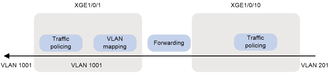

Figure 3 shows how the switches process the uplink traffic from a branch to the backbone network. The figure uses VLAN 1001 as an example.
Figure 3 Uplink traffic processing
Figure 4 shows how the switches process the downlink traffic from the backbone network to a branch. The figure uses VLAN 201 as an example.
Figure 4 Downlink traffic processing
Verify the configuration on any interface, for example, GigabitEthernet 1/0/10.
# Verify QoS policies applied to interface GigabitEthernet 1/0/10.
[Device] display qos policy interface gigabitethernet 1/0/10
Interface: GigabitEthernet1/0/10
  Direction: Inbound
  Policy: BONEupdown
   Classifier: vlan201
     Operator: AND
     Rule(s) :
      If-match customer-vlan-id 201
     Behavior: car100
        CIR 102400 (kbps), CBS 6400000 (Bytes), EBS 0 (Bytes)
        Green action  : pass
   Classifier: vlan202
     Operator: AND
     Rule(s) :
      If-match customer-vlan-id 202
     Behavior: car60
        CIR 61440 (kbps), CBS 3840000 (Bytes), EBS 0 (Bytes)
        Green action  : pass
   Classifier: vlan203
     Operator: AND
     Rule(s) :
      If-match customer-vlan-id 203
     Behavior: car40
        CIR 40960 (kbps), CBS 2560000 (Bytes), EBS 0 (Bytes)
        Green action  : pass
  Direction: Outbound
  Policy: BONEupdown
   Classifier: vlan201
     Operator: AND
     Rule(s) :
     Behavior: car100
        Green action  : pass
   Classifier: vlan202
     Operator: AND
     Rule(s) :
     Behavior: car60
        Green action  : pass
   Classifier: vlan203
     Operator: AND
     Rule(s) :
     Behavior: car40
        Green action  : pass
 car cir 102400 cbs 6400000 ebs 0 green pass red discard yellow pass
 car cir 204800 cbs 12800000 ebs 0 green pass red discard yellow pass
 car cir 409600 cbs 25600000 ebs 0 green pass red discard yellow pass
interface GigabitEthernet1/0/10
 port trunk permit vlan 201 to 203 1001 to 1003

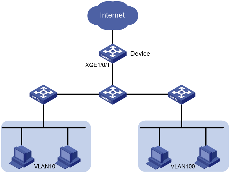

Example: Configuring aggregate CAR
As shown in Figure 5, the access layer devices add VLAN tags to the traffic from VLAN 10 and VLAN 100 before sending the traffic to the device.
Configure aggregate CAR on GigabitEthernet 1/0/1 to meet the following requirements:
·     Limit the incoming traffic from VLAN 10 and VLAN 100 to 200 Mbps.
·     Drop the excess traffic.
Figure 5 Network diagram

# Configure interface GigabitEthernet 1/0/1 as a trunk port.
# Assign the interface to VLANs 10 and 100.
[Device-GigabitEthernet1/0/1] port trunk permit vlan 10 100
# Remove the interface from VLAN 1.
# Create an aggregate CAR action.
[Device] qos car aggcar-1 aggregative cir 204800
# Create class 1, and use SVLAN ID 10 as the match criterion.
[Device] traffic classifier 1
[Device-classifier-1] if-match service-vlan-id 10
[Device-classifier-1] quit
# Create behavior 1, and reference the aggregate CAR action in the behavior.
[Device] traffic behavior 1
[Device-behavior-1] car name aggcar-1
[Device-behavior-1] quit
# Create class 2, and use SVLAN ID 100 as the match criterion.
[Device] traffic classifier 2
[Device-classifier-2] if-match service-vlan-id 100
[Device-classifier-2] quit
# Create behavior 2, and reference the aggregate CAR action in the behavior.
[Device] traffic behavior 2
[Device-behavior-2] car name aggcar-1
[Device-behavior-2] quit
# Create a QoS policy named car, and associate the classes with the behaviors in the QoS policy.
[Device] qos policy car
[Device-qospolicy-car] classifier 1 behavior 1
[Device-qospolicy-car] classifier 2 behavior 2
[Device-qospolicy-car] quit
# Apply the QoS policy car to the inbound direction of GigabitEthernet 1/0/1.
[Device-GigabitEthernet1/0/1] qos apply policy car inbound
Verify the configuration on any interface, for example, GigabitEthernet 1/0/1.
# Verify QoS policies applied to interface GigabitEthernet 1/0/1.
  Direction: Inbound
  Policy: car
   Classifier: 1
     Operator: AND
     Rule(s) :
      If-match service-vlan-id 10
     Behavior: 1
        Car name: aggcar-1
   Classifier: 2
     Operator: AND
     Rule(s) :
      If-match service-vlan-id 100
     Behavior: 2
        Car name: aggcar-1
Configuration files
 qos car aggcar-1 aggregative cir 204800 cbs 12800000 ebs 0 green pass yellow pass red discard
traffic classifier 1 operator and
traffic classifier 2 operator and
traffic behavior 1
 car name aggcar-1
traffic behavior 2
 car name aggcar-1
qos policy car
