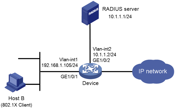

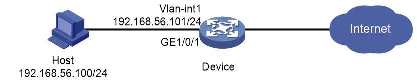

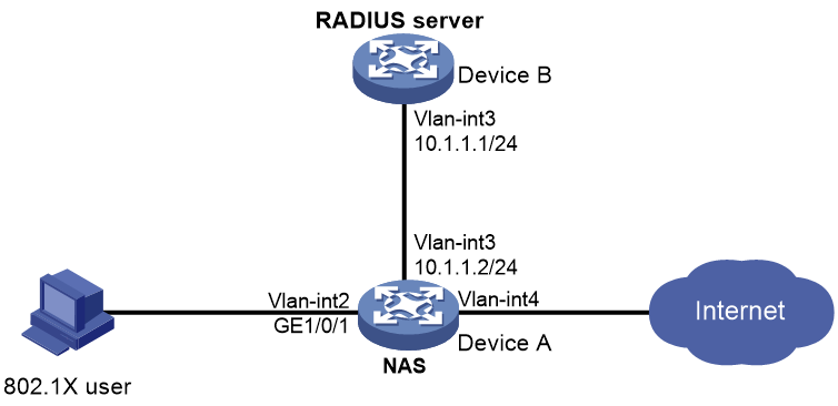

As shown in Figure 1, the device performs local 802.1X authentication on GigabitEthernet 1/0/1 to control Internet access of users. The interface performs port-based access control for 802.1X authentication.
Figure 1 Network diagram
Analysis
For the device to authenticate the 802.1X user on the host, add the 802.1X username and password to the device.

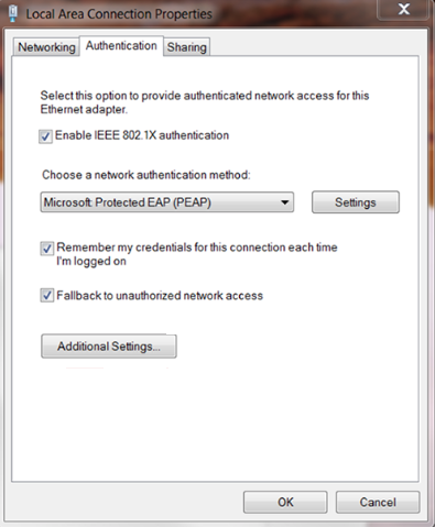

If the host runs the Windows XP built-in 802.1X client, configure the network connection properties as follows:
1.     Click the Authentication tab of the properties window.
2.     Select the Enable IEEE 802.1X authentication for this network option.
3.     Select MD5 challenge as the EAP type.
4.     Click OK.

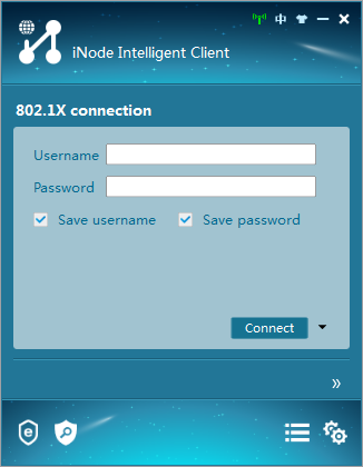

1.     Run the iNode client.
Figure 2 iNode client

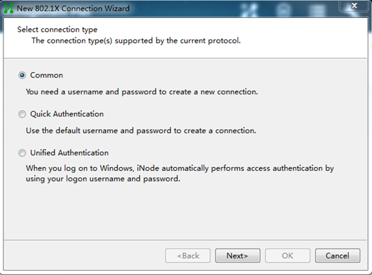

2.     Create a new 802.1X connection.
3.     On the New 802.1X Connection Wizard window, select Common, and then click Next.
Figure 3 Creating an 802.1X connection

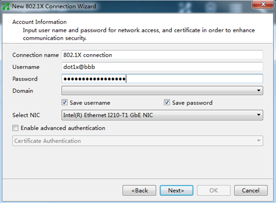

4.     Enter the 802.1X connection name, username, and password, and then click Next.
Figure 4 Configuring the 802.1X connection name, username, and password

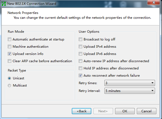

5.     Configure the network property settings, and then click OK.
Do not select Upload version info in the Run Mode area. The device cannot recognize the version number in EAP packets.
Figure 5 Configuring 802.1X connection properties

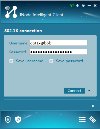

6.     Initiate the 802.1X connection.
Enter the username and password on the iNode client, and then click Connect.
Figure 6 Initiating the 802.1X connection

Example: Configuring RADIUS-based 802.1X authentication (an H3C device acts as the RADIUS server)
As shown in Figure 7, Device B acts as the RADIUS server to provide authentication and authorization services for the 802.1X user connected to Device A (the NAS).
After the user passes authentication, the RADIUS server assigns VLAN 4 to GigabitEthernet 1/0/1 (the NAS port that the user is connecting to).
Figure 7 Network diagram
Analysis
·     For the RADIUS server to authenticate the 802.1X user, perform the following tasks on the RADIUS server:
a.     Add the device to the RADIUS server as a RADIUS client.
b.     Add the 802.1X username and password to the RADIUS server.
·     For the user to access resources in VLAN 4 after it passes authentication, specify VLAN 4 as the authorization VLAN for the user on the RADIUS server.
·     To ensure secure transmission between the RADIUS server and device and avoid RADIUS packets from being tampered with, configure the same shared key on the RADIUS server and device.
·     To use the RADIUS server for authentication and authorization, perform the following tasks on the device:
c.     Create a RADIUS scheme.
d.     Specify the RADIUS server as the authentication and authorization server in the RADIUS scheme.
e.     Apply the RADIUS scheme to the ISP domain of the 802.1X user.
4.     Click OK.
Figure 8 iNode client

4.     Configure the connection name, username, and password, and then click Next.
Figure 10 Configuring the connection name, username, and password
For authentication to be performed correctly, the following details must comply with the correlation rules shown in Table 1:
¡     Username specified on the iNode client.
¡     Domain and username format configuration on the access device.
¡     Service suffix on IMC.
If you set local authentication as the backup authentication method, do not select Upload version info in the Run Mode area. The access device cannot recognize the version number in EAP packets.
Figure 11 Configuring 802.1X connection properties
Figure 12 Initiating the 802.1X connection

Example: Configuring 802.1X unicast trigger
As shown in Figure 13:
·     The device uses the RADIUS server for 802.1X user authentication and authorization.
·     IMC acts as the RADIUS server.
·     The user on Host B uses the Windows XP built-in 802.1X client to interact with the device for 802.1X authentication.
Figure 13 Network diagram
Analysis

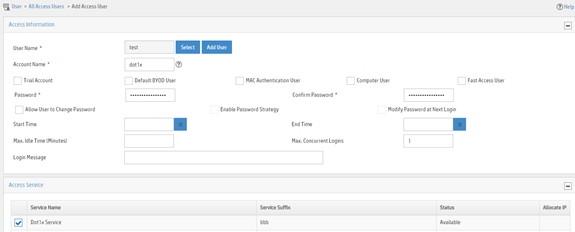

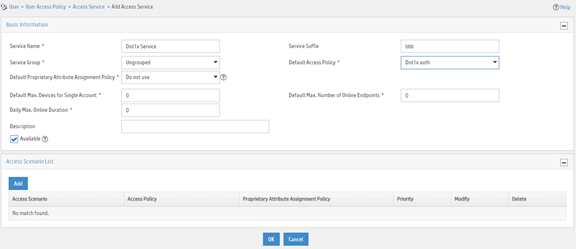

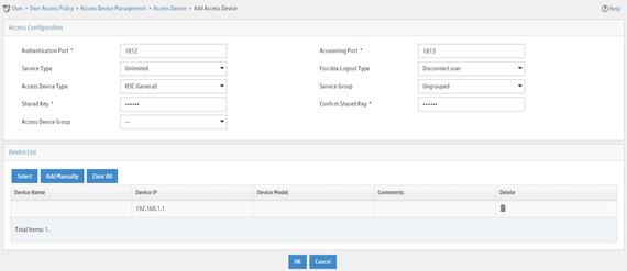

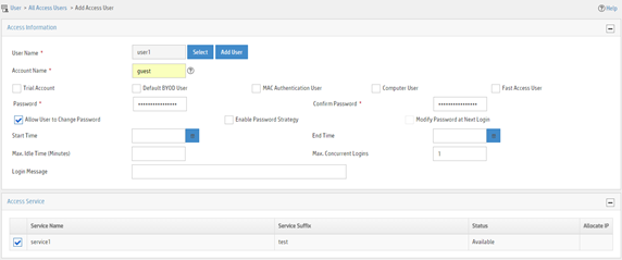

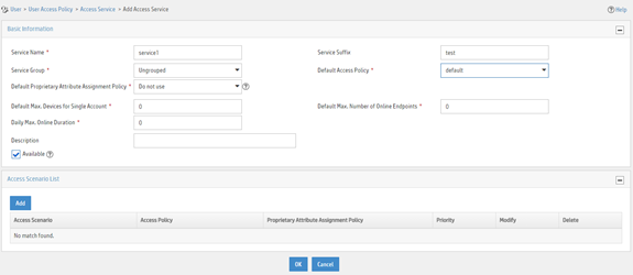

·     For the device to use the RADIUS server for user authentication, perform the following tasks on the RADIUS server:
a.     Add the device as an access device to the RADIUS server.
b.     Add an access policy.
c.     Add an access service and specify the access policy in the access service.
d.     Add an access user and specify the access service for the access user.
·     For the device to perform RADIUS-based authentication and authorization for the 802.1X user, configure AAA settings on the device, including ISP domain settings and RADIUS scheme settings.
·     Because the Windows XP built-in 802.1X client cannot initiate 802.1X connection, you must enable an authentication trigger feature on the device. As a best practice to ensure system performance, disable 802.1X multicast trigger and enable unicast trigger. In multicast trigger mode, the device multicasts a large number of Identity EAP-Request packets periodically to the host, which consumes bandwidth and system resources.

As a best practice to avoid duplicate authentication packets, disable multicast trigger on an interface if unicast trigger is enabled on that interface.
Configure IP addresses for interfaces, as shown in Figure 13. Make sure the host, device, and server are reachable.

Configuring the RADIUS server
This example uses IMC PLAT 7.3 (E0506), IMC EIA 7.3 (E0503), and IMC EIP 7.3 (E0503) to describe the procedure.
Adding the device to the IMC Platform as an access device
1.     Log in to IMC.
2.     Click the User tab.
3.     From the navigation pane, select User Access Policy > Access Device Management > Access Device.
4.     Click Add.
5.     On the page that opens, configure access device parameters.
a.     Set the ports for authentication and accounting to 1812 and 1813, respectively.
b.     Set the shared key to expert for secure authentication and accounting communication, and confirm the shared key.
c.     Select H3C (General) from the Access Device Type list.
d.     Select an access device from the device list or manually add an access device. In this example, the device IP address is 10.1.1.2.
e.     Use the default values for other parameters.
f.     Click OK.
The IP address of the access device specified on the RADIUS server must be the same as the source IP address of the RADIUS packets sent from the device. On the device, the source IP address is chosen in the following order:
a.     IP address specified by using the nas-ip command.
b.     IP address specified by using the radius nas-ip command.
c.     IP address of the outbound interface (the default).
In this example, the device uses the IP address of the outbound interface as the source IP address of RADIUS packets.
Figure 14 Adding an access device

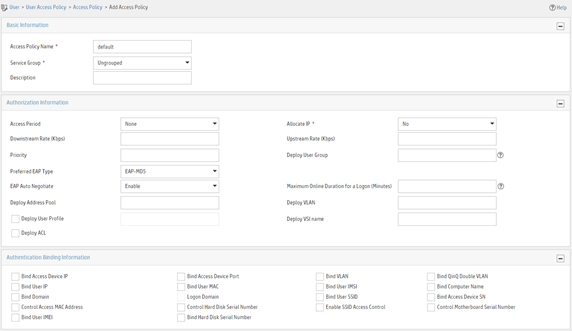

Adding an access policy
1.     Click the User tab.
2.     From the navigation pane, select User Access Policy > Access Policy.
3.     Click Add.
4.     On the page that opens, configure access policy parameters.
a.     Enter access policy name default.
b.     Use the default values for other parameters.
c.     Click OK.
Figure 15 Adding an access policy
Adding an access service
2.     From the navigation pane, select User Access Policy > Access Service.
3.     Click Add.
4.     On the page that opens, configure access service parameters.
a.     Enter service name service1 and set the service suffix to test. The service suffix is the authentication domain for the 802.1X user.
IMPORTANT
IMPORTANT:
With the service suffix configured, you must configure the device to send usernames that include the domain name to the RADIUS server. By default, the device includes the domain name in the usernames sent to a RADIUS server.
b.     Select default from the Default Access Policy list.
c.     Use the default values for other parameters.
d.     Click OK.
Figure 16 Adding an access service
Adding an access user
2.     From the navigation pane, select Access User > Access User.
3.     Click Add.
4.     On the page that opens, configure access user parameters.
a.     Click Add User to add a user named user1.
b.     Enter account name guest and password 123456TESTplat&!. The device uses the account name to identify the user when the user accesses the network.
c.     Select service1 in the Access Service area.
d.     Use the default values for other parameters.
e.     Click OK.
Figure 17 Adding an access user

Configuring the 802.1X client
This example uses the Windows XP built-in 802.1X client to describe the procedure. The configuration is as shown in Figure 18.
Figure 18 Configuring the Windows XP built-in 802.1X client
Verify that you can use the user account to pass 802.1X authentication:
# Use the host to visit an Internet webpage. The Windows status bar displays a message and asks you to enter your username and password.
# Enter username guest@test and password 123456TESTplat&!.

Example: Configuring 802.1X with guest VLAN and authorization VLAN assignment
As shown in Figure 19:
·     Use a RADIUS server to perform authentication, authorization, and accounting for 802.1X users that connect to GigabitEthernet 1/0/2. Implement port-based access control on the port.
·     Configure VLAN 10 as the 802.1X guest VLAN on GigabitEthernet 1/0/2. The host and the update server are both in VLAN 10, and the host can access the update server and download the 802.1X client software.
·     To prevent users in the guest VLAN from accessing the Internet, apply a QoS policy to the outbound direction of VLAN 10 to filter packets destined for the Internet (5.1.1.1).
·     After the host passes 802.1X authentication, the access device assigns the host to the same VLAN (VLAN 5) as the interface (GigabitEthernet 1/0/3) for Internet access.
Figure 19 Network diagram
Analysis
·     For the 802.1X user on the host to access the update server before it passes authentication, configure VLAN 10 as the guest VLAN on the port connected to the host.
·     For the 802.1X user on the host to access the Internet after it passes authentication, specify VLAN 5 (the VLAN connected to the Internet) as the user's authorization VLAN. After the user passes 802.1X authentication, the port connected to the host is assigned to VLAN 5.

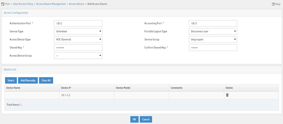

1.     Log in to IMC.
4.     Click Add.
b.     Select H3C (General) from the Access Device Type list.
c.     Set the shared key to expert for secure authentication and accounting communication.
d.     Select an access device from the device list or manually add an access device. In this example, the IP address of the access device is 10.1.1.2.
f.     Click OK.
Figure 20 Adding an access device

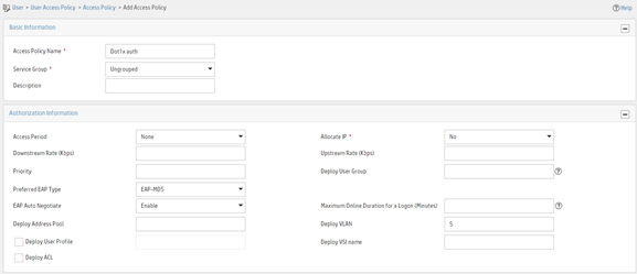

3.     Click Add.
a.     Enter access policy name Dot1x auth.
b.     Enter 5 in the Deploy VLAN field.
c.     Configure other parameters as needed.
d.     Click OK.
Figure 21 Adding an access policy

Example: Configuring 802.1X with ACL assignment
As shown in Figure 24, the user on the host that connects to GigabitEthernet 1/0/1 must pass 802.1X authentication to access the Internet.
Perform 802.1X authentication on GigabitEthernet 1/0/1. Use the RADIUS server at 10.1.1.1 as the authentication and authorization server, and the RADIUS server at 10.1.1.2 as the accounting server.
Configure ACL assignment on GigabitEthernet 1/0/1 to deny access of 802.1X users to the FTP server from 8:00 to 18:00 on weekdays.
Figure 24 Network diagram
Analysis
·     To assign an ACL to the user after the user passes authentication and use the ACL to restrict the user's access behaviors, perform the following tasks:
¡     Specify the ACL in the user account on the RADIUS server.
¡     Create the ACL and configure its rules on the device.
1.     Log in to IMC.
4.     Click Add.
d.     Select an access device from the device list or manually add an access device. In this example, the device IP address is 192.168.1.1.
e.     Use the default values for other parameters and click OK.
Figure 25 Adding an access device
3.     Click Add.
b.     In the Authorization Information area, select Deploy ACL and manually enter ACL number 3000.
d.     Click OK.
Figure 26 Adding an access policy
3.     Click Add.
a.     Enter service name Dot1x Service and set the service suffix to bbb. The service suffix is the authentication domain for the 802.1X user.
IMPORTANT
IMPORTANT:
b.     Select Dot1x auth from the Default Access Policy list.
d.     Click OK.
Figure 27 Adding an access service
3.     Click Add.
4.     On the page that opens, configure user parameters.
a.     Select the user or add a user named test.
b.     Enter account name dot1x and password 123456TESTplat&!.
c.     Select Dot1x Service in the Access Service area.
d.     Configure other parameters as needed.
e.     Click OK.
Figure 28 Adding an access user

IMPORTANT:
With the service suffix configured on IMC, you must configure the device to send usernames that include the domain name to the RADIUS server. By default, the device includes the domain name in the usernames sent to a RADIUS server.

# Configure the 802.1X client. Make sure the client is able to update its IP address after the access port is assigned to the 802.1X guest VLAN or an authorization VLAN. (Details not shown.)
# Use the user account to pass authentication. (Details not shown.)
