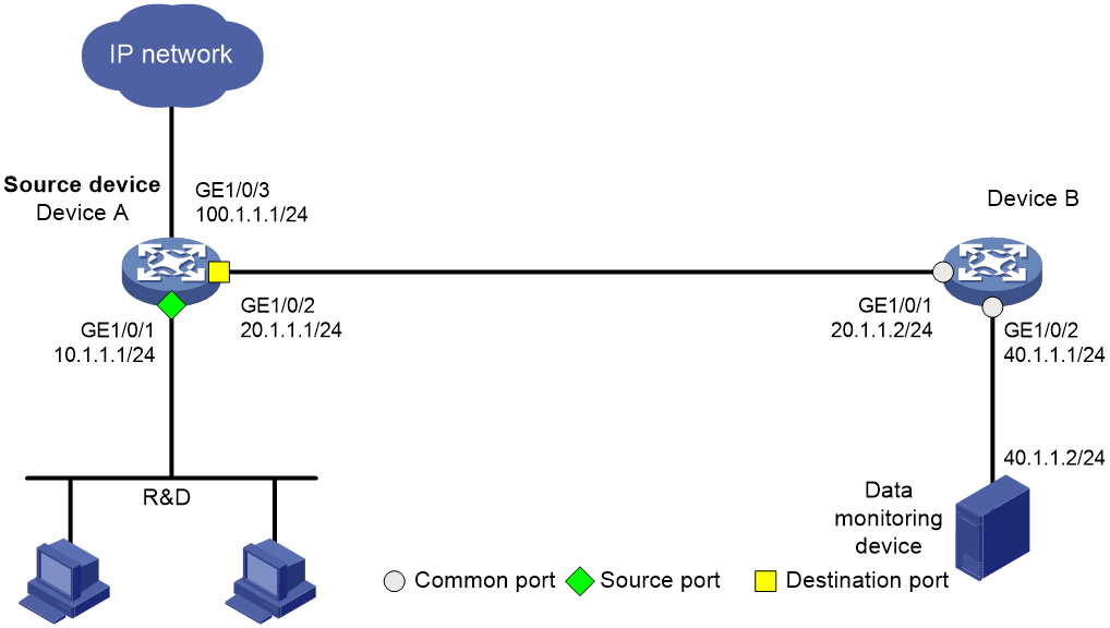

Example: Configuring local port mirroring

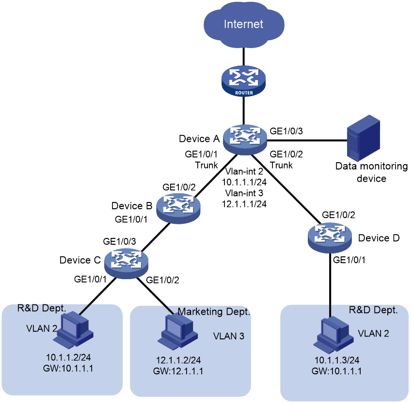

As shown in Figure 1, configure local port mirroring to monitor the Internet traffic and bidirectional traffic of the Marketing department and the Technical department.
Figure 1 Network diagram

# Create VLAN 2, VLAN 3, and VLAN 5.
<DeviceA> system-view
[DeviceA] vlan 2 3 5
# Create VLAN-interface 2 and VLAN-interface 3, and assign IP addresses to them separately, which will act as the gateways for VLAN 2 and VLAN 3 separately.
[DeviceA] interface vlan-interface 2
[DeviceA-Vlan-interface2] ip address 10.1.1.1 24
[DeviceA-Vlan-interface2] quit
[DeviceA] interface vlan-interface 3
[DeviceA-Vlan-interface3] ip address 12.1.1.1 24
[DeviceA-Vlan-interface3] quit
# Create VLAN-interface 5, and assign IP address 56.56.56.5 to the interface.
[DeviceA] interface vlan-interface 5
[DeviceA-Vlan-interface5] ip address 56.56.56.5 24
[DeviceA-Vlan-interface5] quit
# Assign GigabitEthernet 1/0/1 to VLAN 2, GigabitEthernet 1/0/2 to VLAN 3, and GigabitEthernet 1/0/4 to VLAN 5.
[DeviceA-GigabitEthernet1/0/1] port access vlan 2
[DeviceA-GigabitEthernet1/0/1] quit
[DeviceA] interface gigabitethernet 1/0/2
[DeviceA-GigabitEthernet1/0/2] port access vlan 3
[DeviceA-GigabitEthernet1/0/2] quit
[DeviceA] interface gigabitethernet 1/0/4
[DeviceA-GigabitEthernet1/0/4] port access vlan 5
[DeviceA-GigabitEthernet1/0/4] quit
# Configure GigabitEthernet 1/0/3 as a trunk port, and assign it to VLAN 2 and VLAN 3.
[DeviceA] interface gigabitethernet 1/0/3
[DeviceA-GigabitEthernet1/0/3] port link-type trunk
[DeviceA-GigabitEthernet1/0/3] port trunk permit vlan 2 3
[DeviceA-GigabitEthernet1/0/3] quit
# Configure GigabitEthernet 1/0/1 and GigabitEthernet 1/0/2 as the source ports of the mirroring group.
[DeviceA] mirroring-group 1 mirroring-port gigabitethernet 1/0/1 gigabitethernet 1/0/2 inbound
# Configure GigabitEthernet 1/0/3 as the monitor port of the mirroring group.
[DeviceA] mirroring-group 1 monitor-port gigabitethernet 1/0/3
# Disable the spanning tree feature on GigabitEthernet 1/0/3.
[DeviceA-GigabitEthernet1/0/3] undo stp enable
1.     Display information about mirroring group 1 on Device A.
[DeviceA] display mirroring-group 1
Mirroring group 1:
    Type: Local
    Status: Active
    Mirroring port:
        GigabitEthernet1/0/1  Inbound
        GigabitEthernet1/0/2  Inbound
    Monitor port: GigabitEthernet1/0/3

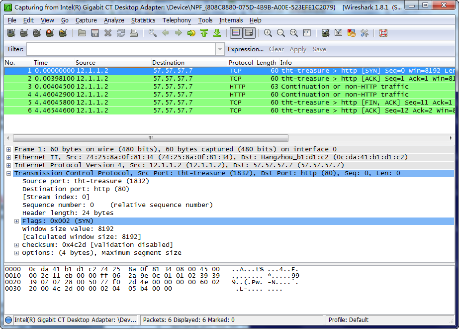

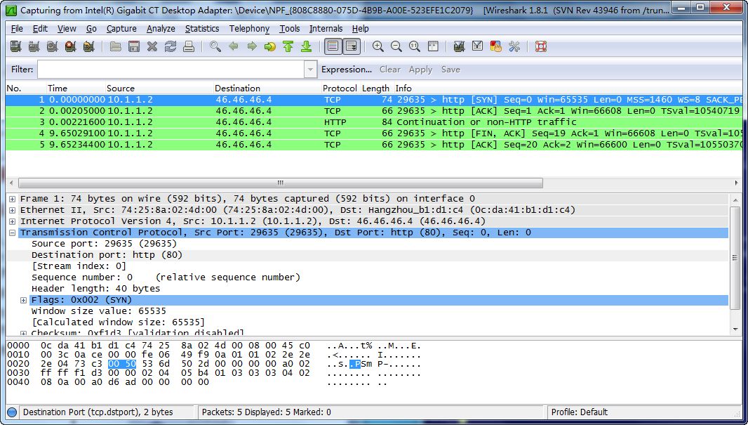

2.     Use Wireshark for packet analysis:
# Ping 56.56.56.6 from a Technical department host (10.1.1.2). (Details not shown.)
# Use Wireshark on the data monitoring device to capture the ping packets.
Figure 2 Ping packet analysis in Wireshark
The analysis shows that the data monitoring device can monitor the packets sent from the Technical department.

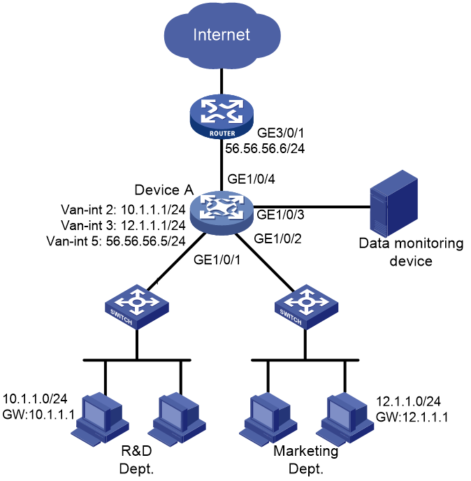

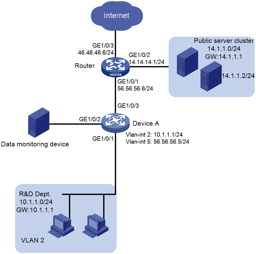

As shown in Figure 3, configure Layer 2 remote port mirroring to monitor the outgoing traffic from the Technical department.
Figure 3 Network diagram
Analysis
To ensure correct forwarding of mirrored packets, assign the ports that connect intermediate devices to the source and destination devices to the remote probe VLAN.

Procedures
Configuring Device A (the destination device)
# Create VLANs 2 and 3.
[DeviceA] vlan 2 to 3
# Create VLAN-interface 2 and assign an IP address to it.
# Create VLAN-interface 3 and assign an IP address to it.
# Configure GigabitEthernet 1/0/1 as a trunk port, and assign the port to VLANs 2, 3, and 5.
[DeviceA-GigabitEthernet1/0/1] port link-type trunk
[DeviceA-GigabitEthernet1/0/1] port trunk permit vlan 2 3 5
# Configure GigabitEthernet 1/0/2 as a trunk port, and assign the port to VLANs 2 and 5.
[DeviceA-GigabitEthernet1/0/2] port link-type trunk
[DeviceA-GigabitEthernet1/0/2] port trunk permit vlan 2 5
# Create a remote destination group.
[DeviceA] mirroring-group 1 remote-destination
# Create VLAN 5.
[DeviceA] vlan 5
[DeviceA-vlan5] quit
# Configure VLAN 5 as the remote probe VLAN of the remote destination group.
[DeviceA] mirroring-group 1 remote-probe vlan 5
# Configure GigabitEthernet 1/0/3 as the monitor port of the remote destination group.
# Configure GigabitEthernet 1/0/3 as an access port, and assign the port to the remote probe VLAN.
[DeviceA-GigabitEthernet1/0/3] port access vlan 5
Configuring Device B (the intermediate device)
<DeviceB> system-view
[DeviceB] vlan 2 to 3
# Create VLAN 5.
[DeviceB] vlan 5
[DeviceB-vlan5] quit
[DeviceB-GigabitEthernet1/0/1] port link-type trunk
[DeviceB-GigabitEthernet1/0/1] port trunk permit vlan 2 3 5
[DeviceB-GigabitEthernet1/0/1] quit
# Configure GigabitEthernet 1/0/2 as a trunk port, and assign the port to VLANs 2, 3, and 5.
[DeviceB] interface gigabitethernet 1/0/2
[DeviceB-GigabitEthernet1/0/2] port link-type trunk
[DeviceB-GigabitEthernet1/0/2] port trunk permit vlan 2 3 5
[DeviceB-GigabitEthernet1/0/2] quit
Configuring Device C (the source device)
<DeviceC> system-view
[DeviceC] vlan 2 to 3
# Assign GigabitEthernet 1/0/1 to VLAN 2.
[DeviceC] interface gigabitethernet 1/0/1
[DeviceC-GigabitEthernet1/0/1] port access vlan 2
[DeviceC-GigabitEthernet1/0/1] quit
# Assign GigabitEthernet 1/0/2 to VLAN 3.
[DeviceC] interface gigabitethernet 1/0/2
[DeviceC-GigabitEthernet1/0/2] port access vlan 3
[DeviceC-GigabitEthernet1/0/2] quit
# Create a remote source group.
[DeviceC] mirroring-group 1 remote-source
# Create VLAN 5.
[DeviceC] vlan 5
[DeviceC-vlan5] quit
# Configure VLAN 5 as the remote probe VLAN for the remote source group.
[DeviceC] mirroring-group 1 remote-probe vlan 5
# Configure GigabitEthernet 1/0/1 as the source port of the remote source group and the mirroring direction as inbound.
[DeviceC] mirroring-group 1 mirroring-port gigabitethernet 1/0/1 inbound
# Configure GigabitEthernet 1/0/3 as the egress port of the remote source group.
[DeviceC] mirroring-group 1 monitor-egress gigabitethernet 1/0/3
# Configure GigabitEthernet 1/0/3 as a trunk port, and assign the port to VLANs 2, 3, and 5.
[DeviceC] interface gigabitethernet 1/0/3
[DeviceC-GigabitEthernet1/0/3] port link-type trunk
[DeviceC-GigabitEthernet1/0/3] port trunk permit vlan 2 3 5
[DeviceC-GigabitEthernet1/0/3] quit
# Disable the spanning tree feature and MAC address learning on the egress port GigabitEthernet 1/0/3.
[DeviceC-GigabitEthernet1/0/3] undo stp enable
[DeviceC-GigabitEthernet1/0/3] undo mac-address mac-learning enable
Configuring Device D (the source device)
# Create VLAN 2.
<DeviceD> system-view
[DeviceD] vlan 2
[DeviceD-vlan2] quit
[DeviceD] interface gigabitethernet 1/0/1
[DeviceD-GigabitEthernet1/0/1] port access vlan 2
[DeviceD-GigabitEthernet1/0/1] quit
# # Create remote source group 1.
[DeviceD] mirroring-group 1 remote-source
# Create VLAN 5.
[DeviceD] vlan 5
[DeviceD-vlan5] quit
[DeviceD] mirroring-group 1 remote-probe vlan 5
[DeviceD] mirroring-group 1 mirroring-port gigabitethernet 1/0/1 inbound
# Configure GigabitEthernet 1/0/2 as the egress port of the remote source group.
[DeviceD] mirroring-group 1 monitor-egress gigabitethernet 1/0/2
[DeviceD] interface gigabitethernet 1/0/2
[DeviceD-GigabitEthernet1/0/2] port link-type trunk
[DeviceD-GigabitEthernet1/0/2] port trunk permit vlan 2 5
# Disable the spanning tree feature and MAC address learning on the egress port GigabitEthernet 1/0/2.
[DeviceD-GigabitEthernet1/0/2] undo stp enable
[DeviceD-GigabitEthernet1/0/2] undo mac-address mac-learning enable
[DeviceD-GigabitEthernet1/0/2] quit
1.     Verify mirroring group configurations on devices:

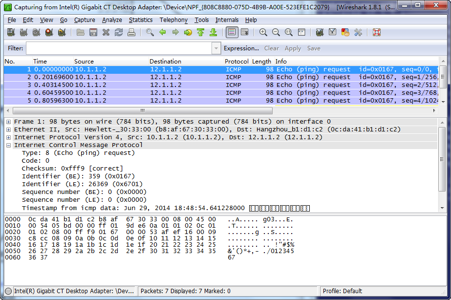

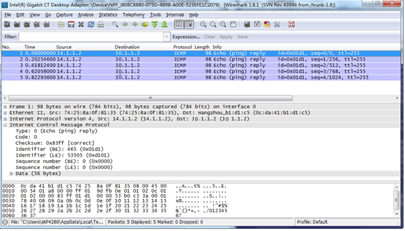

# Ping a Marketing department host (12.1.1.2) from a Technical department host (10.1.1.2). (Details not shown.)
Figure 4 Ping packet analysis in Wireshark
The analysis shows that the data monitoring device can monitor the outgoing traffic from the Technical department.

Example: Configuring Layer 3 remote port mirroring (ERSPAN)
As shown in Figure 5, configure Layer 3 remote port mirroring, so that the data monitoring device can monitor the traffic from the R&D department to Internet.
Figure 5 Network diagram
Analysis
When configuring Layer 3 remote port mirroring, first create a mirroring group, and then configure the source ports and monitor port for the mirroring group. Configure encapsulation parameters of mirrored packets when configuring the monitor port of the mirroring group.

Procedures
# Assign IP address 20.1.1.1 to interface GigabitEthernet 1/0/2.

# Create local mirroring group 1.
[DeviceA] mirroring-group 1 local
# Configure a source port for local mirroring group 1.
[DeviceA] mirroring-group 1 mirroring-port gigabitethernet 1/0/1 inbound
# Configure the monitor port and encapsulation parameters of mirrored packets for local mirroring group 1.
[DeviceA] mirroring-group 1 monitor-port gigabitethernet 1/0/2 destination-ip 40.1.1.2 source-ip 20.1.1.1
# Configure OSPF.
[DeviceB] ospf 1
[DeviceB-ospf-1] area 0
[DeviceB-ospf-1-area-0.0.0.0] network 20.1.1.0 0.0.0.255
[DeviceB-ospf-1-area-0.0.0.0] network 40.1.1.0 0.0.0.255
[DeviceB-ospf-1-area-0.0.0.0] quit
[DeviceB-ospf-1] quit
# Display information about mirroring group 1 on Device A.
Mirroring group 1:
    Type: Local
    Status: Active
    Mirroring port:
    Monitor port: GigabitEthernet1/0/2
                  Encapsulation: Destination IP address 40.1.1.2
                                 Source IP address 20.1.1.1
                                 Destination MAC address 1025-4125-412b

Example: Configuring local flow mirroring
As shown in Figure 6, configure local flow mirroring to mirror the following traffic:
·     HTTP traffic from the Technical department.
·     Packets that the Technical department hosts receive from the public server cluster during non-working hours from 18:00 to 08:30 (the next day) on working days.
Figure 6 Network diagram
Analysis
To configure local flow mirroring, you must perform the following tasks on Device A:
·     Define traffic classes and configure match criteria to classify packets to be mirrored.
·     Configure traffic behaviors to mirror the matching packets to the port that connects to the data monitoring device.
# Use a Technical department host (10.1.1.2) to access the IP address 46.46.46.4 and port 80 through Telnet. (Details not shown.)
# Use Wireshark on the data monitoring device to capture the packets.
Figure 7 HTTP traffic analysis in Wireshark
The analysis shows that the data monitoring device can monitor the HTTP traffic from the Technical department.

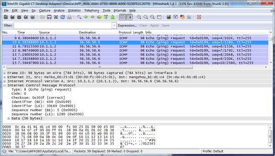

# On a non-working hour of a working day, ping a public server (14.1.1.2) from a Technical department host (10.1.1.2). (Details not shown.)
Figure 8 Ping packet analysis in Wireshark
The analysis shows that the data monitoring device can monitor the traffic that the public server cluster send to the Technical department during non-working hours on working days.
1.     Assign IP addresses to interfaces.
The following example assigns IP address 20.1.1.1 to GigabitEthernet 1/0/2.
[DeviceA-GigabitEthernet1/0/2] port link-mode route
[DeviceA-GigabitEthernet1/0/2] ip address 20.1.1.1 24
2.     Configure the QoS policy policy_research:
# Create ACL 3000, and configure a rule to match packets from the R&D department to access the Internet.
[DeviceA] acl number 3000
[DeviceA-acl-adv-3000] rule permit tcp destination 100.1.1.0 0.0.0.255 destination-port eq 80 source 10.1.1.0 0.0.0.255
[DeviceA-acl-adv-3000] quit
# Create the traffic class classifier_research, and configure the match criterion as ACL 3000.
[DeviceA] traffic classifier classifier_research
[DeviceA-classifier-classifier_research] if-match acl 3000
[DeviceA-classifier-classifier_research] quit
# Create the traffic behavior behavior_research, configure the action of mirroring traffic to GigabitEthernet 1/0/2 and encapsulate the packets with source IP address 20.1.1.1 and destination IP address 40.1.1.2.
[DeviceA] traffic behavior behavior_research
[DeviceA-behavior-behavior_research] mirror-to interface gigabitethernet 1/0/2 destination-ip 40.1.1.2 source-ip 20.1.1.1
[DeviceA-behavior-behavior_research] quit
# Create the QoS policy policy_research.
[DeviceA] qos policy policy_research
# Associate the traffic class classifier_research with the traffic behavior behavior_research in the QoS policy.
[DeviceA-qospolicy-policy_research] classifier classifier_research behavior behavior_research
[DeviceA-qospolicy-policy_research] quit
# Apply the QoS policy to the inbound direction of GigabitEthernet 1/0/1.
[DeviceA] interface GigabitEthernet 1/0/1
[DeviceA-GigabitEthernet1/0/1] qos apply policy policy_research inbound
# Assign IP addresses to interfaces. The following example assigns IP address 20.1.1.2 to GigabitEthernet 1/0/1.
[DeviceB-GigabitEthernet1/0/1] port link-mode route
[DeviceB-GigabitEthernet1/0/1] ip address 20.1.1.2
# Configure the OSPF protocol.
[DeviceB] ospf 1
# Display remote flow mirroring configuration on Device A.
[DeviceA] display qos policy interface
Interface: GigabitEthernet1/0/1
  Direction: Inbound
  Policy: policy_research
   Classifier: classifier_research
     Operator: AND
     Rule(s) :
      If-match acl 3000
     Behavior: behavior_research
      Mirroring:
        Mirror to the interface: GigabitEthernet1/0/2
                                 Destination-MAC 1025-4125-412b
Configuration files
·     Device A:
traffic classifier classifier_research operator and
 if-match acl 3000
 mirror-to interface GigabitEthernet1/0/2 destination-ip 40.1.1.2 source-ip 20.1.1.1
 ip address 20.1.1.1 255.255.255.0
acl number 3000
 rule 0 permit tcp source 10.1.1.0 0.0.0.255 destination-port eq www
·     Device B:
ospf 1
 area 0.0.0.0
 ip address 20.1.1.2 255.255.255.0
 ip address 40.1.1.1 255.255.255.0
Example: Configuring flow mirroring in a flexible way

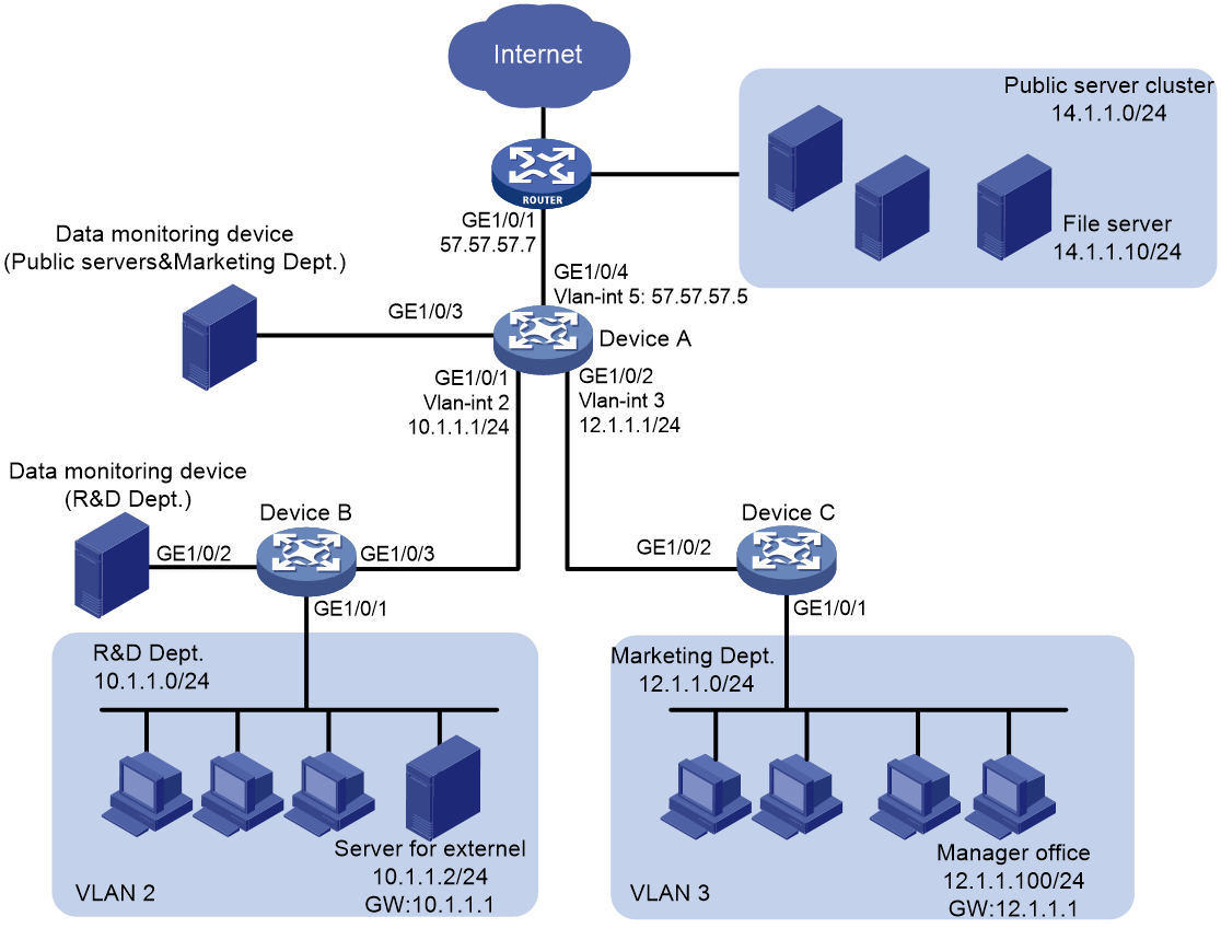

As shown in Figure 10, configure flow mirroring to monitor the network traffic by using the data monitoring devices as follows:
·     On the data monitoring device connected to Device A:
¡     Monitor the traffic from public servers.
¡     Monitor the traffic from the file server only in the non-working hours (18:00 to 8:30 of the next day) on working days.
¡     Monitor the traffic from the Marketing department to the Internet, except the traffic from the Marketing department manager office to the Internet.
·     On the data monitoring device connected to Device B:
¡     Monitor the traffic from the Technical department hosts and the server for external access.
¡     Monitor the outgoing traffic from the server in non-working hours (18:00 to 8:30 of the next day) on working days.
Figure 10 Network diagram
Analysis
To filter data from a specific source, use one of the following methods:
·     Apply a QoS policy of denying traffic to the outgoing interface of the mirrored data. The data from the specified source is not received by the data monitoring device.
·     Configure a class-behavior association to permit the data from the specified source, and then issue the class-behavior association before the class-behavior association for mirroring. Data from the specified source is not mirrored.
·     Use the packet-filter command on the outgoing interface of the mirrored data. The data from the specified source is not received by the data monitoring device.

Configuring Device A to mirror traffic from the public servers
1.     Configure a QoS policy to mirror traffic from all public servers:
# Create ACL 2000 to match packets from subnet 14.1.1.0/24.
[DeviceA] acl number 2000
[DeviceA-acl-ipv4-basic-2000] rule permit source 14.1.1.0 0.0.0.255
[DeviceA-acl-ipv4-basic-2000] quit
# Create traffic class classifier_servers, and configure the match criterion as ACL 2000.
[DeviceA] traffic classifier classifier_servers
[DeviceA-classifier-classifier_servers] if-match acl 2000
[DeviceA-classifier-classifier_servers] quit
# Create traffic behavior behavior_servers, and configure the action of mirroring traffic to GigabitEthernet 1/0/3.
[DeviceA] traffic behavior behavior_servers
[DeviceA-behavior-behavior_servers] mirror-to interface gigabitethernet 1/0/3
[DeviceA-behavior-behavior_servers] quit
# Create QoS policy policy_servers, and associate traffic class classifier_servers with traffic behavior behavior_servers in the QoS policy.
[DeviceA] qos policy policy_servers
[DeviceA-qospolicy-policy_servers] classifier classifier_servers behavior behavior_servers
[DeviceA-qospolicy-policy_servers] quit
# Apply QoS policy policy_servers to the inbound direction of GigabitEthernet 1/0/4.
[DeviceA-GigabitEthernet1/0/4] qos apply policy policy_servers inbound
2.     Configure a QoS policy to filter packets from the file server in working hours:
# Create a periodic time range work-time, setting it to be active between 8:30 and 18:00 during working days.
[DeviceA] time-range work-time 8:30 to 18:00 working-day
# Create ACL 2001, and configure a rule to match packets from 14.1.1.10 in working hours on working days.
[DeviceA] acl number 2001
[DeviceA-acl-ipv4-basic-2001] rule permit source 14.1.1.10 0.0.0.0 time-range work-time
[DeviceA-acl-ipv4-basic-2001] quit
# Create traffic class classifier_fileserver, and configure the match criterion as ACL 2001.
[DeviceA] traffic classifier classifier_fileserver
[DeviceA-classifier-classifier_fileserver] if-match acl 2001
[DeviceA-classifier-classifier_fileserver] quit
# Create traffic behavior behavior_fileserver, and configure the action of denying traffic.
[DeviceA] traffic behavior behavior_fileserver
[DeviceA-behavior-behavior_fileserver] filter deny
[DeviceA-behavior-behavior_fileserver] quit
# Create QoS policy policy_fileserver, and associate traffic class classifier_fileserver with traffic behavior behavior_fileserver in the QoS policy.
[DeviceA] qos policy policy_fileserver
[DeviceA-qospolicy-policy_fileserver] classifier classifier_fileserver behavior behavior_fileserver
[DeviceA-qospolicy-policy_fileserver] quit
# Apply QoS policy policy_fileserver to the outbound direction of GigabitEthernet 1/0/3.
[DeviceA-GigabitEthernet1/0/3] qos apply policy policy_fileserver outbound
# Use a Marketing department host (12.1.1.2) and the manager's host (12.1.1.100) to access the IP address 57.57.57.7 and port 80 through Telnet. (Details not shown.)
# Use Wireshark on the data monitoring device connected to Device A to capture the packets.
Figure 11 HTTP traffic analysis in Wireshark
The analysis shows that the data monitoring device monitors the traffic only from the Marketing department host (12.1.1.2). The traffic from the manager office is not monitored.
