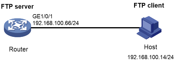

As shown in Figure 1, the host is connected to GigabitEthernet 1/0/1 of the router. The router acts as the FTP server and the host acts as the FTP client. Configure the network to meet the following requirements:
·     Use FTP to upload software upgrade file test.ipe from the FTP client to the FTP server to upgrade the router.
·     Use username abc and password 123456 to log in to the FTP server.
Figure 1 Network diagram

# Assign IP address 192.168.100.14/24 to the host (FTP client). Make sure the FTP client can reach the FTP server. (Details not shown.)
# Use username abc and password 123456 to log in to the FTP server. This example uses Windows Command Prompt.
