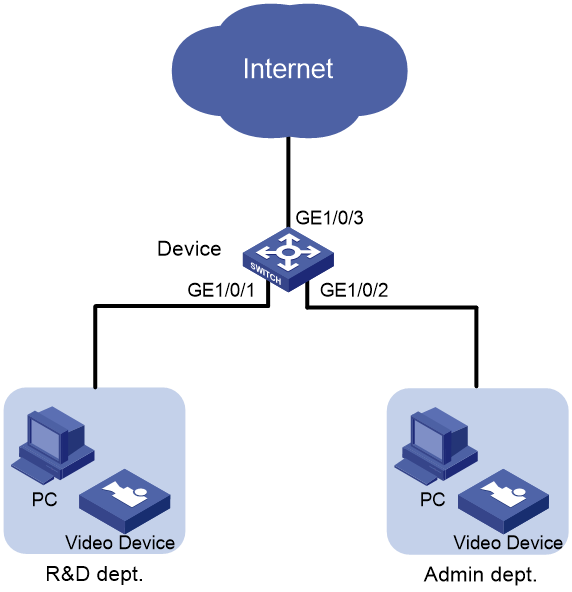

Example: Configuring MAC address-based packet filtering
As shown in Figure 1, the MAC addresses of video devices in the R&D dept and in the Admin dept are 000f-e2xx-xxxx. Configure an ACL to allow packets from the video devices every day from 8:30 to 18:00.
Figure 1 Network diagram
Software versions used
This configuration example was created and verified on Release 9141P16 of the MSR5680-X3 router.
Analysis
If the IP address of the video device to be limited is not fixed, use the MAC address to match packets. For multiple video devices with the same MAC address prefix, you can use a MAC address mask to match them.
Procedures
# Assign IP addresses to interfaces.
<Device> system-view
[Device-GigabitEthernet1/0/1] ip address 10.1.1.1 24
[Device] interface gigabitethernet 1/0/2
[Device-GigabitEthernet1/0/2] ip address 10.1.2.1 24
[Device-GigabitEthernet1/0/2] quit
[Device] interface gigabitethernet 1/0/3
[Device-GigabitEthernet1/0/3] ip address 200.1.1.2 24
[Device-GigabitEthernet1/0/3] quit
# Define a time range that contains the time section from 8:30 to 18:00 every day.
[Device] time-range time1 8:30 to 18:00 daily
# Create Layer 2 MAC 4000, and configure rules to allow the packets with a MAC address prefix of 000f-e2 during time range time1.
[Device] acl number 4000
[Device-acl-mac-4000] rule permit source-mac 000f-e200-0000 ffff-ff00-0000 time-range time1
[Device-acl-mac-4000] rule deny source-mac 000f-e200-0000 ffff-ff00-0000
[Device-acl-mac-4000] quit
# Apply ACL 4000 to filter the incoming packets on GigabitEthernet 1/0/1 and GigabitEthernet 1/0/2.
[Device-GigabitEthernet1/0/1] packet-filter 4000 inbound
[Device-GigabitEthernet1/0/2] packet-filter 4000 inbound
# Configure a default route to the external network.
[Device] ip route-static 0.0.0.0 0.0.0.0 200.1.1.1
# Use the display packet-filter command to display ACL application information for packet filtering.
[Device] display packet-filter interface inbound
Interface: GigabitEthernet1/0/1
 In-bound policy:
  MAC ACL 4000
  MAC default action: Permit
Interface: GigabitEthernet1/0/2
 In-bound policy:
  MAC ACL 4000
The output shows that GigabitEthernet 1/0/1 and GigabitEthernet 1/0/2 have been successfully applied with an ACL for packet filtering.
From 8:30 to 18:00 every day, the video devices can communicate with the external network. During other times, the video devices cannot communicate with the external network.
Configuration files
 port link-mode route
 combo enable copper
 combo enable copper
 ip address 10.1.2.1 255.255.255.0
 combo enable copper
 ip address 200.1.1.2 255.255.255.0
 ip route-static 0.0.0.0 0 200.1.1.1
 time-range time1 08:30 to 18:00 daily
acl number 4000
 rule 0 permit source-mac 000f-e200-0000 ffff-ff00-0000 time-range time1
 rule 5 deny source-mac 000f-e200-0000 ffff-ff00-0000

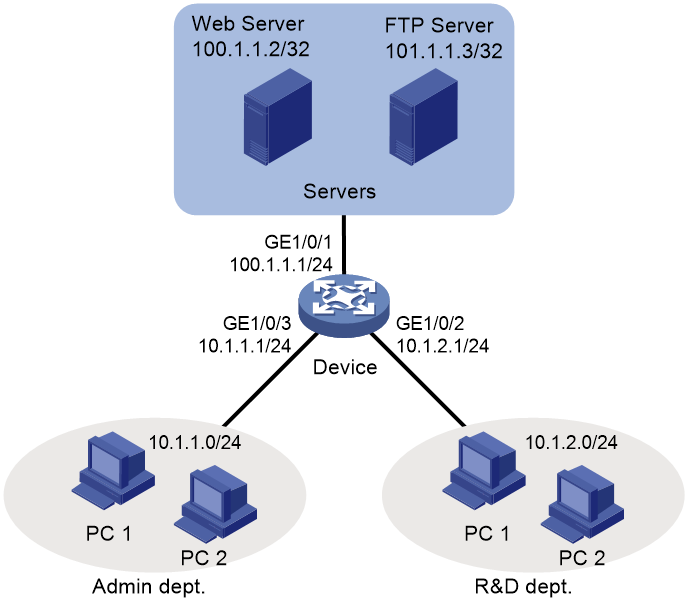

Example: Configuring TCP protocol-based packet filtering
As shown in Figure 3, the network of a company is divided into three parts: Admin dept, R&D dept, and servers. The three parts are connected through the device. Configure ACLs to meet the following requirements:
·     The Web server provides HTTP service for only hosts in the Admin dept and allows only TCP connections from hosts (not to hosts).
·     The FTP server provides FTP service for only hosts in the R&D dept. The TCP initiator is not limited when the host and the FTP server communicate.
Figure 3 Network diagram
Analysis
·     To allow TCP connections only from hosts, specify the established keyword in an advanced ACL rule to match the TCP packets with the ACK or RST bit set.
·     Typically, the TCP initiator uses ports greater than 1023. Permit the Web server-to-host packets with a TCP port greater than 1023 and with the ACK or RST bit set. Deny all other packets from the Web server to hosts.
·     To filter FTP packets, deny both FTP data packets (with TCP port 20) and FTP control packets (with TCP port 21).
·     To filter HTTP packets, deny the packets with destination TCP port 80.
Procedures
1.     Assign IP addresses to interfaces:
# Assign an IP address to GigabitEthernet 1/0/1.
[Device-GigabitEthernet1/0/1] ip address 100.1.1.1 24
# Assign IP addresses to other interfaces. (Details not shown.)
2.     Configure packet filtering for the Admin dept:
# Create IPv4 advanced ACL 3000.
[Device] acl number 3000
# Create a rule to permit the TCP packets with source IP address 100.1.1.2, a destination IP address on the 10.1.1.0/24 network, a destination TCP port greater than 1023, and with the ACK or RST bit set.
[Device-acl-ipv4-adv-3000] rule permit tcp established source 100.1.1.2 0 destination 10.1.1.0 0.0.0.255 destination-port gt 1023
# Create a rule to deny the TCP packets with a source IP address 100.1.1.2 on the 10.1.1.0/24 network and a destination IP address on the 10.1.1.0/24 network.
[Device-acl-ipv4-adv-3000] rule deny tcp source 100.1.1.0 0.0.0.255 destination 10.1.1.0 0.0.0.255
# Create a rule to deny the FTP packets with source IP address 100.1.1.3.
[Device-acl-ipv4-adv-3000] rule deny tcp source 100.1.1.3 0 source-port range 20 21
[Device-acl-ipv4-adv-3000] quit
# Apply ACL 3000 to filter the outgoing packets on GigabitEthernet 1/0/3.
[Device-GigabitEthernet1/0/3] packet-filter 3000 outbound
3.     Configure packet filtering for the R&D dept:
# Create IPv4 advanced ACL 3001, and configure a rule to deny the HTTP packets with source IP address 101.1.1.2.
[Device] acl number 3001
[Device-acl-ipv4-adv-3001] rule deny tcp source 101.1.1.2 0 source-port eq 80
[Device-acl-ipv4-adv-3001] quit
# Apply IPv4 advanced ACL 3001 to filter the outgoing packets on GigabitEthernet 1/0/2.
[Device-GigabitEthernet1/0/2] packet-filter 3001 outbound
[Device] display packet-filter interface outbound
 Outbound policy:
  IPv4 ACL 3001
  IPv4 default action: Permit
Interface: GigabitEthernet1/0/3
 Outbound policy:
  IPv4 ACL 3000
The output shows that GigabitEthernet 1/0/2 and GigabitEthernet 1/0/3 have been successfully applied with an ACL for packet filtering.
# Execute the telnet 101.1.1.3 21 command on a host in the Admin dept to identify whether it can access port 21 of the FTP server.
C:\>telnet 101.1.1.3 21
Connecting To 101.1.1.3...Could not open connection to the host, on port 21:
 Connect failed
C:\>
The output shows that the host cannot access port 21.
# Set folder sharing on a host in the Admin dept, and ping the host from the Web server. The ping operation succeeds, but the shared file cannot be visited.
C:\>ping 10.1.1.110
Pinging 10.1.1.110 with 32 bytes of data:
Reply from 10.1.1.110: bytes=32 time=2ms TTL=128
Reply from 10.1.1.110: bytes=32 time=14ms TTL=128
Reply from 10.1.1.110: bytes=32 time=1ms TTL=128
Ping statistics for 10.1.1.110:
    Minimum = 1ms, Maximum = 14ms, Average = 4ms
C:\>
# Execute the telnet 100.1.1.2 80 command on a host in the R&D dept to identify whether it can access port 80 of the Web server.
C:\>telnet 100.1.1.2 80
Connecting To 100.1.1.2...Could not open connection to the host, on port 80:
 Connect failed
C:\>
The output shows that the host cannot access port 80.
