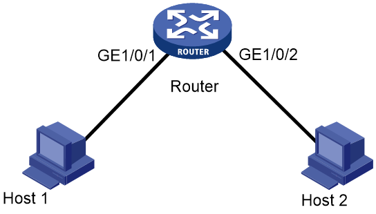

As shown in Figure 1, GigabitEthernet 1/0/1 and GigabitEthernet 1/0/2 on the router are each connected to a host.
Configure the router to perform the following operations:
·     Enable GigabitEthernet 1/0/1 and GigabitEthernet 1/0/2 at 8:00 a.m. every Monday through Friday.
·     Disable GigabitEthernet 1/0/1 and GigabitEthernet 1/0/2 at 18:00 every Monday through Friday.
Figure 1 Network diagram
