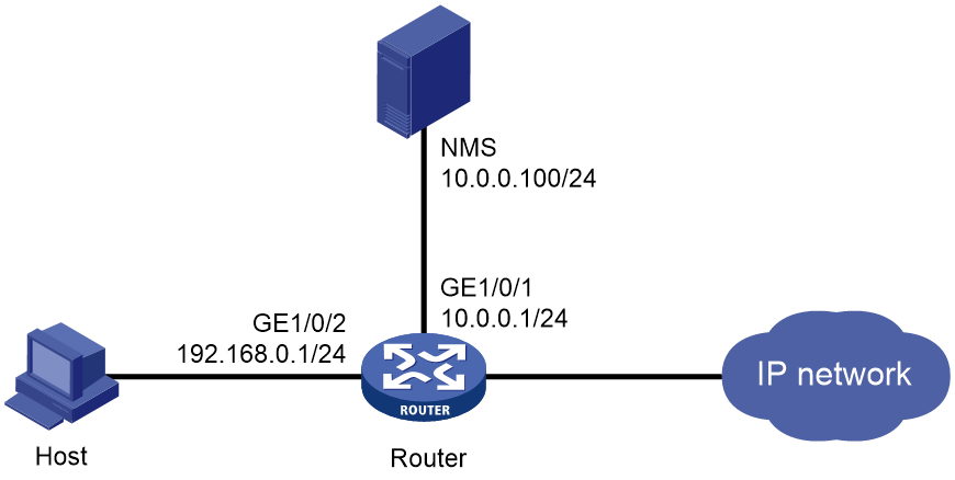

Example: Configuring the alarm function
As shown in Figure 3, configure the device to monitor the incoming traffic statistic on GigabitEthernet1/0/2, and send RMON alarms when either of the following conditions is met:
·     The 5-second delta sample for the traffic statistic crosses the rising threshold (10000).
·     The 5-second delta sample for the traffic statistic drops below the falling threshold (5000).
Figure 3 Network diagram

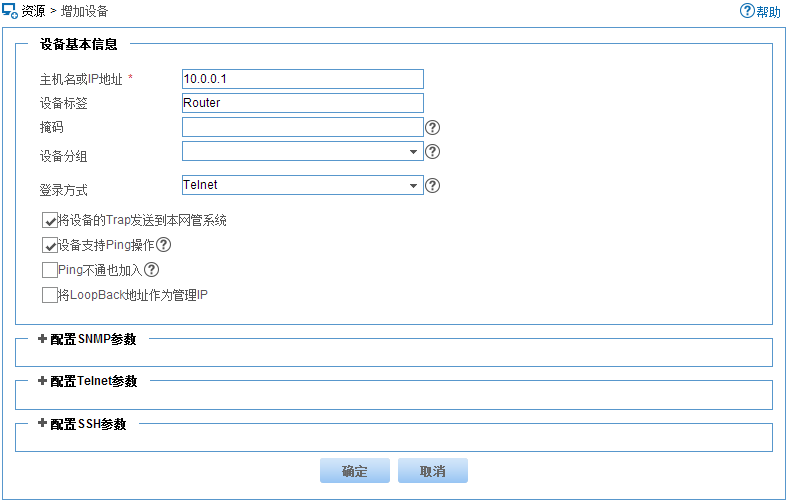

1.     Log in to IMC.
2.     Click the Resources tab.
3.     From the navigation pane, select Resource Management > Add Device.
¡     On the Add Device page, configure the following parameters:
Enter 10.0.0.1 in the Host Name/IP field.
¡     Set the device label to Router.
¡     Select Telnet from the Login Type list.
¡     Use the default values for other parameters.
Figure 4 Adding a device

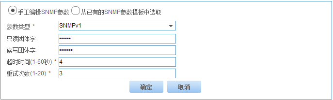

# Expand the SNMP Settings section. Click Configure.
·     Set the parameter type to SNMPv1.
·     Set the read community to public.
·     Set the write and read community to private.
·     Use the default settings for other parameters, and then click OK.
Figure 5 Configuring SNMP parameters
