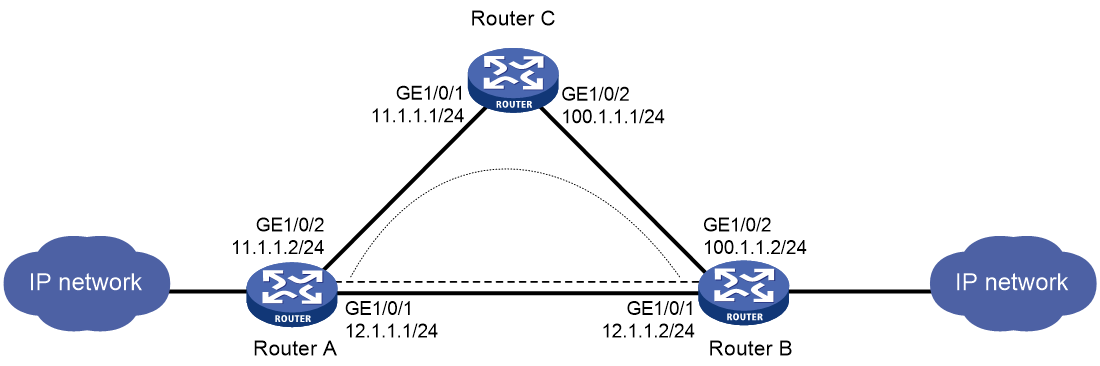

As shown in Figure 1, Router A and Router B run BGP. To prevent network route flapping when BGP peers comes up and goes down repeatedly, configure an EAA monitor policy on Router B to meet the following requirements:
·     Disable the BGP peer relationship automatically when the BGP peer comes up and goes down three times in 10 minutes.
·     Enable BGP peer relationship every 60 minutes.
Figure 1 Network diagram

·     For Router A and Router B to automatically disable the BGP peer relations when the BGP peer comes up and goes down consecutively, configure an EAA monitoring policy for them.
·     To enable BGP peer relations between Router A and Router B every 60 minutes, configure a schedule task for them.

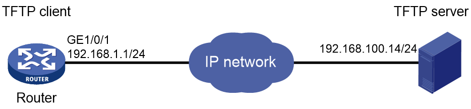

As shown in Figure 2, the administrator remotely configures the router. To avoid network disconnectivity caused by certain configurations, back up the configuration file in advance. Use NQA to monitor network connectivity. Configure EAA monitor policy to automatically restore the available backup configuration and restart the device when the network is disconnected.
Figure 2 Network diagram
Analysis
Use an EAA monitor policy to monitor the state of the NQA reaction entry. When the monitored object exceeds the threshold of the specified type, the EAA monitor policy is automatically triggered. The NQA reaction entry state (MIB value) is as follows:
·     When the state is invalid (MIB value is 1), the NQA operation is not started.
·     When the state is overThreshold (MIB value is 2), the monitored object exceeds the threshold of the specified type.
·     When the state is belowThreshold (MIB value is 3), the monitored object does not exceed the threshold of the specified type.

Example: Configuring an EAA monitor policy to monitor and maintain the device running status automatically
As shown in Figure 3, the router has network connectivity to the TFTP server. To prevent high CPU usage on the router, configure an EAA monitor policy to monitor the CPU usage of the router automatically and perform the following actions when the CPU usage exceeds 80%:
·     Display the memory information, interface statistics, and routing table information at the time when the CPU usage exceeds 80%, and save them to a specified file.
·     Upload the file to the TFTP server.
·     After uploading the file to the TFTP server, delete the local file.
Figure 3 Network diagram
Software version used
This configuration example was created and verified on R9141P16 of the MSR5680-X3 router.
·     You can configure only one event and runtime for an EAA monitor policy.  If you execute the event or running-time command multiple times, the most recent configuration that has been committed takes effect.
·     If two actions have the same ID, the most recent configured action that has been committed takes effect.
·     After configuring an event, action, user role, and runtime for a CLI-defined monitor policy, you must execute the commit command to commit configuration for the configuration to take effect.

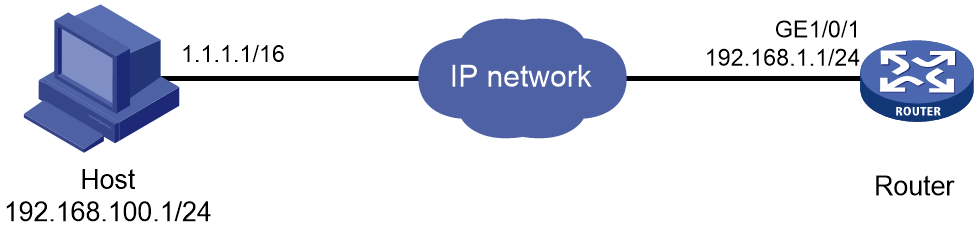

Example: Configuring an EAA monitor policy for automatic bandwidth assurance for video conferencing
As shown in Figure 4, a host and a VoIP video system access the Internet through the router. When a video conference is held, it requires a significant amount of bandwidth, and it is necessary to limit the Internet traffic of the host. Configure an EAA monitor policy on the router to meet the following requirements:
·     When the video traffic is greater than or equal to 100000 packets per second, disallow host packets to pass and allow only video package to pass.
·     When the video traffic is less than 100000 packets per second, allow both video and host packets to pass.
Figure 4 Network diagram

Example: Configuring an EAA monitor policy to enable primary/backup link switchover based on the link quality
As shown in Figure 5, Router A and Router B are reachable to each other. Typically, the direct link between Router A and Router B acts as the primary link, and the link through Router C acts as the backup link. Configure an EAA monitor policy on Router A to meet the following requirements:
·     When the primary link has a packet loss rate exceeding 20% or a delay greater than 200 ms, switch over the traffic to the backup link.
·     When the primary link does not have packet loss and has a latency less than 100 ms, switch back the traffic to the primary link.
Figure 5 Network diagram
Analysis
Configure Router A
1.     Assign IP addresses to interfaces.
# Assign an IP address to GigabitEthernet 1/0/1.
<RouterA> system-view
[RouterA] interface gigabitethernet 1/0/1
[RouterA-GigabitEthernet1/0/1] port link-mode route
[RouterA-GigabitEthernet1/0/1] ip address 12.1.1.1 255.255.255.0
[RouterA-GigabitEthernet1/0/1] quit
# Assign an IP address to GigabitEthernet 1/0/2.
[RouterA] interface gigabitethernet 1/0/2
[RouterA-GigabitEthernet1/0/2] port link-mode route
[RouterA-GigabitEthernet1/0/2] ip address 11.1.1.2 255.255.255.0
[RouterA-GigabitEthernet1/0/2] quit
2.     Configure an NQA operation.
# Create an ICMP echo-type NQA operation with administrator name 1 and operation tag 1. Specify 12.1.1.2 as the destination IP address.
[RouterA] nqa entry 1 1
[RouterA-nqa-1-1] type icmp-echo
[RouterA-nqa-1-1-icmp-echo] destination ip 12.1.1.2
# Configure the operation to repeat every 15000 milliseconds and set the probe timeout time to 800 milliseconds. Configure the ICMP echo operation to perform 15 probes.
[RouterA-nqa-1-1-icmp-echo] frequency 15000
[RouterA-nqa-1-1-icmp-echo] probe timeout 800
[RouterA-nqa-1-1-icmp-echo] probe count 15
# Create reaction entry 1 for monitoring the ICMP-echo probe duration, and set the upper limit to 200 milliseconds and lower limit to 0 milliseconds. Before the NQA operation starts, the initial state of the reaction entry is invalid. After the operation, the average probe duration is checked. If it exceeds the upper limit, the state is set to over-threshold. If it is below the lower limit, the state of the reaction entry is set to below-threshold.
[RouterA-nqa-1-1-icmp-echo] reaction 1 checked-element probe-duration threshold-type average threshold-value 200 0 action-type none
# Create reaction entry 2 for monitoring the number of ICMP-echo probe failures. Before the NQA operation starts, the initial state of the reaction entry is invalid. If the total number of probe failures reaches or exceeds 3, the state of the entry is set to over-threshold. If it is below the threshold, the state of the entry is set to below-threshold.
[RouterA-nqa-1-1-icmp-echo] reaction 2 checked-element probe-fail threshold-type accumulate 3 action-type none
# Create reaction entry 3 for monitoring the ICMP-echo probe duration, and set the upper limit to 100 milliseconds and lower limit to 0 milliseconds. Before the NQA operation starts, the initial state of the reaction entry is invalid. After the operation, the average probe duration is checked. If it reaches the upper limit, the state is set to over-threshold. If it is below the lower limit, the state of the reaction entry is set to below-threshold.
[RouterA-nqa-1-1-icmp-echo] reaction 3 checked-element probe-duration threshold-type average threshold-value 100 0 action-type none
# # Create reaction entry 4 for monitoring the probe failures in ICMP echo operation. Before the NQA operation starts, the initial state of the reaction entry is invalid. If the total number of probe failures reaches or exceeds 1, the state of the entry is set to over-threshold. If it is below the threshold, the state of the entry is set to below-threshold.
[RouterA-nqa-1-1-icmp-echo] reaction 4 checked-element probe-fail threshold-type accumulate 1 action-type none
[RouterA-nqa-1-1-icmp-echo] quit
# Enable the NQA client.
[RouterA] nqa agent enable
# Schedule the operation with administrator name 1 and operation tag 1 to start immediately and last forever.
[RouterA] nqa schedule 1 1 start-time now lifetime forever
# Enable SNMP agent.
[RouterA] snmp-agent

# The log information shows that EAA policy 3 has been successfully executed.
%Jul 14 15:19:13:771 2014 RouterA RTM/6/RTM_POLICY: CLI policy 3 is running successfully.
# Execute the display rtm environment command to display the user-defined EAA environment variables. Verify that the value of environment variable delay changes to 0.
[RouterA] display rtm environment
 Name                 Value
 backup               1
 delay                0
 loss                 1
# Execute the display this to display the effective configuration in the current view. Verify that the traffic from Router A still reaches Router B via the backup link.
[RouterA] display this
 sysname RouterA
 ip route-static 100.1.1.0 24 11.1.1.1 preference 10
 snmp-agent
 snmp-agent local-engineid 800063A280000605B36B9E00000001
 snmp-agent sys-info version v3
 rtm environment backup 1
 rtm environment delay 0
 rtm environment loss 1
Return
4.     When both the message delay and packet loss rate between Router A and Router B fall to the normal range, observe the information displayed on Router A.
# The log information shows that EAA policy 4 has been executed successfully.
%Jul 14 15:19:13:771 2014 RouterA RTM/6/RTM_POLICY: CLI policy 4 is running successfully.
# Execute the display rtm environment command to display the user-defined EAA environment variables. Verify that the values of environment variables backup, delay, and loss change to 0.
 Name                 Value
 backup               0
 delay                0
 loss                 0
# Execute the display this command to display the effective configuration in the current view
 sysname RouterA
 snmp-agent
 rtm environment backup 0
 rtm environment loss 0
Return
Configuration files
·     Router A:
nqa entry 1 1
 type icmp-echo
  frequency 15000
  probe count 15
  probe timeout 800
 snmp-agent
rtm cli-policy 1
 event snmp oid 1.3.6.1.4.1.25506.8.3.1.13.1.11.1.49.1.49.1 monitor-obj get start-op eq start-val 2 restart-op eq restart-val 3 interval 10
 action 0 cli tclsh
 action 1 cli system-view
 action 2 cli if { $delay==0 } { rtm environment delay 1 }
 action 3 cli if { $backup==0 } { rtm environment backup 1; ip route-static 100.1.1.0 24 11.1.1.1 preference 10 }
 user-role network-admin
rtm cli-policy 2
 event snmp oid 1.3.6.1.4.1.25256.8.3.1.13.1.11.1.49.1.49.2 monitor-obj get start-op eq start-val 2 restart-op eq restart-val 3 interval 10
 action 0 cli tclsh
 action 2 cli if { $loss==0 } { rtm environment loss 1 }
rtm cli-policy 3
 event snmp oid 1.3.6.1.4.1.25506.8.3.1.13.1.11.1.49.1.49.3 monitor-obj get start-op eq start-val 3 restart-op eq restart-val 2 interval 10
 action 0 cli tclsh
 action 2 cli if { $delay==1 } { rtm environment delay 0 }
 action 3 cli after 5000
 action 4 cli if { $backup==1 && $loss==0 } { undo ip route-static 100.1.1.0 24 11.1.1.1 preference 10; rtm environment backup 0 }
rtm cli-policy 4
 event snmp oid 1.3.6.1.4.1.25506.8.3.1.13.1.11.1.49.1.49.4 monitor-obj get start-op eq start-val 3 restart-op eq restart-val 2 interval 10
 action 0 cli tclsh
 action 2 cli if { $loss==1 } { rtm environment loss 0 }
 action 4 cli if { $backup==1 && $delay==0 } { undo ip route-static 100.1.1.0 24 11.1.1.1 preference 10;  rtm environment backup 0 }
·     Router B:
 ip address 12.1.1.2 255.255.255.0
 ip address 100.1.1.2 255.255.255.0
ospf 1
 area 0.0.0.0
  network 12.1.1.0 0.0.0.255
  network 100.1.1.0 0.0.0.255
·     Router C:
 ip address 11.1.1.1 255.255.255.0
 ip address 100.1.1.1 255.255.255.0
ospf 1
 area 0.0.0.0
  network 11.1.1.0 0.0.0.255
Example: Configuring a TCL monitoring policy
Configure a TCL monitoring policy for the device to execute the following actions when the incoming traffic on GigabitEthernet 1/0/1 reaches or exceeds 500 Mbps:
·     Generate logs for traffic that exceeds the range.
·     Display the current CPU state and save it to a file.
·     Display the state of GigabitEthernet 1/0/1 and save it to a file.
If the subsequent incoming traffic reaches or exceeds 200Mbps, monitoring will restart. When the incoming traffic on the interface is detected to exceed 500Mbps again, the aforementioned operations are executed again.
Software versions used
Editing the TCL script
# Use Notepad to edit the test.tcl file as follows:
# Define the monitored event. Configure interface GigabitEthernet 1/0/1 to focus on inbound traffic. When the inbound traffic reaches or exceeds 500 Mbps, configure the device to execute the specified action. The condition to re-enable polling is when the interface traffic reaches or exceeds 200 Mbps.
::comware::rtm::event_register interface gigabitethernet 1/0/1 monitor-obj rcv-bps start-op ge start-val 500000000 restart-op ge restart-val 200000000 user-role network-admin
# Configure the action to take when the monitored event occurs: Send log message GE1/0/1 input rate exceeded 500000000bps with priority level 1 and device number local1.
::comware::rtm::action syslog priority 1 facility local1 msg "GE1/0/1 input rate exceeded 500000000bps"
# Configure the device to execute the display cpu-usage command to display CPU usage statistics and save the information in ge0_info.txt when the event occurs.
display cpu-usage >> ge0_info.txt
# Configure the device to execute the display interface gigabitethernet 1/0/1 command to display the current operating state and related information for GigabitEthernet 1/0/1 and save the information in ge0_info.txt when the event occurs.
display interface gigabitethernet 1/0/1 >> ge0_info.txt
Configuring the device
<Device> system-view
[Device-GigabitEthernet1/0/1] ip address 192.168.100.66 255.255.255.0
[Device] quit
# Download test.tcl to the device through TFTP.
<Device> tftp 192.168.100.14 get test.tcl
  % Total    % Received % Xferd  Average Speed   Time    Time     Time  Current
                                 Dload  Upload   Total   Spent    Left  Speed
100   189  100   189    0     0   7900      0 --:--:-- --:--:-- --:--:-- 12600
# Create and enable a TCL monitoring policy, and bind the policy to TCL script test.tcl.
[Device] rtm tcl-policy test test.tcl
[Device] quit
# Use the display rtm policy registered command to view the policy named test with type Tcl.
<Device> display rtm policy registered
Total number: 1
Type  Event             TimeRegistered       PolicyName
TCL   INTERFACE         Oct 22 14:06:20 2017 test
# When the inbound traffic on interface GigabitEthernet 1/0/1 reaches or exceeds 500 Mbps, check all files and folder information in the device for the existence of ge0_info.txt.
<Device> dir
Directory of cfa0:
   0 -rw-        3227 Nov 19 2017 17:28:36   1.cfg
   1 -rw-        2296 Apr 26 2017 18:55:08   5660_data.ak
   2 -rw-        2304 Apr 26 2017 18:54:56   5660_security.ak
   3 -rw-        2298 Apr 26 2017 18:55:16   5660_voice.ak
   4 -rw-        3227 Nov 19 2017 17:15:19   STARTUP110.CFG
   5 drw-           - Mar 10 2017 04:10:10   diagfile
   6 -rw-         567 Jul 17 2017 14:25:00   dsakey
   7 -rw-         223 Jul 17 2017 14:25:00   ecdsakey
   8 -rw-         278 Jul 17 2017 14:25:00   ge0_info.txt
   9 -rw-         735 Jul 17 2017 14:25:00   hostkey
  10 -rw-         492 Nov 18 2017 16:40:50   ifindex.dat
  11 -rw-         276 Apr 23 2017 19:00:00   lauth.dat
  12 drw-           - Jul 17 2017 11:26:34   license
  13 drw-           - Apr 24 2017 12:39:38   logfile
507492 KB total (298412 KB free)
# Use TFTP to copy file ge0_info.txt to the TFTP server.
<Device> tftp 192.168.100.14 put ge0_info.txt
# View file ge0_info.txt to display the current state of the CPU and interface GigabitEthernet 1/0/1.
Slot 1 CPU 0 CPU usage:
       5% in last 5 seconds
       5% in last 1 minute
       6% in last 5 minutes
Slot 2 CPU 0 CPU usage:
       1% in last 5 seconds
       1% in last 1 minute
       1% in last 5 minutes
Current state: UP
Line protocol state: UP
Description: GigabitEthernet1/0/1 Interface
Bandwidth: 1000000kbps
Maximum Transmit Unit: 1500
Internet Address is 192.168.100.66/24 Primary
IP Packet Frame Type:PKTFMT_ETHNT_2, Hardware Address: 4431-9255-f3fc
IPv6 Packet Frame Type:PKTFMT_ETHNT_2, Hardware Address: 4431-9255-f3fc
Media type is twisted pair
Port hardware type is 1000_BASE_T
Port priority: 0
1000Mbps-speed mode, full-duplex mode
Link speed type is autonegotiation, link duplex type is autonegotiation
Flow-control is not enabled
The Maximum Frame Length is 9216
Last clearing of counters: Never
 Peak value of input: 108106680 bytes/sec, at 2017-10-15 14:14:30
 Peak value of output: 20 bytes/sec, at 2017-10-15 13:24:25
 Last 300 seconds input:  1028465 packets/sec 65821768 bytes/sec 69%
 Last 300 seconds output:  0 packets/sec 9 bytes/sec 0%
 Input (total):  9585460958 packets, 759947089836 bytes
          9585460803 unicasts, 3 broadcasts, 9 multicasts, 0 pauses
 Input (normal):  9585460815 packets, - bytes
 Input:  1 input errors, 0 runts, 0 giants, 0 throttles
          1 CRC, 0 frame, - overruns, 0 aborts
          - ignored, - parity errors
 Output (total): 313 packets, 94288 bytes
          0 unicasts, 0 broadcasts, 313 multicasts, 0 pauses
 Output (normal): 313 packets, - bytes
 Output: 0 output errors, - underruns, - buffer failures
          0 aborts, 0 deferred, 0 collisions, 0 late collisions
          0 lost carrier, - no carrier
Configuration files
·     Script text for test.tcl:
::comware::rtm::event_register interface gigabitethernet1/0/1 monitor-obj rcv-bps start-op ge start-val 500000000 restart-op ge restart-val 200000000 user-role network-admin
·     Device:
Exmaple: Configuring a CLI-defined monitor policy
Configure a CLI-defined monitor policy for the device to execute the following actions when the incoming traffic on GigabitEthernet 1/0/1 reaches or exceeds 500 Mbps:
·     For the same policy, you can configure only one trigger event and runtime. If you execute the event or running-time commands multiple times, the most recently configured and committed one takes effect.
·     If the number of a newly configured action is the same as the number of an existing action, the most recently configured one will take effect after you execute the commit command.
·     After configuring events, actions, user roles, and runtime for a CLI-defined monitor policy, you must execute the commit command for the policy and its configurations to be activated.
# Create a CLI-defined monitor policy numbered 1.
[Device] rtm cli-policy 1
# Configure a CLI-defined policy to monitor the receiving rate on GigabitEthernet 1/0/1. Set the start threshold to 500 Mbps and the restart threshold to 200 Mbps. Enable EAA to execute the policy when the rate reaches or exceeds 1000 for the first time. Enable EAA to re-execute the inspection if the rate reaches or exceeds 200 Mbps.
[Device-rtm-1] event interface gigabitethernet 1/0/1 monitor-obj rcv-bps start-op ge start-val 500000000 restart-op ge restart-val 200000000
# Configure an action for the CLI-defined policy to send log message "GE1/0/1 input rate exceeded 500000000bps" with a severity of 1 from the facility device local1.
[Device-rtm-1] action 1 syslog priority 1 facility local1 msg "GE1/0/1 input rate exceeded 500000000bps"
# Configure a CLI action for the CLI-defined policy to display CPU usage statistics and save the statistics in file ge0_info.txt.
[Device-rtm-1] action 2 cli display cpu-usage >> ge0_info.txt
# Configure a CLI action for the CLI-defined policy to display the running status and information about GigabitEthernet 1/0/1 and save the statistics in file ge0_info.txt.
[Device-rtm-1] action 3 cli display interface gigabitethernet 1/0/1 >> ge0_info.txt
# Set the action runtime to 30 seconds for the CLI-defined policy.
[Device-rtm-1] running-time 30
# Assign user role network-admin to the CLI-defined policy.
[Device-rtm-1] user-role network-admin
# Enable the CLI-defined policy.
[Device-rtm-1] commit
[Device-rtm-1] quit
# Verify that CLI-defined policy 1 exists.
Total number: 1
CLI   INTERFACE  May 04 00:12:40 2017  1
# Verify that file ge0_info.txt exists on the device when the inbound traffic on interface GigabitEthernet 1/0/1 reaches or exceeds 500 Mbps.
<Device> dir
Directory of cfa0:
# Verify that file ge0_info.txt contains the CPU usage and status of interface GigabitEthernet 1/0/1.
       5% in last 1 minute
