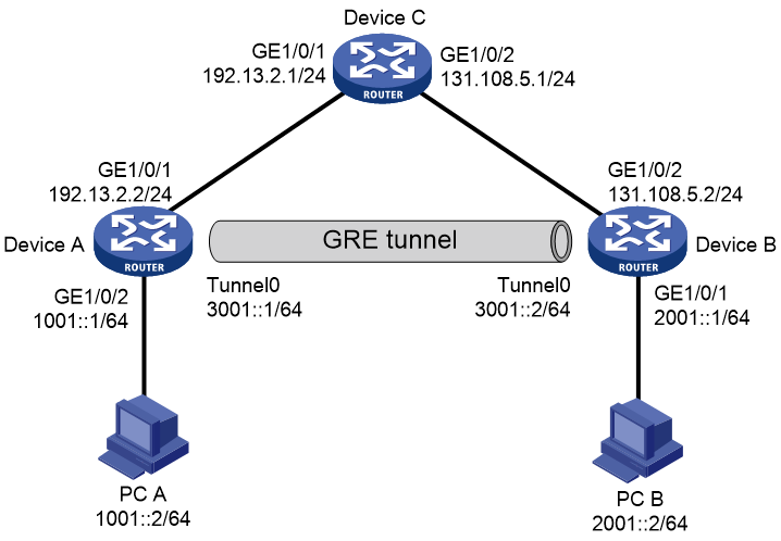

As shown in Figure 1, Device A, Device B, and Device C are connected to each other through the IPv4 network. Device A and Device B are connected to IPv6 hosts PC A and PC B, respectively.
Configure a GRE tunnel between the two border dual-stack devices (Device A and Device B) to allow the two IPv6 PCs to communicate with each other over the IPv4 network.
Figure 1 Network diagram
Analysis
·     To allow the two IPv6 PCs to communicate over the IPv4 network, configure the GRE tunnel mode as GRE/IPv4 (GRE over IPv4) and assign an IPv6 address to the GRE tunnel interface.
·     To direct traffic sent from PC A to PC B to the GRE tunnel, configure a route reaching the destination network through the tunnel on Device A. Configure the route destination address as the packet destination address before GRE encapsulation (IPv6 address of PC B) and next hop address as the tunnel interface address on the tunnel remote device Device B, or specify the route's outgoing interface as the local GRE tunnel interface. You can configure this route by configuring a static route or configuring a dynamic routing protocol on both the tunnel interface and the Layer 3 interface connecting PC A. This example uses a static route. The corresponding configuration is also required on Device B.
·     To ensure that the two ends of the GRE tunnel can reach other through IPv4, configure a static route to the peer on Device A and Device B, respectively.
Software versions used
This configuration example was created and verified on R9141P16 of the MSR5680-X3 device.
You must configure the tunnel source address and destination address at both ends of a tunnel. The tunnel source or destination address at one end must be the tunnel destination or source address at the other end.
