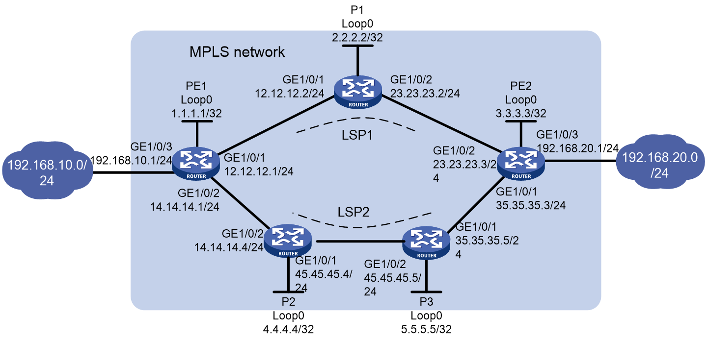

Example: Configuring dynamical LSPs by using LDP
As shown in Figure 2, on the MPLS network of the carrier, PE 1 and PE 2 have two routes to each other.
·     Configure LDP on the MPLS network to dynamically establish LSPs, so subnets 192.168.10.0/24 and 192.168.20.0/24 can transmit packets to each other over the LSPs.
·     By default, packets are transmitted over LSP 1. When LSP 1 fails, packets are transmitted over LSP 2.
·     All devices on the MPLS network allow only routes destined for 1.1.1.1/32, 2.2.2.2/32, 3.3.3.3/32, 4.4.4.4/32, 5.5.5.5/32, 192.168.10.0/24, and 192.168.20.0/24 to trigger LDP to establish LSPs. Other routes are not allowed to trigger LSP establishment to avoid affecting device performance due to excessive LSPs.
Figure 2 Network diagram
Analysis
·     To create LSPs dynamically through LDP, configure a routing protocol to ensure IP connectivity between the LSRs. This example uses OSPF.
·     To use LSP 1 as the primary LSP and LSP 2 as the backup LSP for packet forwarding, configure the primary route between subnet 192.168.10.0/24 and 192.168.20.0/24 as LSP 1 and the backup route as LSP 2. In this example, OSPF automatically calculates the route cost for LSP 1 to be smaller than that for LSP 2, so LSP 1 is preferred.
·     To ensure that LDP establishes LSPs only for specific routes, configure LSP generation policies on each LSR.

Table 1 Assign IP addresses to the network interfaces.
Configure IP addresses and masks for interfaces as shown in Figure 2. (Details not shown.)
Table 2 Configure OSPF on each router to ensure IP connectivity between them:
# Configure PE 1.
[PE1] ospf 1
[PE1-ospf-1] area 0
[PE1-ospf-1-area-0.0.0.0] network 1.1.1.1 0.0.0.0
[PE1-ospf-1-area-0.0.0.0] network 12.12.12.0 0.0.0.255
[PE1-ospf-1-area-0.0.0.0] network 14.14.14.0 0.0.0.255
[PE1-ospf-1-area-0.0.0.0] network 192.168.10.0 0.0.0.255

PE 1 should have established OSPF peering with P 1 and P 2, and PE 2 with P 2 and P 3. Execute the display ospf peer verbose command to verify that the OSPF neighbors are in Full state. Use PE1 as an example:

After the configuration is completed, PE 1 should have established local LDP sessions with P 1 and P 2, and PE 2 with P 2 and P 3.
Execute the display mpls ldp peer command on each router to view the LDP peer information. Use PE1 as an example:

Table 4 Configure an LSP generation policy to establish LSPs for routes destined for 1.1.1.1/32, 2.2.2.2/32, 3.3.3.3/32, 4.4.4.4/32, 5.5.5.5/32, 192.168.10.0/24, and 192.168.20.0/24:
# On PE 1, configure IP prefix list PE1, and configure LDP to use only the routes permitted by the prefix list to establish LSPs.

After the configuration is completed, execute the display mpls ldp lsp command on PE 1 to view LDP LSP information. The output shows that the LSP destined for subnet 192.168.20.0/24 uses P 1 as the next hop by default.
[PE1] display mpls ldp lsp

# When P 1 fails, execute the display mpls ldp lsp command. The output shows that the LSP destined for subnet 192.168.20.0/24 uses P 2 as the next hop.

·     PE 2:
ospf 1
 area 0.0.0.0
  network 3.3.3.3 0.0.0.0
  network 23.23.23.0 0.0.0.255
  network 33.0.0.0 0.0.0.255
  network 192.168.20.0 0.0.0.255
 mpls lsr-id 3.3.3.3
mpls ldp
 lsp-trigger prefix-list PE2
interface LoopBack0
 ip address 3.3.3.3 255,255,255,255
 port link-mode route
ip address 35.35.35.3 255.255.255.0
 mpls enable
 mpls ldp enable
ip address 23.23.23.3 255.255.255.0
 mpls enable
 mpls ldp enable
ip address 192.168.20.1 255.255.255.0
 ip prefix-list PE2 index 10 permit 1.1.1.1 32
 ip prefix-list PE2 index 20 permit 2.2.2.2 32
 ip prefix-list PE2 index 30 permit 3.3.3.3 32
 ip prefix-list PE2 index 40 permit 4.4.4.4 32
 ip prefix-list PE2 index 50 permit 5.5.5.5 32
 ip prefix-list PE2 index 60 permit 192.168.10.0 24
 ip prefix-list PE2 index 70 permit 192.168.20.0 24
