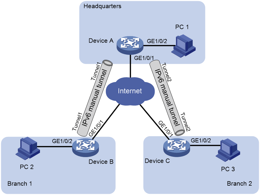

As shown in Figure 1, IPv6 is deployed in the headquarters (HQ) and its branches and they are connected through an IPv4 network. Device A, Device B, and Device C are gateways of the HQ, Branch 1, and Branch 2, respectively. Configure an IPv6 over IPv4 manual tunnel between the HQ and each branch B so the IPv6 networks of the HQ and branch can reach each other over the IPv4 network. Configure OSPFv3 so that the gateway devices can have routes to reach the destination IPv6 addresses through the tunnels, and the branches can communicate with each other through the HQ.
Figure 1 Network diagram
Table 1 Interface and address assignment
