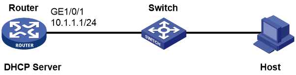

Example: Configuring authorized ARP on a DHCP server
As shown in Figure 1, configure authorized ARP on GigabitEthernet 1/0/1 of the router (a DHCP server). Then, only hosts with IP addresses assigned by the router can access external networks through the router.
Figure 1 Network diagram
Software versions used
This configuration example was created and verified on R9141P16 of the MSR5680-X3 device.

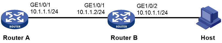

Example: Configuring authorized ARP on a DHCP relay agent
As shown in Figure 2, configure authorized ARP on GigabitEthernet 1/0/2 of Router B (a DHCP relay agent) to ensure user validity.
Figure 2 Network diagram
Analysis
Configure recording of relay entries on the relay agent and authorized ARP so that only packets matching a relay entry can be forwarded by the relay agent. In this way, illegal hosts cannot access external networks through the relay agent.
