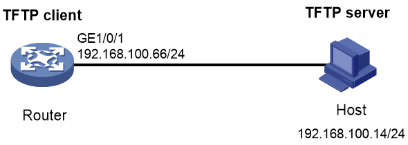

As shown in Figure 1, the host is connected to GigabitEthernet 1/0/1 of the router. The router acts as the TFTP client and the host acts as the TFTP server. Configure the network to realize software upgrade for the router through TFTP.
Figure 1 Network diagram

# Assign IP address 192.168.100.14/24 to the host. Make sure the host and the router can reach each other. (Details not shown.)

# Assign an IP address to GigabitEthernet 1/0/1 on the router.
<Router> system-view
[Router] interface gigabitethernet 1/0/1
[Router-GigabitEthernet1/0/1] ip address 192.168.100.66 255.255.255.0
[Router-GigabitEthernet1/0/1] quit
[Router] quit
