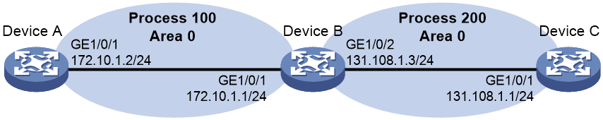

As shown in Figure 1, Device A and Device B establish a neighbor relationship in OSPF process 100, and Device B and Device C establish a neighbor relationship in OSPF process 200. Device A and Device C cannot learn routes from each other through OSPF.
Figure 1 Network diagram
