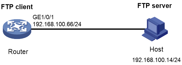

As shown in Figure 1, the host is connected to GigabitEthernet 1/0/1 of the router. The router acts as the FTP client and the host acts as the FTP server. Configure the network to meet the following requirements:
·     Use FTP to download software upgrade file test.ipe from the FTP server to the FTP client to upgrade the router.
·     Use username 123456 and password 123456 to log in to the FTP server.
Figure 1 Network diagram

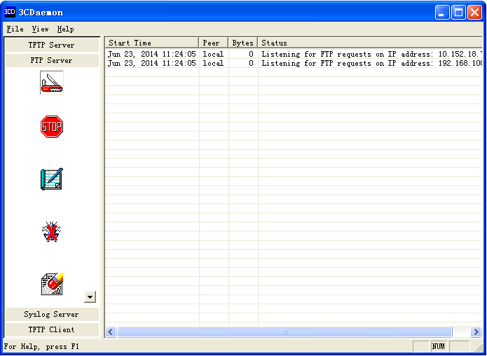

# Start the FTP server on the host. This example uses the 3CDaemon FTP server.
Figure 2 Configuring the FTP server

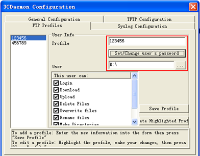

# Perform the following operations to configure the FTP server parameters:
1.     Click .
2.     Set the username in the Profile filed. This example uses 123456.
3.     Click Set/Change user's password to set the password. This example uses 123456.
4.     Click  to specify the download path for the FTP server.
5.     Click OK.
