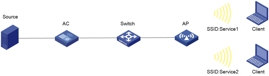

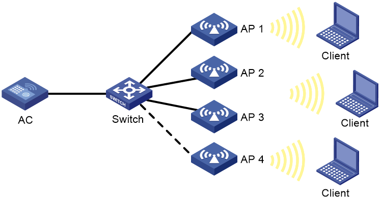

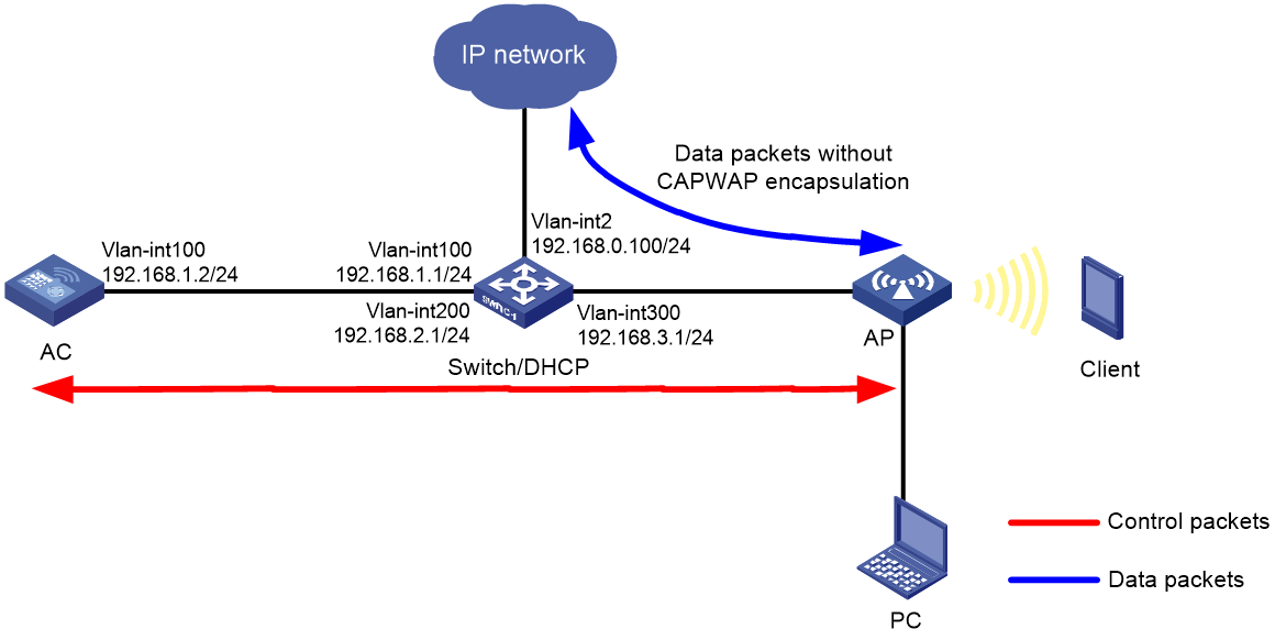

As shown in Figure 1, in centralized forwarding mode, the AC is connected to the switch, and the switch assigns an IP address to the AP and clients as a DHCP server. Configure auto-DFS and auto-TPC for the AP to change the working channel and transmit power automatically based on the wireless environment.

Configure the switch
# Create VLAN 100. The switch will use this VLAN to forward the traffic on the CAPWAP tunnels between the AC and AP.
<Switch> system-view
[Switch] vlan 100
[Switch-vlan100] quit
# Create VLAN 200. The switch will use this VLAN to forward packets for wireless clients.
[Switch] vlan 200
[Switch-vlan200] quit
# Configure GigabitEthernet 1/0/1 that connects the switch to the AC as a trunk port, and assign the trunk port to VLAN1, VLAN 100, and VLAN 200.
[Switch] interface gigabitethernet 1/0/1
[Switch-GigabitEthernet1/0/1] port link-type trunk
[Switch-GigabitEthernet1/0/1] port trunk permit vlan 1 100 200
[Switch-GigabitEthernet1/0/1] quit
# Configure GigabitEthernet 1/0/2 that connects the switch to the APs as an access port, and assign the access port to VLAN 100.
[Switch] interface range gigabitethernet 1/0/2 to gigabitethernet 1/0/5
[Switch-if-range] port link-type access
[Switch-if-range] port access vlan 100
# Enable the PoE feature.
[Switch-if-range] poe enable
[Switch-if-range] quit
# Specify an IP address for VLAN-interface 100.
[Switch-Vlan-interface100] ip address 192.1.0.2 16
# Specify an IP address for VLAN-interface 200.
[Switch] interface vlan-interface 200
[Switch-Vlan-interface200] ip address 192.2.0.2 24
[Switch-Vlan-interface200] quit
# Enable DHCP.
[Switch] dhcp enable
# Create DHCP address pool 100. Specify the 192.1.0.0/16 subnet and the 192.1.0.1 gateway for the pool.
[Switch] dhcp server ip-pool 100
[Switch-dhcp-pool-100] network 192.1.0.0 mask 255.255.0.0
[Switch-dhcp-pool-100] gateway-list 192.1.0.1
[Switch-dhcp-pool-100] quit
# Create DHCP address pool 200. Specify the 192.2.0.0/16 subnet and the 192.2.0.1 gateway for the pool.
[Switch] dhcp server ip-pool 200
[Switch-dhcp-pool-200] network 192.2.0.0 mask 255.255.255.0
[Switch-dhcp-pool-200] gateway-list 192.2.0.1
[Switch-dhcp-pool-200] quit

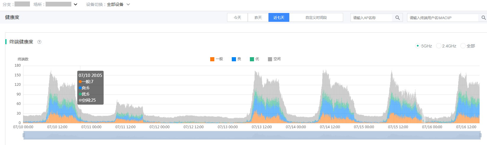

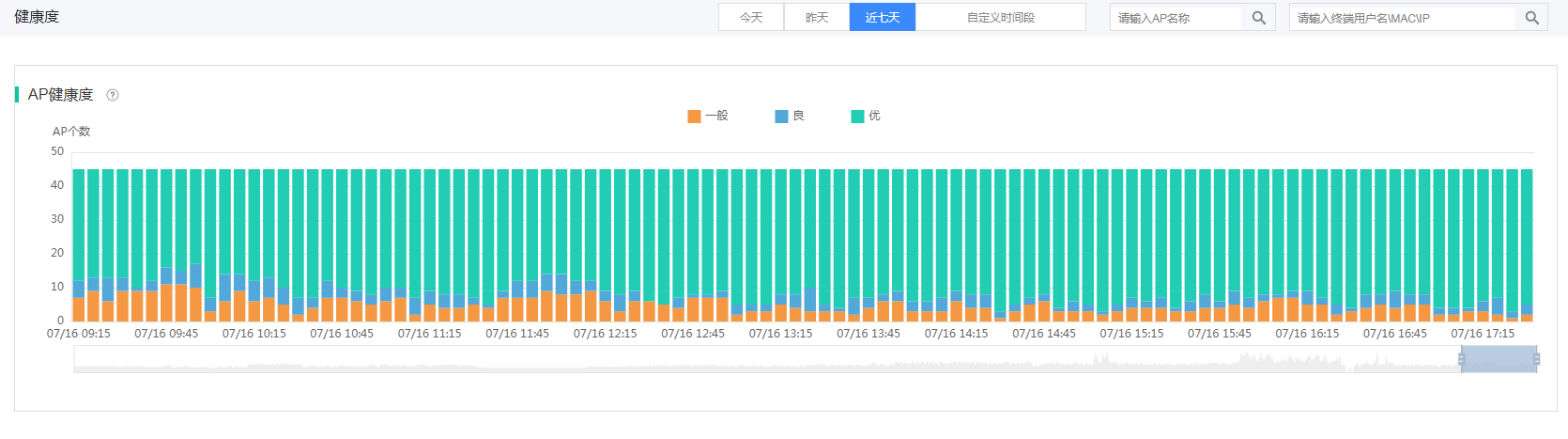

3. (Optional.) Connect the AC to the Cloudnet platform to view AP and client statistics.
# View the health status of clients to identify whether the number of clients with a health score of excellent and good has increased.
Figure 2 Client health status
# View the health status of APs to identify whether the number of APs with a health score of excellent and good has increased.
Figure 3 AP health status
