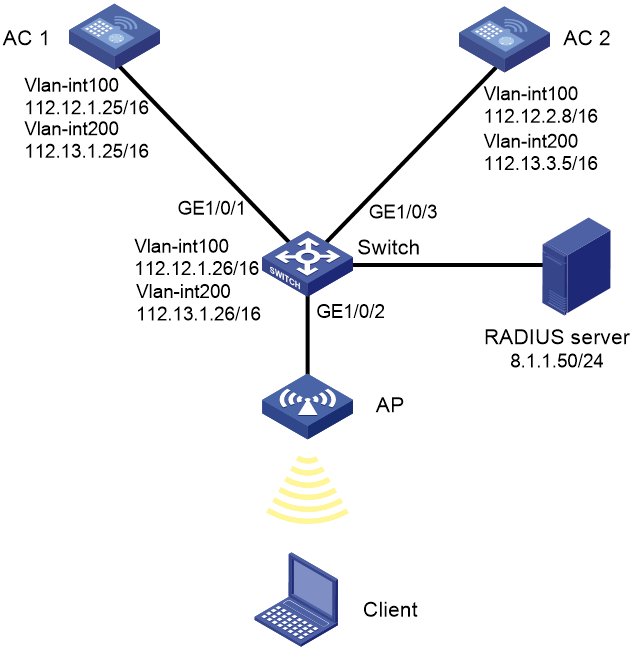

As shown in Figure 1, the AP and the client obtain IP addresses from the DHCP server. The IMC server acts as a portal authentication server, a portal Web server, a MAC binding server, and a RADIUS server.
Configure the devices to meet the following requirements:
· The AC provides direct portal authentication for the client. Before passing the authentication, the client can access only the portal Web server. After passing the authentication, the client can access other network resources. If the client goes offline and then attempts to come online again, the client does not need to enter the username and password.
· The client can visit resources in the external network without authentication when the amount of its traffic is less than 1024000 bytes. When the amount of the client's traffic reaches 1024000 bytes, the AC triggers portal MAC-based quick authentication for the client.
· The client can access network resources through any Layer 2 ports in its access VLAN without re-authentication.
· After the AP is disconnected from the AC, the client can access the network without authentication.
· The RADIUS server can dynamically change user authorization information or forcibly disconnect users.
· The AP forwards the client traffic locally.

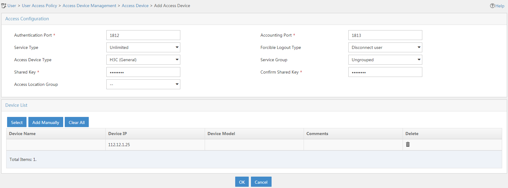

Add the AC to IMC as an access device:
1. Log in to IMC and click the User tab.
2. From the navigation tree, select User Access Policy > Access Device Management > Access Device.
3. Click Add to open the page as shown in Figure 2.
4. In the Access Configuration area, configure the parameters as follows:
¡ Set the shared key to radius, which must be the same as that on the AC.
¡ Use the default values for other parameters.
5. In the Device List area, click Add Manually to open the Add Access Device Manually page. Enter 2.2.2.1 in the Start IP field and then click OK.
6. Click OK.
Figure 2 Adding the AC as an access device

3. Add a portal device:
a. From the navigation tree, select User Access Policy > Portal Service > Device.
b. Click Add to open the page as shown in Figure 5.
c. Enter the device name.
d. Select CMCC 1.0 for Version.
e. Enter the IP address of the AC's interface connected to the client.
f. Set whether to support the portal server heartbeat and user heartbeat functions.
In this example, select No for both Support Server Heartbeat and Support User Heartbeat.
g. Enter the key, which must be the same as that configured on the AC.
h. Select Directly Connected for Access Method.
i. Use the default settings for other parameters.
j. Click OK.
Figure 5 Adding a portal device

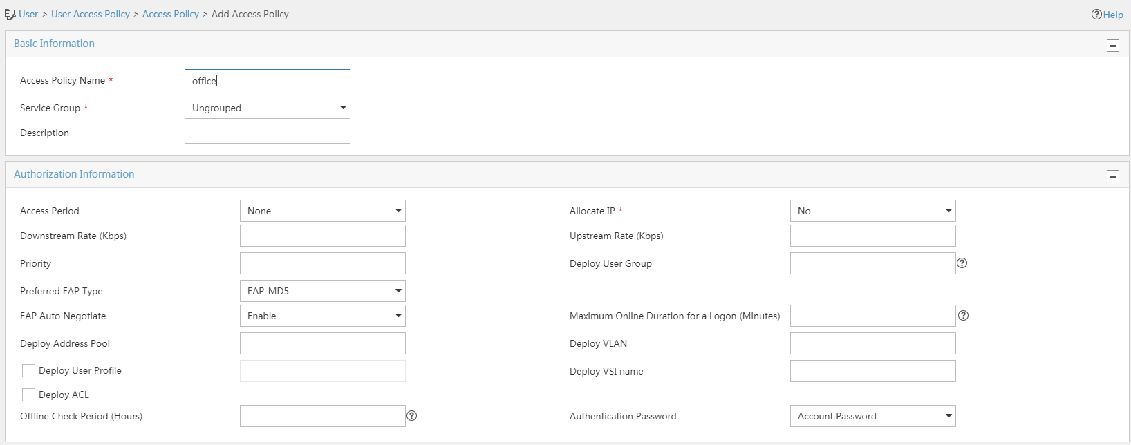

1. Add an access policy:
a. From the navigation tree, select User Access Policy > Access Policy.
b. Click Add to open the page as shown in Figure 8.
c. Enter the access policy name.
d. Select a service group.
This example uses the default value Ungrouped.
e. Use the default settings for other parameters.
f. Click OK.
Figure 8 Adding an access policy

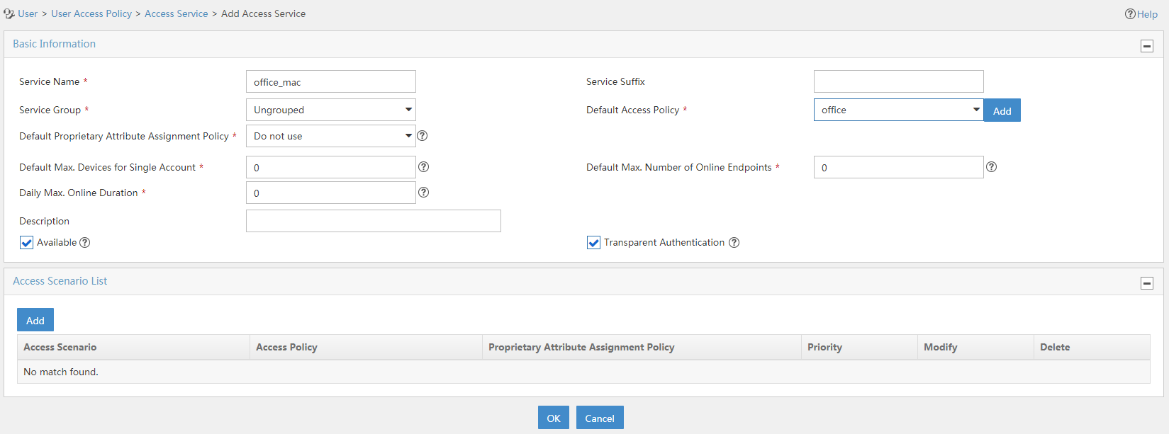

2. Add an access service:
a. From the navigation tree, select User Access Policy > Access Service.
b. Click Add to open the page as shown in Figure 9.
c. Enter the service name.
d. Select the Transparent Authentication on Portal Endpoints option.
f. Click OK.
Figure 9 Adding an access service

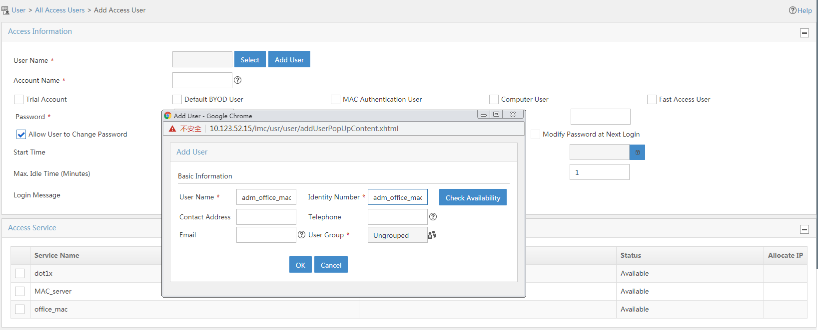

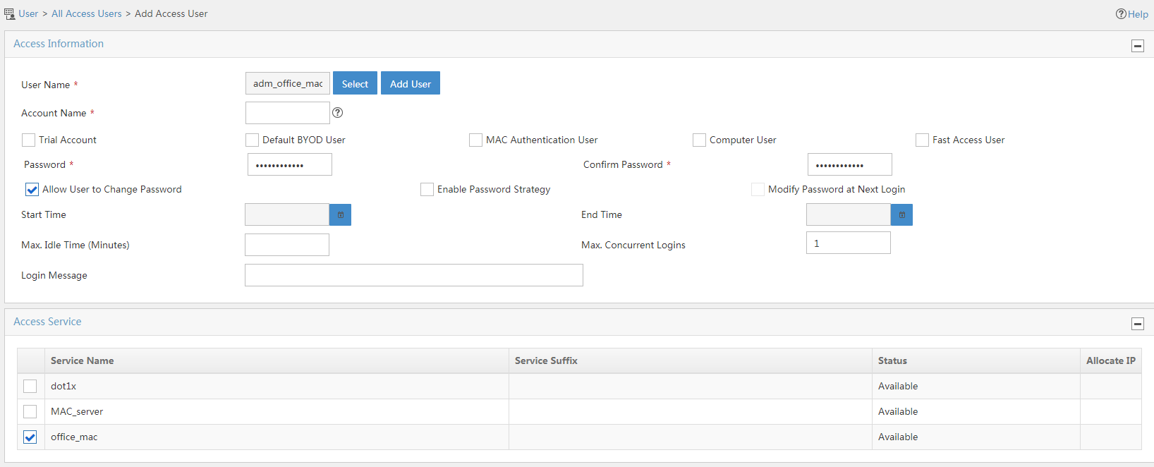

3. Add an access user:
a. From the navigation tree, select Access User > Access User.
b. Click Add to open the page as shown in Figure 10.
c. Select an existing access user or click Add User to add a new access user.
d. Enter the account name.
e. Set the password.
f. Select access service MAC_server.
g. Use the default settings for other parameters.
h. Click OK.
Figure 10 Adding an access user

1. Configure interfaces on the AC:
# Create VLAN 100 and VLAN-interface 100, and assign an IP address to the VLAN interface. The AC will use this IP address to establish a CAPWAP tunnel with the AP.
<AC> system-view
[AC] vlan 100
[AC-vlan100] quit
[AC] interface vlan-interface 100
[AC-Vlan-interface100] ip address 2.2.1.1 24
[AC-Vlan-interface100] quit
# Create VLAN 200 and VLAN-interface 200, and assign an IP address to the VLAN interface. The AC will use VLAN 200 for client access.
[AC] vlan 200
[AC-vlan200] quit
[AC] interface vlan-interface 200
[AC-Vlan-interface200] ip address 2.2.2.1 24
[AC-Vlan-interface200] quit
# Configure GigabitEthernet 1/0/1 (the port connected to the switch) as a trunk port and assign the port to VLANs 100 and 200.
[AC] interface gigabitethernet 1/0/1
[AC-GigabitEthernet1/0/1] port link-type trunk
[AC-GigabitEthernet1/0/1] port trunk permit vlan 100 200
[AC-GigabitEthernet1/0/1] quit

Configuring the switch
# Create VLAN 100. The switch will use this VLAN to forward traffic on the CAPWAP tunnel between the AC and the AP.
<Switch> system-view
[Switch] vlan 100
[Switch-vlan100] quit
# Create VLAN 200. The switch will use this VLAN to forward client traffic.
[Switch] vlan 200
[Switch-vlan200] quit
# Create VLAN 2. The switch will use this VLAN to connect to the IMC server.
[Switch] vlan 2
[Switch-vlan2] quit
# Configure GigabitEthernet 1/0/1(the port connected to the AC) as a trunk port and assign the port to VLAN 100 and VLAN 200.
[Switch] interface gigabitethernet 1/0/1
[Switch-GigabitEthernet1/0/1] port link-type trunk
[Switch-GigabitEthernet1/0/1] port trunk permit vlan 100 200
[Switch-GigabitEthernet1/0/1] quit
# Configure GigabitEthernet 1/0/2 (the port connected to the AP) as a trunk port and assign the port to VLAN 100 and VLAN 200. Set the PVID of the port to VLAN 100.
[Switch] interface gigabitethernet 1/0/2
[Switch-GigabitEthernet1/0/2] port link-type trunk
[Switch-GigabitEthernet1/0/2] port trunk permit vlan 100 200
[Switch-GigabitEthernet1/0/2] port trunk pvid vlan 100
# Enable PoE on GigabitEthernet 1/0/2.
[Switch-GigabitEthernet1/0/2] poe enable
[Switch-GigabitEthernet1/0/2] quit
# Configure GigabitEthernet 1/0/3 (the port connected to the IMC server) as an access port and assign the access port to VLAN 2.
[Switch] interface gigabitethernet 1/0/3
[Switch-GigabitEthernet1/0/3] port link-type access
[Switch-GigabitEthernet1/0/3] port access vlan 2
[Switch-GigabitEthernet1/0/3] quit
# Assign an IP address to VLAN-interface 200.
[Switch] interface vlan-interface 200
[Switch-Vlan-interface200] ip address 2.2.2.100 255.255.255.0
[Switch-Vlan-interface200] quit
# Assign an IP address to VLAN-interface 2.
[Switch-Vlan-interface2] ip address 192.168.0.100 255.255.255.0
[Switch-Vlan-interface2] quit
