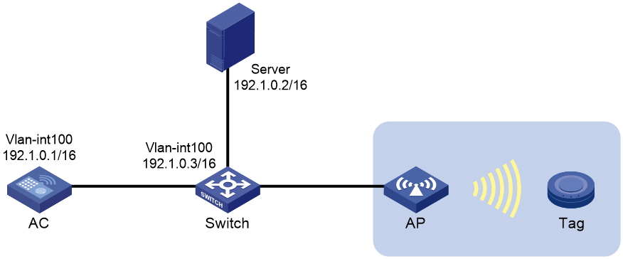

As shown in Figure 1, configure the AP to collect medical RFID tag information and send the information to the location server for calculation. Then, users can obtain tag information in various forms such as maps, tables, or reports.
Figure 1 Network diagram
When you configure medical RFID tag management, follow these restrictions and guidelines:
·     Use the actual serial ID of an AP to uniquely identify that AP.
·     The port number of the location server configured on the AC must be the same as the port number specified on the location server.
