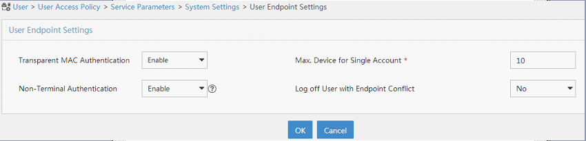

d. Select the Transparent Authentication on Portal Endpoints option.
e. Use the default settings for other parameters.
f. Click OK.

5. From the navigation tree, select User Access Policy > Service Parameters > Validate System Configuration to make the configuration take effect.
6. Configure system parameters:
a. From the navigation tree, select User Access Policy > Service Parameters > System Settings.
b. Click the Configure
icon
for User Endpoint Settings to open the
page as shown in Figure 11.
c. Select Enable for Transparent MAC Authentication.
d. Select whether to enable transparent portal authentication on non-smart devices.
In this example, select Enable for Non-Terminal Authentication.
e. Click OK.
Figure 11 Configuring user endpoint settings
