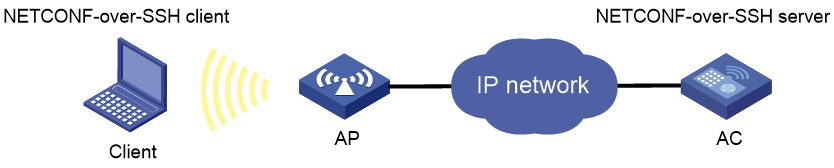

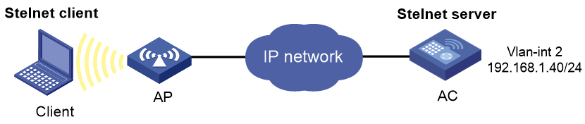

As shown in Figure 1:
· The route between the wireless client and the AC is reachable.
· The AC acts as the Stelnet server and uses password authentication to authenticate the Stelnet client. The username and password of the Stelnet client are saved on the AC.
· The wireless client acts as the Stelnet client, using Stelnet client software (SSH2). After the user on the wireless client logs in to the AC through Stelnet, the user can configure and manage the AC as a network administrator.

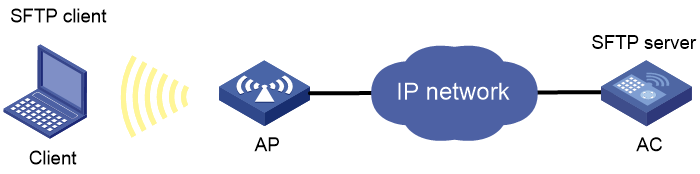

As shown in Figure 3:
· The AC acts as the Stelnet server, and it uses publickey authentication and the RSA public key algorithm.

Example: Configuring the AC as an Stelnet client (password authentication)
As shown in Figure 11:
· The switch acts as the Stelnet server and uses password authentication to authenticate the Stelnet client. The username and password of the client are saved on the switch.
· The AC acts as the Stelnet client. After the user on the AC logs in to the switch through Stelnet, the user can configure and manage the switch as a network administrator.

Example: Configuring the AC as an Stelnet client (publickey authentication)
As shown in Figure 12:
· The switch acts as the Stelnet server, and it uses publickey authentication and the DSA public key algorithm.

Example: Configuring the AC as an SFTP server (password authentication)
As shown in Figure 13:
· The AC acts as the SFTP server and uses password authentication to authenticate the SFTP client. The username and password of the client are saved on the AC.
· The wireless client acts as the SFTP client. After the user on the client logs in to the AC through SFTP, the user can perform file management and transfer operations on the AC as a network administrator.

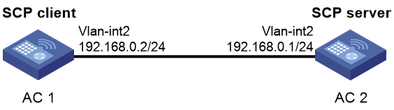

Example: Configuring the AC as an SFTP client (publickey authentication)
As shown in Figure 15:
· AC 2 acts as the SFTP server, and it uses publickey authentication and the RSA public key algorithm.
· AC 1 acts as the SFTP client. After the user on AC 1 logs in to AC 2 through SFTP, the user can perform file management and transfer operations on AC 2 as a network administrator.
Analysis
Because the client's host public key is required in the server configuration, you must generate RSA key pairs on the client before configuring the SFTP server.
Procedures

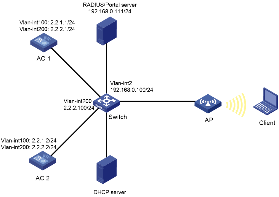

Example: Configuring NETCONF over SSH with password authentication
As shown in Figure 17:
· The AC acts as the NETCONF-over-SSH server and uses password authentication to authenticate the client. The client's username and password are saved on the AC.
· The wireless client acts as the NETCONF-over-SSH client, using SSH2 client software. After the user on the wireless client logs in to the AC through NETCONF over SSH, the user can perform NETCONF operations on the AC as a network administrator.

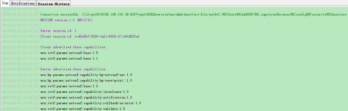

1. Launch a client that supports NETCONF over SSH.
This example uses NetConf Browser 2015 (version 3.1).
2. Select File > Connect… from the menu.

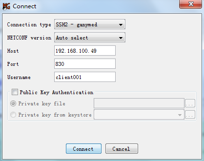

The Connect page opens, as shown in Figure 18.
3. Configure connection parameters as follows:
a. Select a connection type from the Connection type list.
This example uses SSH2-ganymed.
b. Select Auto select from the NETCONF version list.
c. Enter 192.168.100.49 in the Host field.
d. Enter 830 in the Port field.
e. Enter client001 in the Username field.
f. Use the default setting for the Public Key Authentication area.
4. Click Connect.
Figure 18 Connecting to the device
5. Enter password aabbcc, and then click OK, as shown in Figure 19.
Figure 19 Entering the password
The NETCONF configuration interface opens when the client successfully establishes an NETCONF-over-SSH connection to the device. The Log tab of the interface displays the connection information, as shown in Figure 20.
Figure 20 Logging in to the device
6. Verify that you have obtained the permissions of the network-admin user role:
