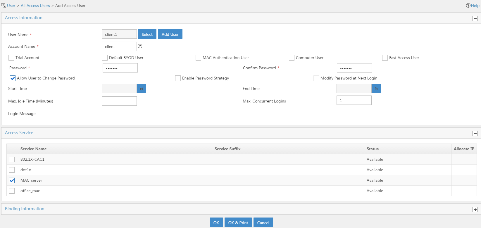

Add the AC to IMC as an access device:
1. Log in to IMC and click the User tab.
2. From the navigation tree, select User Access Policy > Access Device Management > Access Device.
3. Click Add to open the page as shown in Figure 2.
4. In the Access Configuration area, configure the parameters as follows:
¡ Set the shared key to radius, which must be the same as that on the AC.
¡ Use the default values for other parameters.
5. In the Device List area, click Add Manually to open the Add Access Device Manually page. Enter 2.2.2.1 in the Start IP field and then click OK.
6. Click OK.

3. Add an access user:
a. From the navigation tree, select Access User > All Access Users.
b. Click Add to open the page as shown in Figure 10.
c. Select an existing access user or click Add User to add a new access user.
d. Enter the account name.
e. Set the password.
f. In the Access Service area, select the access policy configured in a previous step.
g. Use the default settings for other parameters.
h. Click OK.
Figure 10 Adding an access user
