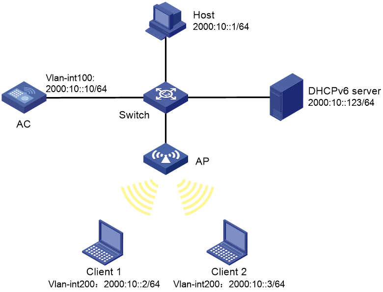

As shown in Figure 1, install AP licenses on the AC for the AC to manage the AP and for the AP to provide wireless services to the client.
· Purchase licenses from H3C authorized channels.
· To identify the validity periods of the licenses that have been installed on the device, execute the display license command. If the license for a feature is time limited, install a new license for the feature before the old license expires.
· When you operate DID files or activation files, follow these restrictions and guidelines:
¡ To avoid licensing error, do not modify the file name or edit the file content.
¡ Before you install an activation file, download the activation file to the storage media of the device such as flash memory. When installing an activation file, the device automatically copies the activation file to the license folder in the root directory of the storage media. The license folder stores important files for licensing. For licensed features to function correctly, do not delete or modify the license folder or the files in this folder.

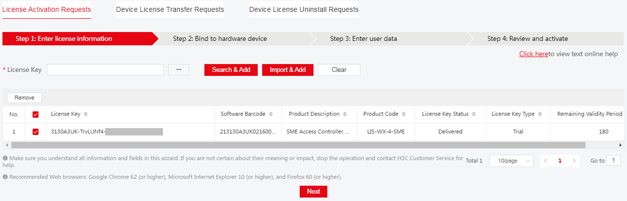

2. On the License Activation Requests tab, add license keys.
Figure 3 Adding license keys
3. Select license keys to be activated, and then click Next.

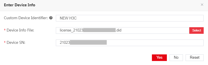

1. Click the
icon next to the empty Device ID box in the license key entry. In the dialog box that opens, enter the
required device information, and then click OK.
For information about how to obtain device information, see "Obtaining device information from the AC."

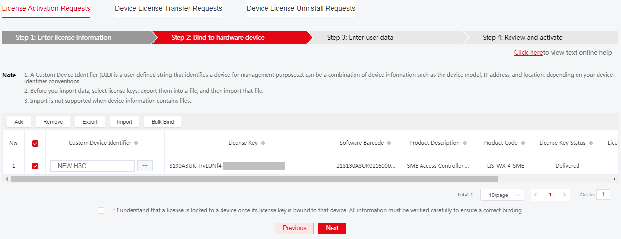

2. Review the bindings carefully. Make sure you understand the impact of the binding operation, and then select the option that explicitly states so.
Figure 5 Reviewing the bindings
3. Click Next.

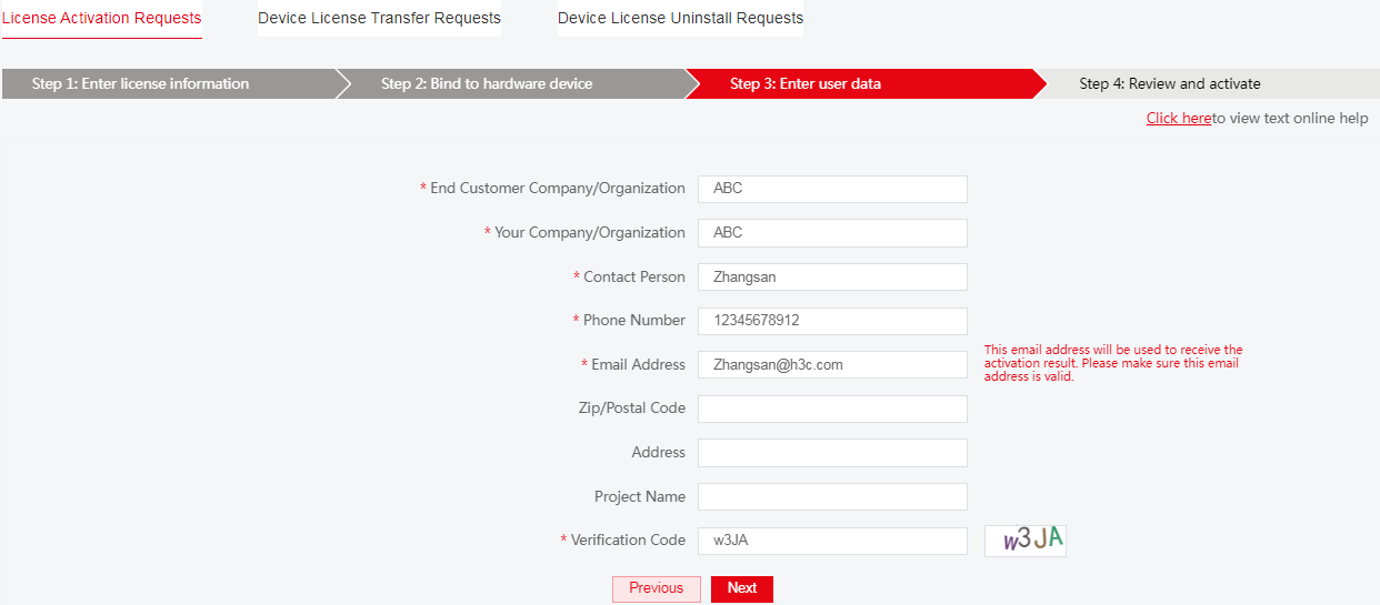

Enter customer information, and then click Next.

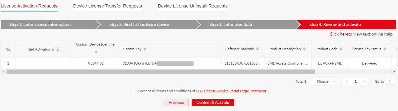

Reviewing information and activating the licenses
1. Review the license key and device information and then select I accept all terms of H3C Legal Statement.
2. Click Confirm & Activate.
Figure 7 Confirming and activating the licenses

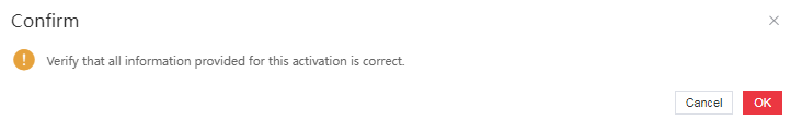

3. Double-check the license key and device information, and then click OK.
Figure 8 Confirming information

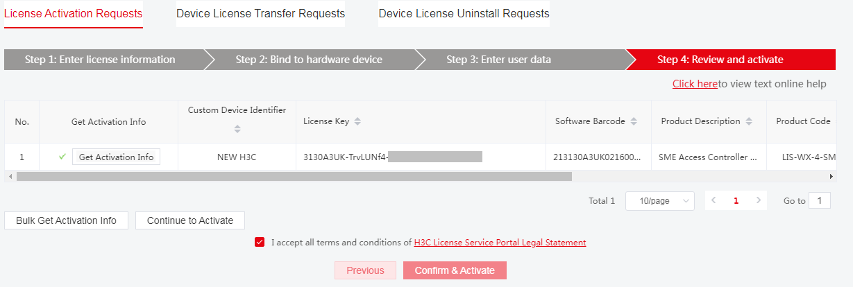

4. Click Get Activation Info to download an activation file to the local disk.
Figure 9 Obtaining activation information
