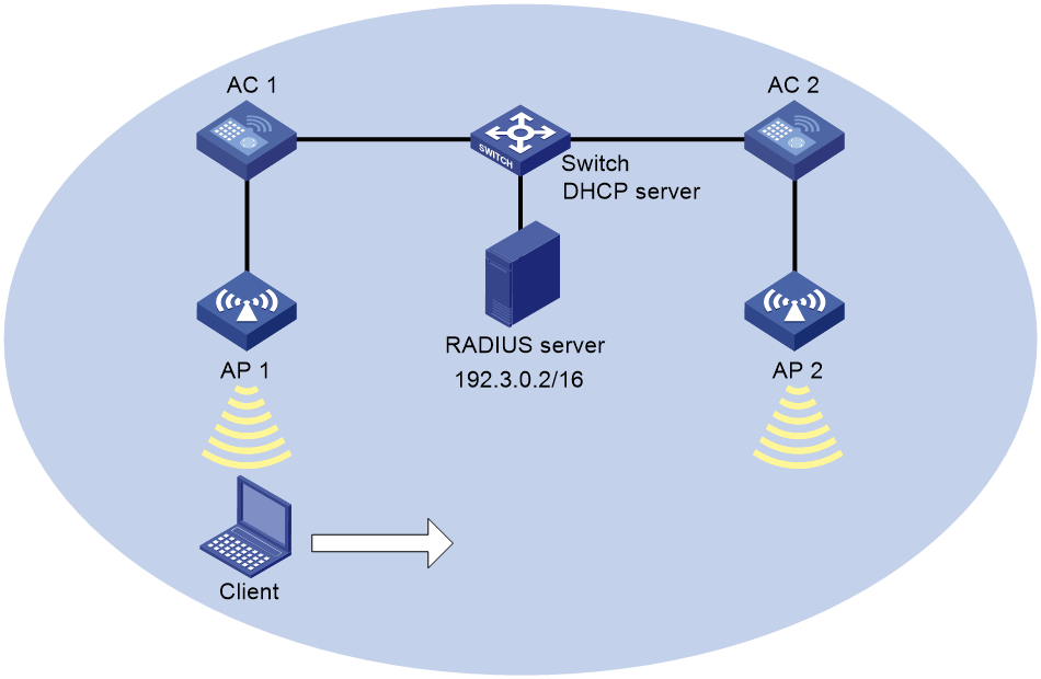

Network requirements
As shown in Figure 1, AP 1 and AP 2 are managed by AC 1 and AC 2, respectively. Clients associated with AC 1 belong to VLAN 200. Clients associated with AC 2 belong to VLAN 400.
Complete the following tasks:
·     Configure inter-AC roaming to enable clients to roam between AP 1 and AP 2.
·     Configure VLAN-based user isolation to improve user security and reduce radio resources consumption caused by multicast and broadcast packets.
Figure 1 Network diagram

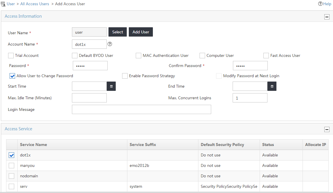

2.     Configure 802.1X authentication:
# Set the EAP message handling method to EAP.
[AC1] dot1x authentication-method eap

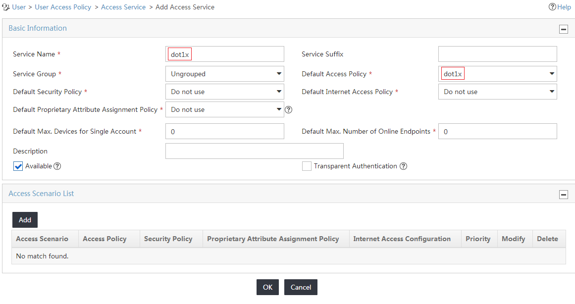

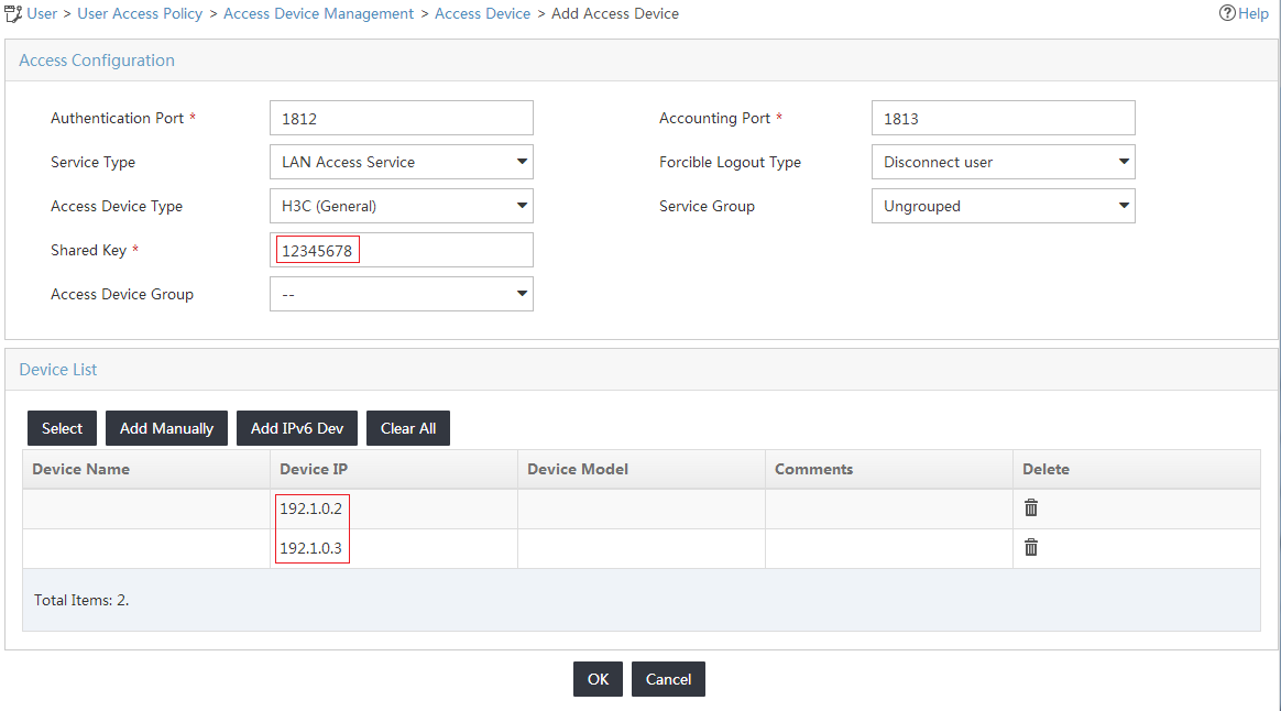

# Create a RADIUS scheme named office and enter its view.
[AC1] radius scheme office
# Specify the server at 192.3.0.2 as the primary authentication server.
[AC1-radius-office] primary authentication 192.3.0.2
# Specify the server at 192.3.0.2 as the primary accounting server.
[AC1-radius-office] primary accounting 192.3.0.2
# Set the shared key to 12345678 for secure communication with the primary authentication server and accounting server.
[AC1-radius-office] key authentication simple 12345678
[AC1-radius-office] key accounting simple 12345678
# Set the source IP address to 192.1.0.2 for outgoing RADIUS packets.
[AC1-radius-office] nas-ip 192.1.0.2
[AC1-radius-office] quit
# Create an ISP domain named office and enter its view.
[AC1] domain office
# Configure the ISP domain to use RADIUS scheme office for authentication, authorization, and accounting of LAN users.
[AC1-isp-office] authentication lan-access radius-scheme office
[AC1-isp-office] authorization lan-access radius-scheme office
[AC1-isp-office] accounting lan-access radius-scheme office
[AC1-isp-office] quit

1.     Add the ACs to the IMC Platform as access devices:
a.     Log in to IMC.
b.     Click the User tab.
c.     From the navigation tree, select User Access Policy > Access Device Management > Access Device.
d.     Click Add to add AC 1 as an access device.
e.     Configure the following parameters:
-     Enter 192.1.0.2 for AC 1 and 192.1.0.3 for AC 2 in the Device IP field.
-     Enter 12345678 in the Shared Key field.
-     Use the default settings for other parameters.
f.     Click OK.
g.     Use the same procedure to add AC 2 as an access device.
Figure 2 Adding an access device

3.     Add an access service:
a.     Click the User tab.
b.     From the navigation tree, select User Access Policy > Access Service.
c.     Click Add to add an access service that uses the following settings:
-     Service Name—dot1x.
-     Default Access Policy—dot1x.
Figure 4 Adding an access service
4.     Add an access user:
b.     From the navigation tree, select All Access Users.
c.     Click Add to add an access user that uses the following settings:
-     User Name—user.
-     Account Name—dot1x.
-     Password—dot1x.
d.     Select the dot1x service for the user.
Figure 5 Adding an access user
