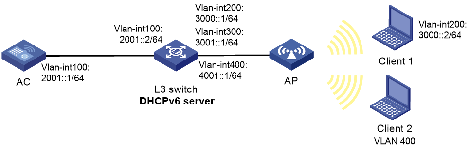

As shown in Figure 1, the Layer 3 switch acts as a DHCP server to assign IPv6 addresses to the AP and Client 1 and assign an IPv6 prefix to Client 2. Configure wireless services to ensure that the WLAN uses IPv6 addresses and Client 1 and Client 2 can access the WLAN. Assume that centralized forwarding is used in this example.
Figure 1 Network diagram

1.     Configure the interfaces of the AC:
# Create VLAN 100 and VLAN-interface 100, and assign the interface an IPv6 address. The AC will use this IPv6 address to establish a CAPWAP tunnel with the AP.
<AC> system-view
[AC] vlan 100
[AC-vlan100] quit
[AC] interface vlan-interface 100
[AC-Vlan-interface100] ipv6 address 2001::1 64
[AC-Vlan-interface100] quit
# Create VLAN 200 and VLAN 400. The AC uses the VLANs to forward client traffic.
[AC] vlan 200
[AC-vlan200] quit
[AC] vlan 400
[AC-vlan400] quit
# Configure GigabitEthernet 1/0/1 that connects the AC to the switch as a trunk port, remove the port from VLAN 1, and assign the port to VLANs 100, 200, and 400.
[AC] interface gigabitethernet 1/0/1
[AC-GigabitEthernet1/0/1] port link-type trunk
[AC-GigabitEthernet1/0/1] undo port trunk permit vlan 1
[AC-GigabitEthernet1/0/1] port trunk permit vlan 100 200 400
[AC-GigabitEthernet1/0/1] quit
2.     Configure IPv6 static routes.
[AC] ipv6 route-static 3001::0 64 2001::2
[AC] ipv6 route-static 4001::0 64 2001::2
3.     Configure wireless services:
# Create service template 1 and enter its view.
[AC] wlan service-template 1
# Set the SSID to service1.
[AC-wlan-st-1] ssid service1
# Specify PSK as the AKM mode and specify 12345678 as the plaintext key.
[AC-wlan-st-1] akm mode psk
[AC-wlan-st-1] preshared-key pass-phrase simple 12345678
# Specify CCMP as the cipher suite and specify RSN as the security IE.
[AC-wlan-st-1] cipher-suite ccmp
[AC-wlan-st-1] security-ie rsn
# Configure the AC to forward client data traffic. If the default client data traffic forwarder is AC, skip this step.
[AC-wlan-st-1] client forwarding-location ac
# Enable service template 1.
[AC-wlan-st-1] service-template enable
# Enable snooping DHCPv6 and ND packets.
[AC-wlan-st-2] client ipv6-snooping dhcpv6-learning enable
[AC-wlan-st-2] client ipv6-snooping nd-learning enable
[AC-wlan-st-2] quit
# Create service template 2 and enter its view.
[AC] wlan service-template 2
# Set the SSID to service2.
[AC-wlan-st-2] ssid service2
[AC-wlan-st-2] akm mode psk
[AC-wlan-st-2] preshared-key pass-phrase simple 12345678
[AC-wlan-st-2] cipher-suite ccmp
[AC-wlan-st-2] security-ie rsn
[AC-wlan-st-2] client forwarding-location ac
# Enable service template 2.
[AC-wlan-st-2] service-template enable
[AC-wlan-st-2] quit
4.     Configure AP settings:
To simply AP configuration on a large-scale network, configure AP settings on a per AP group basis as a best practice.
# Create manual AP officeap, and specify the AP model and serial ID.
[AC] wlan ap officeap model WA6320
[AC-wlan-ap-officeap] serial-id 219801A28N819CE0002T
# Create AP group group1 and configure officeap as the AP grouping rule.
[AC] wlan ap-group group1
[AC-wlan-ap-group-group1] ap officeap
# Bind service template 1 and VLAN 200 to radio 1 for AP group group1.
[AC-wlan-ap-group-group1] ap-model WA6320
[AC-wlan-ap-group-group1-ap-model-WA6320] radio 1
[AC-wlan-ap-group-group1-ap-model-WA6320-radio-1] service-template 1 vlan 200
# Enable radio 1.
[AC-wlan-ap-group-group1-ap-model-WA6320-radio-1] radio enable
[AC-wlan-ap-group-group1-ap-model-WA6320-radio-1] quit
# Bind service template 2 and VLAN 400 to radio 2 for AP group group1.
[AC-wlan-ap-group-group1-ap-model-WA6320] radio 2
[AC-wlan-ap-group-group1-ap-model-WA6320-radio-2] service-template 2 vlan 400
# Enable radio 2.
[AC-wlan-ap-group-group1-ap-model-WA6320-radio-2] radio enable
[AC-wlan-ap-group-group1-ap-model-WA6320-radio-2] return
Configuring the switch
1.     Configure switch interfaces:
# Create VLAN 100, VLAN 300, VLAN-interface 100, and VLAN-interface 300, and assign IPv6 addresses to the VLAN interfaces. The switch will use VLAN 100 and VLAN 300 to forward packets between AC and AP.
<L3 switch> system-view
[L3 switch] vlan 100
[L3 switch-vlan100] quit
[L3 switch] interface vlan-interface 100
[L3 switch-Vlan-interface100] ipv6 address 2001::2/64
[L3 switch-Vlan-interface100] quit
[L3 switch] vlan 300
[L3 switch-vlan300] quit
[L3 switch] interface vlan-interface 300
[L3 switch-Vlan-interface300] ipv6 address 3001::1/64
[L3 switch-Vlan-interface300] quit
# Create VLAN 200 and VLAN-interface 200 and assign an IPv6 address to the VLAN interface. Client 1 will use this VLAN to access the WLAN.
[L3 switch] vlan 200
[L3 switch-vlan200] quit
[L3 switch] interface vlan-interface 200
[L3 switch-Vlan-interface200] ipv6 address 3000::1/64
[L3 switch-Vlan-interface200] quit
# Create VLAN 400 and VLAN-interface 400 and assign an IPv6 address to the VLAN interface. Client 2 will use this VLAN to access the WLAN.
[L3 switch] vlan 400
[L3 switch-vlan400] quit
[L3 switch] interface vlan-interface 400
[L3 switch-Vlan-interface400] ipv6 address 4000::1/64
[L3 switch-Vlan-interface400] quit
# Configure GigabitEthernet 1/0/1 that connects the switch to the AC as a trunk port, remove the port from VLAN 1, and assign the port to VLANs 100, 200, and 400.
[L3 Switch] interface gigabitethernet 1/0/1
[L3 Switch-GigabitEthernet1/0/1] port link-type trunk
[L3 switch-GigabitEthernet1/0/2] undo port trunk permit vlan 1
[L3 Switch-GigabitEthernet1/0/1] port trunk permit vlan 100 200 400
[L3 Switch-GigabitEthernet1/0/1] quit
# Configure GigabitEthernet 1/0/2 that connects the switch to the AP as a trunk port, remove the port from VLAN 1, configure the PVID as VLAN 300, and assign the port to VLANs 300.
[L3 switch] interface gigabitEthernet 1/0/2
[L3 switch-GigabitEthernet1/0/2] port link-type trunk
[L3 switch-GigabitEthernet1/0/2] port trunk permit vlan 300
[L3 switch-GigabitEthernet1/0/2] port trunk pvid vlan 300
[L3 switch-GigabitEthernet1/0/2] quit
2.     Configure DHCPv6:
# Enable the DHCPv6 server on VLAN-interface 200, VLAN-interface 300, and VLAN-interface 400, respectively.
[L3 switch-Vlan-interface200] ipv6 dhcp select server
[L3 switch-Vlan-interface300] ipv6 dhcp select server
[L3 switch-Vlan-interface400] ipv6 dhcp select server
# Disable RA message suppression, set both the managed address configuration flag (M) and the other stateful configuration flag (O) to 1 in RA advertisements to be sent for the created VLAN interfaces.
[L3 switch-Vlan-interface200] undo ipv6 nd ra halt
[L3 switch-Vlan-interface200] ipv6 nd autoconfig managed-address-flag
[L3 switch-Vlan-interface200] ipv6 nd autoconfig other-flag
[L3 switch-Vlan-interface300] undo ipv6 nd ra halt
[L3 switch-Vlan-interface300] ipv6 nd autoconfig managed-address-flag
[L3 switch-Vlan-interface300] ipv6 nd autoconfig other-flag
[L3 switch-Vlan-interface400] undo ipv6 nd ra halt
[L3 switch-Vlan-interface400] ipv6 nd autoconfig managed-address-flag
[L3 switch-Vlan-interface400] ipv6 nd autoconfig other-flag
# Create DHCPv6 address pool 1 to assign an IPv6 address to Client 1, and specify subnet 3000::0/64 in the DHCP address pool.
[L3 switch] ipv6 dhcp pool 1
[L3 switch-dhcp6-pool-1] network 3000::0/64
[L3 switch-dhcp6-pool-1] gateway-list 3000::1
[L3 switch-dhcp6-pool-1] quit
# Create DHCPv6 address pool 2 to assign an IPv6 address to the AP, specify subnet 3001::0/64 in the DHCP address pool, and configure Option 52 that specifies AC IPv6 address 2001:1 in the address pool.
[L3 switch] ipv6 dhcp pool 2
[L3 switch-dhcp6-pool-2] network 3001::0/64
[L3 switch-dhcp6-pool-2] gateway-list 3001::1
[L3 switch-dhcp6-pool-2] option 52 hex 20010000000000000001000000000001
[L3 switch-dhcp6-pool-2] quit
# Create a prefix pool and specify the prefix and the assigned prefix length for the pool.
[L3 switch] ipv6 dhcp prefix-pool 1 prefix 4001::/64 assign-len 64
# Create DHCPv6 address pool 3 to assign an IPv6 address to Client 2, and specify subnet 4001::0/64 in the DHCP address pool.
[L3 switch] ipv6 dhcp pool 3
[L3 switch-dhcp6-pool-3] network 4001::0/64
[L3 switch-dhcp6-pool-3] gateway-list 4001::1
# Apply prefix pool 1 to DHCPv6 address pool 3, so the DHCPv6 server can dynamically select a prefix from the prefix pool for a client.
[L3 switch-dhcp6-pool-3] prefix-pool 1
[L3 switch-dhcp6-pool-3] quit
# Verify that Client 1 and Client 2 have connected to the network successfully.
[AC] display wlan client ipv6
MAC address     AP name              IPv6 address                            VLAN
0000-000f-1211  officeap             3000::2                                 200
0000-000f-1212  officeap             4001::3                                 400

vlan 100
vlan 200
vlan 300
vlan 400
ipv6 dhcp pool 1
 network 3000::0/64
ipv6 dhcp pool 2
 network 3001::0/64
 option 52 hex 00010000000000000001000000000001
ipv6 dhcp pool 3
 network 4001::0/64
 prefix-pool 1
interface Vlan-interface100
interface Vlan-interface200
interface Vlan-interface300
interface Vlan-interface400
 ipv6 address 4001::1/64
