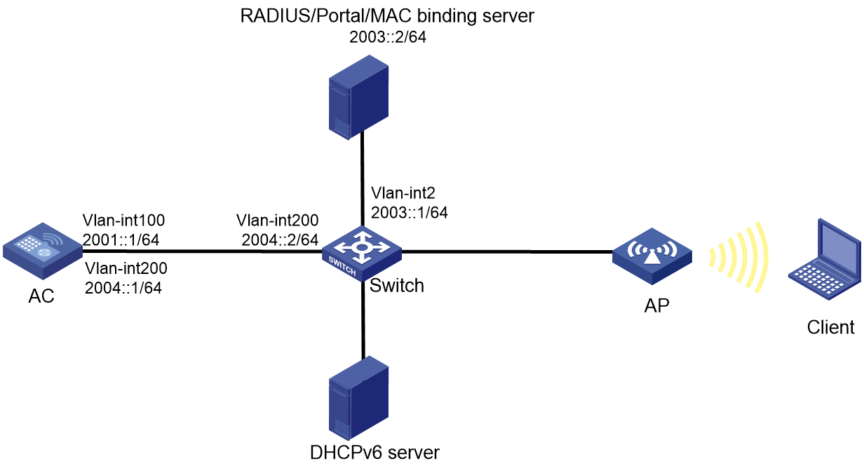

As shown in Figure 1:
· The AP and the client obtain IP addresses from the DHCP server.
· The network deploys an IMC server as the portal authentication server, portal Web server, and RADIUS server for portal authentication.
Configure the devices to meet the following requirements:
· The AC uses a service template to provide direct portal authentication for the client. Before passing the authentication, the client can access only the portal Web server. After passing the authentication, the client can access other network resources.
· The AP forwards the client traffic locally.
· The client can access network resources through any Layer 2 ports in its access VLAN without re-authentication.
· The RADIUS server can dynamically change user authorization information or forcibly disconnect users.

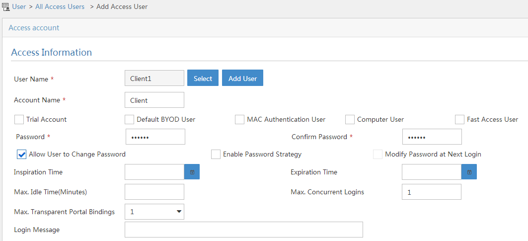

4. Add an access user:
a. From the navigation tree, select Access User > All Access Users to open the access user page.
b. Click Add to open the page as shown in Figure 5.
c. Set the user: If the user already exists, click Select to select the user. If the user does not exist, click Add User to add the user.
d. Set the password.
e. Use the default settings for other parameters.
f. Click OK.
Figure 5 Adding an access user

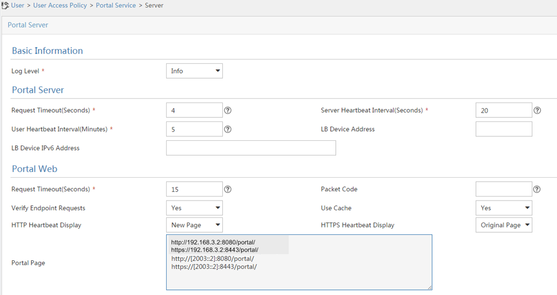

Configuring the portal server
1. Configure the portal service:
a. Log in to IMC and click the User tab.
b. From the navigation tree, select User Access Policy > Portal Service > Server to open the portal server configuration page as shown in Figure 6.
c. Configure the portal server parameters as needed.
This example uses the default settings.
d. Click OK.
Figure 6 Configuring the portal server

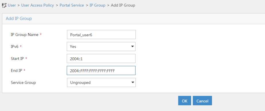

2. Configure an IP address group:
a. From the navigation tree, select User Access Policy > Portal Service > IP Group to open the portal IP address group configuration page.
b. Click Add to open the Add IP Group page as shown in Figure 7.
c. Enter the IP group name.
d. Enter the start IP address and end IP address of the IP group.
Make sure the client IP address is in the IP group.
e. Select a service group.
This example uses the default group Ungrouped.
f. Select Normal from the Action list.
g. Click OK.

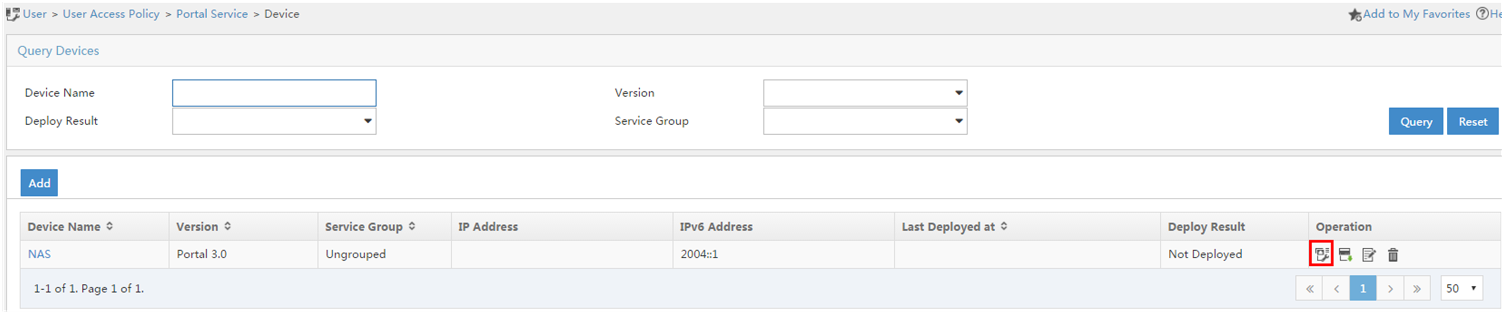

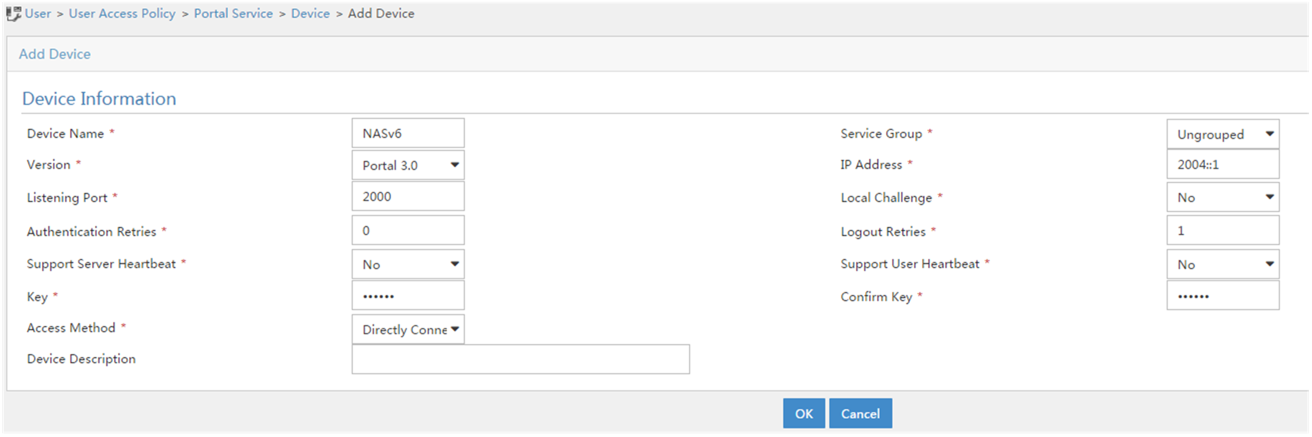

3. Add a portal device:
a. From the navigation tree, select User Access Policy > Portal Service > Device to open the portal device configuration page.
b. Click Add to open the page as shown in Figure 8.
c. Enter the device name.
d. Select CMCC 1.0 from the Version list.
e. Enter the IP address of the port through which the AC connects to the client in the IP Address field.
f. Set whether to support the portal server heartbeat and user heartbeat functions.
In this example, select No for both Support Server Heartbeat and Support User Heartbeat.
g. Enter the key, which must be the same as that configured on the AC.
h. Select Directly Connected from the Access Method list.
i. Use the default settings for other parameters.
j. Click OK.
Figure 89 Adding a portal device
