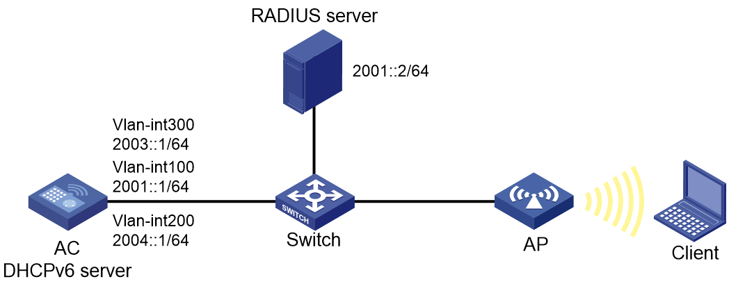

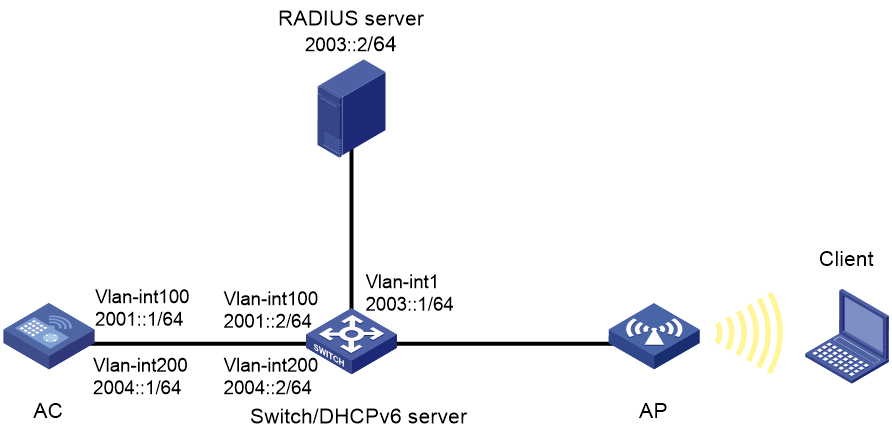

As shown in Figure 1, the AC acts as a DHCPv6 server to provide IPv6 addresses for the AP and its attached clients. The AC centrally forwards client traffic.
To control the access of clients to network resources:
· Configure VLAN 200 as the access VLAN of the clients.
· Use the AC with a RADIUS server to perform MAC authentication for the clients.
· Configure VLAN 300 as the guest VLAN in the service template for the clients. A client is moved to the guest VLAN if it fails authentication and will stay in the guest VLAN until it passes re-authentication, which is performed every 30 seconds.
When you configure MAC authentication for wireless clients, follow these restrictions and guidelines:
· Use the serial ID labeled on the AP's rear panel to specify an AP.
· To prevent too many packets from entering VLAN 1, configure the switch's interface that connects the switch to the AP to deny packets from VLAN 1.
· Some endpoints by default use random MAC addresses. To ensure successful MAC authentication for such an endpoint, disable the endpoint from using a random MAC address.

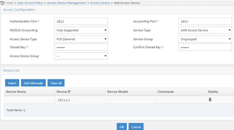

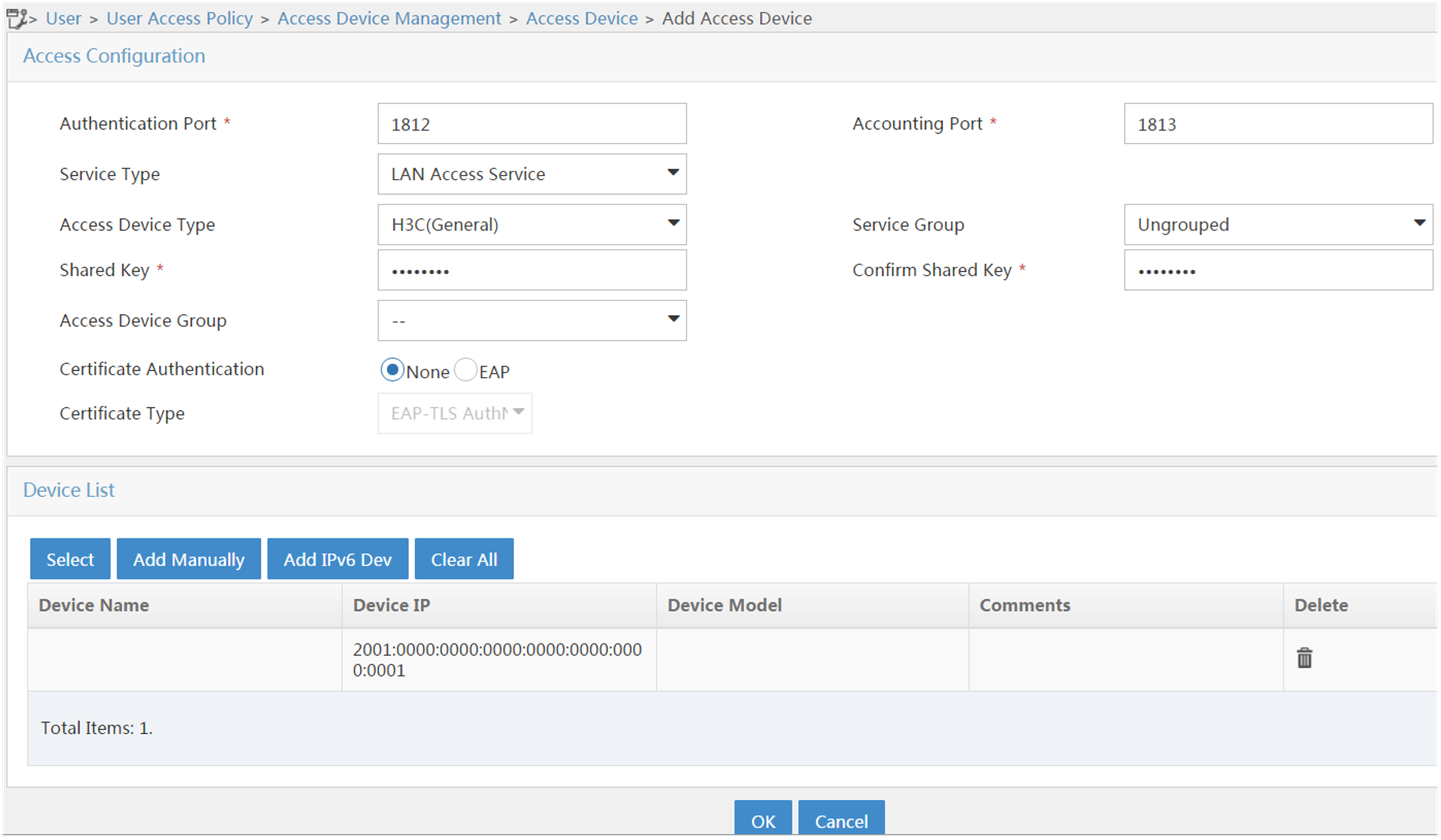

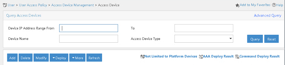

1. Add an access device:
a. Log in to IMC.
b. Click the User tab.
c. From the navigation tree, select User Access Policy > Access Device Management > Access Device.
d. Click Add.
The Add Access Device page opens.
e. In the Device List area, click Add IPv6 Dev.
f. Enter 2001::1 as the start IPv6 address, and then click OK.
This IPv6 address is the source IPv6 address specified on the AC for outgoing RADIUS packets.
g. In the Access Configuration area, configure the following parameters, as shown in Figure 2:
- Enter 123456789 in the Shared Key and Confirm Shared Key fields.
The key is consistent with the shared key configured on the AC.
- Use the default values for other parameters.
h. Click OK.
Figure 2 Adding an access device

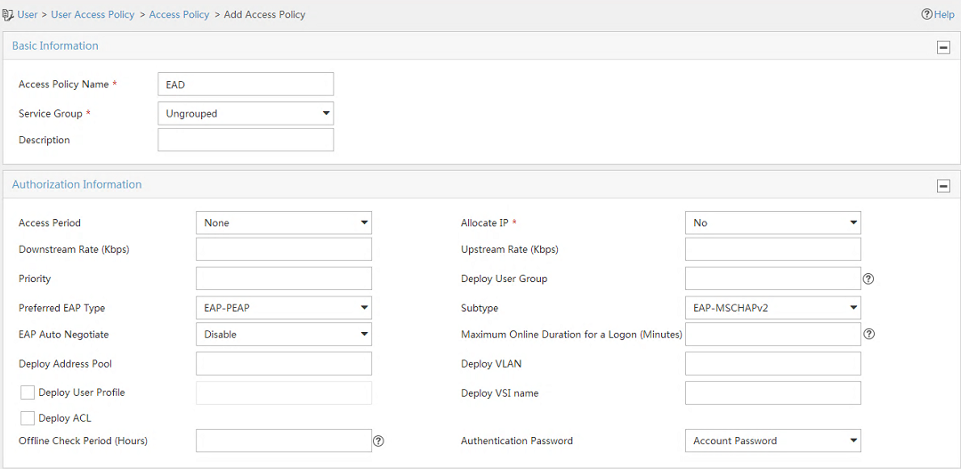

2. Add an access policy:
a. Click the User tab.
b. From the navigation tree, select User Access Policy > Access Policy.
c. Click Add.
d. On the Add Access Policy page, configure the following parameters, as shown in Figure 3:
- Enter office in the Access Policy Name field.
Figure 3 Adding an access policy

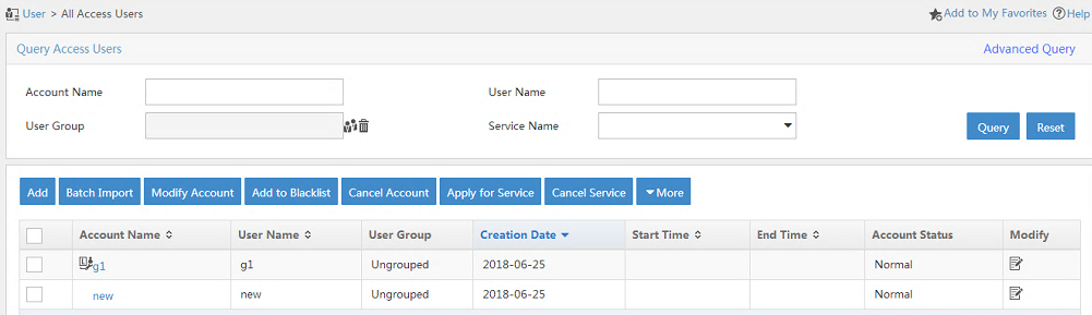

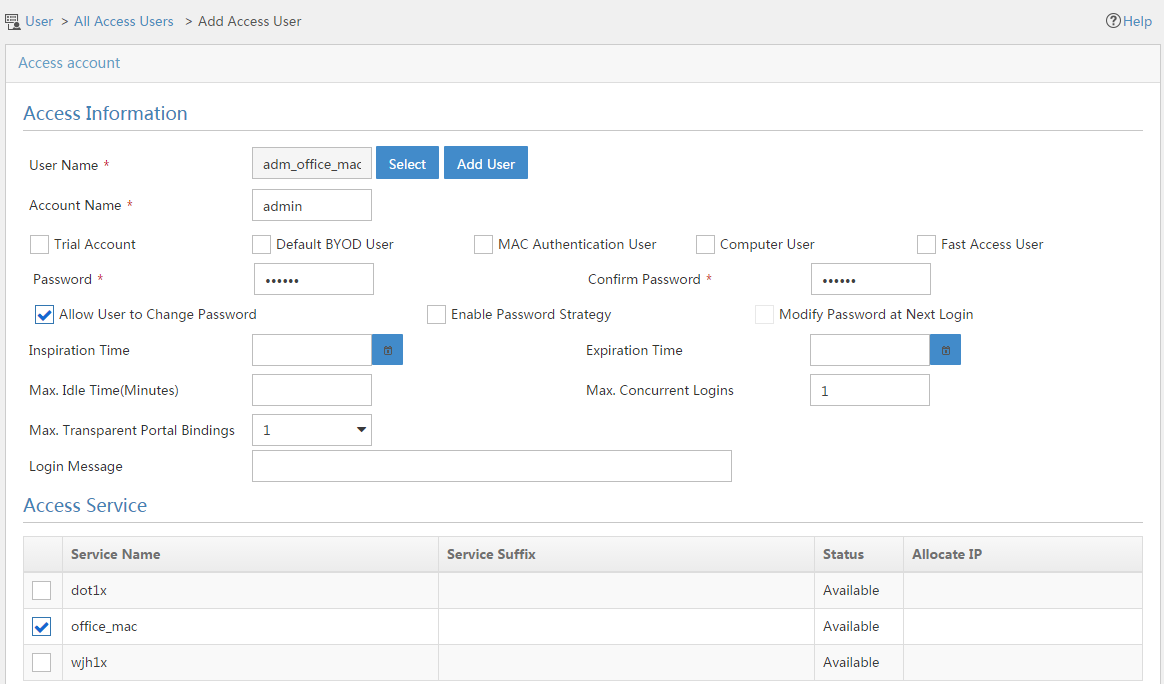

4. Add an access user:
b. From the navigation tree, select Access User > Access User.
The access user list opens.
c. Click Add.
The Add Access User page opens.

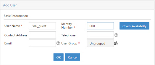

d. In the Access Information area, add a user, as shown in Figure 5:
- Click Add User.
- On the dialog box that opens, enter adm_office_mac in the User Name and Identity Number fields.
- Click Check Availability to verify the validity of the username and identity number.
- Click OK.
e. In the Access Information area, configure the MAC authentication user account, as shown in Figure 6:
- Enter admin in the Account Name field.
- Enter 123456 in the Password and Confirm Password fields.
NOTE: To test the guest VLAN functionality, the user account settings in this example are inconsistent with the MAC authentication username and password format configured on the AC. On a live network, you must make sure the usernames and passwords for the clients are their MAC addresses in the format specified on the AC. |
f. In the Access Service area, select office_mac from the list.
g. Click OK.
Figure 6 Adding an access user account

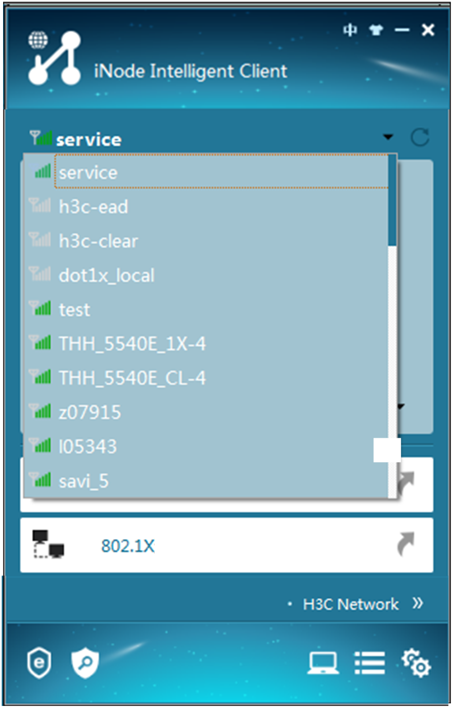

# Attempt to access the network from a client.
# On the AC, verify that the wireless client fails MAC authentication and is assigned to VLAN 300.
