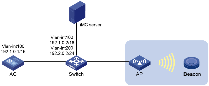

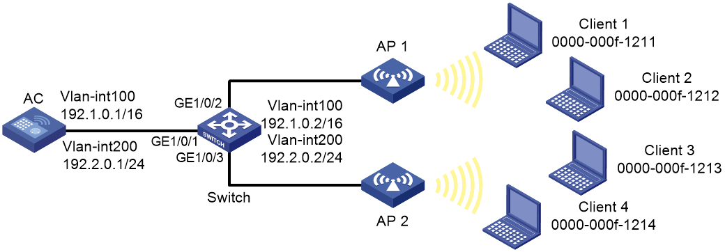

The following information provides an example for configuring WA4320-ACN-B APs to realize iBeacon management.
This document applies to Comware-based access controllers and access points. Procedures and information in the examples might be slightly different depending on the software or hardware version of the access controllers and access points.
This document assumes that you have basic knowledge of IoT AP and WLAN location.
Example: Configuring iBeacon management
As shown in Figure 1, configure the AP to manage the iBeacon device. The AP collects BLE information and sends the information to the location server on the IMC server for calculation. Then, users can obtain information including electric quantity and RSSI of the iBeacon device. The AP also assigns management orders from the server to the iBeacon device.
Use the actual serial ID of an AP to uniquely identify that AP.

1. Configure interfaces on the AC:
# Create VLAN 100 and VLAN-interface 100, and assign an IP address to the VLAN interface. The AC will use this IP address to establish a CAPWAP tunnel with the AP.
<AC> system-view
[AC] vlan 100
[AC-vlan100] quit
[AC] interface vlan-interface 100
[AC-Vlan-interface100] ip address 192.1.0.1 16
[AC-Vlan-interface100] quit
# Create VLAN 200 and VLAN-interface 200, and configure the VLAN interface to use DHCP for IP address acquisition.
<AC> system-view
[AC] vlan 200
[AC-vlan200] quit
[AC] interface vlan-interface 200
[AC-Vlan-interface200] ip address dhcp-alloc
[AC-Vlan-interface200] quit
# Configure GigabitEthernet 1/0/1 that connects the AC and the switch as a trunk port, remove the port from VLAN 1, and assign it to VLANs 100 and 200.
[AC] interface gigabitethernet 1/0/1
[AC-GigabitEthernet1/0/1] port link-type trunk
[AC-GigabitEthernet1/0/1] undo port trunk permit vlan 1
[AC-GigabitEthernet1/0/1] port trunk permit vlan 100 200
[AC-GigabitEthernet1/0/1] quit
2. Configure the AP:
NOTE: In a large-scale network, configure AP settings in AP group view instead of AP view as a best practice. |
# Create a manual AP named ap1, and specify the AP model and serial ID
[AC] wlan ap ap1 model WA6320
[AC-wlan-ap-ap1] serial-id 219801A28N819CE0002T
# Create AP group group1, and configure a grouping rule by AP name to add AP ap1 to the group.
[AC] wlan ap-group group1
[AC-wlan-ap-group-group1] ap ap1
3. Configure a module:
# Enter the view of module 1.
[AC-wlan-ap-group-group1] ap-model WA6320
[AC-wlan-ap-group-group1-ap-model-WA6320] module 1
# Specify the supported module type BLE for module 1, and enable module 1.
[AC-wlan-ap-group-group1-ap-model-WA6320-module-1] type ble
[AC-wlan-ap-group-group1-ap-model-WA6320-module-1] module enable
[AC-wlan-ap-group-group1-ap-model-WA6320-module-1] quit
[AC-wlan-ap-group-group1-ap-model-WA6320]quit
4. Configure BLE location:
# Enable BLE location.
[AC-wlan-ap-group-group1] rfid-tracking ble enable
# Set the IPv4 address and port number of the location server to 192.2.0.1 and 1145, respectively. In this example, the IP address of the BLE location server is the IMC server's IP address obtained through DHCP.
[AC-wlan-ap-group-group1] rfid-tracking ble engine-address 192.2.0.1 engine-port 1145
# Enable BLE neighbor list reporting for AP ap1.
[AC-wlan-ap-group-group1] rfid-tracking ble report enable
# Configure the AP to send BLE neighbor list reports to the location server every 10 seconds.
[AC-wlan-ap-group-group1] rfid-tracking ble report interval 10
# Specify the default password for deploying configuration to iBeacon devices as AprilBrother in plaintext form. Make sure the specified password is the same as the factory password of the iBeacon device.
[AC-wlan-ap-group-group1] rfid-tracking ble command-password simple AprilBrother
[AC-wlan-ap-group-group1] quit

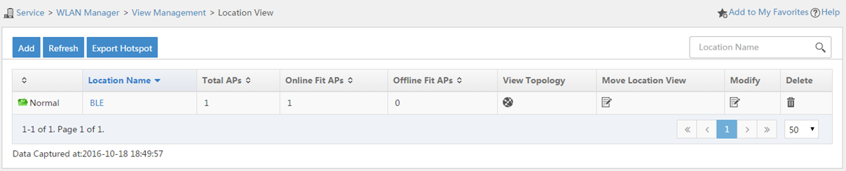

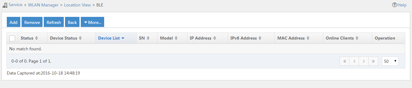

1. Add a location:
a. Click the Service tab.
b. From the navigation tree, select WLAN Manager > Location View.
c. Click Add.
The Add Location page opens.
d. Configure the following parameters, as shown in Figure 2:
- Enter BLE in the Location Name field.
- Use the default settings for other parameters.
e. Click OK.
Figure 2 Adding a location

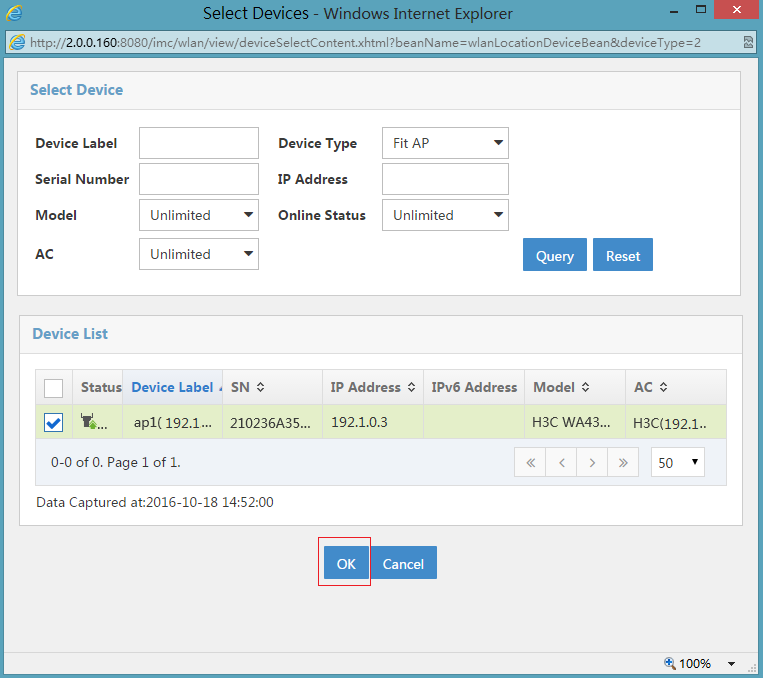

2. Add a Bluetooth AP:
a. On the newly created location view page, click Add, as shown in Figure 3.
The Select Devices page opens.
b. On the Device List area, select the target Bluetooth AP, as shown in Figure 4.
Figure 3 Adding a Bluetooth AP
Figure 4 Selecting a Bluetooth AP
