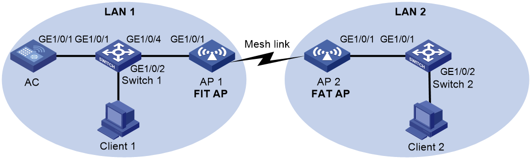

As shown in Figure 1, in centralized forwarding mode, the AC in LAN 1 is connected to Switch 1, and Switch 1 assigns an IP address to the AP and client in LAN 1 as a DHCP server. Switch 2 assigns an IP address to the client in LAN 2 as a DHCP server. Configure the devices to meet the following requirements:
·     AP 1 obtains an IP address from the address pool on VLAN 10 configured on Switch 1 and comes online from the AC.
·     The clients in LAN 1 and LAN 2 are assigned to different VLANs and are reachable to each other at Layer 3.
Figure 1 Network diagram
·     Use the actual serial ID of an AP to uniquely identify that AP.
·     Configure GE 1/0/4 that connects Switch 1 to the AP as a trunk port, and remove the port from VLAN 1.

# Bind WLAN-Radio 1/0/1 to the mesh profile.
[AP2] interface wlan-radio 1/0/1
[AP2-WLAN-Radio1/0/1] mesh-profile 1
4.     Add the MAC address of AP 1 to the mesh peer whitelist for the fat AP.
[AP2-WLAN-Radio1/0/1] mesh peer-mac-address 542b-dea7-a8c0
[AP2-WLAN-Radio1/0/1] quit
5.     Configure a WLAN-mesh interface:
# Create a WLAN-mesh interface.
[AP2] interface wlan-mesh 1
# Configure WLAN-mesh interface 1 as a trunk port, and assign the port to all VLANs.
[AP2-WLAN-Mesh1] port link-type trunk
[AP2-WLAN-Mesh1] port trunk permit vlan all
[AP2-WLAN-Mesh1] quit
# Bind WLAN-mesh interface 1 to WLAN-Radio 1/0/1.
[AP2-WLAN-Radio1/0/1] mesh-interface 1
6.     Configure a route to the network where Client 1 resides.
[AP2] ip route-static 192.168.10.0 255.255.255.0 10.12.12.1

Configuration files
·     Switch 1:
 dhcp enable
vlan 10
vlan 20
vlan 30
dhcp server ip-pool 1
 forbidden-ip 172.16.1.2
 gateway-list 172.16.1.1
 network 172.16.1.0 mask 255.255.255.0
dhcp server ip-pool 2
 gateway-list 192.168.10.1
 network 192.168.10.0 mask 255.255.255.0
 dns-list 192.168.10.1
interface Vlan-interface10
 ip address 172.16.1.1 255.255.255.0
interface Vlan-interface20
 ip address 192.168.10.1 255.255.255.0
interface Vlan-interface30
 ip address 10.12.12.1 255.255.255.0
 port access vlan 20
interface GigabitEthernet1/0/4
 undo port trunk permit vlan 1
 port trunk permit vlan 2 to 4094
 port trunk pvid vlan 10
 ip route-static 192.168.20.0 255.255.255.0 10.12.12.2
·     AC:
wlan mesh-profile 1
 mesh-id 1
 akm mode sae
 preshared-key pass-phrase cipher $c$3$qVXx1KuNn4FeEi3nMUkQ7A8jcIMrN8JH2AOv
 mesh-profile enable
vlan 10
 ip address 172.16.1.2 255.255.255.0
wlan ap-group group1
 map-configuration flash:/map.txt
 vlan 1
 ap ap1
  mesh-port link-type trunk
  mesh-port trunk permit vlan all
 ap-model WA6330
  radio 1
   type dot11an
   channel 36
   radio enable
   mesh-interface 1
   mesh-profile 1
   mesh peer-mac-address 90e7-1066-e060
wlan ap ap1 model WA6330
 serial-id 219801A23V8192E00021
·     Switch 2:
 dhcp enable
vlan 40
 forbidden-ip 192.168.20.1
 gateway-list 192.168.20.1
 network 192.168.20.0 mask 255.255.255.0
interface Vlan-interface40
 ip address 192.168.20.2 255.255.255.0
 port access vlan 40
·     AP 2:
wlan mesh-profile 1
 mesh-id 1
 akm mode sae
 mesh-profile enable
vlan 30
vlan 40
 ip address 10.12.12.2 255.255.255.0
 ip address 192.168.20.1 255.255.255.0
interface WLAN-Radio1/0/1
 mesh-profile 1
 mesh-interface 1
 type dot11an
 channel 36
interface WLAN-Mesh1
