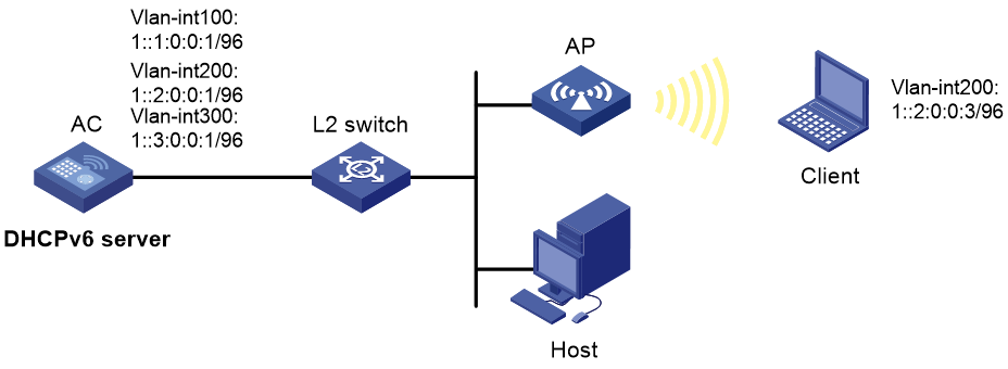

As shown in Figure 1, the AC acts as a DHCPv6 server to assign IPv6 addresses to the AP, client, and host, and the Layer 2 switch supplies power to the AP through PoE. Assume centralized forwarding is used in this example.
Configure wireless services to enable the client to access the wireless services and communicate with the host.
Figure 1 Network diagram
