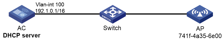

Example: Configuring auto AP
As shown in Figure 1, the AC acts as the DHCP server to assign an IP address to the AP. Enable the auto AP feature so that the AP can connect to the AC without manual configuration and can be automatically converted to a manual AP after coming online.
Procedures
Configuring the AC
1. Configure interfaces on the AC:
# Create VLAN 100 and VLAN-interface 100, and assign an IP address to the VLAN interface. The AC will use this IP address to establish a CAPWAP tunnel with the AP.
<AC> system-view
[AC] vlan 100
[AC-vlan100] quit
[AC] interface vlan-interface 100
[AC-Vlan-interface100] ip address 192.1.0.1 16
[AC-Vlan-interface100] quit
# Configure GigabitEthernet 1/0/1 that connects the AC and the switch as a trunk port, remove the port from VLAN 1, and assign it to VLAN 100.
[AC] interface gigabitethernet 1/0/1
[AC-GigabitEthernet1/0/1] port link-type trunk
[AC-GigabitEthernet1/0/1] undo port trunk permit vlan 1
[AC-GigabitEthernet1/0/1] port trunk permit vlan 100
[AC-GigabitEthernet1/0/1] quit
2. Configure DHCP:
# Enable DHCP.
[AC] dhcp enable
# Create a DHCP address pool named 1, and specify subnet 192.1.0.0/16 and gateway IP address 192.1.0.1 in the DHCP address pool.
[AC] dhcp server ip-pool 1
[AC-dhcp-pool-1] network 192.1.0.0 16
[AC-dhcp-pool-1] gateway-list 192.1.0.1
[AC-dhcp-pool-1] quit
3. Configure auto AP:
# Enable auto AP.
[AC] wlan auto-ap enable
# Convert auto APs to manual APs automatically after auto APs come online.
[AC] wlan auto-persistent enable
Configuring the switch
# Create VLAN 100. The switch will use this VLAN to forward the traffic on the CAPWAP tunnel between the AC and AP.
<Switch> system-view
[Switch] vlan 100
[Switch-vlan100] quit
# Configure GigabitEthernet 1/0/1 that connects the switch and the AC as a trunk port, remove the port from VLAN 1, and assign the trunk port to VLAN 100.
[Switch] interface gigabitethernet 1/0/1
[Switch-GigabitEthernet1/0/1] port link-type trunk
[Switch-GigabitEthernet1/0/1] undo port trunk permit vlan 1
[Switch-GigabitEthernet1/0/1] port trunk permit vlan 100
[Switch-GigabitEthernet1/0/1] quit
# Configure GigabitEthernet 1/0/2 that connects the switch and the AP as an access port. Assign the access port to VLAN 100.
[Switch] interface gigabitethernet 1/0/2
[Switch-GigabitEthernet1/0/2] port link-type access
[Switch-GigabitEthernet1/0/2] port access vlan 100
# Enable PoE on GigabitEthernet 1/0/2.
[Switch-GigabitEthernet1/0/2] poe enable
[Switch-GigabitEthernet1/0/2] quit
# Verify that the AP has established a CAPWAP tunnel with the AC.
[AC] display wlan ap all
Total number of APs: 1
Total number of connected APs: 1
Total number of connected manual APs: 0
Total number of connected auto APs: 1
Total number of connected common APs: 1
Total number of connected WTUs: 0
Total number of inside APs: 0
Maximum supported APs: 3072
Remaining APs: 3071
Total AP licenses: 128
Local AP licenses: 128
Server AP licenses: 0
Remaining AP licenses: 127
Sync AP licenses: 0
AP information
State : I = Idle, J = Join, JA = JoinAck, IL = ImageLoad
C = Config, DC = DataCheck, R = Run, M = Master, B = Backup
AP name AP ID State Model Serial ID
741f-4a35-6e00 1 R/M WA6320 219801A28N819CE0002T
Configuration files
· AC:
dhcp enable
vlan 100
network 192.1.0.0 mask 255.255.0.0
interface Vlan-interface100
ip address 192.1.0.1 255.255.0.0
wlan auto-ap enable
· Switch:
vlan 100
poe enable
Related documentation
· AP and WT Management Command Reference in H3C Access Controllers Command References
· AP and WT Management Configuration Guide in H3C Access Controllers Configuration Guides
