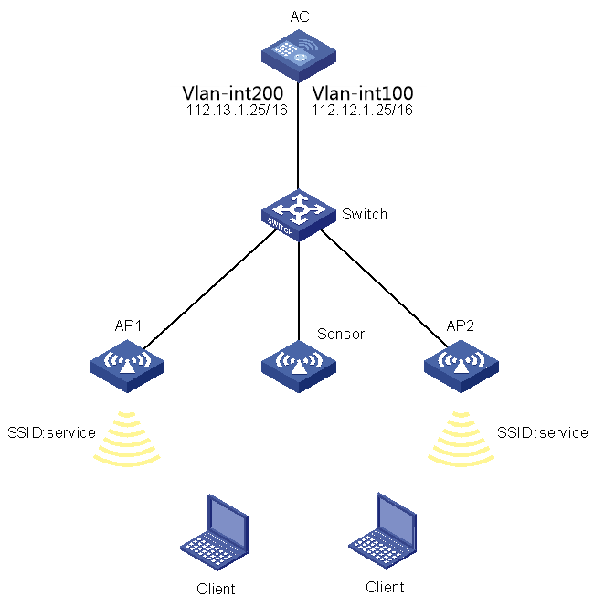

As shown in Figure 1, AP 1 and AP 2 provide wireless services for clients through SSID service.
Enable WLAN probe on the sensor, and configure the sensor to report the received wireless device information to the AC.
Figure 1 Network diagram

1.     Configure interfaces on the AC:
# Configure VLAN-interface 100 and assign it an IP address. The AC will use this IP address to establish CAPWAP tunnels with APs.
<AC> system-view
[AC] vlan 100
[AC-vlan100] quit
[AC] interface vlan-interface 100
[AC-Vlan-interface100] ip address 112.12.1.25 16
[AC-Vlan-interface100] quit
# Configure VLAN-interface 200 and assign it an IP address. The AC will use VLAN 200 for client access.
[AC] vlan 200
[AC-vlan200] quit
[AC] interface vlan-interface 200
[AC-Vlan-interface200] ip address 112.13.1.25 16
[AC-Vlan-interface200] quit
# Configure GigabitEthernet 1/0/1 that connects the AC to the switch as a trunk port.
[AC] interface gigabitethernet1/0/1
[AC-GigabitEthernet1/0/1] port link-type trunk
# Remove the trunk port from VLAN 1, and assign the port to VLANs 100 and 200.
[AC-GigabitEthernet1/0/1] undo port trunk permit vlan 1
[AC-GigabitEthernet1/0/1] port trunk permit vlan 100 200
[AC-GigabitEthernet1/0/1] quit
2.     Configure DHCP:
# Enable DHCP.
[AC] dhcp enable
# Create DHCP address pool vlan100 to assign IP addresses for APs, and specify the IP address range for the DHCP address pool.
[AC] dhcp server ip-pool vlan100
[AC-dhcp-pool-vlan100] network 112.12.0.0 mask 255.255.0.0
# Specify gateway IP address 112.12.1.25 in the DHCP address pool.
[AC-dhcp-pool-vlan100] gateway-list 112.12.1.25
[AC-dhcp-pool-vlan100] quit
# Create DHCP address pool vlan200 to assign IP addresses for clients, and specify the IP address range for the DHCP address pool.
[AC] dhcp server ip-pool vlan200
[AC-dhcp-pool-vlan200] network 112.13.0.0 mask 255.255.0.0
# Specify gateway IP address 112.13.1.25 in the DHCP address pool.
[AC-dhcp-pool-vlan200] gateway-list 112.13.1.25
# Configure the DNS server according to the actual network plan. In this example, the gateway is specified as the DNS server.
[AC-dhcp-pool-vlan200] dns-list 112.13.1.25
[AC-dhcp-pool-vlan200] quit
3.     Configure the AP:
In a large-scale network, configure AP groups instead of single APs as a best practice.
# Create a service template named service.
[AC] wlan service-template service
# Set the SSID to service.
[AC-wlan-st-service] ssid service
# Assign the service template to VLAN 200.
[AC-wlan-st-service] vlan 200
# Set the AKM mode to PSK and specify plaintext string 12345678 as the preshared key.
[AC-wlan-st-service] akm mode psk
[AC-wlan-st-service] preshared-key pass-phrase simple 12345678
# Specify the cipher suite as CCMP and the security IE as RSN.
[AC-wlan-st-service] cipher-suite ccmp
[AC-wlan-st-service] security-ie rsn
# Configure the AC to forward client data traffic. You can skip this step if the AC is the client traffic forwarder by default.
[AC-wlan-st-service] client forwarding-location ac
# Enable the service template.
[AC-wlan-st-service] service-template enable
[AC-wlan-st-service] quit
# Create AP group group1, add the APs to the AP group, and specify the AP model.
[AC] wlan ap-group group1
[AC-wlan-ap-group-group1] ap ap1 ap2
[AC-wlan-ap-group-group1] ap-model WA6320
# Bind the service template to the radio interface.
[AC-wlan-ap-group-group1-ap-model-WA6320] radio 1
[AC-wlan-ap-group-group1-ap-model-WA6320-radio-1] service-template service
[AC-wlan-ap-group-group1-ap-model-WA6320-radio-1] radio enable
[AC-wlan-ap-group-group1-ap-model-WA6320-radio-1] quit
[AC-wlan-ap-group-group1-ap-model-WA6320] quit
[AC-wlan-ap-group-group1] quit
# Create AP ap1, and specify its model and serial ID.
[AC] wlan ap ap1 model WA6320
[AC-wlan-ap-ap1] serial-id 219801A28N819CE0002X
# Create AP ap2, and specify its model and serial ID.
[AC] wlan ap ap2 model WA6320
[AC-wlan-ap-ap2] serial-id 219801A28N819CE0002T
# Create AP sensor and specify its model and serial ID.
[AC] wlan ap sensor model WA6330
[AC-wlan-ap-sensor] serial-id 219801A23V8192E00021
# Enable WLAN probe for the radio.
[AC-wlan-ap-sensor] radio 1
 [AC-wlan-ap-sensor-radio-1] scan scan-time 100
[AC-wlan-ap-sensor-radio-1] client-proximity-sensor enable
[AC-wlan-ap-sensor-radio-1] radio enable
[AC-wlan-ap-sensor-radio-1] quit
[AC-wlan-ap-sensor] return
Configuring the switch
# Create VLANs 100 and 200. The switch will use VLAN 100 to forward the traffic on CAPWAP tunnels between the AC and APs, and use VLAN 200 to forward client traffic.
<Switch> system-view
[Switch] vlan 100
[Switch-vlan100] quit
[Switch] vlan 200
[Switch-vlan200] quit
# Configure GigabitEthernet 1/0/1 that connects the switch to the AC as a trunk port.
[Switch] interface gigabitethernet1/0/1
[Switch-GigabitEthernet1/0/1] port link-type trunk
# Remove the trunk port from VLAN 1, and assign the port to VLAN 100 and VLAN 200.
[Switch-GigabitEthernet1/0/1] undo port trunk permit vlan 1
[Switch-GigabitEthernet1/0/1] port trunk permit vlan 100 200
[Switch-GigabitEthernet1/0/1] quit
# Configure GigabitEthernet 1/0/2 as an access port and assign the port to VLAN 100.
[Switch] interface gigabitethernet1/0/2
[Switch-GigabitEthernet1/0/2] port link-type access
[Switch-GigabitEthernet1/0/2] port access vlan 100
# Enable PoE.
[Switch-GigabitEthernet1/0/2] poe enable
[Switch-GigabitEthernet1/0/2] quit
# Configure GigabitEthernet 1/0/3 that connects the switch to the AP 1 as a trunk port.
[Switch] interface gigabitEthernet 1/0/3
[Switch-GigabitEthernet1/0/3] port link-type trunk
# Remove the trunk port from VLAN 1, and assign the port to VLAN 100.
[Switch-GigabitEthernet1/0/3] undo port trunk permit vlan 1
[Switch-GigabitEthernet1/0/3] port trunk permit vlan 100
# Specify the PVID of the trunk port as VLAN 100.
[Switch-GigabitEthernet1/0/3] port trunk pvid vlan 100
# Enable PoE.
[Switch-GigabitEthernet1/0/3] poe enable
[Switch-GigabitEthernet1/0/3] quit
# Configure GigabitEthernet 1/0/4 that connects the switch to the AP 2 as a trunk port.
[Switch] interface gigabitEthernet 1/0/4
[Switch-GigabitEthernet1/0/4] port link-type trunk
[Switch-GigabitEthernet1/0/4] undo port trunk permit vlan 1
[Switch-GigabitEthernet1/0/4] port trunk permit vlan 100
[Switch-GigabitEthernet1/0/4] port trunk pvid vlan 100
# Enable PoE.
[Switch-GigabitEthernet1/0/4] poe enable
[Switch-GigabitEthernet1/0/4] quit
# Display wireless device information detected by the sensor
<Sysname> display client-proximity-sensor device
Total 3 detected devices
MAC address    Type      Duration    Sensors Channel Status
0AFB-423B-893C AP        00h 10m 46s 1       11      Active
0AFB-423B-893D AP        00h 10m 46s 1       6       Active
0AFB-423B-893E AP        00h 10m 46s 1       1       Active
