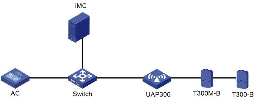

The following information provides an example for configuring iBeacon transmission for a BLE module.
This document applies to Comware-based access controllers and access points. Procedures and information in the examples might be slightly different depending on the software or hardware version of the access controllers and access points.
This document assumes that you have basic knowledge of IoT AP and wireless location.
Example: Configure iBeacon transmission for a BLE module
As shown in Figure 1, the IMC server acts as an IoT server, and UAP300 acts as an IoT AP to provide IoT services for the connected IoT modules T300M-B and T300-B.
When you configure iBeacon transmission for a BLE module, follow these restrictions and guidelines:
