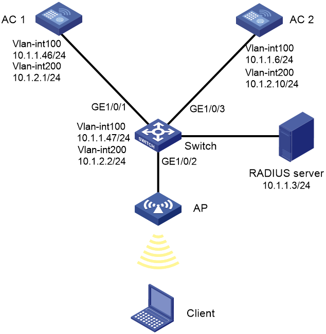

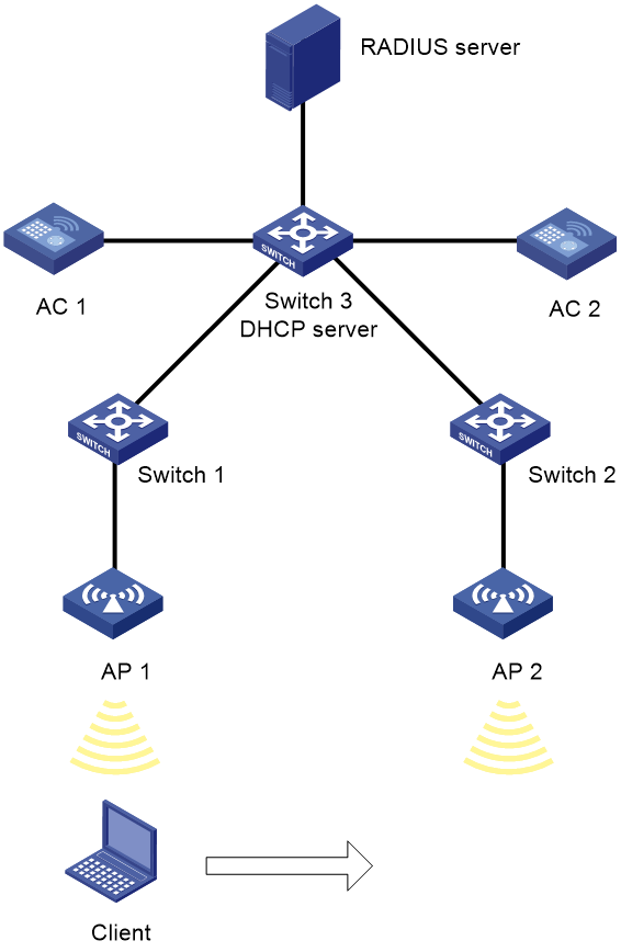

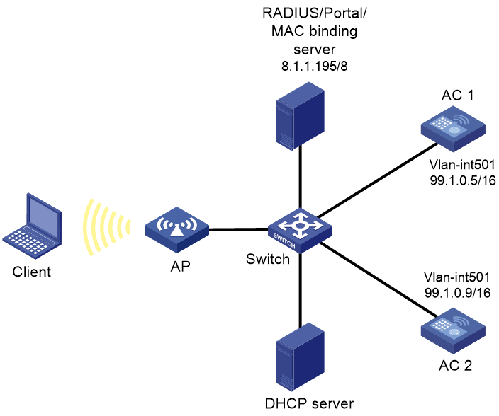

As shown in Figure 1, AP 1 and AP 2 are managed by AC 1 and AC 2, respectively. Clients associated with AC 1 belong to VLAN 200. Clients associated with AC 2 belong to VLAN 400.
Complete the following tasks:
· Configure inter-AC roaming to enable clients to roam between AP 1 and AP 2.
· Enable local forwarding of client traffic.
· Configure VLAN-based user isolation to improve user security and reduce radio resource consumption caused by multicast and broadcast packets.

Analysis
· To implement inter-AC roaming, add the two ACs to the same mobility group.
· To implement fast roaming, configure RSN + 802.1X authentication for clients.
· A client will inherit the roaming VLAN when it roams between ACs, so you must assign the data forwarding links of the APs to all service VLANs.
· To assign the interfaces on the APs to the local forwarding service VLANs and configure VLAN-based isolation, execute the map-configuration command on the AC to deploy a configuration file to each AP.
When you configure inter-AC roaming in local forwarding mode, follow these restrictions and guidelines:
· Make sure the configured SSID, authentication and key management (AKM) mode, and cipher suite are the same on APs for wireless roaming.
· Make sure no Tab or space exists at the end of each command line in the configuration file to be deployed by using the map-configuration command.
· Use the serial ID labeled on the AP's rear panel to specify an AP.

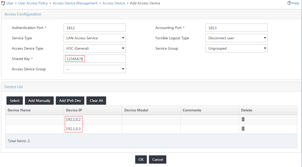

# Set the shared key to 12345678 in plaintext form for communication with the authentication server.
[AC1-radius-office] key authentication simple 12345678
# Set the shared key to 12345678 in plaintext form for communication with the accounting server.
[AC1-radius-office] key accounting simple 12345678
# Specify 192.1.0.2 as the NAS IPv4 address of RADIUS packets.
[AC1-radius-office] nas-ip 192.1.0.2
[AC1-radius-office] quit
# Create ISP domain office and enter its view.
[AC1] domain office
# Perform RADIUS authentication for LAN users based on scheme office.

3. Configure wireless access services:
# Create wireless service template 1 and enter its view.
[AC1] wlan service-template 1
# Set the SSID of the service template to service.
[AC1-wlan-st-1] ssid service
# Assign the service template to VLAN 200.
[AC1-wlan-st-1] vlan 200
# Configure APs to forward client data traffic.
[AC1-wlan-st-1] client forwarding-location ap

5. Configuring roaming:
# Create mobility group 1 and enter its view.
[AC1] wlan mobility group 1
# Specify 192.1.0.2 as the source IP address for establishing IACTP tunnels.
[AC1-wlan-mg-1] source ip 192.1.0.2
# Configure AC 1 as a member of mobility group 1, and specify 192.1.0.3 as the source IP address for establishing IACTP tunnels.
[AC1-wlan-mg-1] member ip 192.1.0.3
# Enable mobility group 1.
[AC1-wlan-mg-1] group enable
[AC1-wlan-mg-1] quit
6. Configure the default route:
# Configure the next hop of the default route to AC 1 as 192.1.0.1. The default route is used for the communication between AC 1 and the RADIUS server.
[AC1] ip route-static 0.0.0.0 0.0.0.0 192.1.0.1

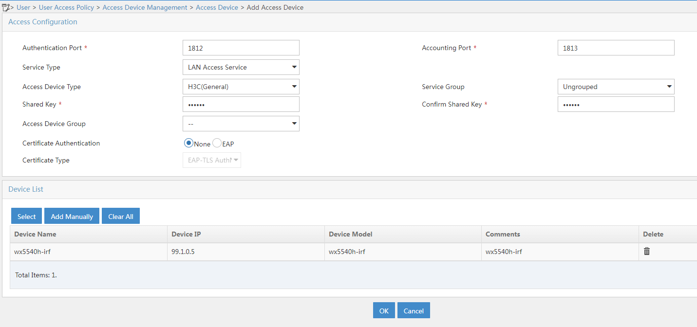

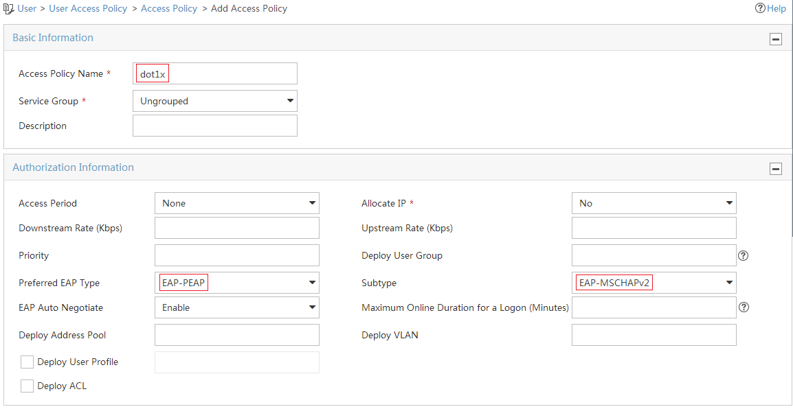

Configuring the RADIUS server
In this example, the RADIUS server runs on iMC PLAT 7.2(E0403) and iMC EIA 7.2(E0403).
To configure the RADIUS server:
1. Add the ACs to the IMC Platform as access devices:

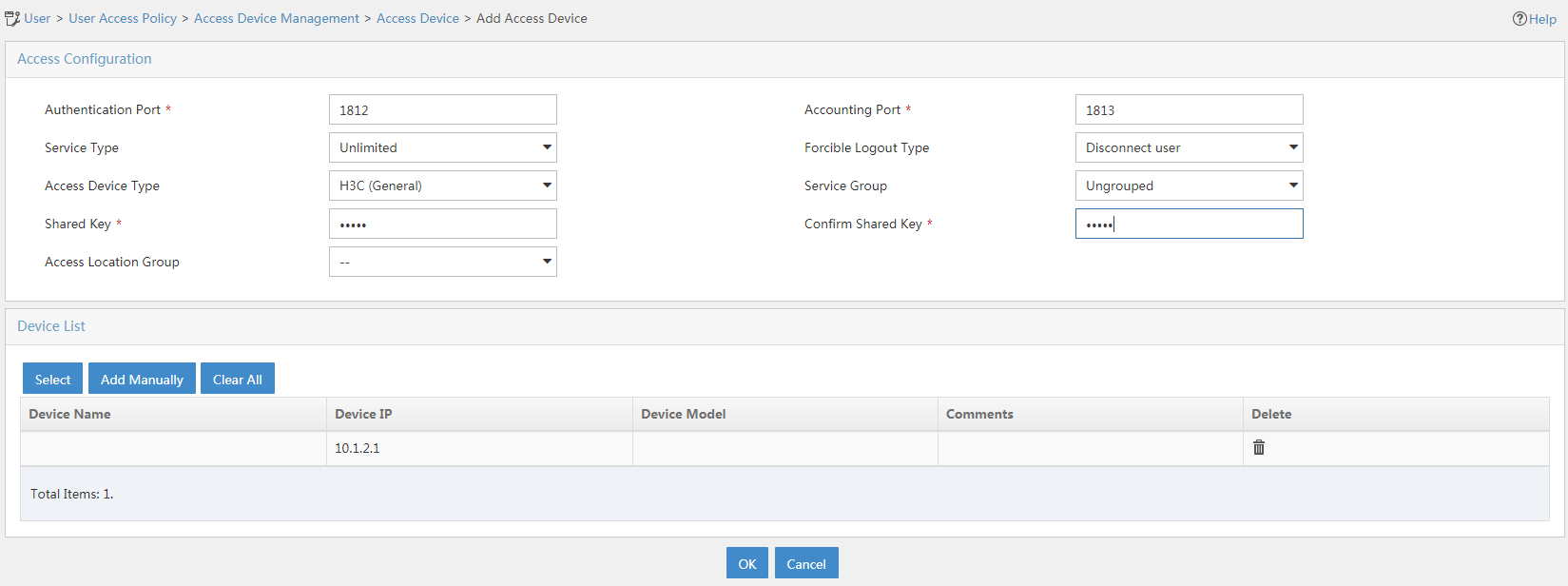

a. Log in to IMC.
b. Click the User tab.
c. From the navigation tree, select User Access Policy > Access Device Management > Access Device.
d. Click Add to add AC 1 and AC 2 as access devices.
e. Configure the following parameters:
- Enter 192.1.0.2 for AC 1 and 192.1.0.3 for AC 2 in the Device IP field.
- Enter 12345678 in the Shared Key field.
- Use the default settings for other parameters.
f. Click OK.
Figure 2 Adding access devices

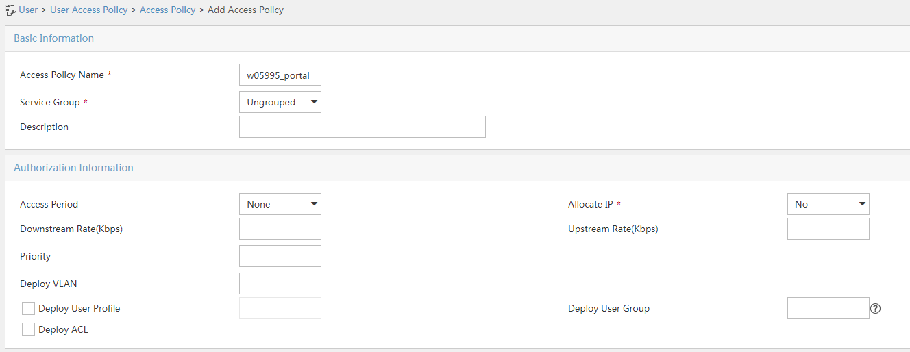

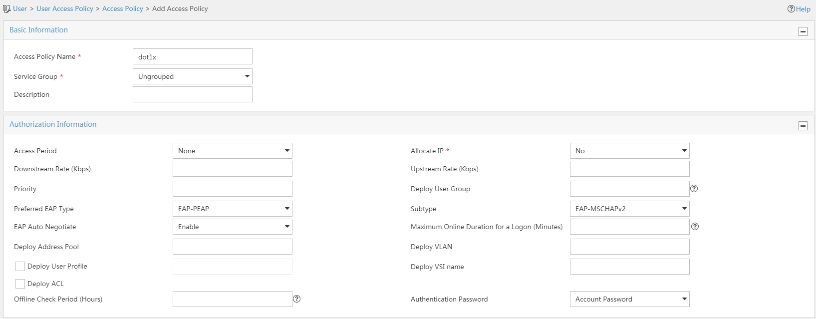

2. Add an access policy:
a. Click the User tab.
b. From the navigation tree, select User Access Policy > Access Policy.
c. Click Add to add an access policy that uses the following settings:
- Access Policy Name—dot1x.
- Preferred EAP Type—EAP-PEAP.
- Subtype—MS-CHAPV2. The subtype must match the client authentication method.
Figure 3 Adding an access policy

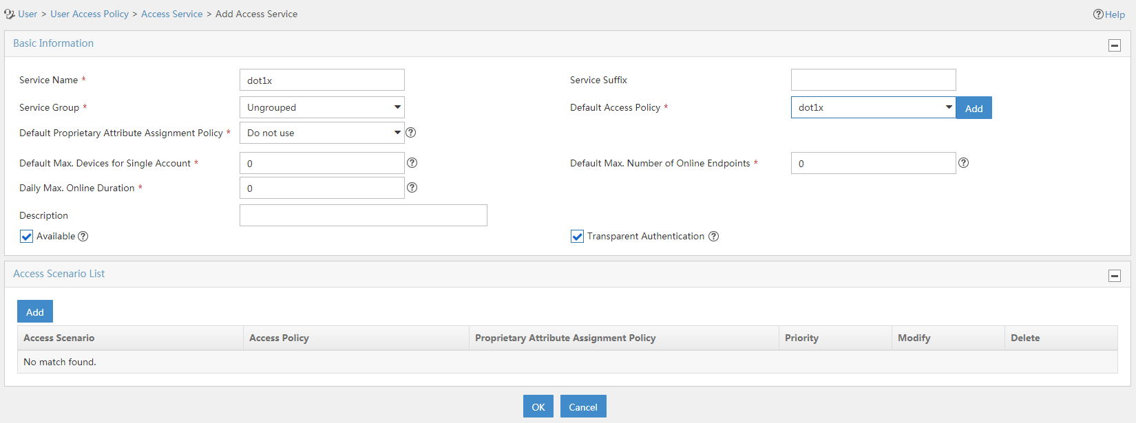

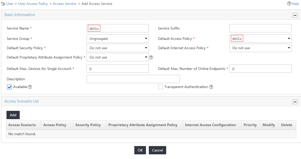

3. Add an access service:
b. From the navigation tree, select User Access Policy > Access Service.
c. Click Add to add an access service that uses the following settings:
- Service Name—dot1x.
- Default Access Policy—dot1x.
Figure 4 Adding an access service

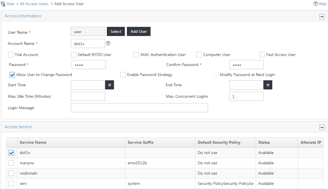

4. Add an access user:
b. From the navigation tree, select All Access Users.
c. Click Add to add an access user that uses the following settings:
- User Name—user.
- Account Name—dot1x.
- Password—dot1x.
d. Select the dot1x service for the user.
Figure 5 Adding an access user

# Make the client roam to AP 2.
# On AC 2, verify that the client is associated with AP 2.
<AC2> display wlan client verbose

# Verify that clients in VLAN 200 and VLAN 400 can access the Internet but cannot access a client in the same VLAN. (Details not shown.)
